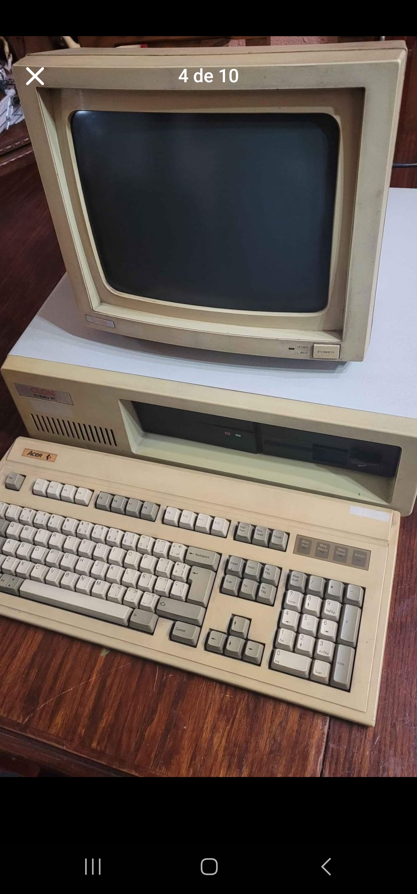

Just spotted this fella on Facebook marketplace, does anyone recognize the computer or if there is any way to confirm the model? I've read that kb-101s and 6010s are pretty much identical
- Screenshot_20241027_184542_Facebook.jpg (1.39 MiB) Viewed 15889 times

I think the label says "CLONE" in red letters with the N and E being a ligature.Leshe wrote: 27 Oct 2024, 22:52 does anyone recognize the computer or if there is any way to confirm the model?
The text below that is harder to see, but I read it as "TUENG PC".
The thing to look for is an IBM PC clone case that has the label in the exact same position and size. Apparently, that variety is not too common.
- Polecat
"Turbo PC". Generic term, probably just meant the motherboard had a 6 MHz or 8MHz mode, instead of the base 4,77. Might not be branded at all. Many XT clones were built from generic parts, either by the dealer or owner.
Keyboard could be a KB-102A or KB-102AS, or 6012 (all Alps), or a 6312 or 6512 (Acer slider-over-something). Upper cases were interchangeable. Need to see the label.
edited to correct 101A/101AS to 102A/102AS
Findecanor wrote: 27 Oct 2024, 23:04I think the label says "CLONE" in red letters with the N and E being a ligature.Leshe wrote: 27 Oct 2024, 22:52 does anyone recognize the computer or if there is any way to confirm the model?

Label says Clone Turbo PC. At least they're pretty straight forward with admitting they're a clone! But yes, one of many PC XT clones of the time. Acer has nothing to do with it, just happened to find its way to being paired with this system. As always, if it can come with blue alps, don't be surprised if it actually has white alps.

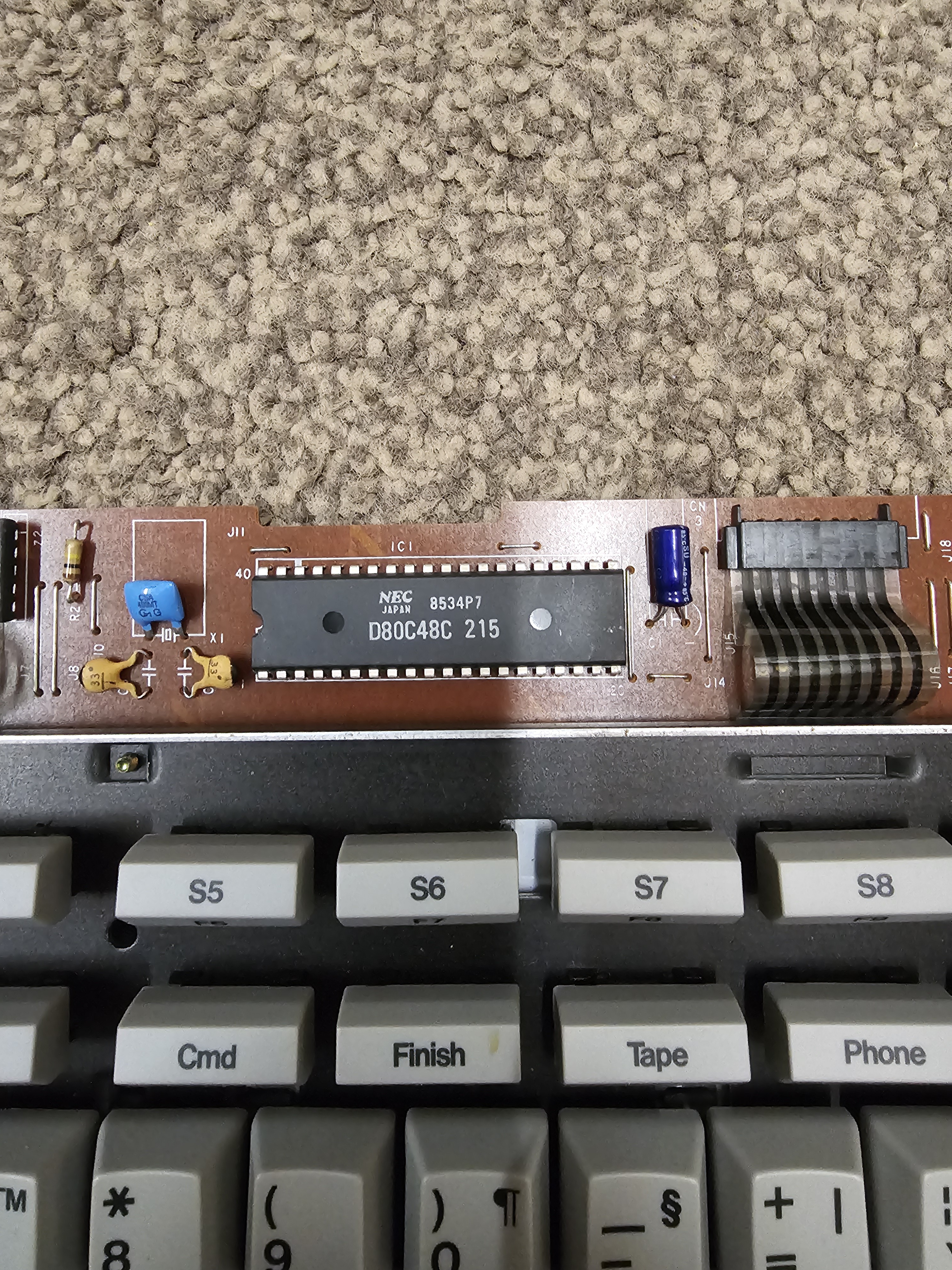

Hey everybody. I recently won an ebay auction for 4 vintage keyboardss. One of them is a darn-near NOS Tai Hao TH-5539-3. Two are Focus models with cut cords and a few missing caps, though the calculator still works on the FK-9000. The last one is an oddity, though sadly it's probably too far gone to salvage, at least by me.
It's a Clare-Pender/General Instruments terminal board, likely for some VT100 clone based on the layout (though 14 function keys) and one of the ICs. DB9 coiled cable. Yellowed and thin ABS double-shot keycaps, with a good number of them missing and/or broken. The switches are probably some variant of Clare Foam & Foil, but here's where it gets weird. Instead of a standard coil return spring, each switch uses a pair of torsion springs. I've never seen anything like this, and I can't find anything on the wiki or Telcontar. Anybody ever seen this?
- N3v3 5289.jpg (3.55 MiB) Viewed 14309 times
- N3v3 5288.jpg (79.22 KiB) Viewed 14309 times
- N3v3 5288 1.jpg (3.19 MiB) Viewed 14309 times

One of the ICs on the PCB says "VT100" on it, and apart from the sheer number of function keys and the placement of the arrows, it's a very similar layout to other VT100 boards I saw online. The weird thing is, though, it feels pretty value engineered. The case is pretty light and only uses wide-thread plastic screws to hold it together, and the keycaps are super thin. The plate is permanently mounted to the PCB with those robust plastic rivets, and peeking between it looks like foam and foil is the only thing that will fit, especially combined with the capacitive look that the bottom of the PCB has. Those return springs have me baffled, though. It seems fiddly and complex, and none of the documentation I could find seems to match them. There are several switches with broken housings or sliders, so I might dissect one to see what I'm really dealing with. I fear this is well beyond my ability to do much with, as I top out at soldering projects with existing code, but it seemed like an interesting find.AndyJ wrote: 03 Dec 2024, 20:20 That is *deeply* weird, particularly the sculpting of the top and bottom row keycaps.
It definitely looks like some sort of terminal. I'm surprised they would use foam-and-foil switches, though. My experience with those has been very bad; it's odd they would be used in a bespoke and expensive-looking keyboard.
