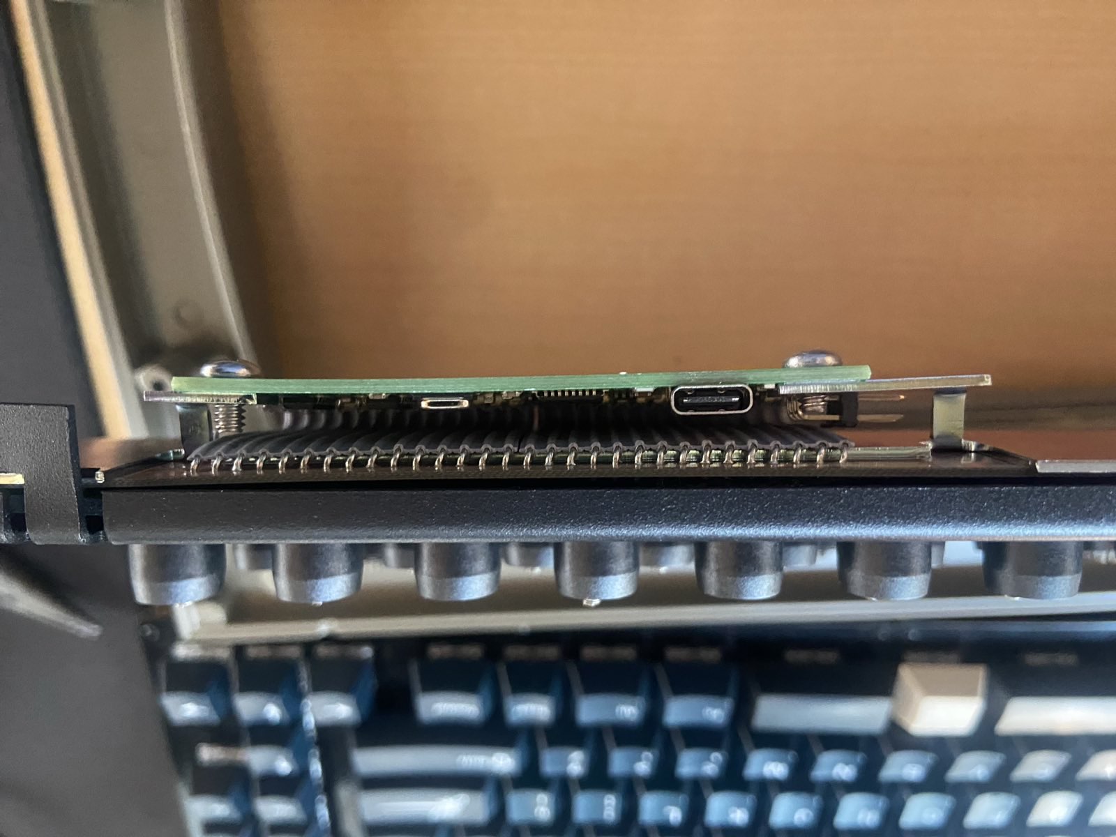

It is a tight fit, but I would install the case bolt inside the bottom case hole, then install the 1" bumper, and then install the bottom case to the top case. Be sure to install the bumper so that it is as far as possible away from the head of the bolt. I just tested it now and there is just enough clearance for a driver.
- Location: Canada
- Main keyboard: IBM F
Has anyone tried installing the solenoid in the middle of the top keyboard edge instead of on the side, to achieve centered sound and more even distribution of vibrations? I just installed a solenoid and I love it, but I can definitely feel it coming from the side, and would love to have the sound and sensations coming more from the middle.
- Location: Canada

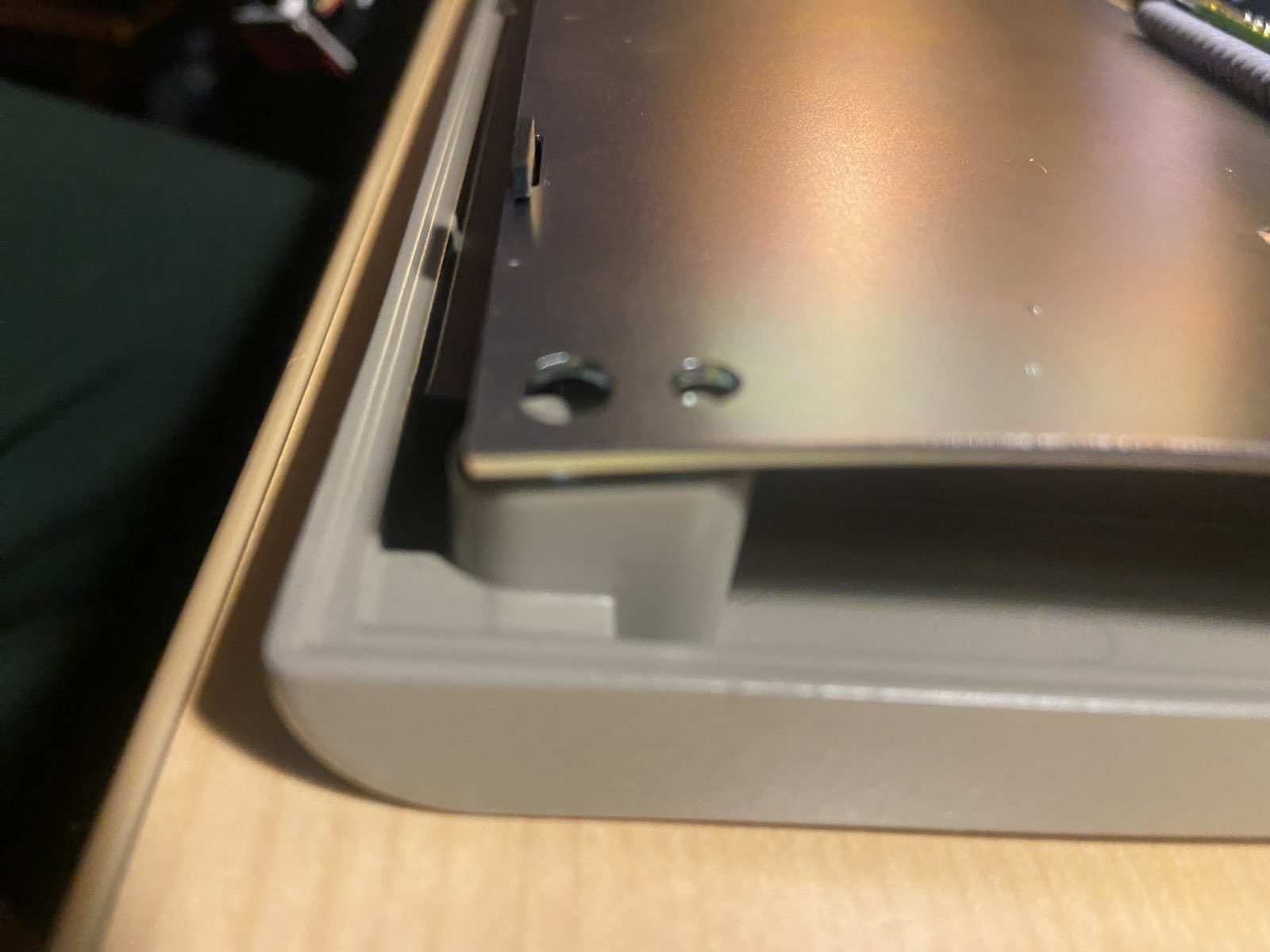

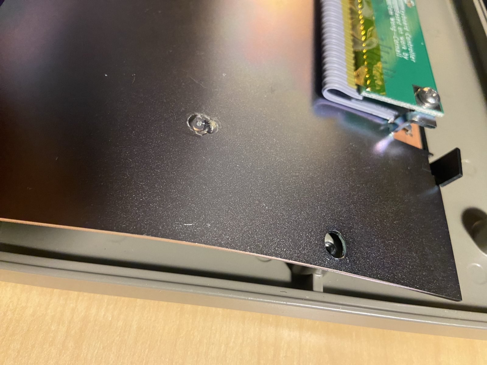

I put together an F62 scumyc layout, and there is a surprising amount of curvature in the backplate, it didn't touch the screw holes and the PCB started to bend. Putting the case on seems like a bad idea. Is this normal or have I likely done something wrong?
- f62-4.jpeg (205.41 KiB) Viewed 96295 times
- f62-3.jpeg (170.1 KiB) Viewed 96295 times
- f62-2.jpeg (137.96 KiB) Viewed 96295 times
- f62-1.jpeg (251.73 KiB) Viewed 96295 times
- Location: Canada
Is this normal and screwing the case bottom on will compress the metal into the right place? Seems like it has a relatively large distance to travel/bend to get into place.
Yes, all appears normal

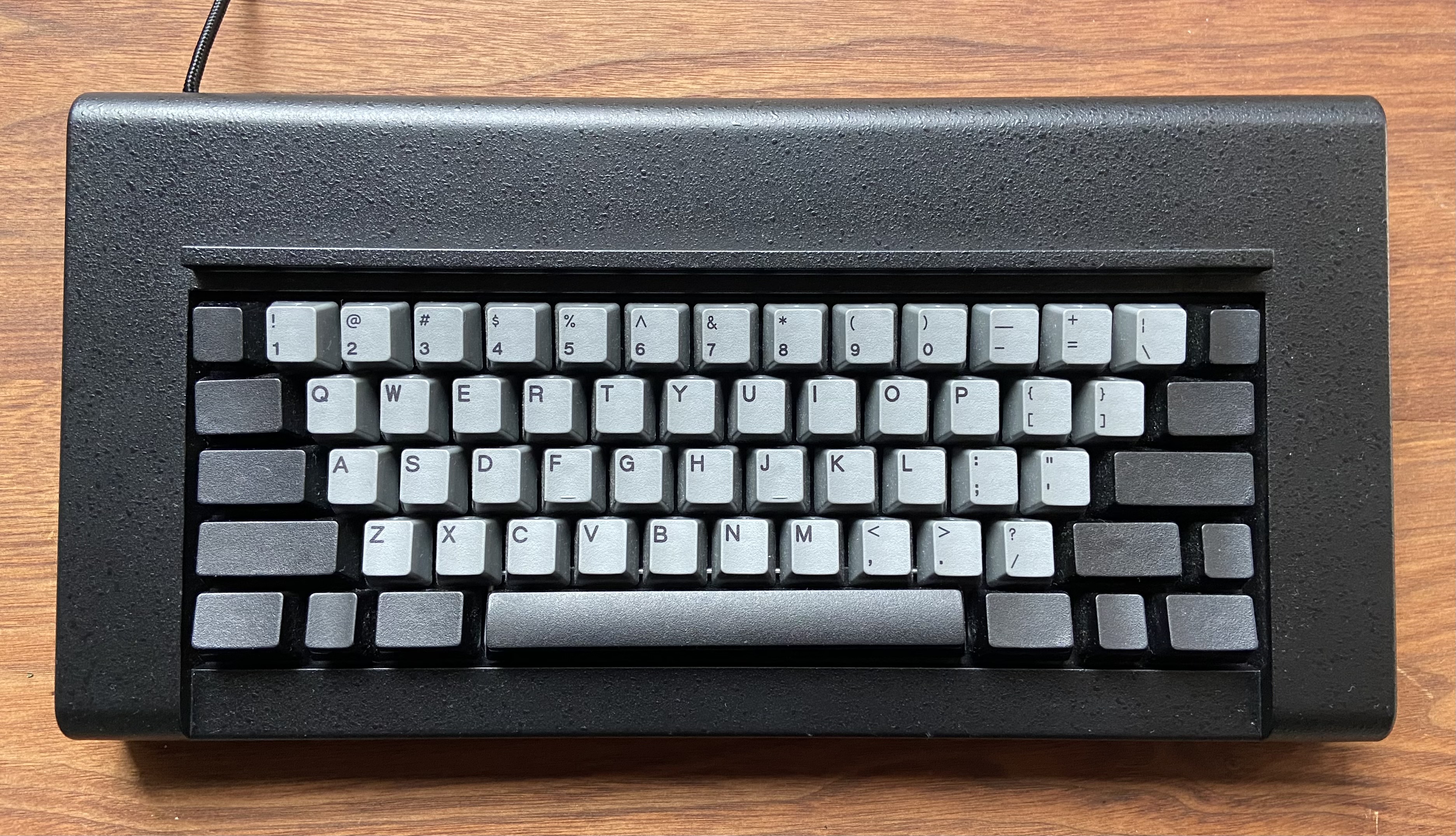

Loving my F62 boards, especially the scumyc layout.

So the scumyc board that I posted images of above while I was putting it together has a surprisingly different sound signature than the black F62 - much more muted with less treble. It sounds more different than I would have thought possible considering the components are so consistently manufactured. Has anyone else run into this? And idea what it could be? Maybe it has to do with the force required to screw down the scumyc, or maybe not all pre-made boards were sent out with foam installed? Or maybe people are finding each board sounds unique, and it's part of the joy of collecting these?
Both sound great, that's for sure. Wow.
That is normal. All Model F keyboards vary in their sound and each Model F keyboard sounds unique.

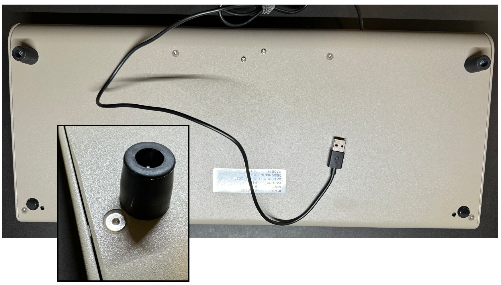

I ended up buying 3/4 inch bumpers on McMaster-Carr (p/n 9540K932, if anyone is interested). They work well with the 6-32 screws that were included with the 1-inch bumpers, and they were the tallest model with a small enough diameter to not interfere with the case screws on F104.Ellipse wrote: 07 Oct 2024, 06:31 It is a tight fit, but I would install the case bolt inside the bottom case hole, then install the 1" bumper, and then install the bottom case to the top case.

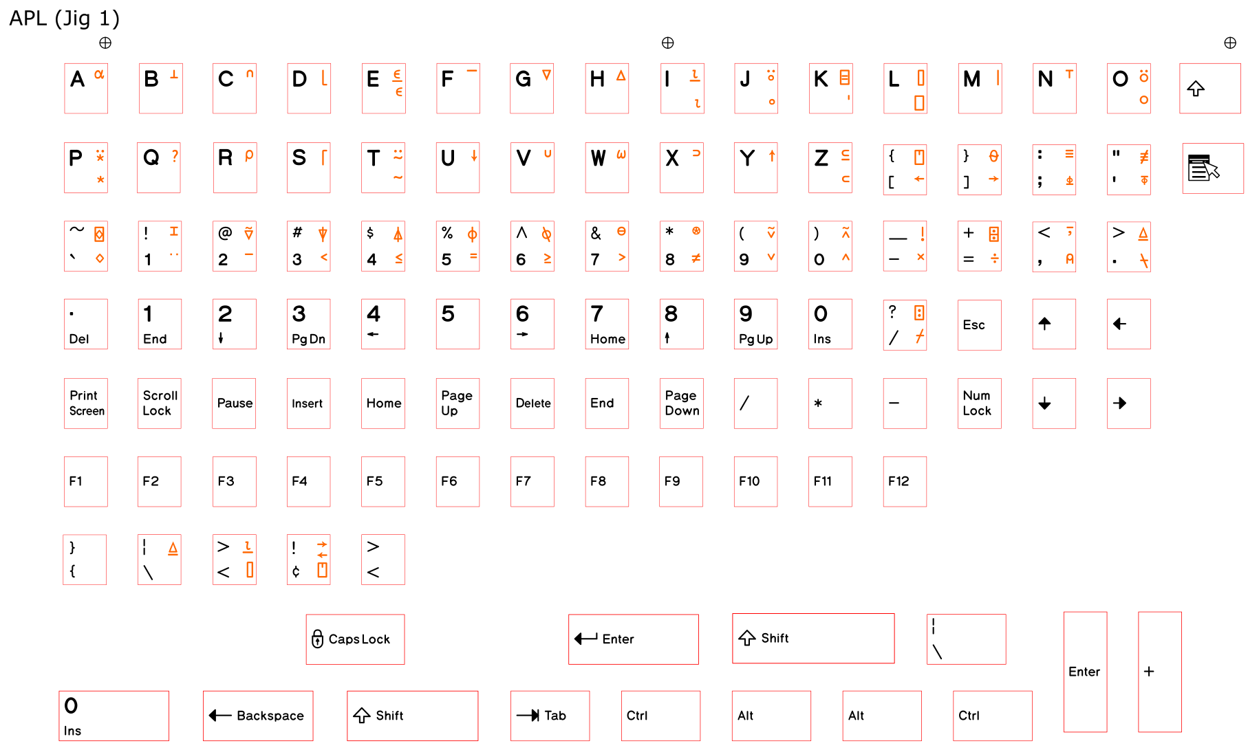

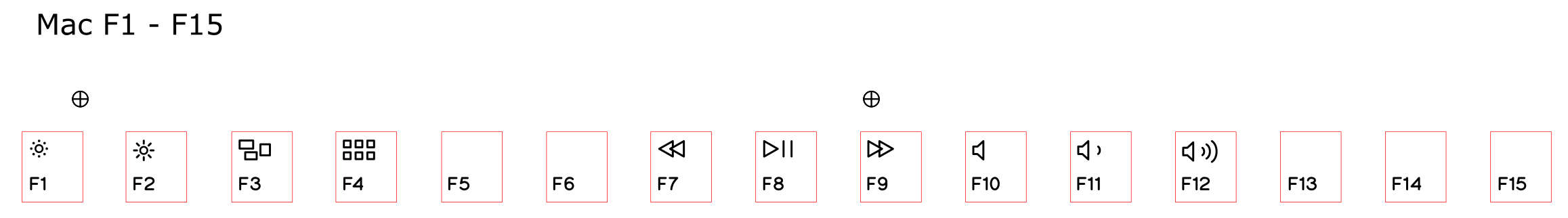

Here is the draft Mac F1-F15 set, designed to match the legends style of Apple's keyboard. Please let me know your feedback:
Engr please do post photos of those bumpers on your Model F if possible!

Thanks for that.Ellipse wrote: 15 Oct 2024, 21:04 Here is the draft Mac F1-F15 set, designed to match the legends style of Apple's keyboard. Please let me know your feedback
It seems macs have slightly different legends for the past few generations (with no F-only keys anymore):
My main worry would be the fact this is draft... Is adding a set likely to substantially delay an F122 order?

No, because I don't really need another key and the bigger shift is easier to reach with the left pinky.NathanA wrote: 06 Oct 2024, 00:59Okay, so you are not doing split left shift to get the extra key next to LShift that we normally see on ISO models?

Thanks - I see that there are two current full-size keyboards on the Apple site. Here is the larger version of the newer one from that image: https://www.apple.com/shop/product/MK2C ... white-keys
Any other feedback on the draft APL set posted a few months ago?

Here is the photo of my F104 with those 3/4" rubber feet from McMaster. Combined with 1/8" adhesive rubber feet, the typing angle is pretty close to a Model M with flip-out feet extended, and the diameter is just right to leave the case screws exposed.
The USB cable in the photo is different from the original because this Friday the keyboard suddenly stopped working, so I opened the case and replaced the original cable with some random USB cable that I had lying around, after which it started working again. I then tried re-plugging in the original cable, and the keyboard again was working, so I am not sure if the issue was the cable, the connector, or something else. I figured I would replace the cable anyway, because 10-foot cable is just impractical for me and I had a feeling that I would eventually have to replace it anyway.
So far the cable design has been my only gripe with the Classic F104. The cable hole is about 3mm in diameter, way too small for most USB-C cables, and the hole edges are fairly sharp, which may not be good for the cable in the long term (even with the internal strain relief bracket). If there is going to be another round of these boards, I would suggest drilling out the hole to a diameter large enough for a cord grip or for typical USB-C cables, or, better yet, a detachable cable like on the Ultra Compact F104.

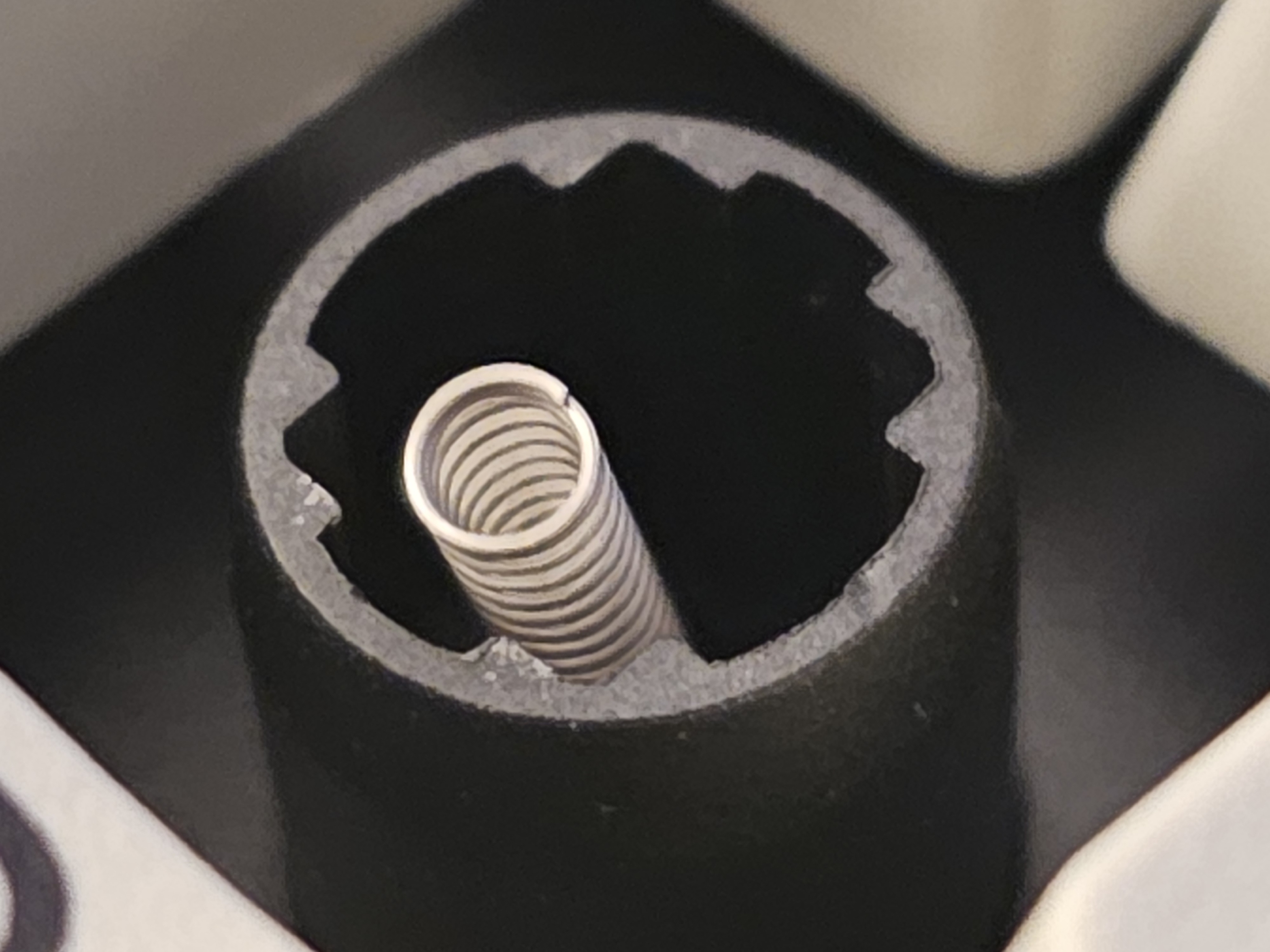

Secondly, I started noticing some prevalent off-center binding/scratchiness on a some of the unstabilized keys after a little over a week of use. I noticed there was a bit of light colored debris around the corner edges of the barrels from the keycap stem rubbing against them, and they did feel a bit sharp. I resolved this by just gently smoothing the corner edges of the barrels with the side of a flathead screwdriver blade. I don't know if this would've eventually worked itself out with more use/breaking-in but I haven't had the issue reoccur on any of the previously affected keys since doing that.

I have done some testing on the barrel issue you noted but I cannot reproduce it and am not sure that anyone else posted about this issue. The squeaking may be due to an improperly seated spring and your efforts may have inadvertently moved around or stretched the spring so as to eliminate the extra sound. The key and barrel do not squeak on their own in my testing of loose keys and barrels assembled together. If the keys are being rotated while pressed down firmly all the way (they do have some rotation by design) then I'd imagine you would see some wear from the plastic due to friction.

As for the barrels, it isn't so much an audible issue as it is one that I can feel - like extra resistance when I push down off center. On most of the keys I encountered, it was more prevalent on the bottom corners of the key though I'd sometimes feel it on the upper corners too. But I will note that I didn't even notice it until I spent some more time with the keyboard, so (not to draw any conclusions) it could be something that wears in with extended use. Nobody else seems to have encountered this on the prior models or the Round 2 models to date though, so hopefully it's just something that works itself out with time and/or I'm just being exceedingly picky. Just figured I'd raise it in case it comes up in the future.

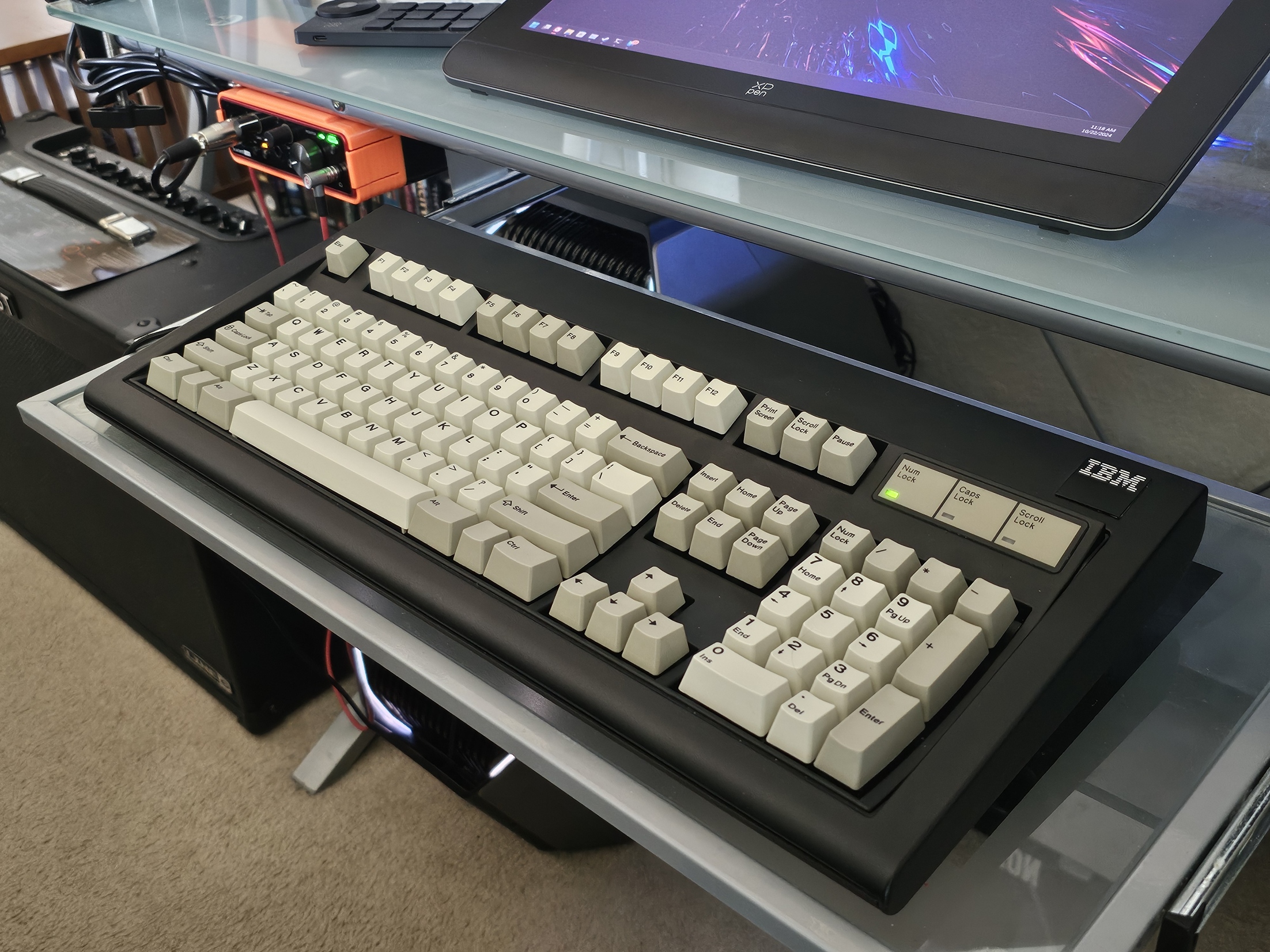

I took delivery of my F104 on Saturday. Right now I have it set up at my WFH workstation, sitting in for my F122 Battleship. Here are some pictures:
As you can see, the board looks exactly like an original Model M. This is the keyboard which I've been waiting for my whole life, a Model F with a fully standard layout. So far, with exception to some setup glitches which I'll mention below, I'm very satisfied with the result.
While the setup process was mostly straightforward to anyone that's dealt with rehabbing original Model F's, I did run into one frustrating issue with the black vertical key stabilizers. In the instructions it's explicitly stated that the stabilizer for the ISO enter should be keyed such that the large ear is pointing towards the left, 180 degrees rotated from the images in the guide. When I keyed it this way, it didn't work. It turned out that it worked perfectly when it was keyed the same way as the '+' key, with the large ear pointing toward the right. That was frustrating because the instruction didn't mention the variation, and getting that wrong can easily mean a complete teardown of the keyboard. I did have to pause the setup for a night to stop myself from doing something stupid to try to brute force the stabilizer. It was very frustrating in the moment.
To get it out, I modified the paper trick that's linked on the setup page. Paper wasn't grippy enough to pull the stabilizer out, so I used a piece of a flat silicone gasket instead, and that was grippy enough to get the job done.
Aside from that, it was just bending the spacebar stabilizer wire into shape (the instruction here worked for me perfectly) and the normal Model F process of getting the springs to seat during key installation, which anybody whose cleaned one of the OG Model F keyboards has been through.
I've only been using the board for two days now so I'm still forming opinions on it, but compared to my 122 key Model F, it feels like the tactility is just a little bit lighter. It's probably within spec to variations of the Model F's key feel over the course of its production and it may change as the keyboard breaks in, but it is noticeably different. I personally like the lighter touch a little bit better.
Again, I'm happy with what was delivered overall. I understand the reasons for not delivering a fully assembled board, but do wish that, at the very least, the stabilizers came tested and preinstalled, especially if there's undocumented variation in the orientation which they have to be installed. Getting them wrong can be a costly and annoying time sink. There's always a chance that you'll have to disassemble the keyboard either way, springs can come dislodged in shipping, etc, but I feel that just taking this one step would greatly reduce the risk.
