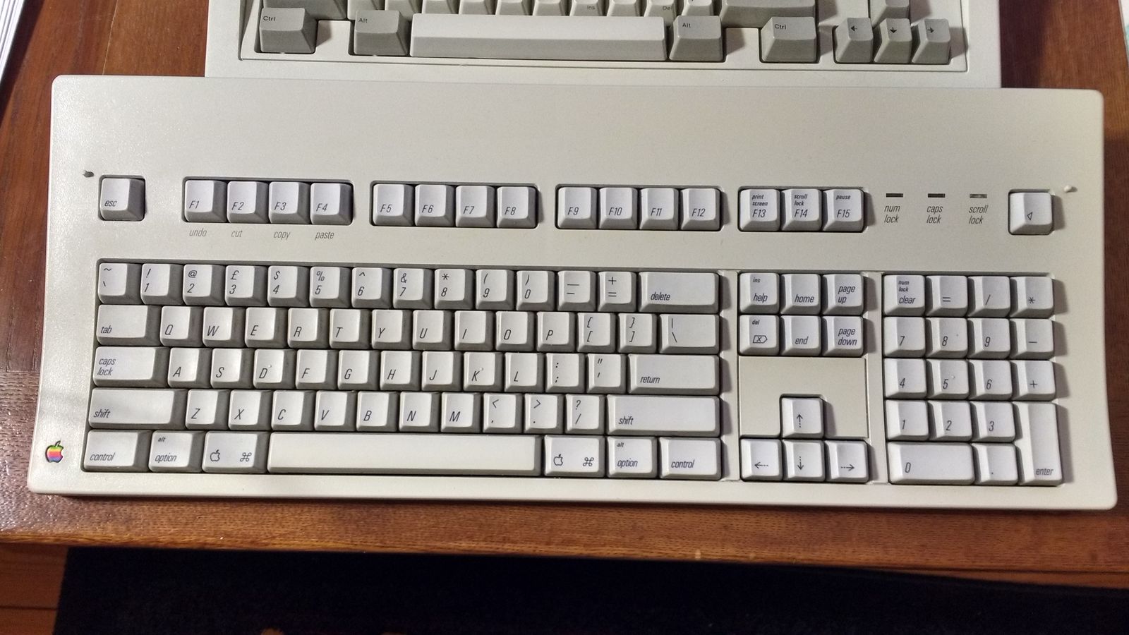

I'm a long time lurker here but I only just recently got an account so I could contribute something back for all the knowledge I gleaned out of reading the posts here.
It might actually be possible to get what you want out of an AEK, but it takes a lot of work. I'm actually typing this on an AEK which I did a lot of stuff on to get it to the point I wanted :
- wax modded most of the switches because I wasn't happy with the scratchiness of some of the sliders
- paper modded more than half the switches to get rid of annoying "double click" effects on them
- lubed all the springs to get rid of spring ping
- used a form of plaster mod on all the keys with stabilisers to get rid of the annoying rattling (yes, there is a sane way to reattach those stabilisers without going crazy)
- retrobrited the hell out of the casing (it was severely yellow when I got it)
I'm using this through a self-built converter using TMK firmware through which I've got the alt and Mac keys remapped so they are swapped because I use this on a windows machine. TMK's firmware should allow you to remap nearly any keys you want.
In terms of modern-day keyboards, I can only comment on Matias keyboards, which use modern day alps clones for switches, as I'm not fond of cherry switch types and their clones. I've got both a Quiet Pro and a Tacticle Pro. The Quiet Pro has damped switches which are sort of similar to an AEK II's cream alps switches, while the Tacticle Pro, despite the name, has clicky switches. Neither comes close to the tactile orange or salmon switches of an AEK.
Others here will probably be able to point you to modern tactile alternatives but if you wish to go in that direction but maybe don't throw in the towel on your AEK so quickly. Vintage keyboards are usually not in the world's best condition and need quite a bit of work to get them right again.

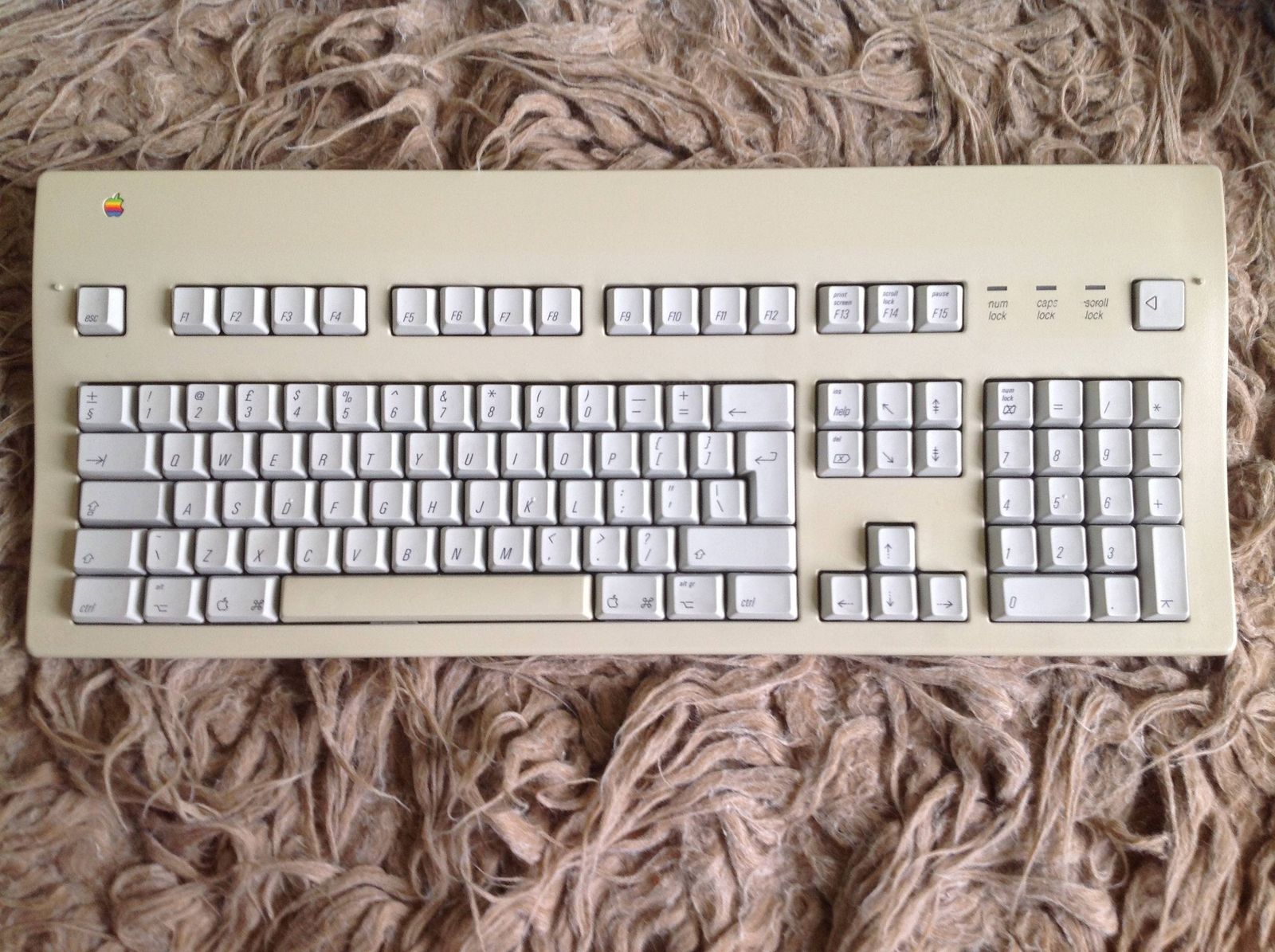

You mean Acer switches like this?
This one was mine. The switches aren't modular like Alps, they're actually just clicker mechanisms over a membrane. The rollover wasn't good—that board would routinely block chorded mods and get in my way, unlike a (consumer) Model M—and I didn't much like the extra crunchy feel. Sold it at some point. Reasonably heavy construction and nice PBT caps though.

Is there a use-case for average people not to have their modifiers merged?
- Muirium
- µ
- DT Pro Member: µ
Correct! In general, there is no functional difference between left and right Shift etc., and the average user would give you a very strange look indeed if you tried to tell them there was!
Now, those of us freaky enough to define our own keyboard combos for things—let alone build keyboards and converters ourselves—can and do make use of the distinct scan-codes for left and right modifiers. My beloved Shift+Shift=Caps Lock macro is just one example. I’m pleased the distinction is real, and I miss it when the occasional *cough* Apple *cough* keyboard denies it.
But then there's Alt Gr, as you've encountered. In ISO: left and right Alt are different. I suspect the need to distinguish that is what led to separate scan-codes for all modifiers.
Re: AEK I. Apple didn't even bother with an ISO version, or printing Alt Gr on the right Option key. Take a look:
By the AEK II, they did remember ISO. But despite remembering the Alt Gr sub-legend on the right, internally the modifiers are merged…
That's not the only goof about the AEKs. See those Num Lock and Scroll Lock LEDs? They indicate states which don't exist on the Mac, so would never light. They seem to have been intended as PC compatible, yet the AEK is of course ADB so couldn't connect to a PC with the use for them.
