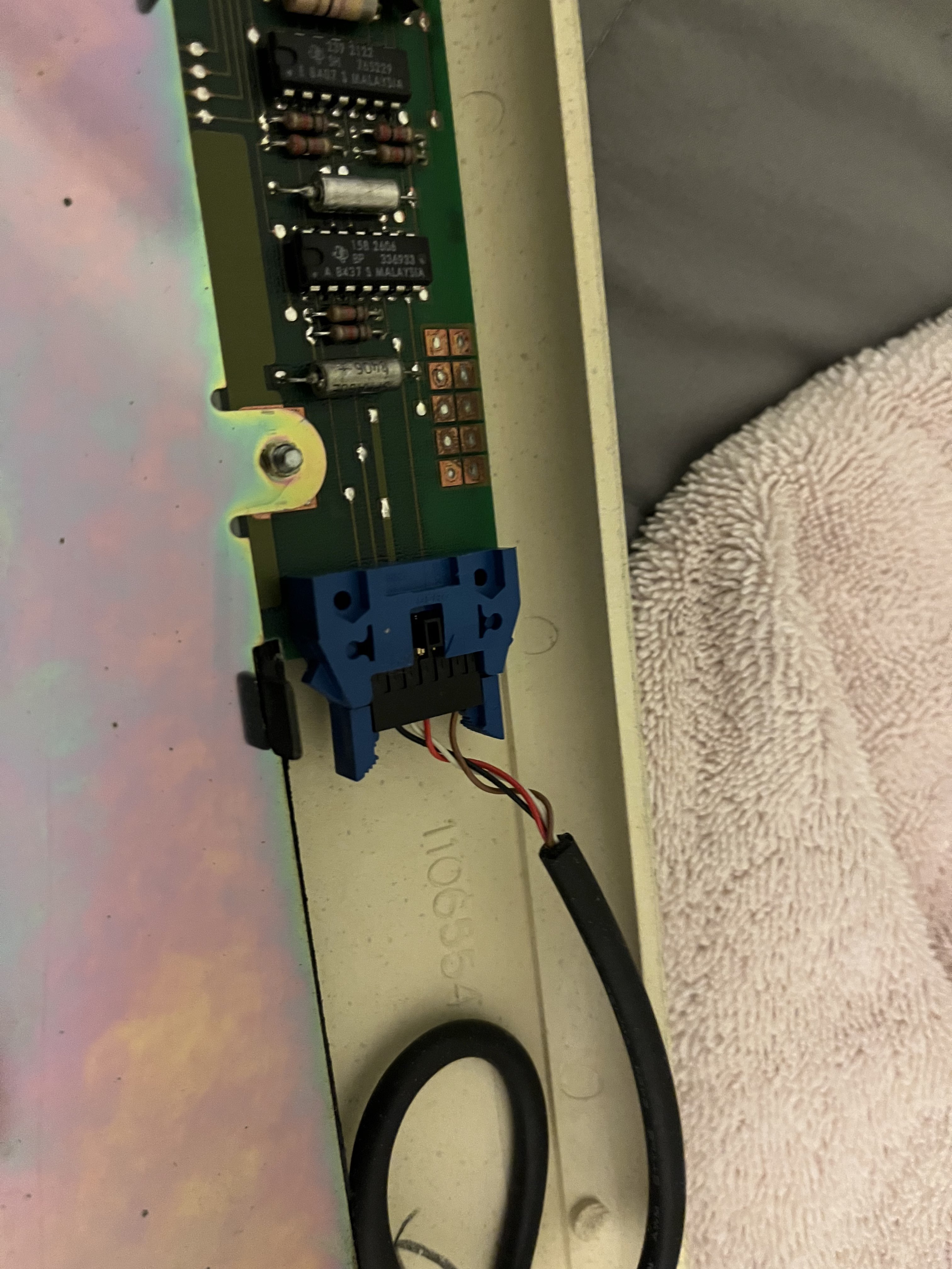

I opened up the keyboard and all the components and wires inside look to be in very good condition (at least to my eye). I'm not very well-versed in electronics, however, and if it is shorted then I am about lost on what to do in order to fix it. Unfortunately, I also do not have a multimeter to test for temperature or conductivity. If you need more photos of the interior, I'd be happy to send them. I appreciate your help.

Barring some physical damage to the cable resulting in a short, there's not a whole lot that can be wrong with the board that would cause the cable to heat up. Give the cable a really close look all over. Look for any signs it was pinched, stretched, or crushed.
If it's not the cable then there's only a handful of PCB components it could be. You can try plugging it in again and then touch the various components and see if any are scalding hot. My bet is one of the capacitors decided to short out (the silver cylinder things).

Indeed. There's nothing dangerous for a human to touch in there—the whole keyboard operates at 5 volts, the only danger to you is hot components—but a short circuit will blow out an active converter. You're lucky you plugged it into a USB port that's willing to give the power without blowing a fuse.
Ageing capacitors are always prime suspects. Lots of pics of them going bad here:
https://en.wikipedia.org/wiki/Capacitor_plague
One of those might have oozed its insides all over the PCB, causing a short. You really need a multimeter to be able to see what's going on electrically.
