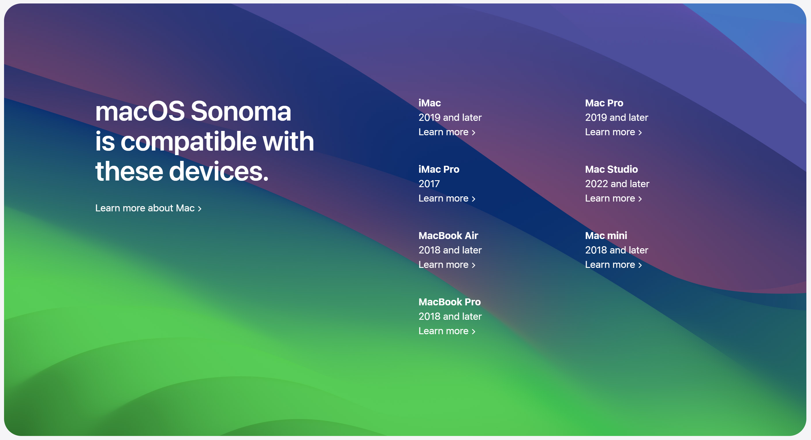

That my particular MacOS copy of the util has neither Apple Silicon binary bits nor Dark Mode support is nobody's fault (least of all pandrew's!) BUT my own.Muirium wrote: 04 Sep 2023, 17:26 A couple of requests, if Pandrew or anyone is able:
- Universal binary to run native on ARM. It's currently x86_64 only, so running in Rosetta. Apple will kill that at some point, as they did with PowerPC
- Dark mode support. Not a biggie, but a nice to have
The absence of both features comes down to me wanting to try to target as wide a swath of supported systems (both hardware- and software/OS-wise) as possible. Though I'm sure most people here are largely interested in using their 40+ year-old keyboards on contemporary machines, there is surely a measurable percentage of people who would also like to be able to use them on legacy/"retro" systems, too. Of course, the USB-adapted 'boards will happily work on just about any host that has a USB port, no matter how old, but also having all of the software tooling needed to make changes or debug problems available to you on the same machine is a nice cherry on top, assuming it's practical to do.
The pandrew util for Windows is already compatible all the way back to Windows 7, released in 2009. On the MacOS side, producing a build of the app that runs perfectly on versions as old as Lion (10.7), released in 2011, ended up being (relatively) straightforward. So that's what I did. (Frankly, because I'm a sick man, I had actually hoped to get this working on Snow Leopard [2009], bringing legacy MacOS support as far back in time as Windows support, but it turned out that this was going to require way more work to accomplish than I was willing to put into it...at least at the time
To support Apple Silicon natively, I'd "just" need to build with at least Xcode 12.x, which only supports targeting as far back as Mavericks (10.9). pandrew wrote his app against the cross-platform Qt 5.x framework, and Qt handles most of the nitty-gritty platform support details for you. If you build against a new enough version of the Qt5 libraries, you get Dark Mode support effectively "for free". And if you use an even newer version still, Qt5 also has official support for being built to run on Apple Silicon. That version of Qt5, though, only supports running on as far back as High Camp (10.13). So building a version of the app that fulfills both requests is absolutely doable, and probably with not that much effort. So perhaps in the future I'll release separate versions for older and newer Macs.
For whatever it's worth, I do sense that Rosetta 2 might be sticking around longer than the original Rosetta...
It was funny to me how, back during the PPC > x86 transition, Apple & Jobs announced a "2-year transition" and (probably to avoid the Osbourne Effect, heh) also that there were still "great PowerPC products in the pipeline yet to be introduced" (Jobs literally said this on stage! Spoiler: they never shipped another single PPC product after this
The ARM64 transition has gone pretty smoothly, but it's clearly taken them longer than they'd hoped to transition the entire product line ("thanks, Covid..."

Notably, Xwhatsit’s Qt based (and strictly Intel only) config software for his controller can’t run on modern Macs at all. Apple is a moving target.
- Location: USA
- Main keyboard: Model M
Well...dadgum. That'll teach me to shoot my mouth off. *
* ...eh, let's be honest: probably not.
EDIT: to be fair, it appears that this, along with a minor Powerbook G4 refresh, was the last PPC Mac to ship, in October, so a couple-three months following WWDC. But that this was before they had yet shipped a single Intel-based Mac. So I guess they did ship a new PPC product following that conference, but they never shipped another PPC product after they introduced the very first Intel model (the Mini in January '06)...every Mac following that was another Intel model. So it's not like they were interleaving Intel and PPC hardware releases together. There was still a pretty clear demarcation line there, release-schedule-wise.

It's not really even a matter of me looking at the past to use as a guide for this instance. I'm looking at what Apple has publicly communicated about their intentions for MacOS Sonoma. This yet-to-be-released version still supports Intel...this part isn't even up for conjecture or dispute. So unless Apple decides to break their very public promise, the software support for Intel continuing on for the next 400ish days is already in the bag.Muirium wrote: 06 Sep 2023, 23:06Something like that. I wouldn’t count antique OS version history as any guide—
Therefore, Intel support might extend further out than one more year, but whether or not that happens, we already know for a fact it is going to be at least one more year. That's all I'm saying.
If this were GH, that statement would probably be true. And likely even for most people here, it's true. But I do get the sense that the DT audience here is made up of a larger cross-section of people who are also at least tangentially interested in "vintage tech" when compared other online keyboarding communities, and I guess that's to be expected given that there is just a plain larger interest in vintage keyboards here relative to elsewhere. After all, right now we are talking to each other in a thread that's largely about reproductions of keyboards that were made in the early 80s and freaking weigh nearly 10 pounds. And even I get a hankerin' on occasion to use my "new" F boards on some of my older machines.Muirium wrote: 06 Sep 2023, 23:06Any Mac user nerdy enough to play with QMK is running current software.
The way I looked at it was, if I can extend the range of base OS compatibility with minimal effort in order to benefit the widest possible set of users, then why not do it? Also, the app we are talking about here is just a debugging/troubleshooting app anyway, where I would argue the "aesthetics" are absolutely secondary to its utility. It's not like we are talking about the Vial app here. (Oh dear, that gives me a very, very sick idea...
Add to all of this that my own collection of Macs only contains machines that are at least a decade old already. So my own options for machines to both build and test on is limited. If I want to test on an Apple Silicon Mac in person, I have to borrow a friend's. My "newest" Mac that I own? Retina MacBook Pro 2012. So...
Like I said, I'll look into building a native aarch64 release. It's just going to take a little time given what I have to work with. I do have a functioning Catalina install on the rMBP, and I believe Xcode 12 (latest version of Xcode that will run on Catalina) is when building for Apple Silicon hardware targets was introduced. But I'm also looking into the available tools (e.g., OpenCore Legacy Patcher) for installing Ventura on a Mac of this vintage.
