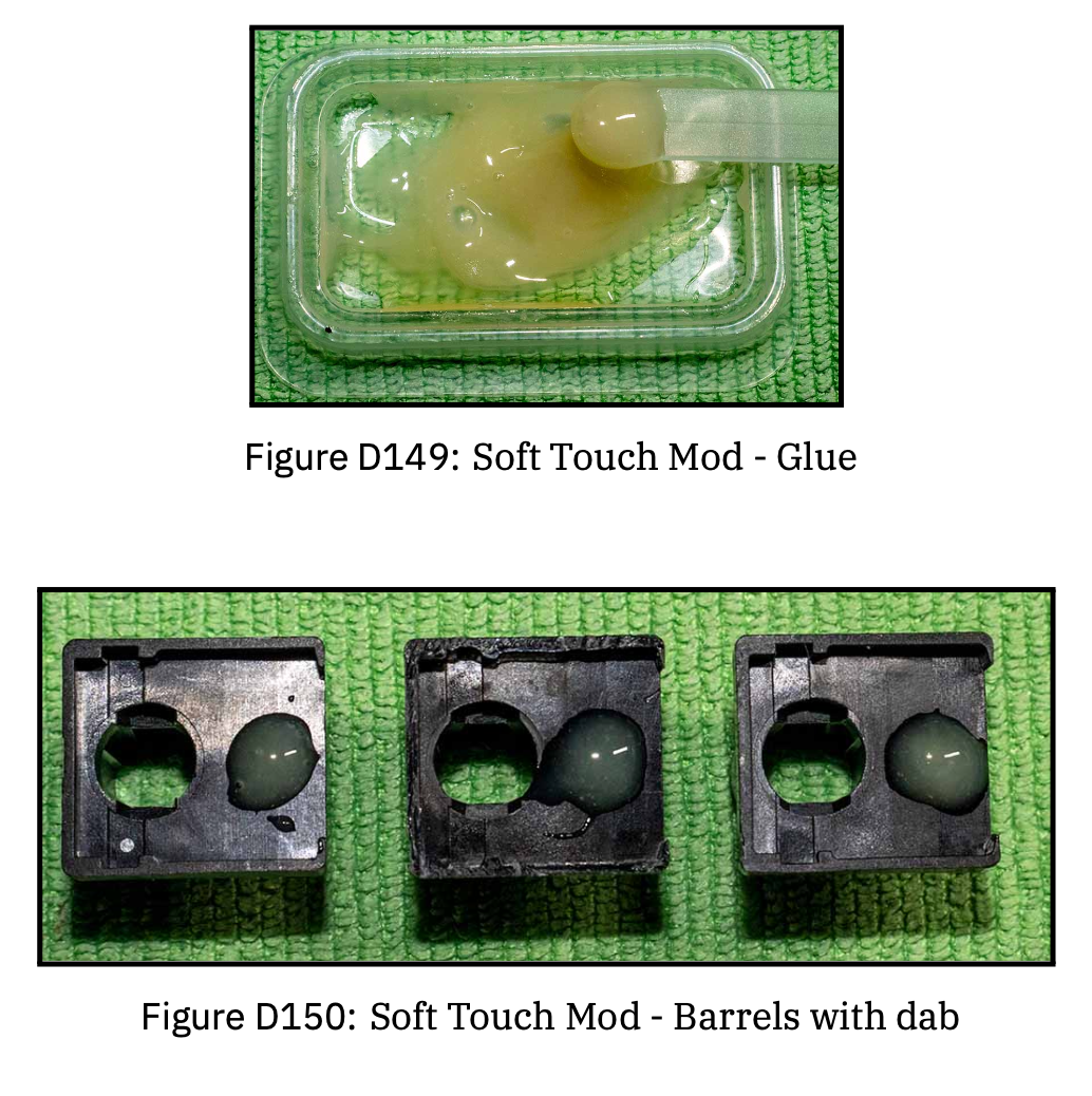

The only thing that comes close to dampening the switches is the soft touch method (find the part of the PDF attached). It is not sounding like the Model M of course, but the shorter travel of the flipper gives it less energy to make noise.
Screen Shot 2022-09-25 at 8.51.14 PM.png (1.17 MiB) Viewed 3329 times
ModelFManual.pdf
(357.35 KiB) Downloaded 122 times

That is a lot more effort than the floss mod.
But it makes me wonder whether something like a small square of black electrical tape might be enough for just a bit of relief.
