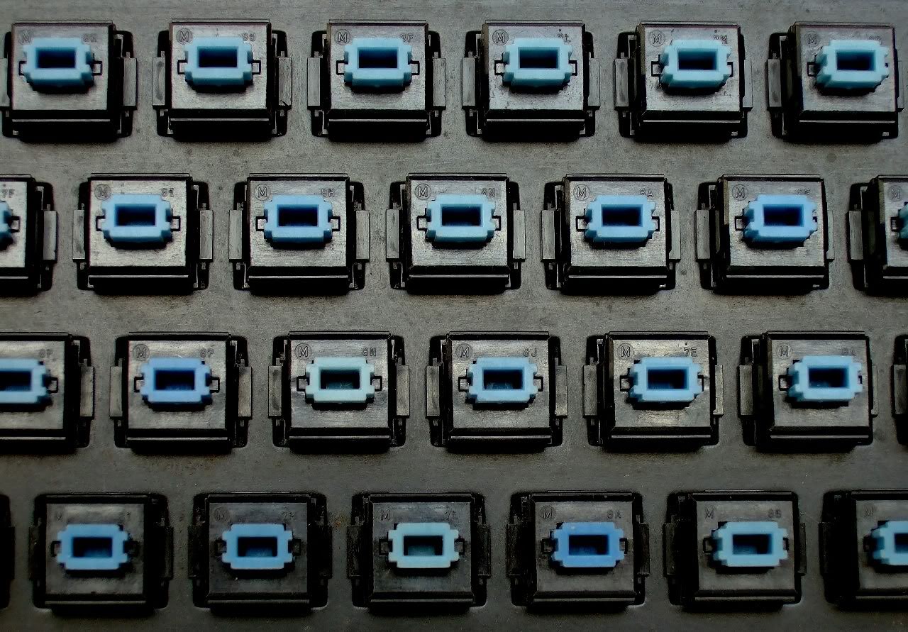

Alps switches have little clips on the side:
Which snap into the plate, like so:
MX is similar. They just click right in. No need for a PCB, structurally speaking; though it saves you a lot of wiring!
