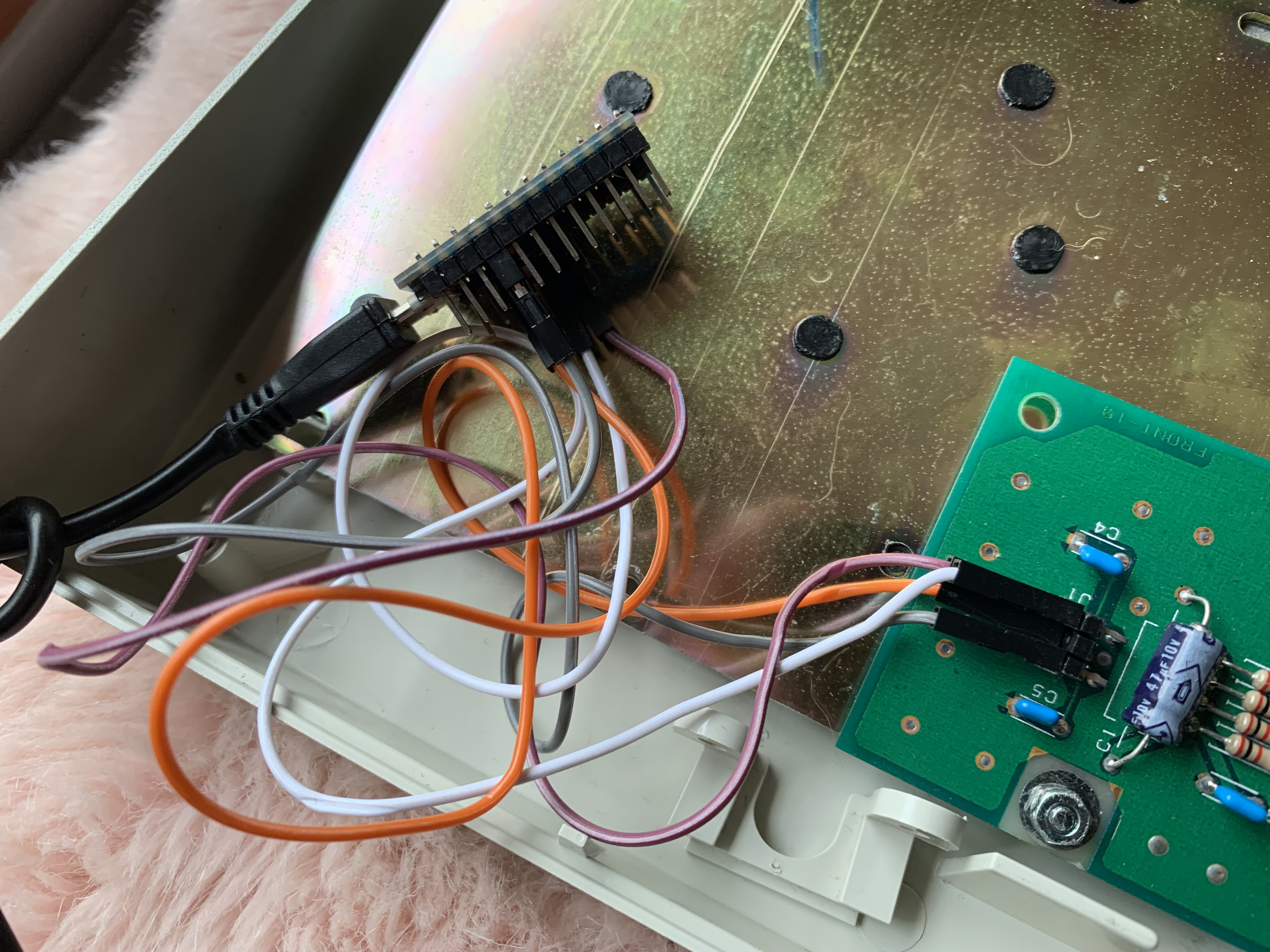

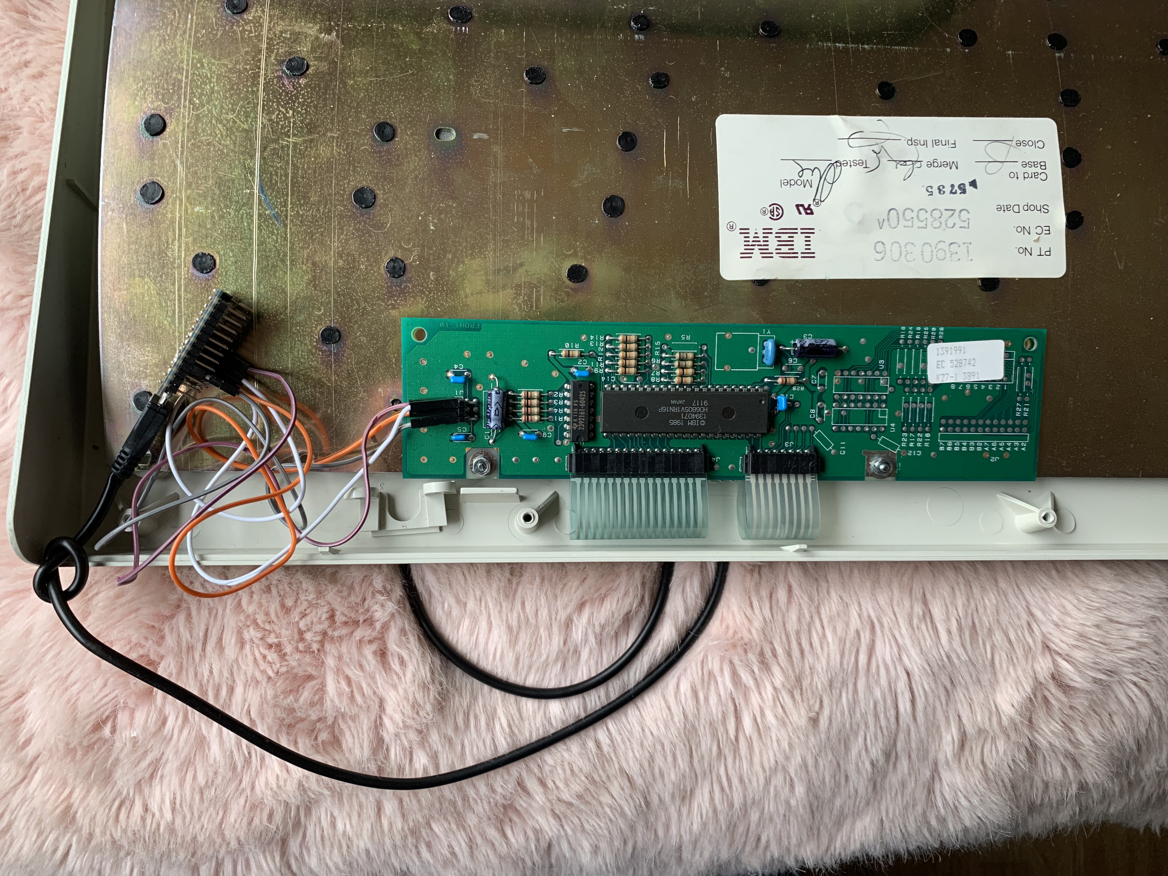

Of course, sorry I should have posted photos - I've attached them here. I don't have the original cable.fohat wrote: 31 Aug 2021, 15:18 Without a proper description of the problem and/or a picture it is very hard to make suggestions.
Specifically, what original parts, if any, were removed? We have to know the starting point to formulate a path forward.
When I opened it to see what the problem was, I saw that the pins of that little board were just sat on top of and touching the metal base so I thought that could have been the problem. But when I put the keyboard back together with insulation around the board & pins, the problem was still there. Now it's not working at all. I'm just looking for the easiest, most reliable solution.
- IMG_0259.JPG (3.32 MiB) Viewed 2572 times
- IMG_0257.JPG (4.01 MiB) Viewed 2572 times

Nice backplate- shit converter. Those Dupont connectors aren't great for permanent installations, especially if cheap ones are used because they lose their grip.
If it were ME (because I like keeping keyboards as original as possible) - I would order a replacement fixed cable from Unicomp and make a new inline converter using Hasu's TMK ibmpc_usb firmware and a Pro M1cro. Since you want to have an easy solution and would pay more, you could order the cable from Unicomp and order a fully-made converter from Hasu. Then everything will be external from your board and easier to access/reprogram.

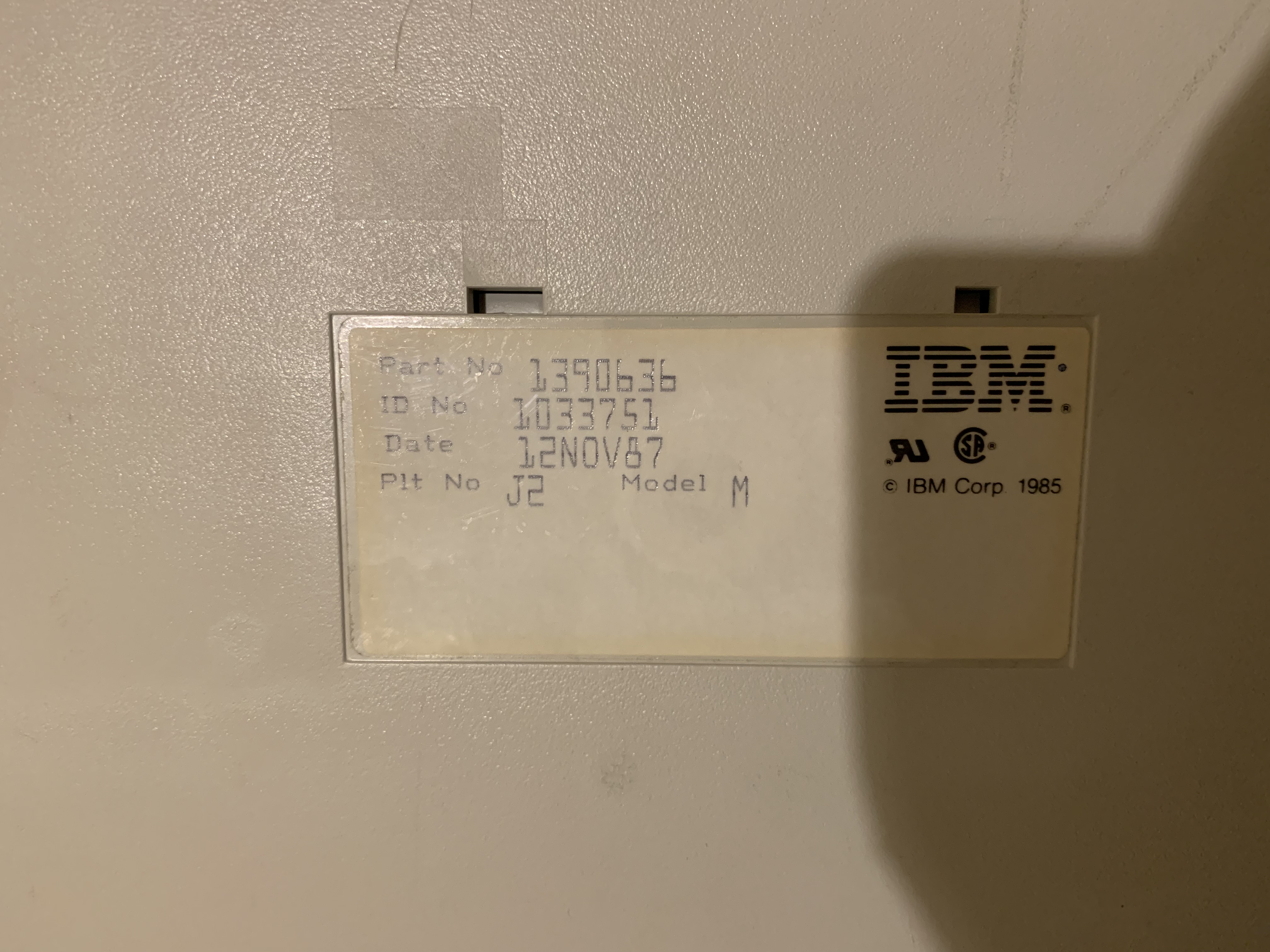

What's the model number on your case bottom? I was trying to look up which cable (5-pin DIN or PS/2) your keyboard originally came with but the number on your plate sticker isn't in the DB.

Looked it up, that came with an 8P8C connector (many call it an RJ45 but it is not) cable.
Fortunately there are converters available for them. Not too expensive.
