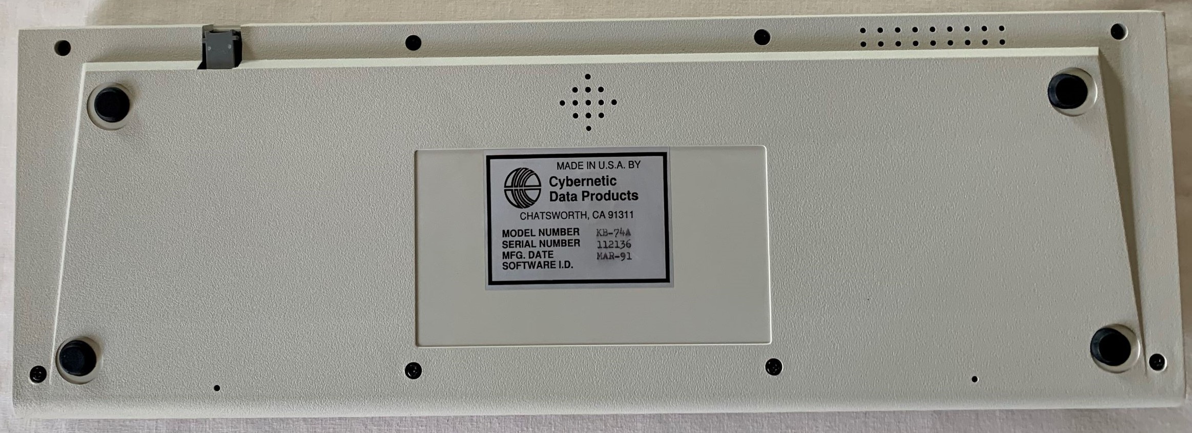

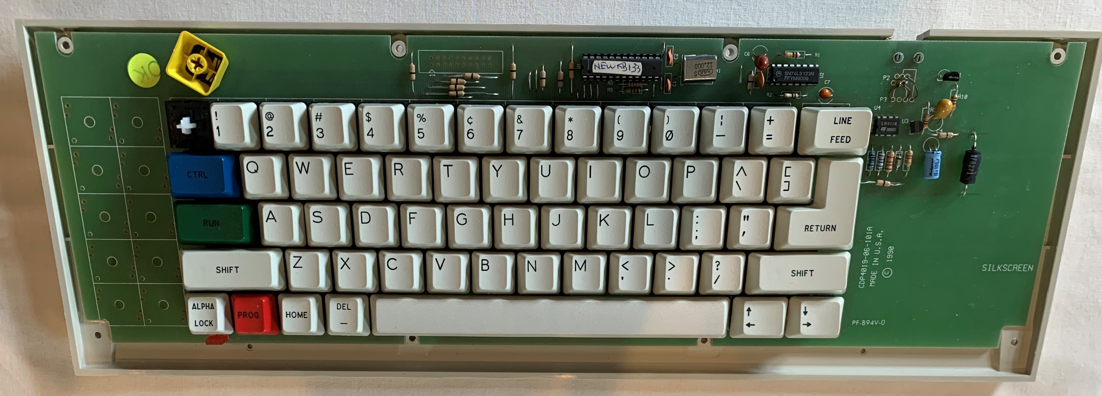

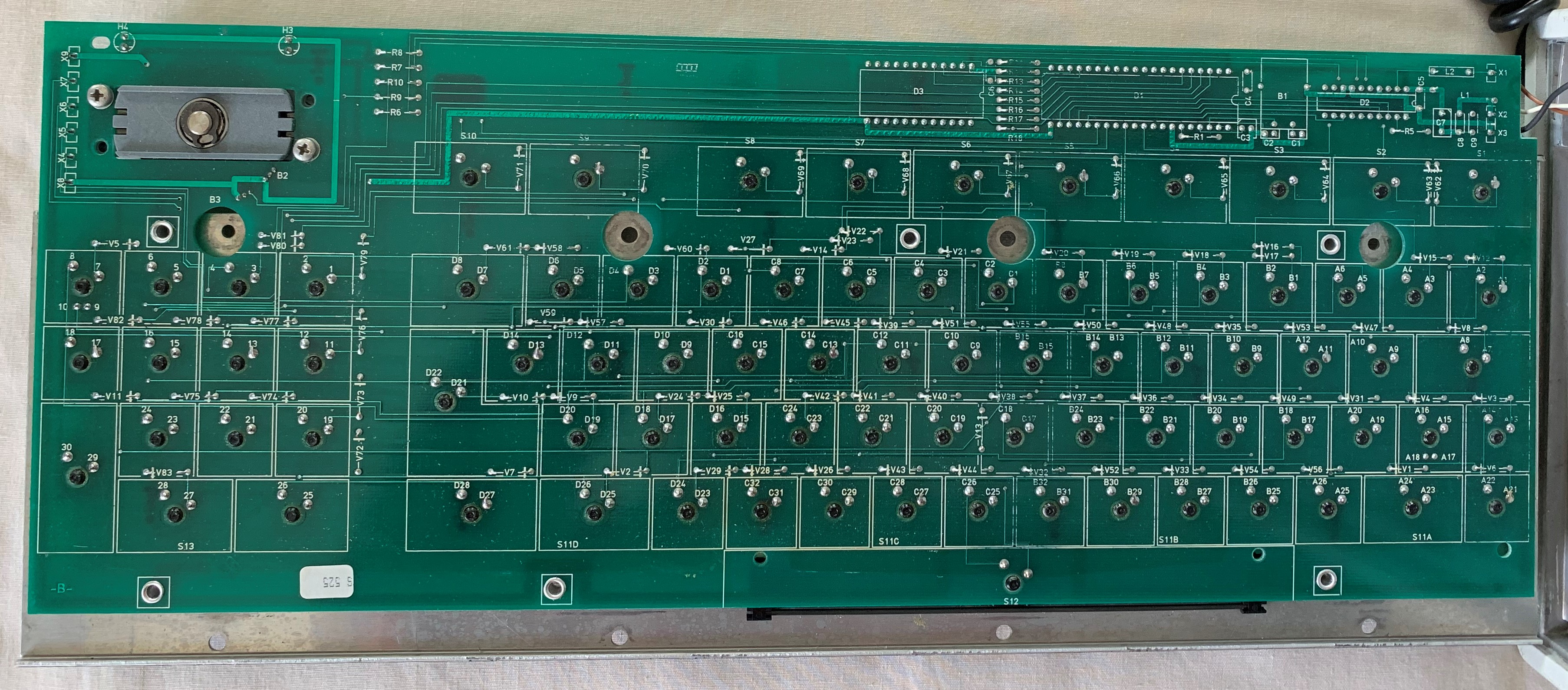

This is KB-74 from Cybernetic Data Products, used with the SilentRadio.
It connected to the sign with an RJ 4P4C. The PCB shows that only three of the signals are connected. The case cutout for the connector looks like it was done by hand with a rotary tool. And there's a ferrite bobbin bodged on.
There is a 5V regulator, so the input voltage can be anything in the 9-30V range. Interestingly, the controller is a Philips 87C751. The scan circuitry has a one-shot and a voltage comparator, which suggests some kind of key sense rather than a straight on-off switch. This seems to also be confirmed by the switches having more than two connectors.

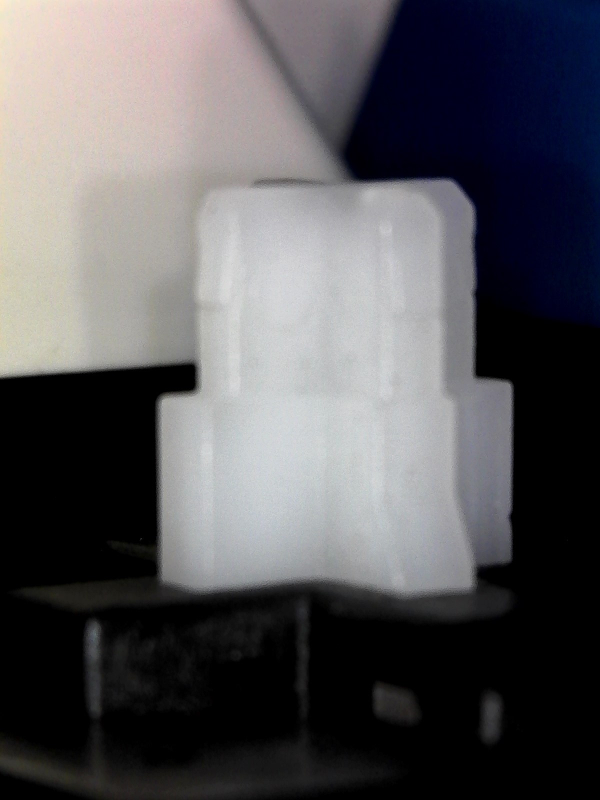

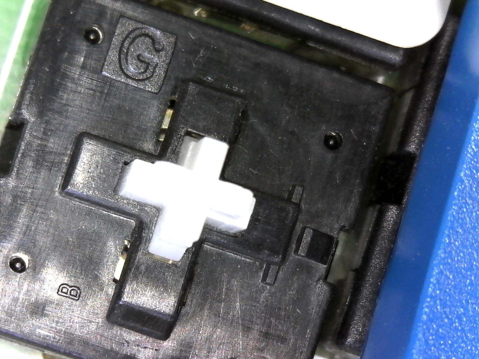

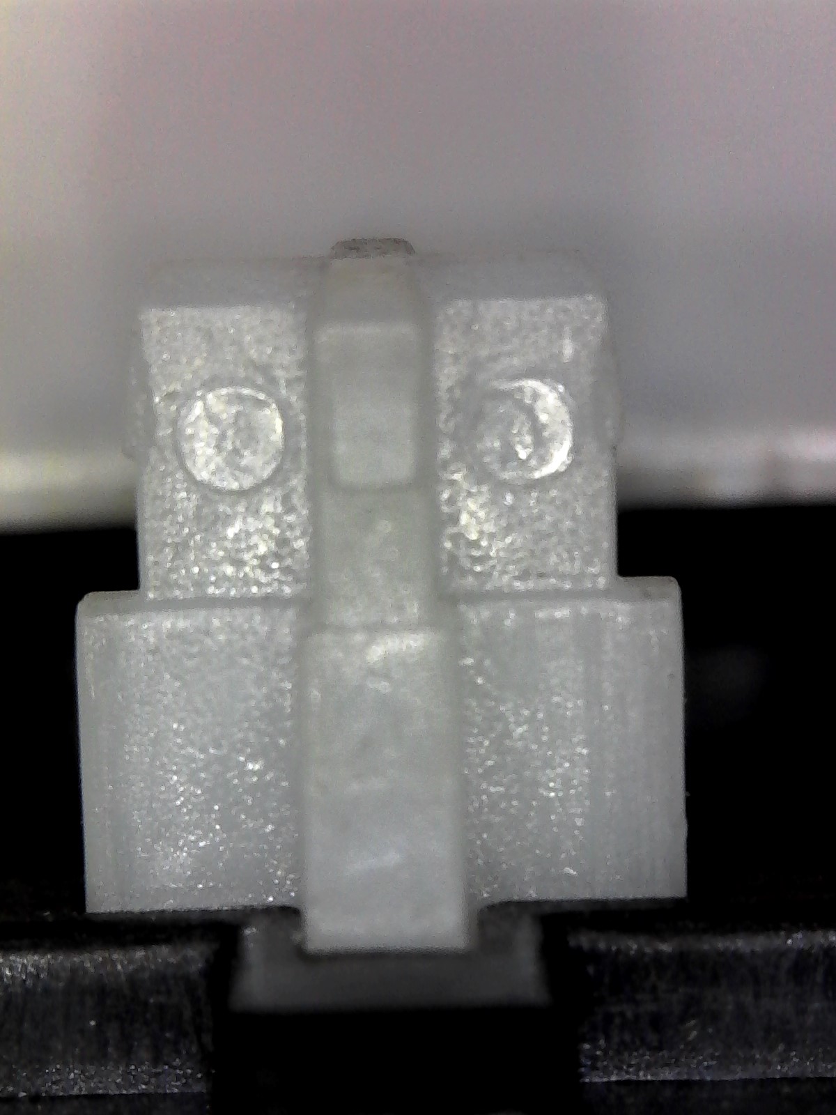

I don't recognize the make of these switches from the housing or the stem. As might be expected, though, with only one data line, it's serial ASCII at 5V TTL level. Alpha Lock happens locally. But the scope shows that it's idle low.

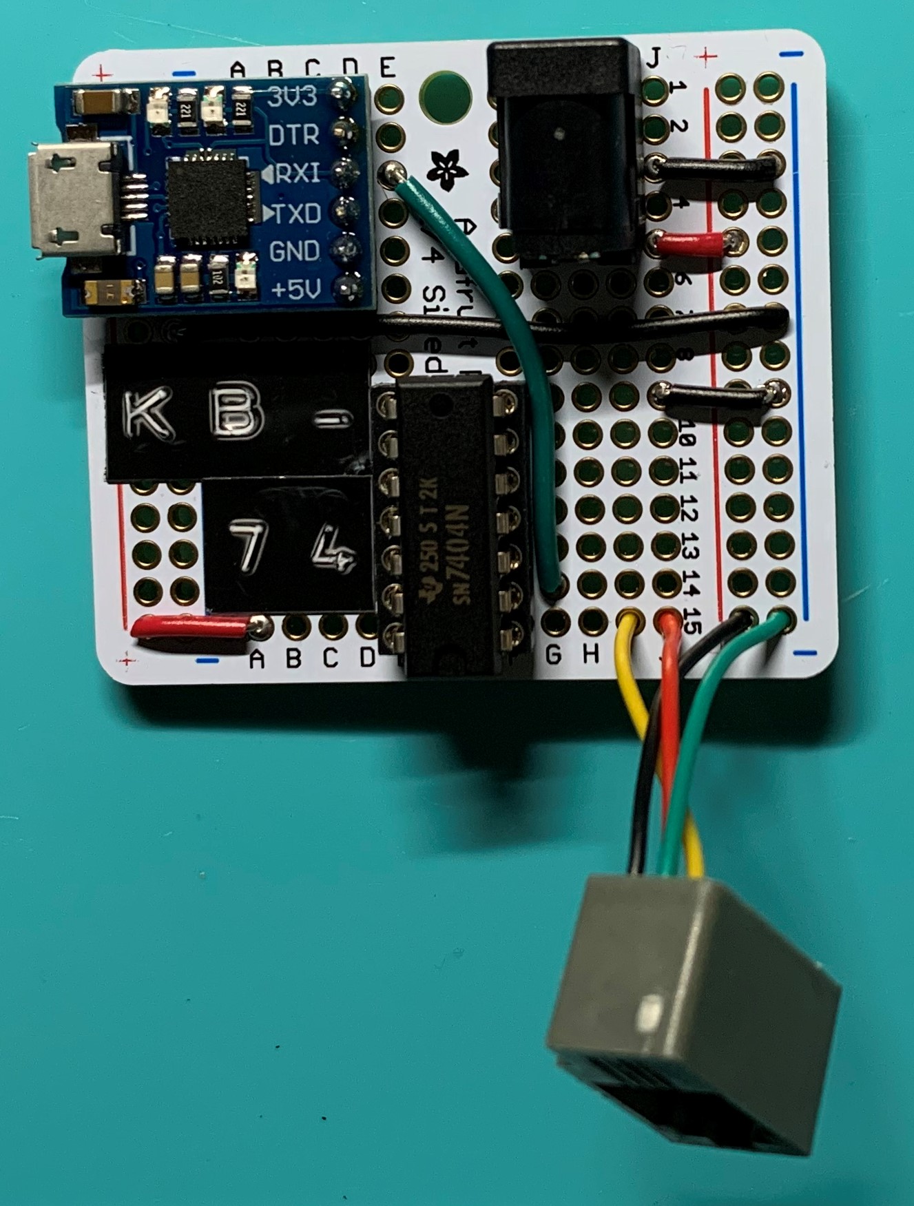

For the converter, when it's serial ASCII already, the default is to use a cp2102. But what about the inverted polarity? I could use a 5V tolerant ARM Cortex microcontroller whose UART can handle it. But there's no real software needed. So, instead I dug around in the parts drawer and pulled out a 74-series inverter and hacked this up.

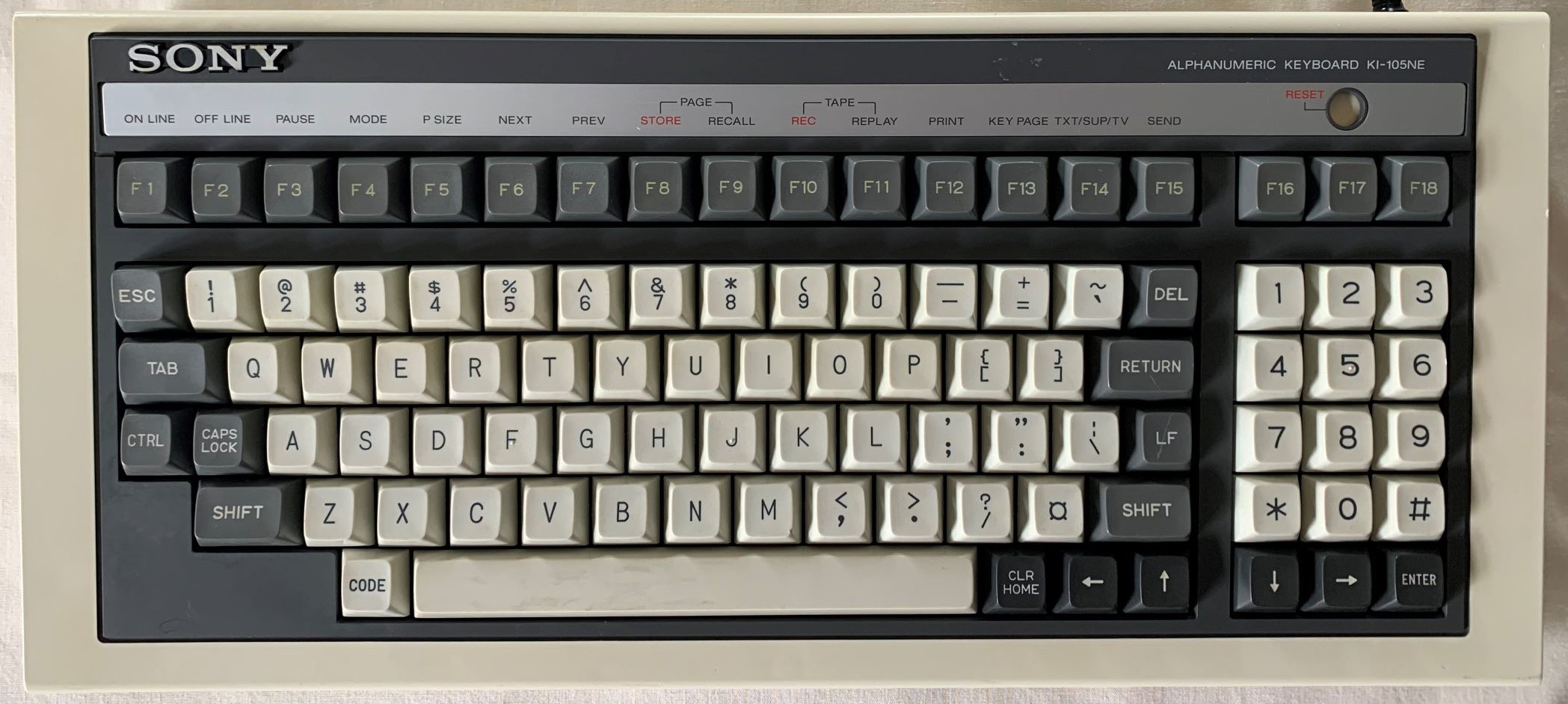

A Sony KI-105NE.
A nice looking medium-sized keyboard from the mid-80s. It's hard to capture in a photo, but the eighteen F keys are pale green on gray. The telephone-style numpad is simple. I imagine the arrow placement takes some getting used to.

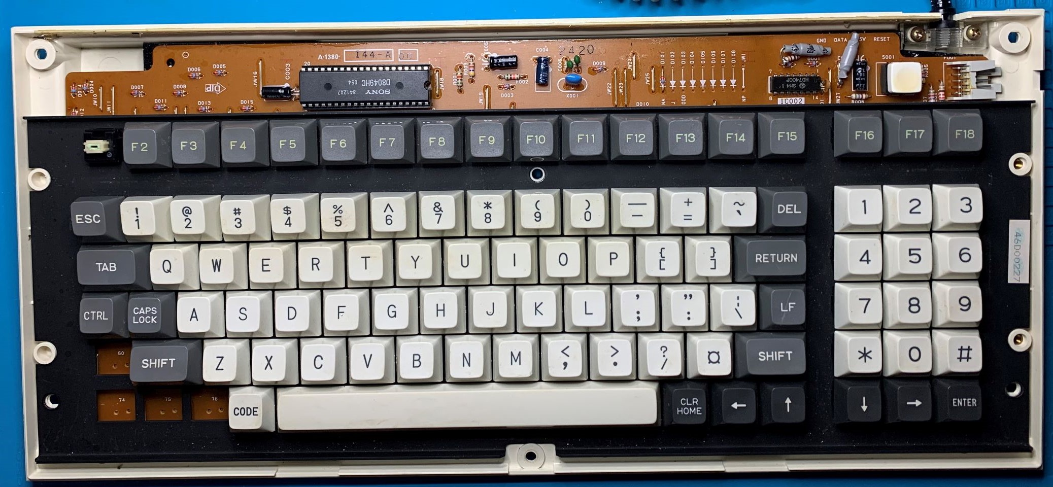

It has Alps switches and an MCS-48 controller. There is no voltage regulator: it takes 5VDC straight from the computer. No LEDs or other requirement for communication to the keyboard.

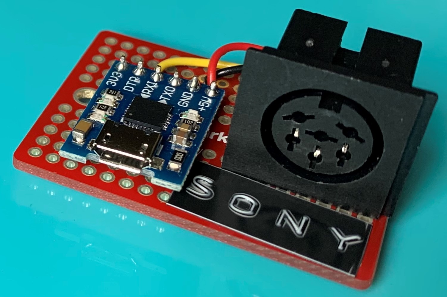

The DIN-6 connector gave some faint hope that it would be a protocol that could be turned into a USB keyboard. Turns out there are only 5 connections (position is 4 not connected). And only 4 signals (1 and 6 are both ground). And the extra one is for the RESET button.
In the end, the DATA line is just 1200 baud ASCII. So not worth an MCU as opposed to a TTL-to-USB serial converter. The recessed RESET button, which would have allowed using a Pro Micro or other board without one of its own, doesn't do anything in this configuration.
The currency key sends $ on this board. I imagine a slightly different ROM would give £ or ¥.
The non-ASCII function keys send codes with the eighth bit set. Some change with each shift: A is 61, SHIFT-A 41, CODE-A E1, SHIFT-CODE-A also 61, CTRL-A (and CTRL-SHIFT-A) 01, CTRL-CODE-A (and CTRL-SHIFT-CODE-A) 81. Some do not change: LEFT, RIGHT, DOWN, UP, ENTER are 88, 89, 8A, 8B, 8D. Some respect some shifts: CLR/HOME is 9E, SHIFT- or CTRL- is 8C. Number 0-9 are B0-B9, CTRL- 90-99. * # are AA, A3, CTRL- 9A, 9B. There is evidently some attempt to avoid collisions. F1-F16 are E0-EF. SHIFT-F1-F16 are F0-FF. CTRL-F1-F8 are 80-88, and CTRL-F15-F16 8E-8F. But CTRL-F9 is 8F, CTRL-F10 9C, CTRL-F11 9D, CTRL-F12 9F, CTRL-F13 EF, CTRL-F14 FF. Then F17, F18 are 9C, 9D, SHIFT- and CTRL- 9E, 9F. So F17 and CTRL-F10 are the same. Or CTRL-CODE-A and CTRL-F2. In short, yet another reason why it would be hard to reverse into a keyboard.
