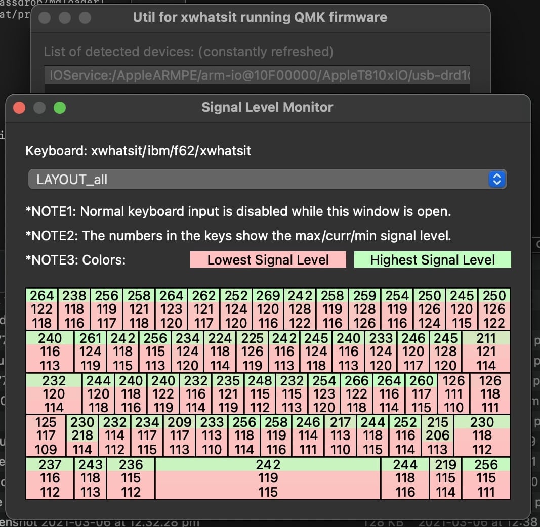

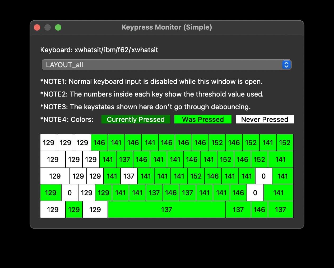

So, here I am, having just followed those instructions myself with my Xwhatsit powered AT. Built my own firmware using the interface within. So far so good!
I didn't need to open the keyboard up—or find an older Mac to run Xwhatit's old GUI on—just to enter the bootloader for flashing. Simply using XMIT's build of the config tool and QMK Toolbox has me all set. Impressive work!
One weird thing is the Caps Lock LED is lighting up momentarily on every keypress, which feels even more oldschool than this AT! Those LEDs were working fine with Xwhatsit's firmware immediately before I reflashed to this, so it's not a wiring issue.

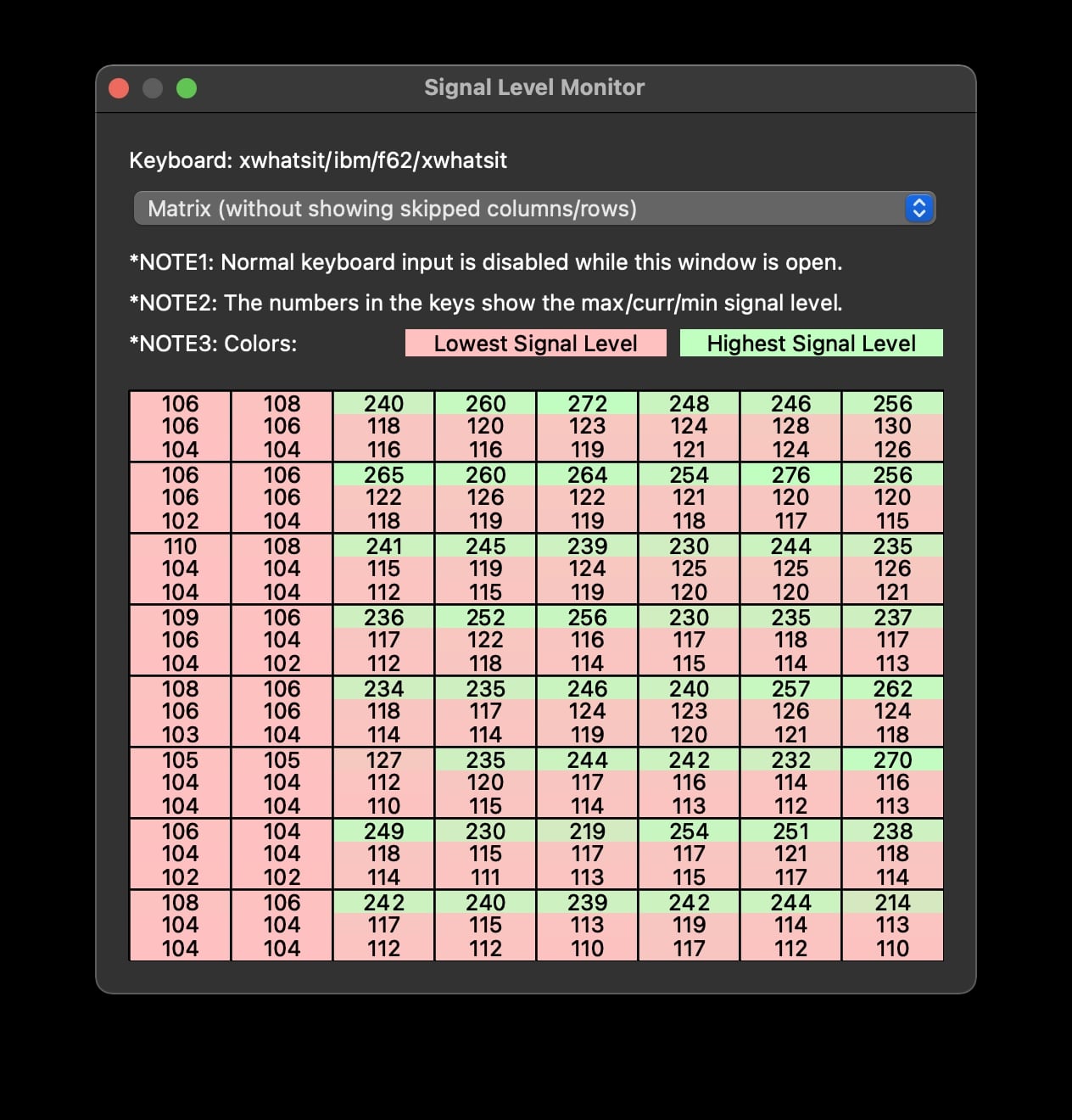

Ahem. The Kishsaver's going to need more work. The firmware loads fine but all the keymappings are wrong. This is what the key tester looks like once I've thoroughly mashed the keyboard: It's a basic matrix mapping issue in the LAYOUT_ansi_regular_shift_split_backspace definition. All the keys seem to trigger something in the levels test, shown here after a comprehensive mashing: For what it's worth: my Kishsaver actually has Xwhatsit's prototype Model F controller installed. He sent it to me for testing before the rev.1 production run. Maybe the pins are mapped differently? It is a bit smaller than the final model, as I recall. I wonder how I'll fix it in software…
Here's my Xwhatsit config file, showing the correct matrix mapping:
Note those column skips! The Kish definitely skips many of them, but not contiguously. By my count that's 9 pins in use for its columns. More than the Signal Level Monitor shows, in its f62/xwhatsit setup. I bet that definition is what needs tweaked.
Anyway, these new tools are pretty nifty! Love seeing the capsense stuff running in realtime.
- Location: Romania
You're the first original F62 kishsaver tester for my firmware. I wrote the original kishsaver keymap based on a picture from kishy.ca ( http://kishy.ca/?attachment_id=951 ), And it's not 100% clear, but looking at it again now it does look like the first two columns are skipped. (first two are in the middle of the ribbon cable next to the two ground pins). I missed this while first implementing the keyboard.Muirium wrote: 13 Mar 2021, 12:46 Note those column skips! The Kish definitely skips many of them, but not contiguously. By my count that's 9 pins in use for its columns. More than the Signal Level Monitor shows, in its f62/xwhatsit setup. I bet that definition is what needs tweaked.
I pushed fixes, please try again.
Btw the extra column (on the left of the picture) is calibration pads, which I don't use. So effectively there are only 8 useful columns.
My intent was to support solenoid drivers by default, that's why it's behaving like that. Normally I would say that you have to build from sources to achieve the old behaviour, but you're not the first one complaining about this, so I just created, Just for the AT, "wcass_locklights" and "xwhatsit_locklights" variants of the firmware. Please test them. You will need new util.exe for these.Muirium wrote: 13 Mar 2021, 12:46 One weird thing is the Caps Lock LED is lighting up momentarily on every keypress, which feels even more oldschool than this AT! Those LEDs were working fine with Xwhatsit's firmware immediately before I reflashed to this, so it's not a wiring issue.
Just to clarify: The Ibm capsense util that comes with the original xwhatsit firmware will only work with original xwhatsit firmware. It is not expected to be able to send the keyboard into bootloader mode with that ibm capsense util.swedishpiehole wrote: 02 Mar 2021, 18:33 I tried to enter bootloader mode using the capsense util, it just won't work.
There are many ways to send a QMK-sporting keyboard into bootloader mode, the easiest is pressing leftshift-rightshift-B.
It's also possible to send it into bootloader mode with MY util (not ibm capsense util), but that particular feature might go away once my work is upstreamed. (for security reasons, see automated malware could flash badusb firmware onto your keyboard if this feature is supported. So having bootloader entry controlled from the host is technically a security flaw. )

Oooh! Thanks Pandrew!
I just rebuilt my Kishsaver map on your new configurator, and it's getting there. All keys in the matrix now show up, but several are still in the wrong spots. The ASDF and ZXCV rows both need some work, and Left Shift and Return keys are like this:
Left Shift is showing up in the hidden pad under that key, while Return is showing up in the hidden pad under Right Shift.
Here's the jiggled keys:
S is mapped to X
D to F
F to D
G to H
H to G
J to K
K to J
L to ;
; to L
' to /
X to S
/ to '
Flip those around and it's looking mighty fine!
Oh: none of these alpha key presses show up outside of (XMIT's Mac build of) your tools. I know they block the keyboard when running in monitor mode but this is also true when they're closed. Yet pressing Command + Tab works just fine for app switching. I don't know what that's all about.
Edit: oh, they do all work *before* running the tools. But they're all disabled after quitting, including Cmd+Tab. Huh… I probably need a new build to match these firmwares.
