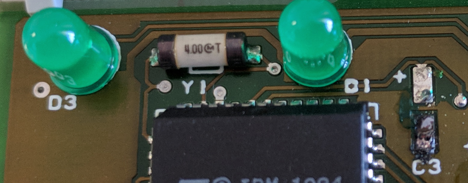

I think Y1 is the clock crystal but it could be another capacitor (like those "Y capacitors" you find inside PC power supplies on the socket connector)

Hi all,
Has anyone figured out what that Y1 is?
I have successfully repaired two of these M2's but my third one needs something more than a recap.
The board looks fine but Y1 is corroded.

Thank bro, that's useful
How did you figure out it's the crystal oscillator pins? I tried to find the data sheet for the IC but couldn't find it.
You have it? Please share
I thought I'd try to swap it with one from my working boards to test it. but those bastards have three pins.
I guess i'll bring out the scope

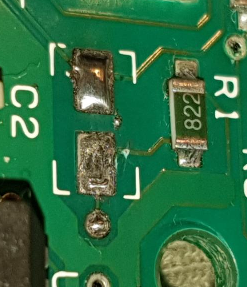

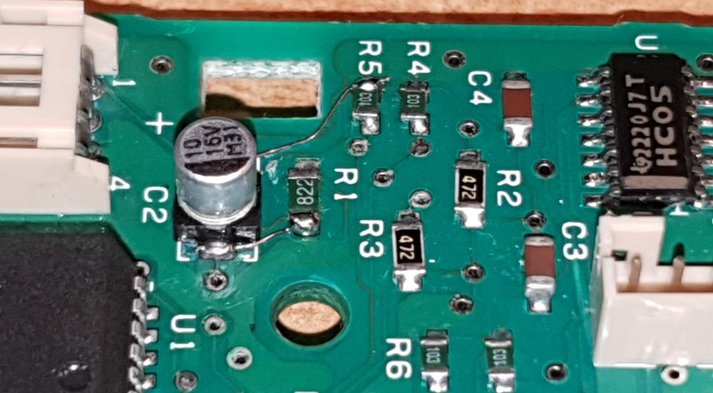

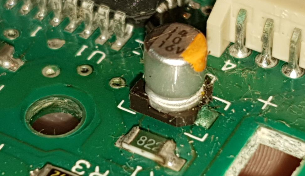

I repaired an M5-2 trackball controller, which had the exact same problem as the M2s do, and it's using the same style of capacitor, on what I presume again is a reset line. However it was much worse, the capacitor has leaked it's electrolyte, leaving corrosion, and eating up some traces. I ended up having to add two jumper wires for it to work, after cleaning up all the corrosion (so it doesn't spread).
See some pictures of the M5-2 repair, expand the spoilers here:
And double-check that you have about 5V between Vcc and Vss pins of the microcontroller, and that the ~RESET pin is high ( about 5V. 1.1V on the reset line would not be enough. Crystal is a different story, could have a special driver. For the crystal you should only make sure that there's continuity between chip pins and crystal pins)
No matter what you do make sure that you clean up any corrosion that you see. Replace all corroded solder joints, and clean up the board after with alcohol, or it might spread.

I managed to fix my M2!
It was the corroded crystal that caused my board to fail.
I tried to replace it with a generic 4Mhz SMD crystal but it was to wide for the board.
I could have bodged it but ended up using a though hole crystal standing on top of the board with bent legs instead.
Hope this is helpful for anyone passing through here with the same problem.
PS. The caps are still the most common problem with the M2.
Replace the caps first. In this case the electrolyte from the leaky caps probably killed my original crystal.
