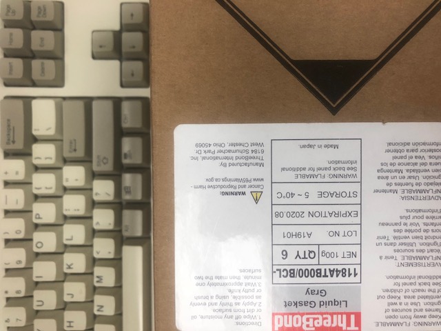

Heads up on eta, if he can get these products it will likely take 1 to 4 months to arrive. Just to prove I am not an interweeb liar with no 3B dealings here is some trans seal from my last request.
- 3b stash.jpg (80.63 KiB) Viewed 12456 times
