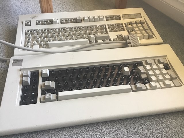

If anyone is having issues with a rattly or shrill spacebar, try putting thin adhesive neoprene under the stabiliser wire next to the tabs on the barrel frame. This has made the spacebar quieter and more solid, without making it mushy. For some reason after disassembling the keyboard, the spacebar doesn't sound as massive or firm as it did before.

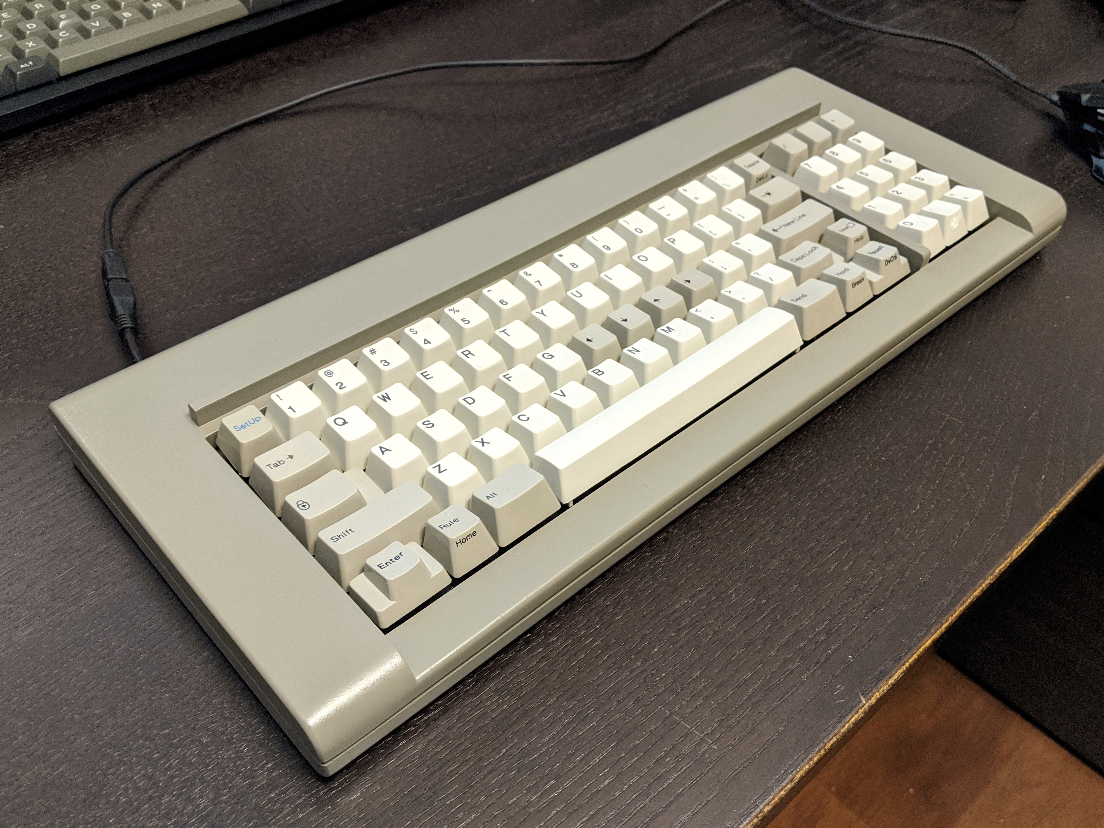

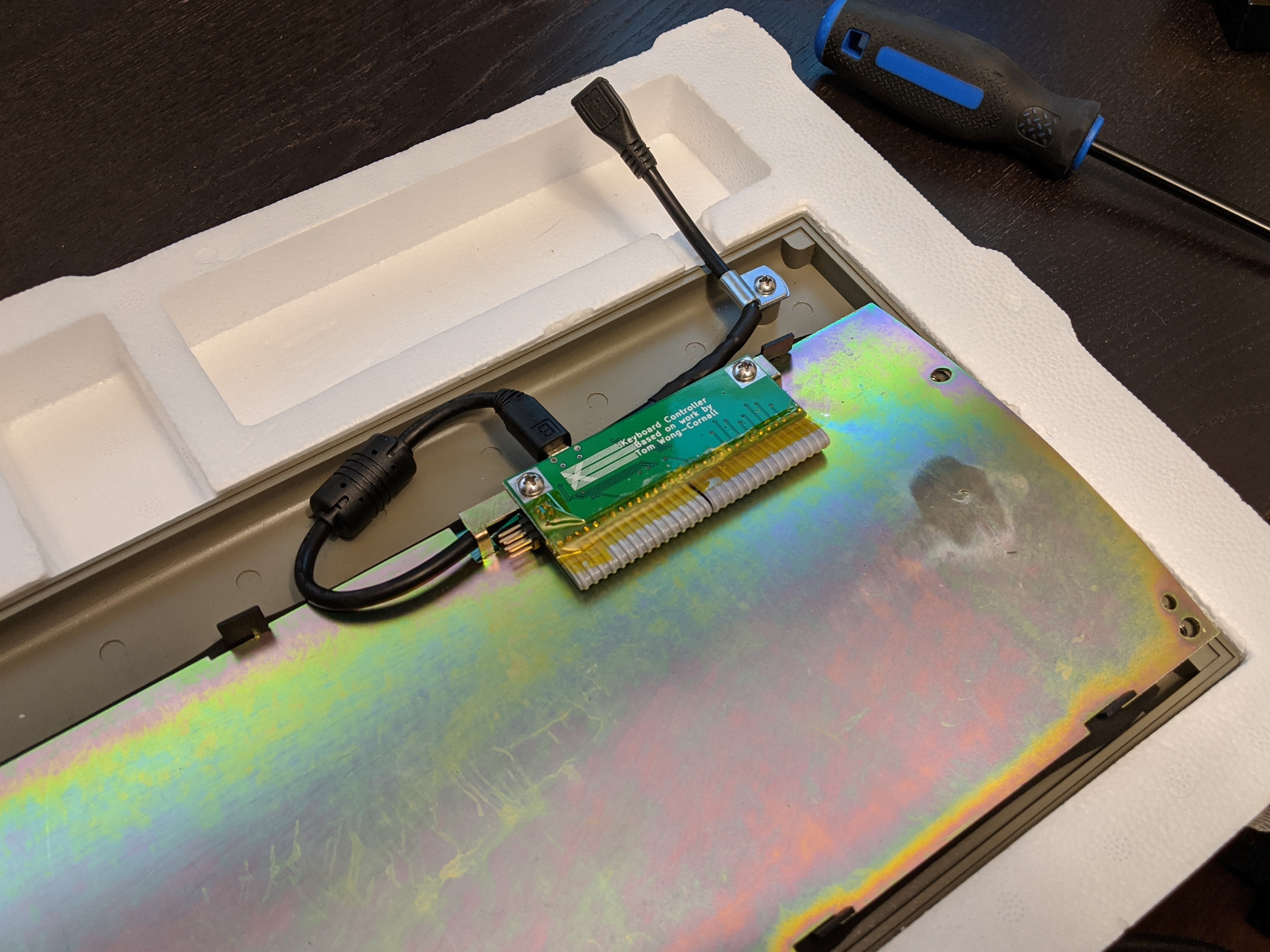

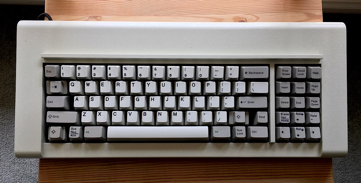

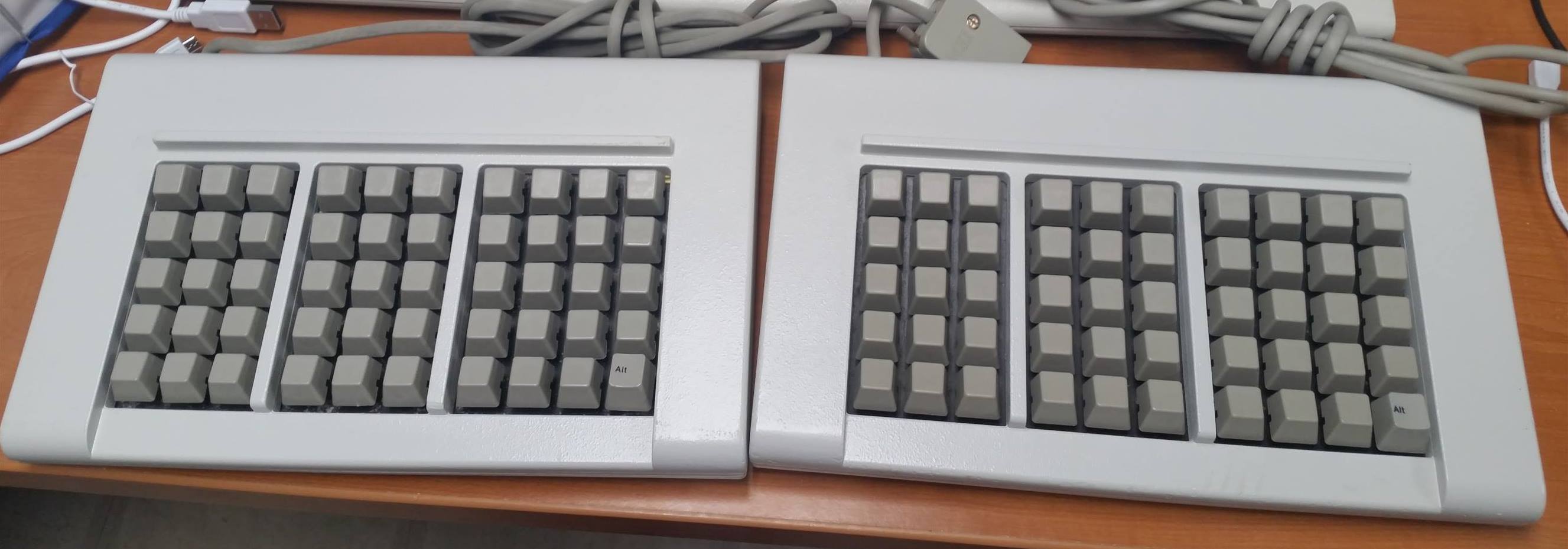

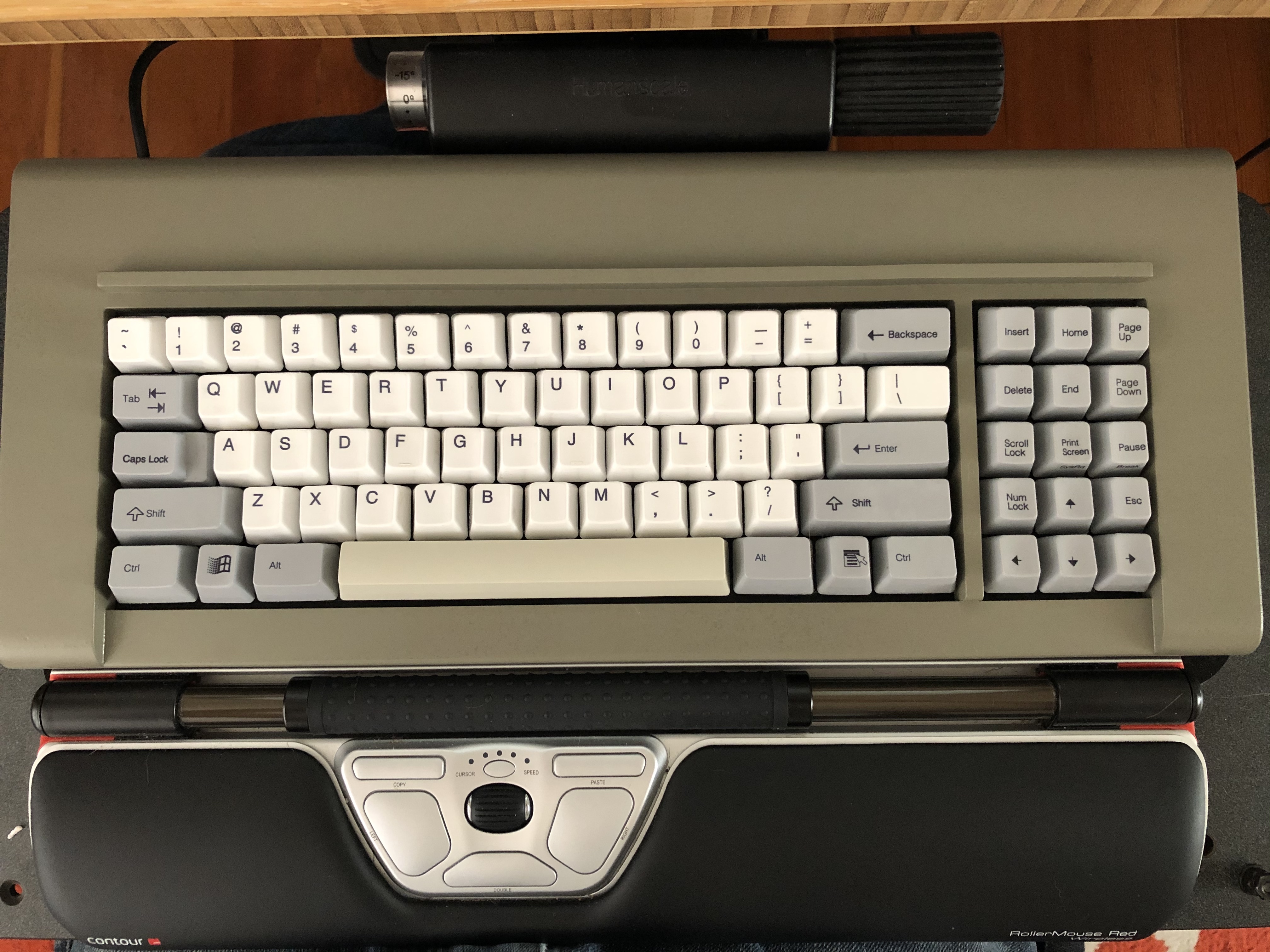

Got my F77 working with the QMK beta a couple weeks ago. Had some initial issues with keys not working and random keystrokes on the original xwhatsit firmware, but that all cleared up after switching to QMK. So big thanks to pandrew for his work on that.
Here are some pictures for anyone interested. All keycaps were taken from Model Ms. Also made a very minor mod to make the USB cable detachable.

I actually went and tried this on a different Model F and indeed it eliminated the rattling from my spacebar, but it also made it feel noticeably stiffer, so I am not sure if I like it. Curious if the neoprene sheet I have is too thick (1/16 in). What thickness were you using?Wazrach wrote: 04 Sep 2020, 12:26 If anyone is having issues with a rattly or shrill spacebar, try putting thin adhesive neoprene under the stabiliser wire next to the tabs on the barrel frame. This has made the spacebar quieter and more solid, without making it mushy. For some reason after disassembling the keyboard, the spacebar doesn't sound as massive or firm as it did before.

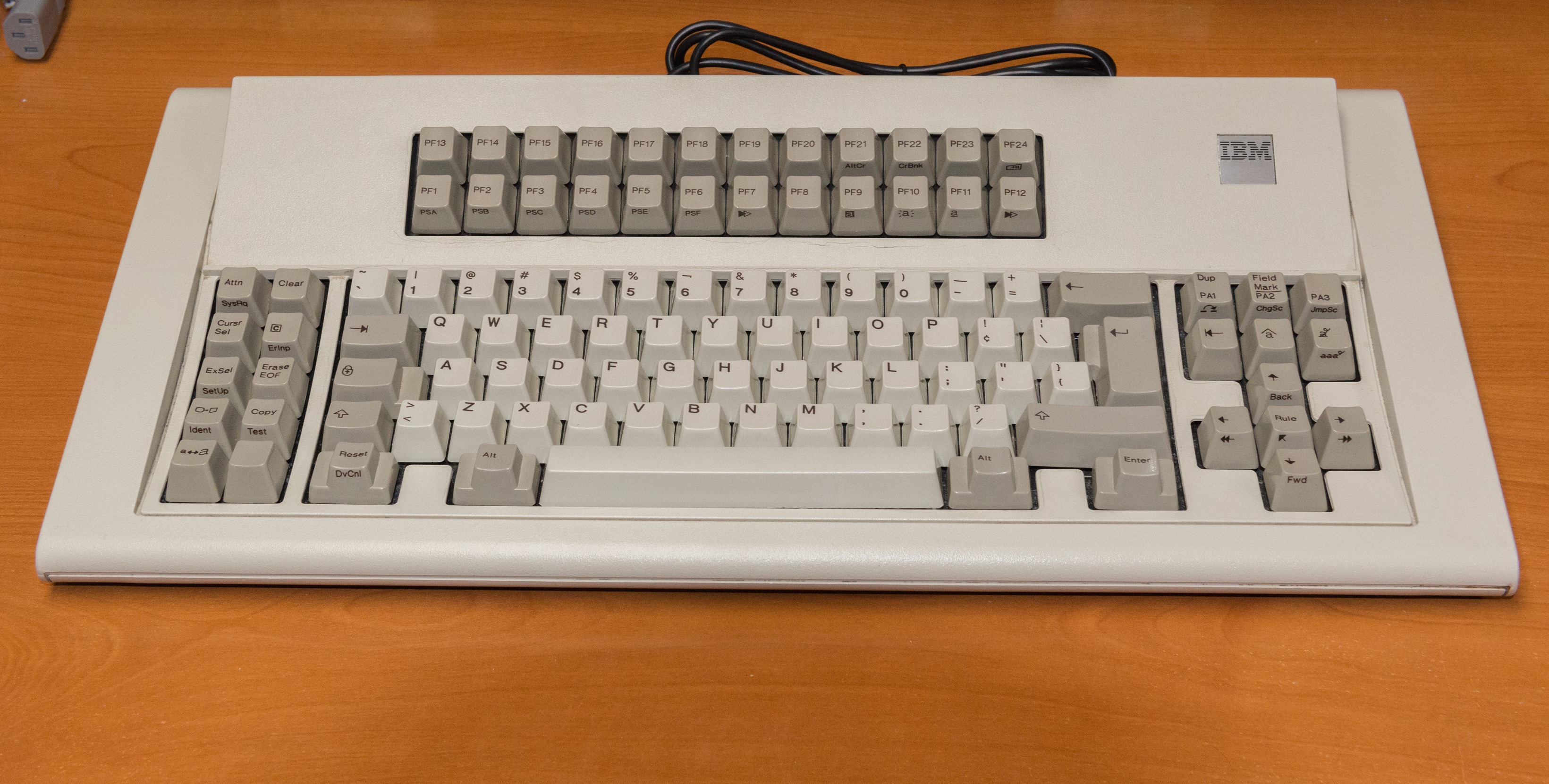

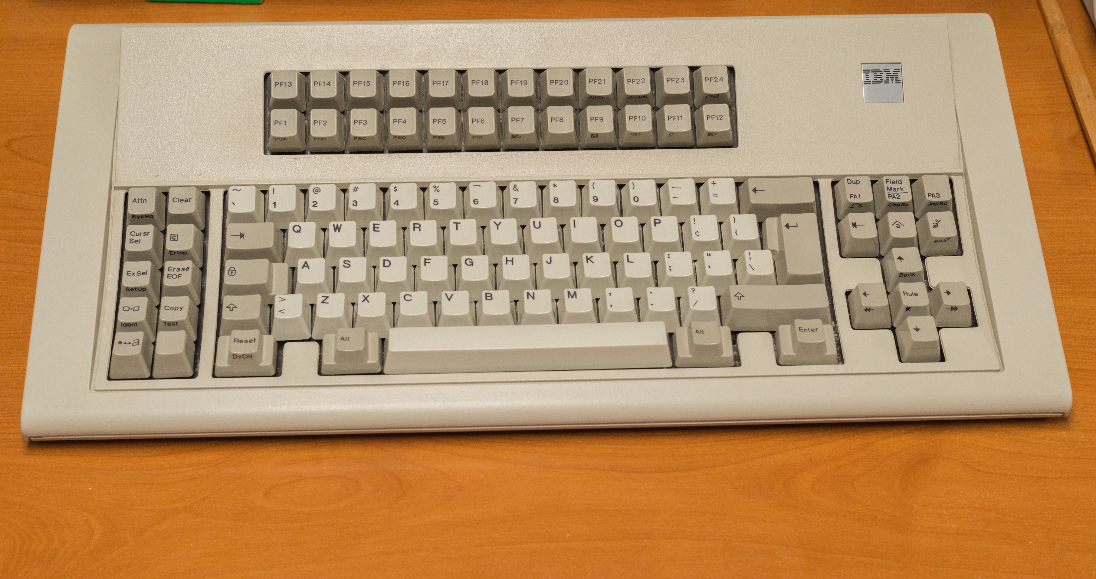

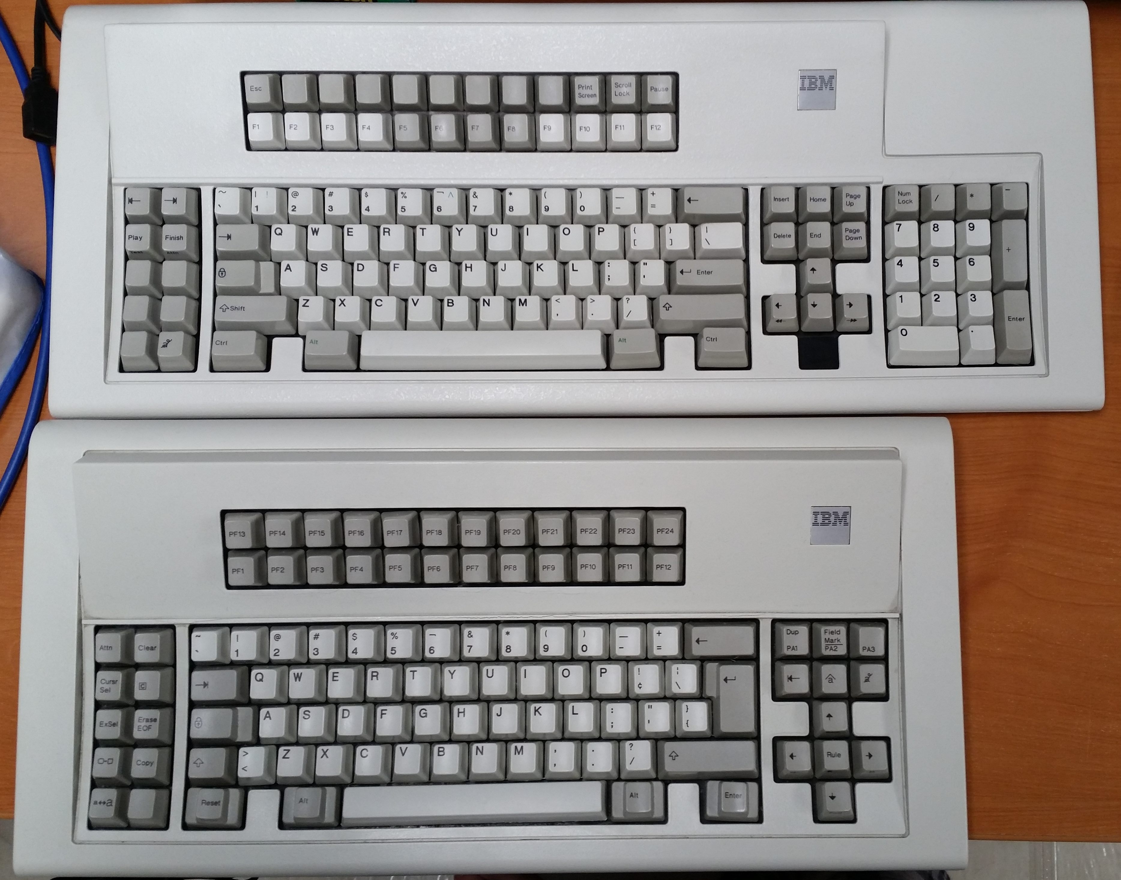

I wanted to do another shoutout here as well.
For the Model F Technical Reference, I would still require photos (with CC rights) for a bunch of original IBM Keyboards.
I have two pictures in the PDF http://linux-tin.org/ModelFManual.pdf of my XT and AT boards already, so you can see the approximate angle I shoot them of (Section 2.13 Photos of the Models - page 2-34 at this moment)

Models I would love to get pictures for:
* System/23 Datamaster Keyboard (IBM 5322)
* System/23 Datamaster Keyboard (IBM 5324) “Bezelmaster”
* CS/9000 Keyboard [should look like the XT with a different badge]
* Model F ‘Bigfoot’
* Model F ‘104-key terminal keyboard’ or ‘Unsaver’
* Model F ‘4704 50-key’
* Model F ‘4704 62-key’ or Model 200 or ‘Kishsaver’ - Original
* Model F ‘4704 77-key’ or Model 300 - Original
* Model F ‘Displaywriter’
* Model F ‘Blue Button’ (all versions)
* Model F 127 ‘4980’

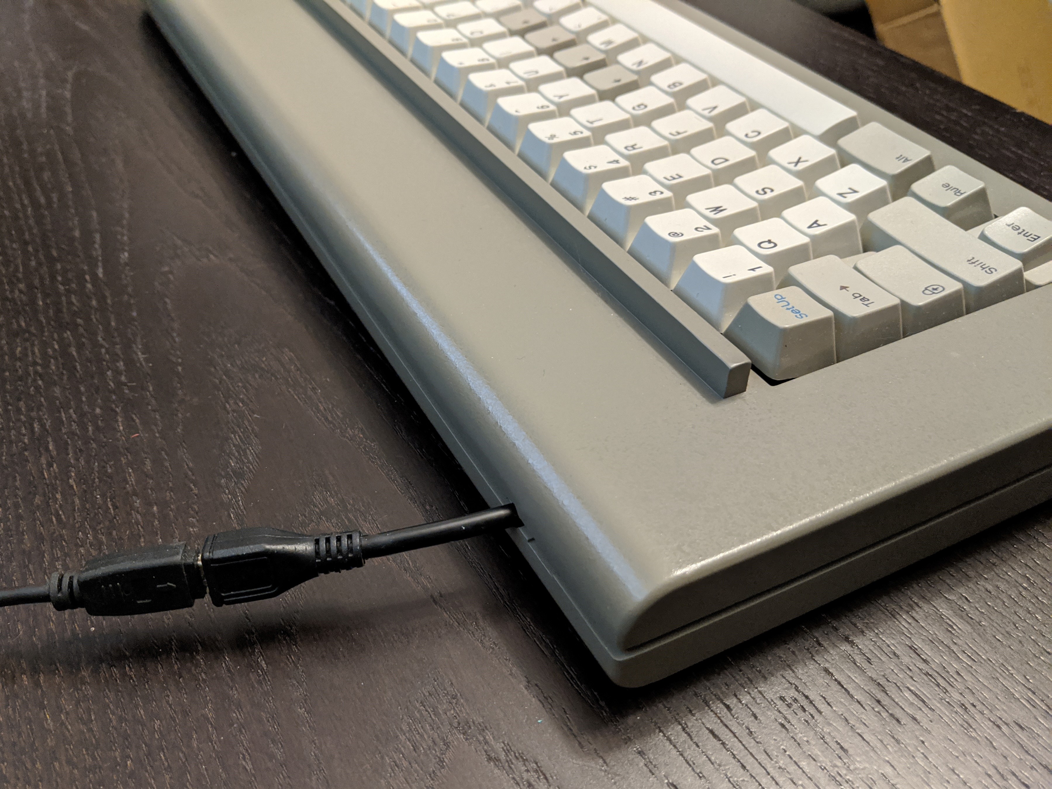

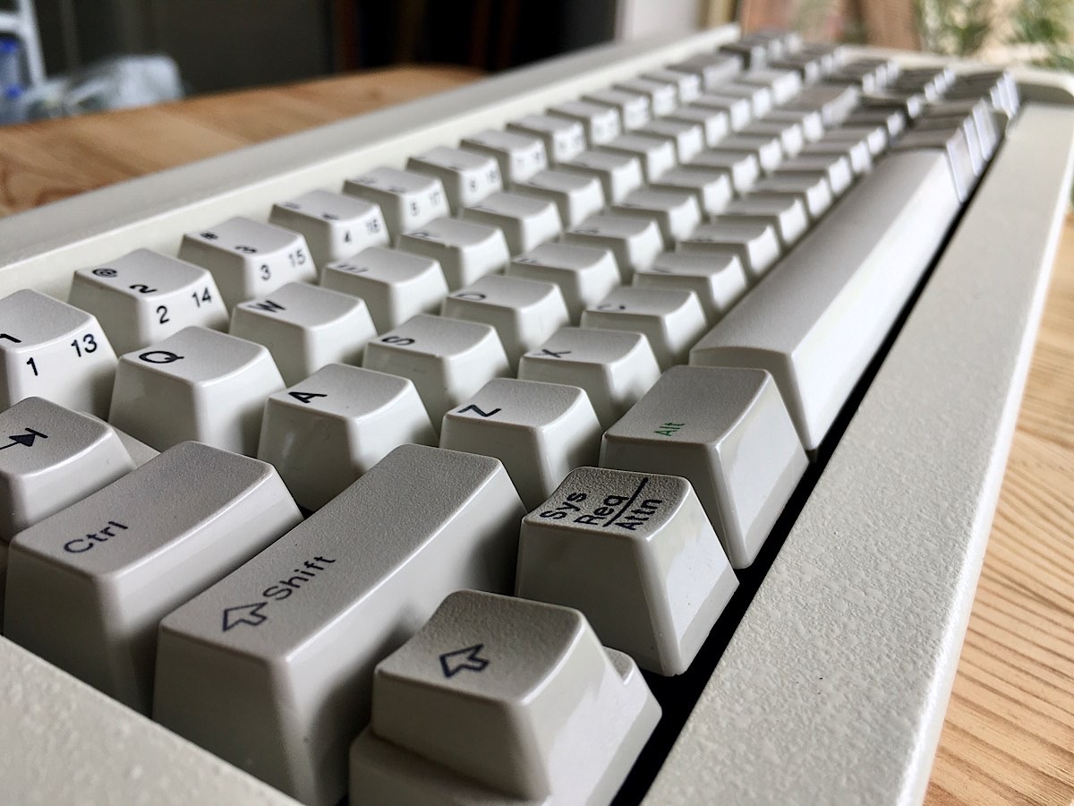

Finally got my F77, and i'm super impressed.
I did have one major issue - I had the problem where I had large swaths of keys that were unresponsive, and the issue seemed to be the pins on the ribbon cable connection poking through the tape and shorting out on the case. I layered some scotch tape for a temporary solution until I buy some more electrical tape.
I feel like Ellipse should check to see what's going on here, might want to invest in some thicker tape.
The typing feel is amazing. I had heard the Model F had a lighter actuation than Model M but I was really surprised with how light they are. Even though they are light, they have a very satisfying tactile event. The more I use it, the more I love it.
It sounds like a bag full of nails and springs tumbling down a hill. The ping and general racket of it all is impressive to me but perhaps a bit much for my girlfriend.
Still, even she agrees, it's quite the looker:

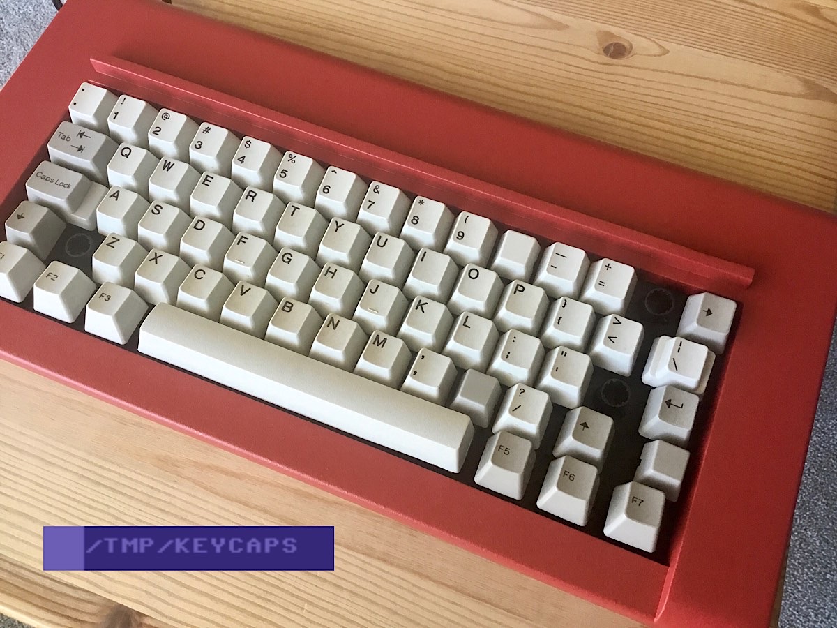

Goddamn the red powdercoating looks really good. I thought that the red looked overpowering, but it really gives a British postbox vibe and looks better than I expected.

On the color, the photo is a bit off, but not too far... it has the trademark samsung over-saturation. I'll try to get a photo with some natural lighting tomorrow. It's a really punchy red, a tinge on the orange side. When I unboxed it, i was taken aback at its vibrance and beauty. Such an amazing deal for the price, IMO. And the spare cases being $110 is great also. I picked up a black compact f77 aluminum case, but i havent inspected it that thoroughly yet... i've been too busy with this beauty. (and trying to stay cool... no air conditioning and a heat wave is killing me, especially with all the ash in the air making it difficult to open windows...)
Regarding the layout, I must say that this F77 layout with the three column filled nav cluster is the PERFECT layout for me. This has it all. I've got it set up like a TKL with some extra macro/media keys, but if you hit numlock it toggles the layer to be a numpad with all the math operators below, perfect for whenever i need to type some pin, authenticator code or whatever other number crunching my work throws at me.
The M13 keycaps I managed to score last week, so this all came together nicely in the last minute. Although... I almost like the M13 keycaps better on the model m... something about the design of the model m is quite amazing. I wouldn't mind a zinc model m with f assembly, Ellipse.

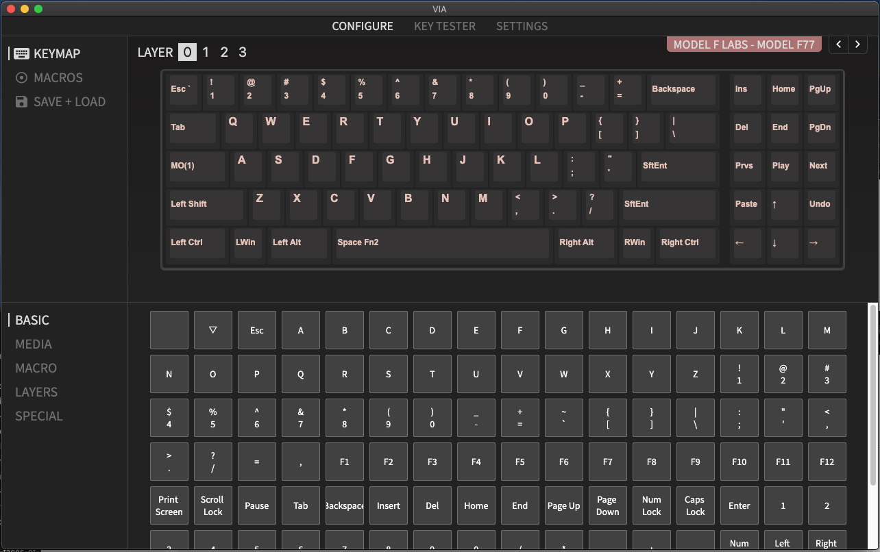

Hello!
I have been using my Model F77 for about a week now and it's such a great feeling keyboard!
Mine came with QMK installed, but I wanted to customize it, of course. I got access to the QMK beta from pandrew (thank you!) and have it building locally. I'm experimenting with VIA support enabled in the firmware and have successfully edited the keymap layers with the VIA editor (no flashing required).
Enabling VIA also enables BOOTMAGIC ("lite", I think), which is incompatible with the capsense auto-calibration. While I can't actually use the features of BOOTMAGIC (no keys can be pressed when the keyboard is initialized), having it enabled doesn't seem to cause me any problems.
- Here's a screen capture of the VIA editor with my F77 keymap.
- VIA Editor - Model F77.png (129.27 KiB) Viewed 11894 times

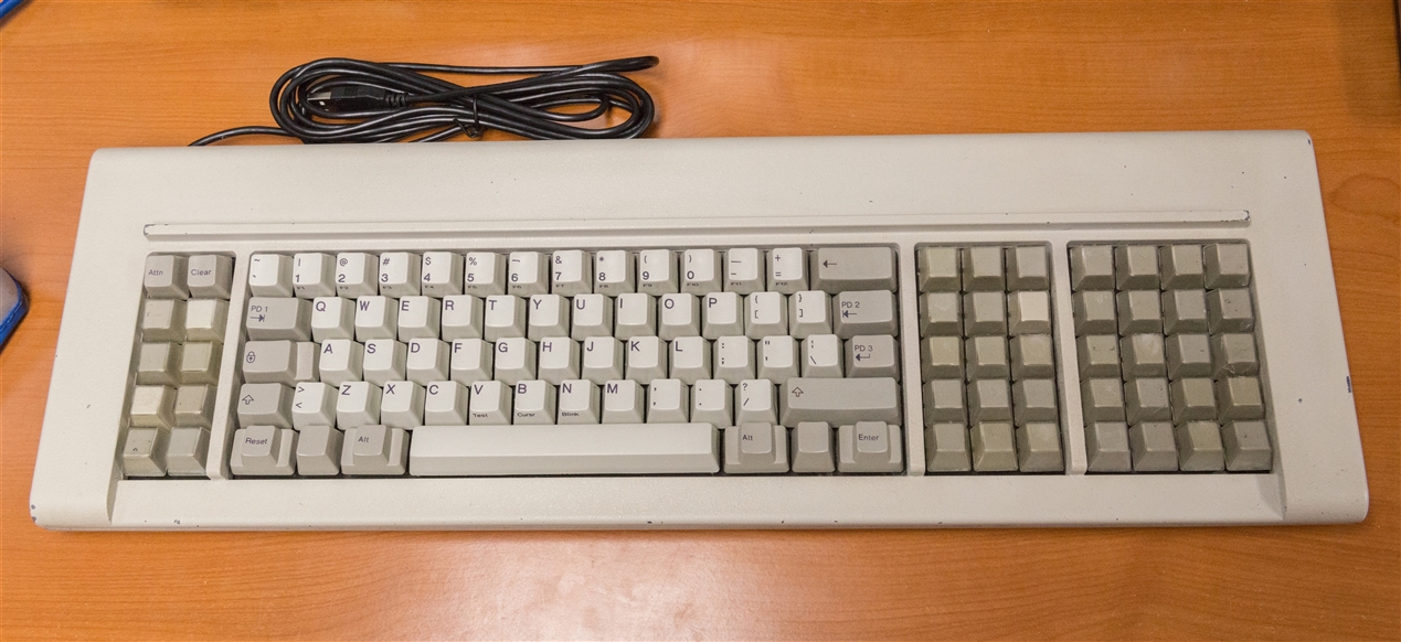

While waiting for the keycaps, I am using some from old keyboards but didn’t have enough of the correct ones so the layouts are a bit eccentric.
A couple of notes on my issues and resolutions:
The keycap donors. These were broken and very dirty:
- The F62 worked out-of-box (almost). I carefully followed the instructions in the video for adding the keycaps but I still had some issues with sets of random characters for a couple of keys. In each case however it was fixed by redoing the key VERY carefully to ensure the spring was in the correct position. So... my fault.
- The F77 was spamming lots of key press when plugged in. I tried it with a Dell and an Apple, with unpowered and powered hubs, and with USB ports on a thunderbolt dock. Same in all instances. Temperature made no difference. Fortunately I found an really easy solution that didn’t require reloading firmware or anything complex at all. I detailed that over on the Geekhack thread previously. It is perfect now.

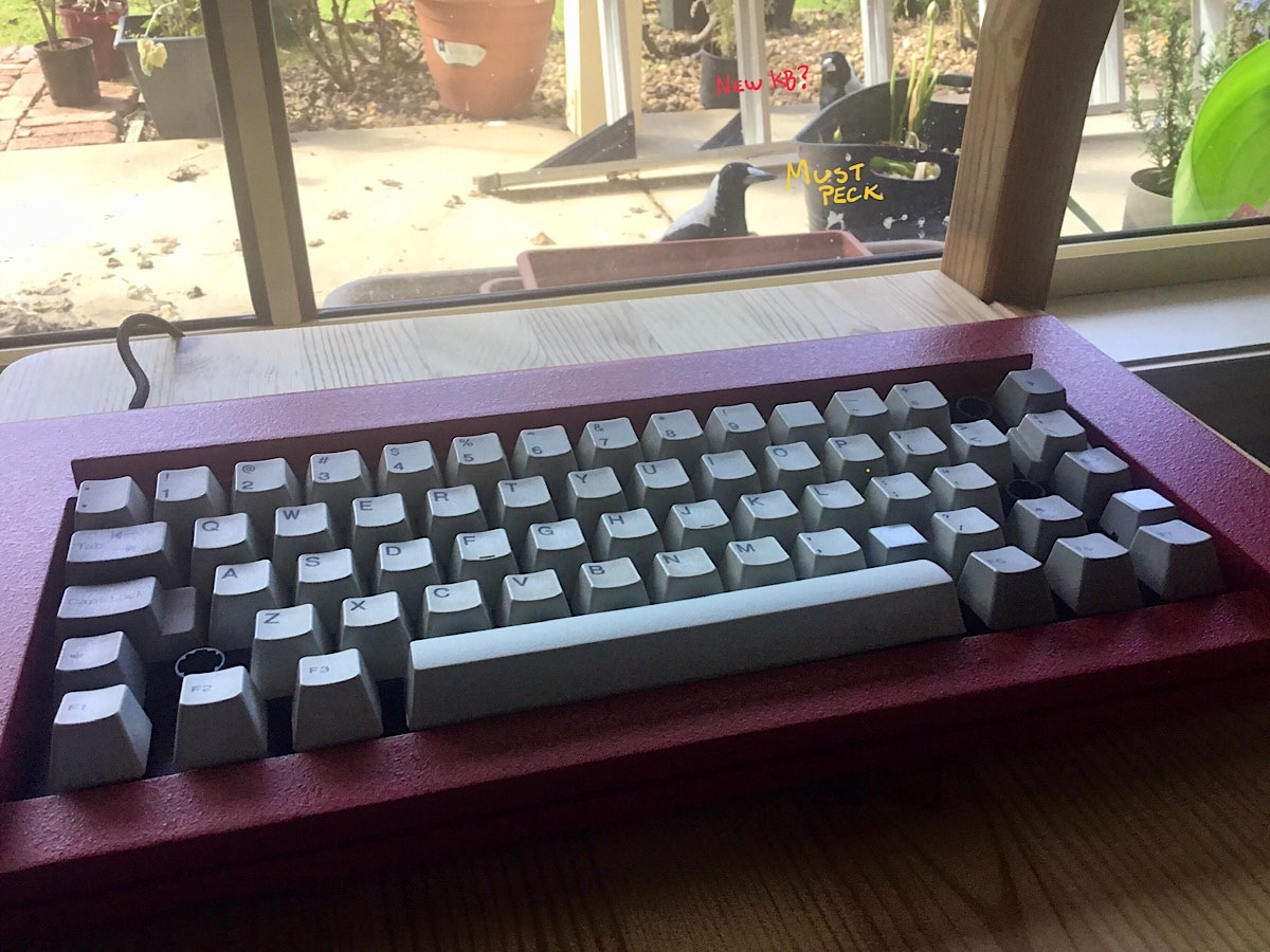

- Tritian
Not to outdo darkcruix, but i'll be taking mine scuba diving next week.
Seriously though, I tried to take a better natural light photo for the color red, but then this happened to our skies:
But anyway, I decided to try my hand at photographing it again indoors. This time with better lighting/saturation, although i'm not actually any good at photography so bear with me.
And with some Model M caps instead of M13
@scarpia, would love to see a pic of yours with that ibm badge

- darkcruix
- Main keyboard: Brand New Model F F77 Keyboard
- Favorite switch: Ellipse version of Buckling Spring / BeamSpring
- DT Pro Member: 0209
First of all - stay safe! I saw some posts of the sky earlier - frightening!Tritian wrote: 10 Sep 2020, 23:13 Not to outdo darkcruix, but i'll be taking mine scuba diving next week.
Seriously though, I tried to take a better natural light photo for the color red, but then this happened to our skies outside:
But anyway, I decided to try my hands at photographing it again indoors. This time with better lighting/saturation, although i'm not actually any good at photography so bear with me.
I love the red more and more ... it has something of the Ferrari of Magnum, P.I. ... yeah, an old TV show, I know...
