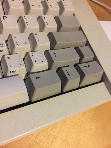

I got my F62 a couple of weeks ago and after a rough patch of trying to adjust a few stubborn springs, and struggling to figure out how to flash it with QMK, here I am with a dope ass keyboard! Only catch is that the keycaps won't be ready until later in the year, so I'm making do with some blanks I bought from Unicomp. At first I thought I'd go crazy without legends, but it has forced me to improve my typing skills and I can just about manage by now without too much trouble. I did a floss mod, because the pinging is just not my bag, and I'm now utterly content with the sound/feel.
Because the white blank keycaps looked kind of lame, I decided to dye them. I chose RIT dye for synthetics in "frost gray". The results were a little weird, and everything came out in various shades of mauve. The result is not too bad, except for the right shift key which had some parts that just would NOT take dye.

@swedishpiehole: Strange dying result with that Right Shift key. Did you wash the keys before dying them? Does RIT recommend any surface treatments before dying?

I did wash the keys, even though they were practically new. Clearly there is a mix of some kind of plastic in that one key that does NOT take dye. RIT is a fabric dye, so the instructions don't apply to plastic, although I don't recall there being any recommended surface treatments.Hypersphere wrote: 21 Jul 2020, 20:07 @swedishpiehole: Strange dying result with that Right Shift key. Did you wash the keys before dying them? Does RIT recommend any surface treatments before dying?

I dimly recall some posts on DT years ago with some suggestions (such as temperature and time) for dying PBT keycaps with RIT dye. Perhaps a search would come up with something useful. However, as you have pointed out, there is something odd about that one key.swedishpiehole wrote: 21 Jul 2020, 20:22I did wash the keys, even though they were practically new. Clearly there is a mix of some kind of plastic in that one key that does NOT take dye. RIT is a fabric dye, so the instructions don't apply to plastic, although I don't recall there being any recommended surface treatments.Hypersphere wrote: 21 Jul 2020, 20:07 @swedishpiehole: Strange dying result with that Right Shift key. Did you wash the keys before dying them? Does RIT recommend any surface treatments before dying?

I also love the HHKB form factor (I have been using an HHKB for a long time, which has been replaced by a F62 exactly like yours) and I subscribe to every word you wrote.rgleas wrote: 21 Jul 2020, 23:34 The F62 was very awkward at first, especially with FN + [ - ; - ' - / (up - left - right - down) for arrow keys
The F62 "split backspace, split right shift" is the best keyboard I ever owned, and I am seriously thinking to sell off most of my other keyboards (except maybe a Model M and the HHKB) and get another spare F62.
Regarding the cursor placement, I have also remapped the bottom right modifier group to act as cursor cluster when the keys are pressed on their own, and as standard modifiers (shift, super, alt, control) when pressed together with other keys.
I'm not sure if the stock remapping tool can do this, but you can use a software remapper (like Karabiner in macOS) or the beta QMK firmware.
- IMG_0098.JPG (49.35 KiB) Viewed 10522 times
