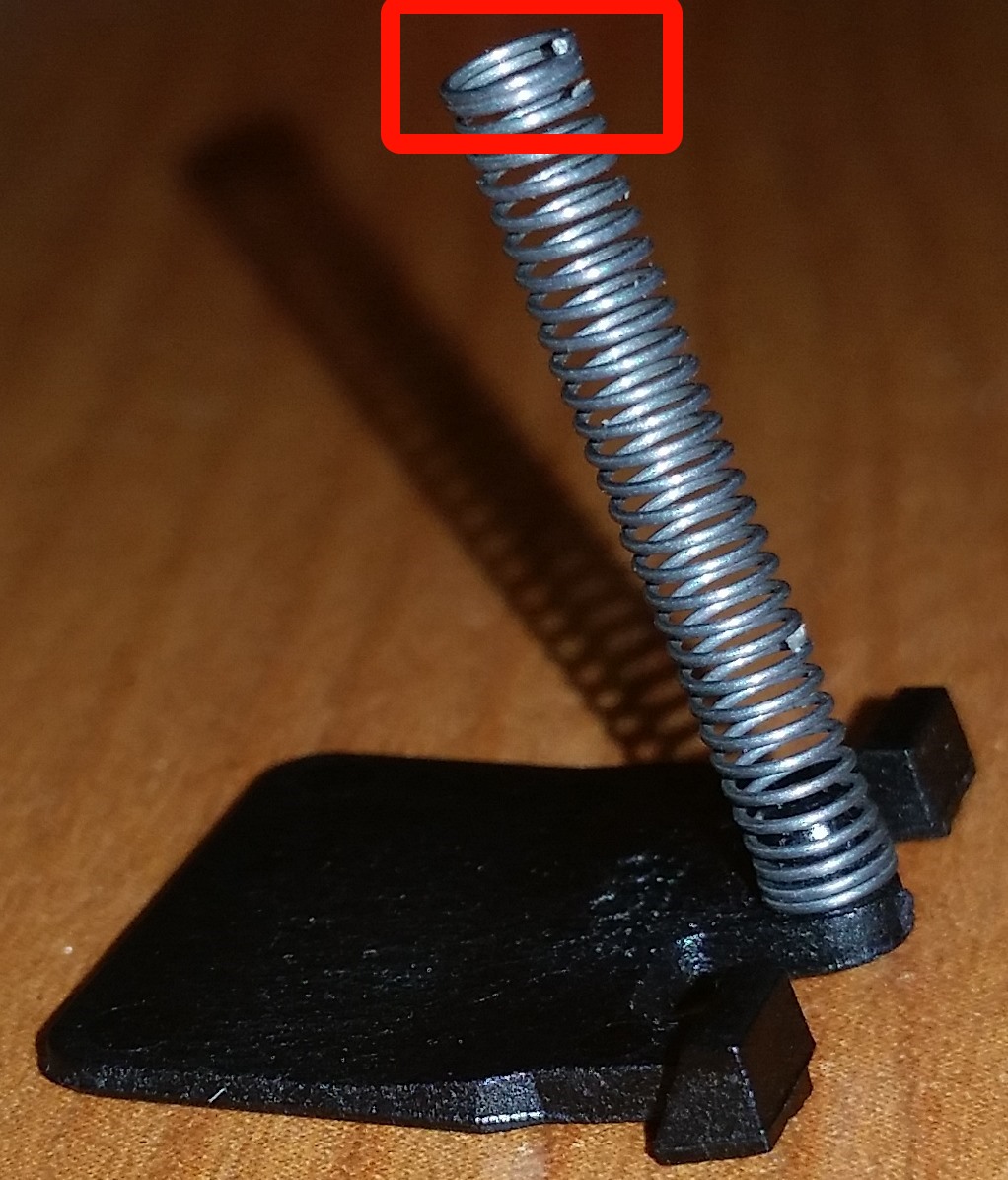

I was having a similar issue with my f62, I flashed it with qmk and it got rid of all my problems.Senescent wrote: 30 Jun 2020, 20:14 So I set up my F77 today and when it works it seems really awesome. However, I'm having one big issue that I can't seem to fix.
My board initially had a couple of buzzing/dead keys but I fixed those pretty easily. Unfortunately, there seems to be another issue that I believe may be software related that I can't seem to nail down. I type fairly quickly, usually around 130~ wpm, and this has caused me to notice a problem with my F key. When typing words such as "feel" or "fool" quickly it's like the F key registers too slow and it comes out as "efel" or "ofol". Sometimes the F key will double or triple register as well. I've tried both 0.9.2 firmware debounce versions and I've experimented with voltage ranges between 122-130 but nothing has fixed the issue.
I haven't used this thing enough to know if I'm having the same problem with other keys yet. Has anyone experienced something similar to this before? Any help is greatly appreciated as this is significantly affecting the usability of this board for me.

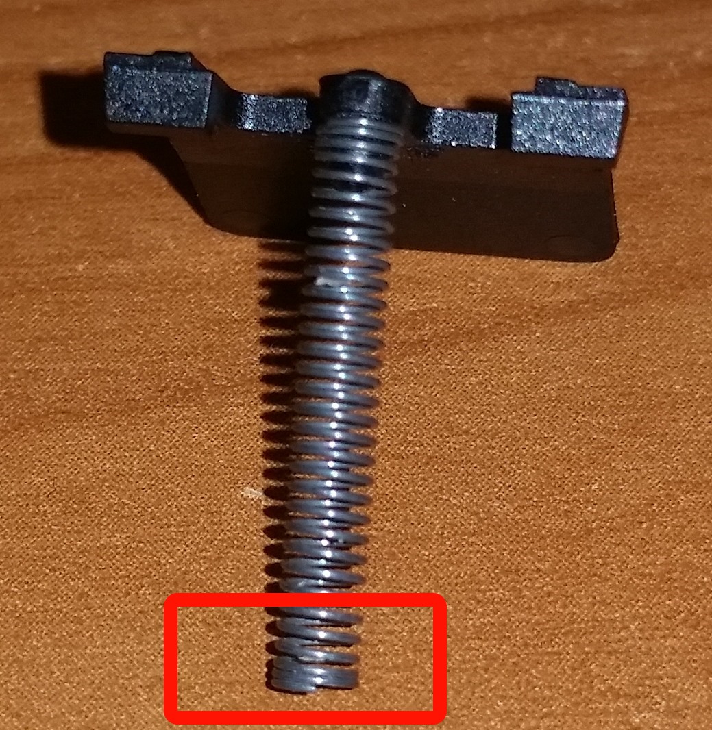

First impressions:
- function: all keys functioned right out of the box. No chatter and no
unresponsive keys. I noticed though that holding down the down-arrow
does not lead to a repeated down-arrow - instead I get one down arrow
scan code after I release the key. Re-seating this spring fixed the problem.

BucklingSprings, regarding the Unicomp key binding, it was discussed previously in the thread I believe to move the stabilizer insert about 1mm higher, and/or add a felt pad or O ring on top of the stabilizer insert to help reduce the binding. Even many of my original Model F and Model M keyboards had instances of binding for the wider keys. There's no binding for the wire stabilized keys though!
Here is another method to eliminate binding of all Model M and Model F keys, as shared to me many years ago:
"The idea is to get the sharp edge of the arched portion to bend inward slightly and stay that way.
I used the smooth polished rim of a nut wrench to burnish the edge inward and verified with a magnifying glass that the edge had been bent inward a bit. This completely eliminated the sticking of that key, so it must have been catching on the edge of the barrel ever so slightly before I burnished it.
The entire "sharp" upside down U-shaped edge of the key stem should be burnished.
The hardest part is finding just the right tool because the space is quite cramped in that part of the stem. The nut wrench rim just barely fit in enough to allow burnishing that edge. I have absolutely no idea why this worked -- I don't know what exactly that edge was contacting to cause the problem in the first place. All I know is that it worked."

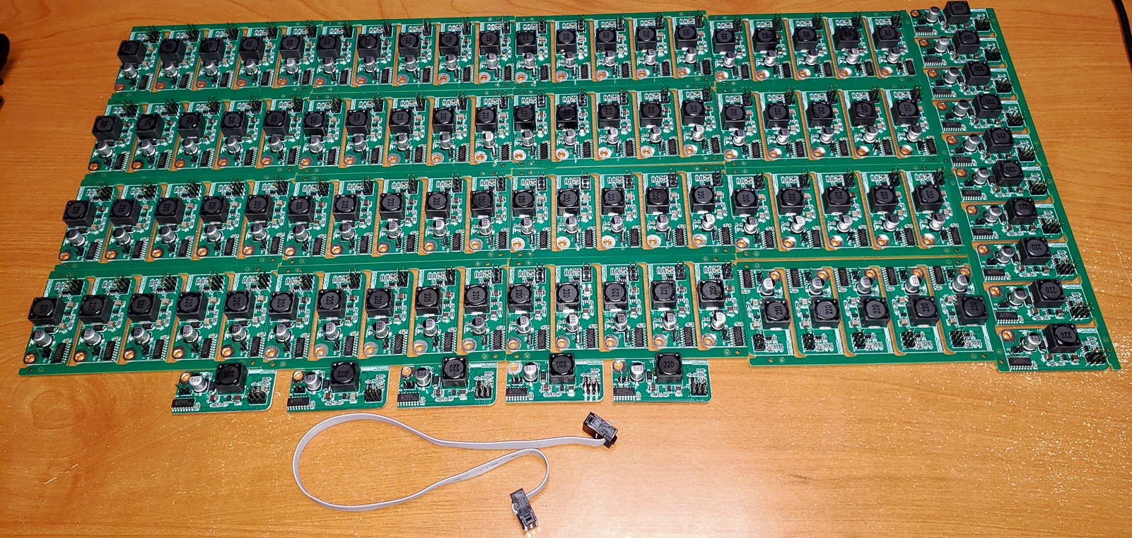

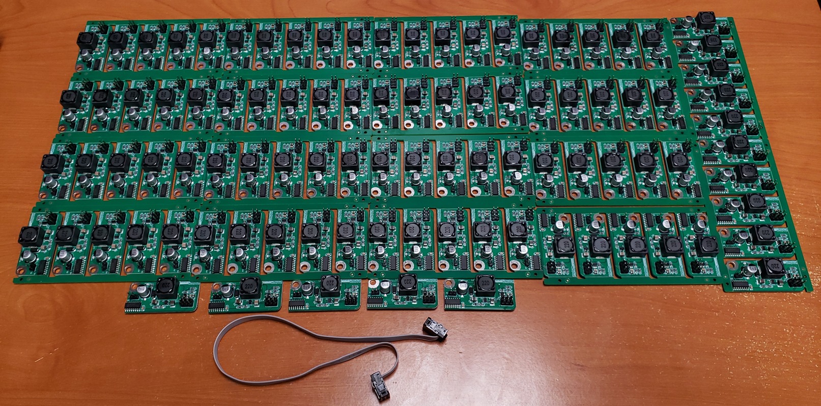

The xwhatsit solenoid drivers have arrived!

So I opened the assembly to be able to reseat the springs properly and ensure all spring ends are in the 12 o'clock position as shown in the video.
I wish I didn't bother. It's just worse than before. All the keys are barely tactile, even though the barrels don't wobble and the springs are in the proper positions.
Why...?
Why...?
Wazrach that should only be done to a few keys at most, maybe 3 to 7 keys, in my experience. Your typing test video that you linked to earlier sounded great so I am not sure anything was significantly out of bounds. Also my QC secrets video specified stretching the springs and using tweezers to correct buzzing springs without opening up the keyboard. If you opened up the keyboard to adjust springs by hand, that was not what is recommended for bad sounding keys.
The assembly machines do precision placement of springs on the nubs and a bad placement causes a bad sound. You should leave a bit of space between the end of the spring and the bottom of the flipper nub. Maybe 0.2mm.
Below are photos of the correct end of spring location and spring-flipper positioning.

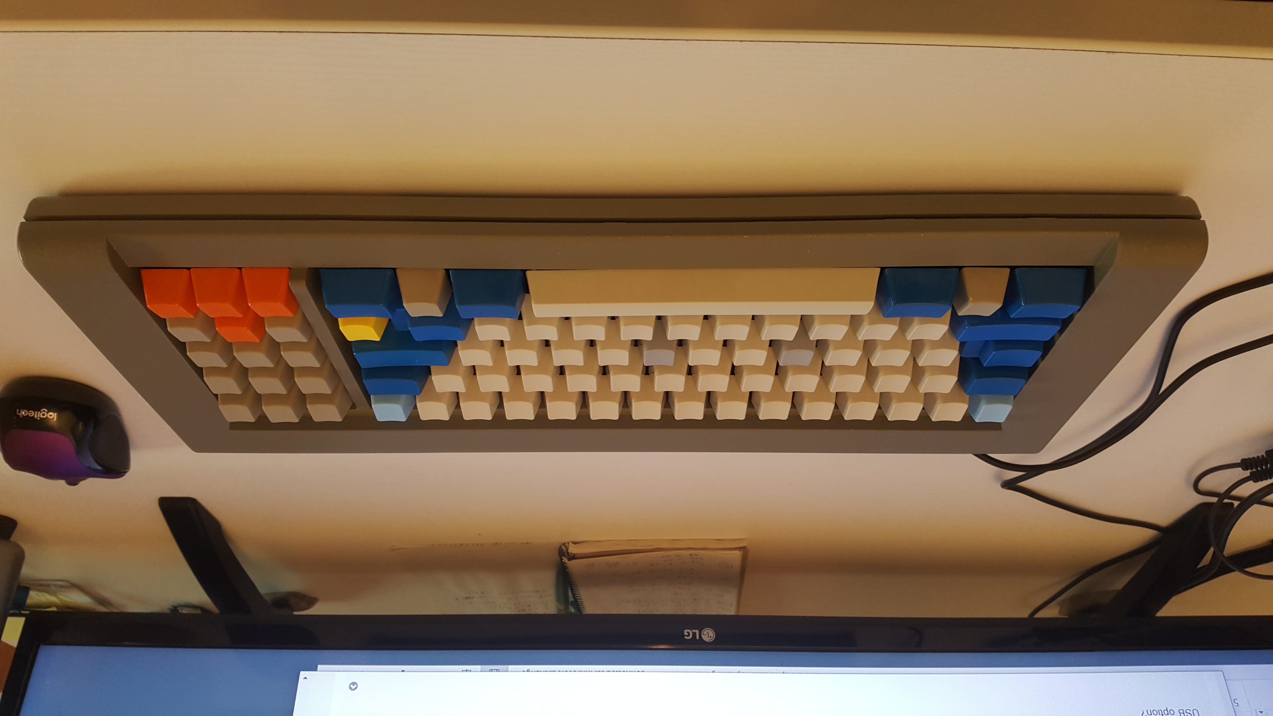

The case is incredibly stiff. The lightness of the key travel and this extreme firmness of the case
is an indescribably great typing feeling. Words fall short of expressing it. You've got to try it out
on an F64/77/107 (or probably a Beamspring) in order to really appreciate how satisfying this feels.
@Ellipse: I am noticing one thing: the top front part of my case ever so slightly vibrates when
I tap my fingers on it. There is no visible gap. I guesstimate that the gap is at most half a millimeter
wide.
Is it possible to bent the top part of the case to fit better? Or would you recommend to use some kind
of filler material (rubber strip or such)? Or is it safest to just leave it alone?
It is SUCH a joy typing on this thing. I am writing code at night - just to have an excuse typing on
this beast. I can't help having a smile on my face when I am typing ...
