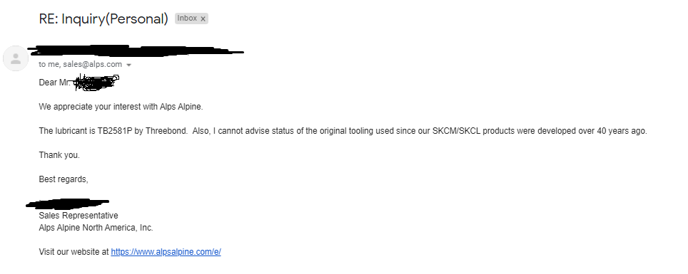

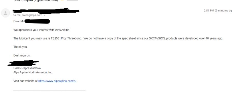

Earlier today, on the r/mk discord, someone posted a screenshot of an email from Alps. The email response ways that the lubricant used on the SKCM/SKCL was TB2581P, made by Threebond. I confirmed this by emailing them myself. While this lubricant is not listed on Threebond's website, I have contacted them try to find out where I can get some to compare with real lubed Alps. Proof of both email's have been attached below, even though they are identical. Please message either me or the original finder on Discord for further proof, or even email Alps themselves. I am headphone_jack#0001, the original finder is Jacobalbertus1
#5416.
UPDATE: A testing video of the lubed Threebond 1855 switches has been posted here: https://www.youtube.com/watch?v=GMVv1q1zNIQ
While we still are uncertain if this is the closest we can get, as the Nyogel posted recently in the thread seems very promising. However, I must say that these sound pretty damn good. Props to HerbalNekoTea for buying this sample and posting this testing video. Hopefully we can get a direct comparison in a few weeks when he lubes his blue alps board.
#5416.
- unknown (1).png (42.68 KiB) Viewed 82835 times
- alps.png (25.23 KiB) Viewed 82835 times

nice! looking forward to the response from threebond, though I would be surprised if they still sold that specific lubricant, or were willing to make new samples for testing. so it'd be a big plus if they could advise whether they currently sell lubricants now with a similar formula.

Yeah I was the one who emailed alps on this
