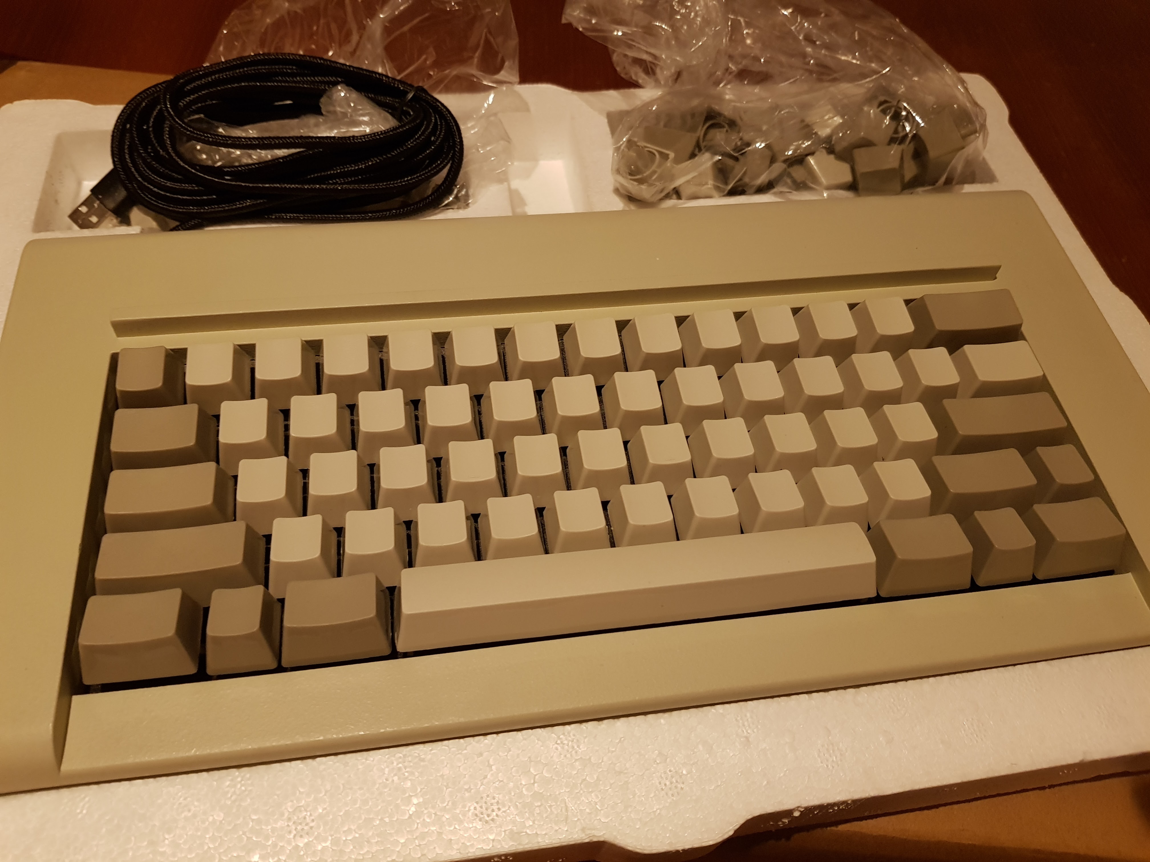

Package arrived! Big thank's to Joe!
Shipping was suprisingly fast, even with a delay with the postal service and considering the times we are in - it took only 9 days shipping all the way to the north of Norway.
Gave the F62 a split left shift and it has already been put to work at the office.
Keys are supersmoooth and both the feel and sound is perfect. Even better than my XT and AT.
The F62 in paticular has such great heft and is easily the best keyboard I have owned.

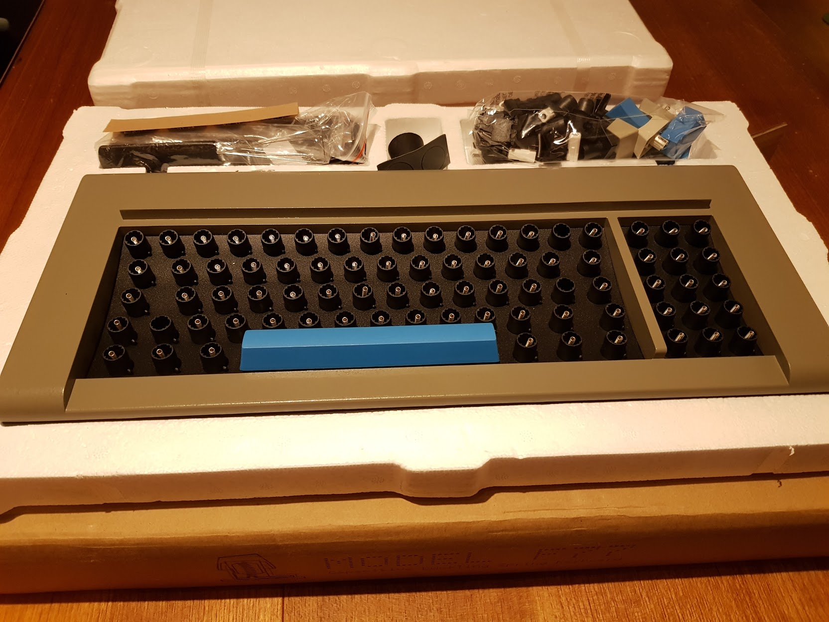

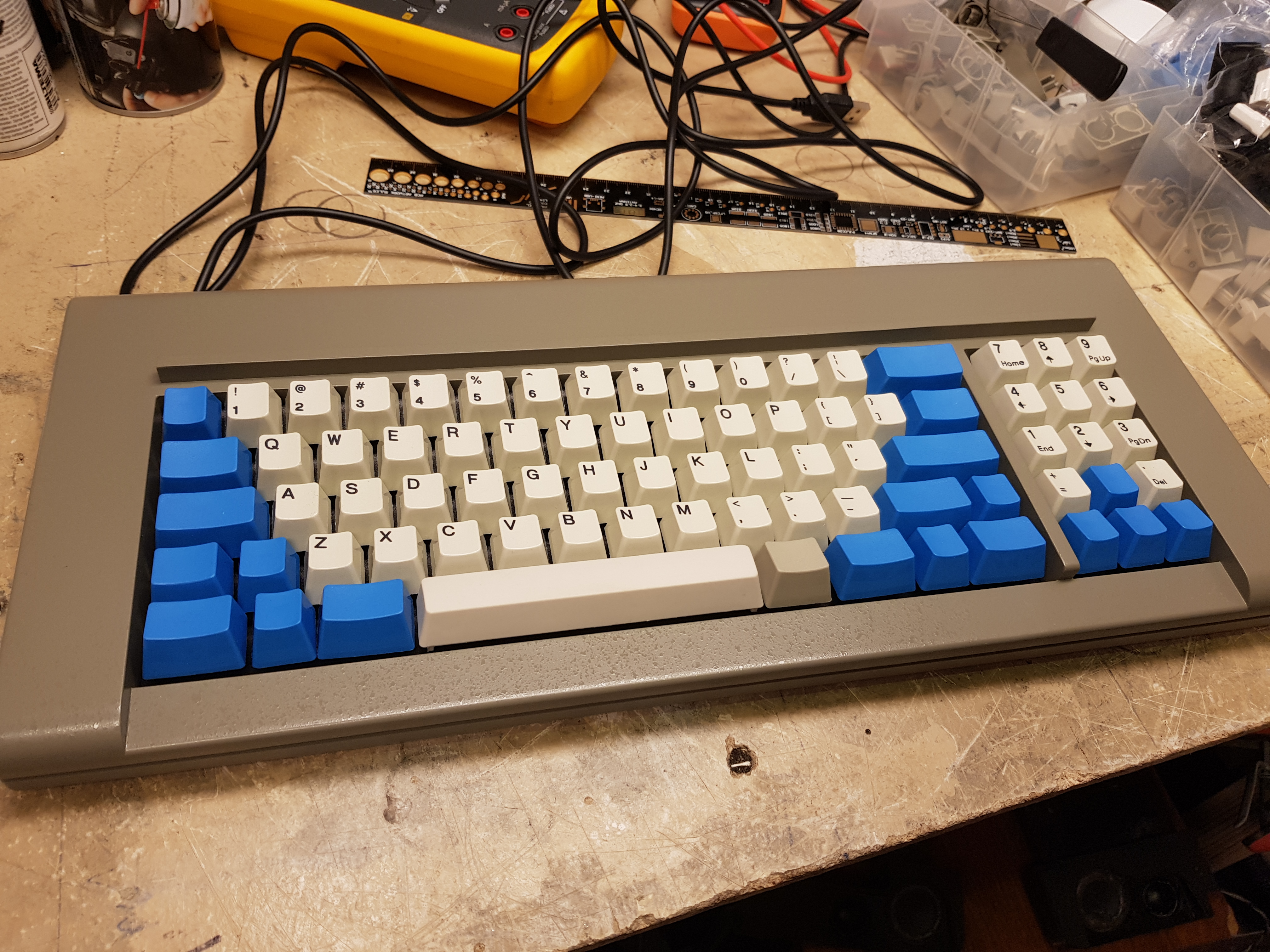

While I wait for the dye subbed caps, the F77 will have to do with what was lying around, mostly caps from an AT
Had a smaller Unicomp spacebar from a Unicomp Classic - so I added a extra barrel+flipper and got a extra key. Working without a problem.
Have the threshold settled in on the F77 at 130.

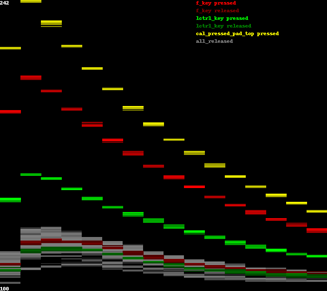

So I wonder how IBM did it. I doubt they made millions of keyboards which failed under different temperatures etc. Maybe the hardware has less divergences. But maybe it did some kind of self-test at startup and auto-tuned itself? I wonder if something like that would be possible.pandrew wrote: 29 Mar 2020, 10:29If anyone is having issues on their board with finding a good voltage threshold, I would love to collect some data from your board, to understand what's making it hard. I can plot scope-like signal traces with my code. I PM-ed Spacesaver, but he hasn't responded yet.LightningXI wrote: 29 Mar 2020, 08:01 QMK for the New Model F would be fantastic -- assuming that we won't have issues with the voltage threshold concerns that are occasionally brought up by users every now and then.
pandrew
- Location: Romania
I don't know how IBM did it. The xwhatsit's calibration is not gonna work on the model F reproductions, because the always-pressed calibration pads give a much higher signal then real buttons. I don't know if the reproduction keyboards are different, or if the xwhatsit approach is flawed. I was thinking that one way of calibrating would be to assume that when the keyboard is plugged in no keys are pressed, and then to measure the signal level for each unpressed key. Add a static offset to the measured value, and then try to come up with 2-3 bins of thresholds. For each matrix scan do 2-3 actual scans with different thresholds, and based on that determine each key status. For temperature-drift during operation, we could periodically measure the calibration pads. But I'm not sure how I should adjust the thresholds based on drift. If the reference changed +10 steps, should I change my thresholds +10 steps? We could come up with a formula, but we'd need to measure the same keyboard in various temperature conditions.webwit wrote: 29 Mar 2020, 12:39 So I wonder how IBM did it. I doubt they made millions of keyboards which failed under different temperatures etc. Maybe the hardware has less divergences. But maybe it did some kind of self-test at startup and auto-tuned itself? I wonder if something like that would be possible.
See attached waveforms from tantator's keyboard. There's a massive difference between CAL pad response, and the left control key pressed. (thresholds are on the Y axis, there's 4 pixels per step of threshold)
- out.png (6.44 KiB) Viewed 15194 times

I am happy to report back after getting a new-in-box Model F XT (chassis) from Redmaus that the key feel of modern Model F is very similar to Model F XT. If I have to find a difference, I would say the XT to be a bit stiffer, not to mention the monster spacebar. If I am going to get a third Model F, I probably would pick the F62 over XT for the more modern and economic layout. Modern Model F also has a higher quality case.
Redmaus has been super helpful in helping me navigating the whole thing. I would recommend people to buy from red market as well.
