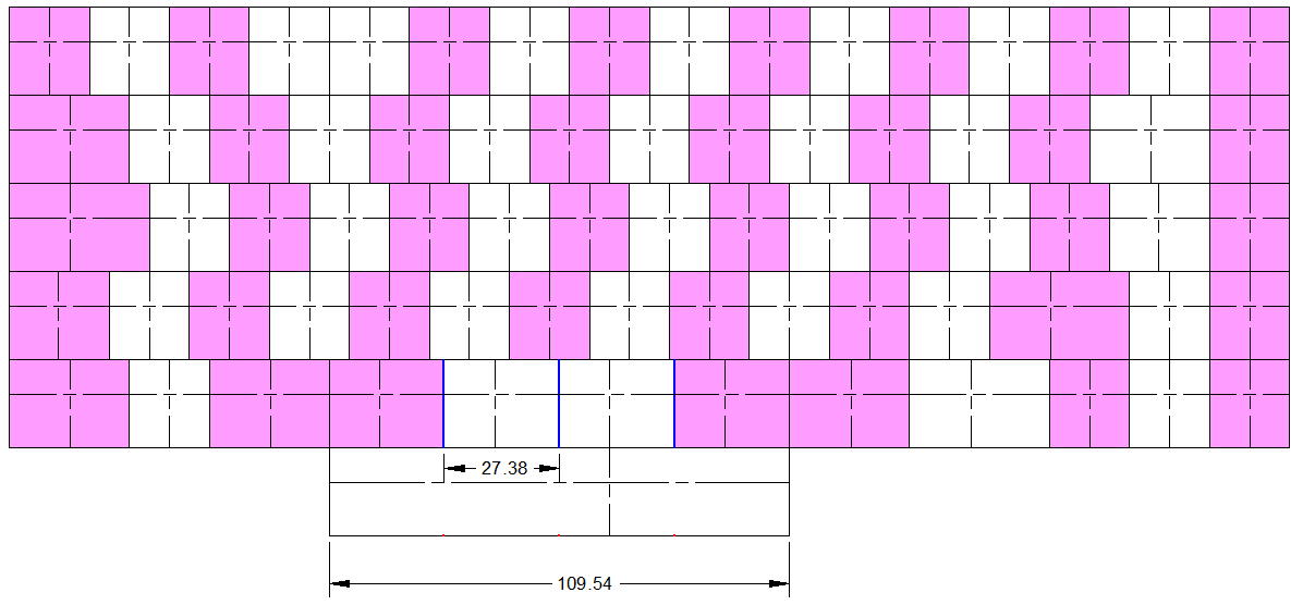

Split spacebar was seriously considered. It was not selected for 2.5 reasons; Code key caps are rare (you can't order them from Unicomp); the "small" spacebar is 5.75u wide (could not fill this space with just Code key caps); and we have exactly 70 pads already (5x14 matrix - so would need to activate another column).
That said, it would be very do-able. I remember taking the measurements of a code key cap years ago, but can't find it now. IIRC ... is it 2.25u (42 mm) wide?
- Location: Sweden
Not interested in the compact 62 one?Muirium wrote: 08 Oct 2019, 02:55 Discovering this a little late, I'll ask a likely dumb question: could a 60% Model F build be Poker case compatible? There's many good ones out there in classy materials, and, uh, some of us happen to be 60% purists who find any immediately adjacent extra keys to be a recipe for fodsdyrt/
https://www.modelfkeyboards.com/product ... a-compact/
orihalcon wrote: 09 Oct 2019, 00:34 Awesome project! I've always loved the idea of split spacebars if it's possible to implement something that would handle two "Code" keys from a wheelwriter in the spacebar area, I'd be all over that. I don't think this is suggesting much of a major change, just some extra capsense pads PCB for some extra keys in the spacebar area. The above plate could then have some different variants that would determine the placement of the barrels depending on the desired layout![]()
I suggested it early on and made a mockupwcass wrote: 09 Oct 2019, 01:51 Split spacebar was seriously considered. It was not selected for 2.5 reasons; Code key caps are rare (you can't order them from Unicomp); the "small" spacebar is 5.75u wide (could not fill this space with just Code key caps); and we have exactly 70 pads already (5x14 matrix - so would need to activate another column).
A code key on the right would interfere with the 5.75u spacebar pad, but an R-shift key would work there. The left obviously doesn't matter as it's unused PCB space, a code key (2.75u) could fit.
There's no need for separate plates in this configuration and it'd be a trivial change on my end.
When wcass mentioned the matrix limitation I left it at that, but it would indeed be cool...
I could try resin casting split spacebars with modified stem placement, the top mold being of a code key and the bottom a cutout for a 2-part key slider insert and stab rod. For those who want even more keys we could work out the optimal stem/stab placement to fit those pads.
I only have the default 5291 keys so I'd need a code key and stem inserts. The inserts would be glued in place as clips would be a pain/unreliable.
This way you'd have two convex thumb keys without the code text in any color, although it wouldn't precisely match the remaining keys. Some might actually prefer that, like the colorful HHKB PBT spacebar look
If left alt is replaced with a 1.75u key (same housing location) the gap can be eliminated

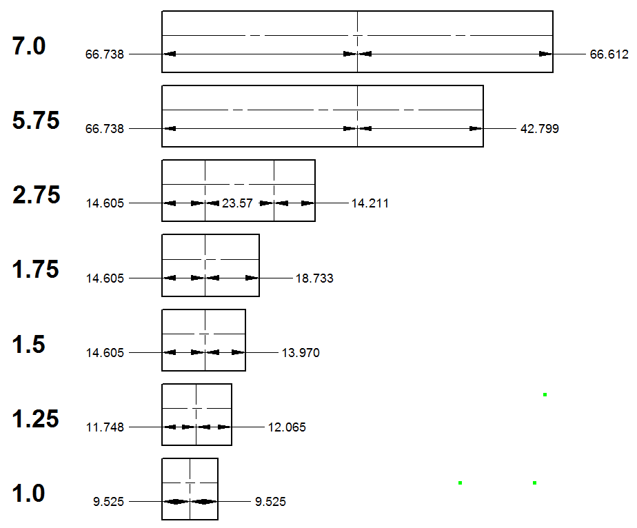

Right now, Enter plus back-slash are using 3 pads; Enter covers two pads, but only uses one (same) pad for sensing in ISO and ANSI config, the second for stabilization, and the third for back-slash - second and third swap depending on ISO or ANSI. Hypothetically, i could use the same column and row for both ISO and ANSI back-slash positions. This would free up a pad to use for a second space bar.
If we are to printer custom space bars, might as well fill the 5.75 space; 2.75 + 3. Maybe check to see what rsbseb is up to.

My fault for not explaining it well. The key cap "value" is not so much a problem - it is possition.
Right now, there are 3 possible configurations; ISO Enter and the cap left of that, ANSI Enter and the cap above that, or 1u + 1.25u + 1.5u on the row above. I could "free up" one pad by saying that you can do the first two options, but not the third.

Let's compare the options
Your suggestion (2):
- The 5.75u spacebar pad interferes (I personally don't mind)
- AFAIK a 3u key doesn't exist. I could attempt slicing my 9.75u spacebar to create one, but there'd be a visible seam. Ordering a quality 3dprinted one and casting it is an option, that's still added cost and wouldn't precisely match the surface finish of the remaining caps.
My suggestion (1):
- Nonstandard 1.75u l-alt key when using split space, a blank/incorrect legend one could be used instead (caps/ctrl/shift/fn), or a standard 1.5u one with a gap.
- Space can't be replaced with 4 1.5u keys, an ugly gap is inevitable.
- A single 2.75u space (red) requires a separate bottom mold due to stem location, the green one is also possible with a separate mold. Annoying but not a big deal.
KLE layout, please correct if I got something wrong
Edit: Realised yet another option with the green spacebar is possible, added
My suggestion (1):

i think it is worth trying - make the bottom row pads slightly wide to accommodate as many different layouts as we can. We would need one more pin for a new column, though. Any suggestions as to what pin to use? And what pins to use for the TP option - with consideration for routing? Though i suggested it, maybe we should just give up on the pogo pin idea.

I finally found my cheat sheet with post position measurements on it. There is about 1 mm between caps, so the actual caps are about 1 mm smaller than this. It is marked to .001 precision, but don't believe that. If you are off by 0.1, everything will work fine and no one will notice. I would not be surprised if IBM designed in millimeters not mils; 1u = 19.00 not 750
As rare as Code caps are, i expect that we would have to make these - and convex 1.5 and 3.0 to complete the row options we want to offer. If we commit to that, It may be more efficient to ignore the Code and just do just two - 1.4375 and 2.875 - like this ...
It looks like the "Code" cap posts are not where you would expect them to be. All of the other multi-wide caps are composites of other caps; ISO Enter is 1.5 over 1.25; ANSI Enter is 1 + 1.25; ANSI left Shift is 1.25 + 1; right Shift is 1 + 1.75. I was expecting Code to be 1.5 + 1.25 but it is not. It is closer to 1.5 + 1 + 0.25. With the posts where they are, the space bar is best replaced with a Code plus two 1.5u caps.As rare as Code caps are, i expect that we would have to make these - and convex 1.5 and 3.0 to complete the row options we want to offer. If we commit to that, It may be more efficient to ignore the Code and just do just two - 1.4375 and 2.875 - like this ...

Measuring across 9 1u keys on my 5921 plate it seemed closer to 6" than 152mm
Thanks for the graphic, good to know.
I suspected my red option above might be the actual code key stem placement, isn't that what you're suggesting? L>R: 1.5u key, 1u key and 0.25u gap.
Ignoring the code key doesn't make sense to me as it's the only one that can be cloned practically 1:1 with minimal investment. Convex 1.5u keys occurred to me too, I'd like to experiment with splicing and smoothing casts for new molds and see what results I can get. 3u is also an option using this method.
Do you have another process in mind for these keys?
