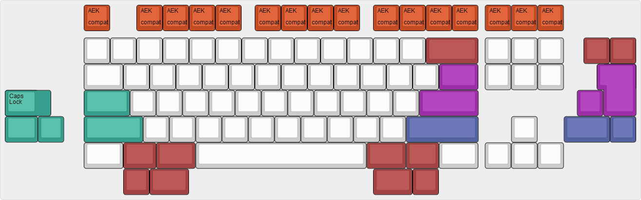

1. Layout supports:
- ISO + ANSI
- 1.75u Rshift
- AEK top row
- AEK + WKL bottom row
- 3 positions of capslock
2. Switch types supports:
In order to support pcb mount APS, 10 extra holes are added for bolt modding, and this is also the focus of this build. Both Wingpad's and Snack's builds utilize plate mount APS, Leaf80 is built entirely with pcb mount APS. Please see picture below for the holes in question.

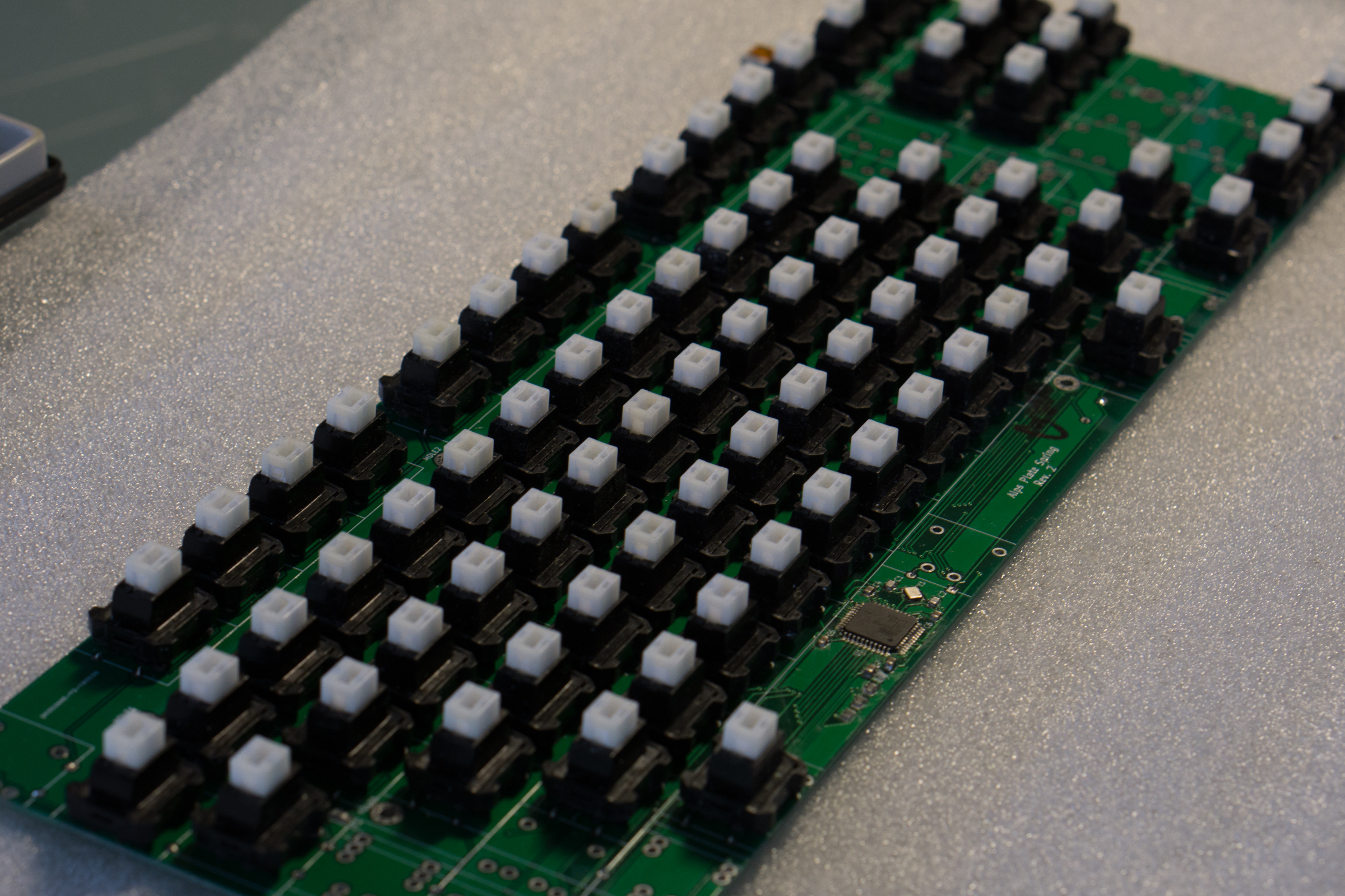

3. Building with battleship pcb mount APS:
At this point I am fully committed with powder lubing so the snow flakes you see in these pictures are just PTFE powder, nothing extra harmful.
The further-spaced pins are just stabilizers so I solder only 1 of the 2, because too much effort
I use M2x8mm screws and nuts, the holes on the pcb could fit up to M3 screws. For spacer I use 3mm LED spacer in nylon.

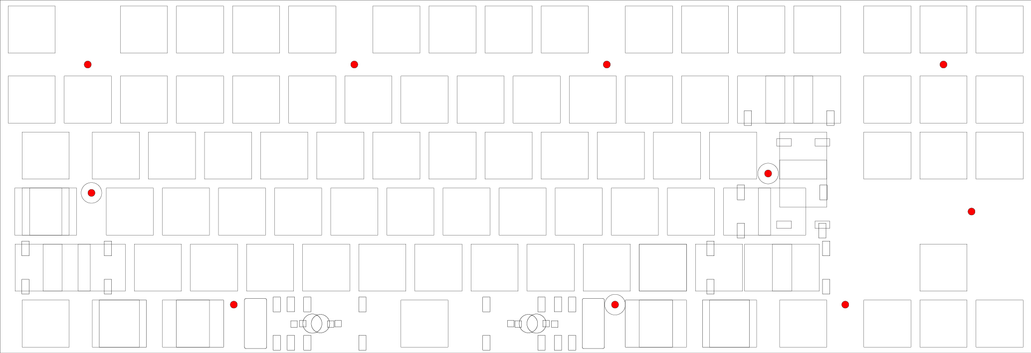

The Plate
The plate was cut by Sendcutsend, they do amazing work if you live in mainland US.
-1.2mm thickness
- stainless steel
- hand drilling for countersunk screw holes.
- plate purposes: to mount stabilizers and top.
Plate is not for switch alignments and mounting, plate is for case alignment. Think of this as reversed-tray mount: instead of mounting to the bottom tray, you mount it to the plate, then the plate mounts to the top case.
Except for a few dog bone switch cutouts for extra alignment, all the cutouts are larger than the actual switches so the plate could be taken off easily.
Due to the mounting system of the Leaf80, this is the most amount of metal I could take away, if I take away anymore metal, flex will come into play and I dont want that.
Big thank to robotical for letting me borrow his stationary drill to countersunk the plate screws.

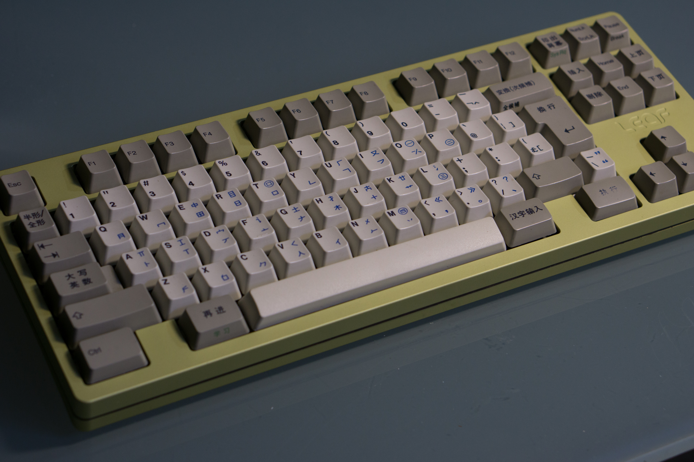

The Diffuser
Most ppl use diffuser for RGB underglow, diffuser actually has another use: adding extra spacing. Because of the bolt mod I want extra gap inside, also bigger gap is nicer for clicky switches anyway. Big thank to senter for providing the Leaf80 file design so I could derive the spacer from it.
The inner checker pattern is to refrain it from breaking during transport.
I have the choice between plastic and wood and of course I have to go with wood because it fits the main theme. I stained the wood with dark oil, don't remember what it is because I did it at my buddy's house and I just grabbed whatever available.
Using uniformed 2-piece cap right now, they are alright, will switch back to regular alps caps later.

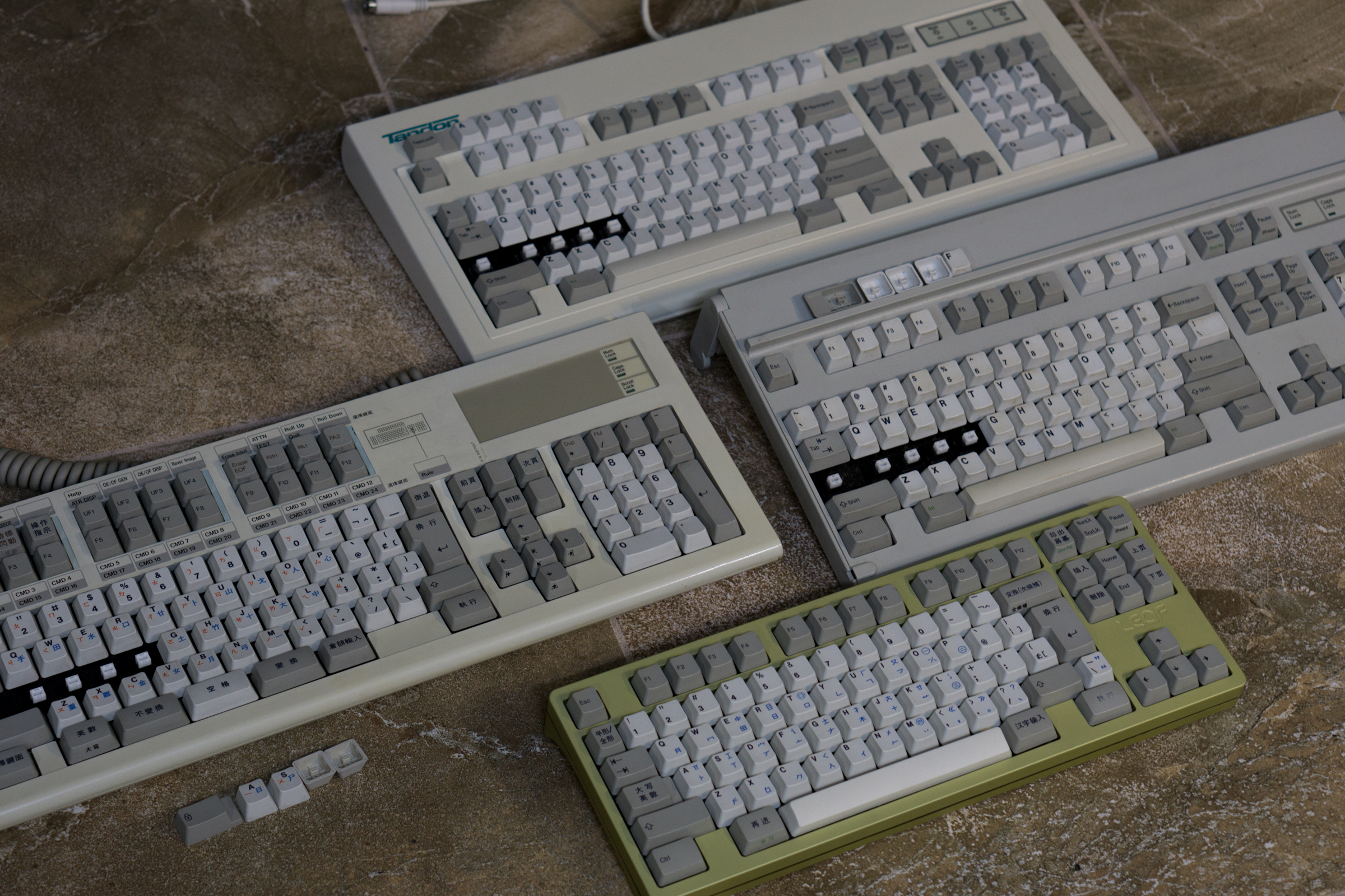

The Family
- P70 in g81-1000HAU case (Square pcb mount)
- P70 unmodded (Square pcb mount)
- IBM 5576 (plate mount)
- Leaf80 (Battleship pcb mount)

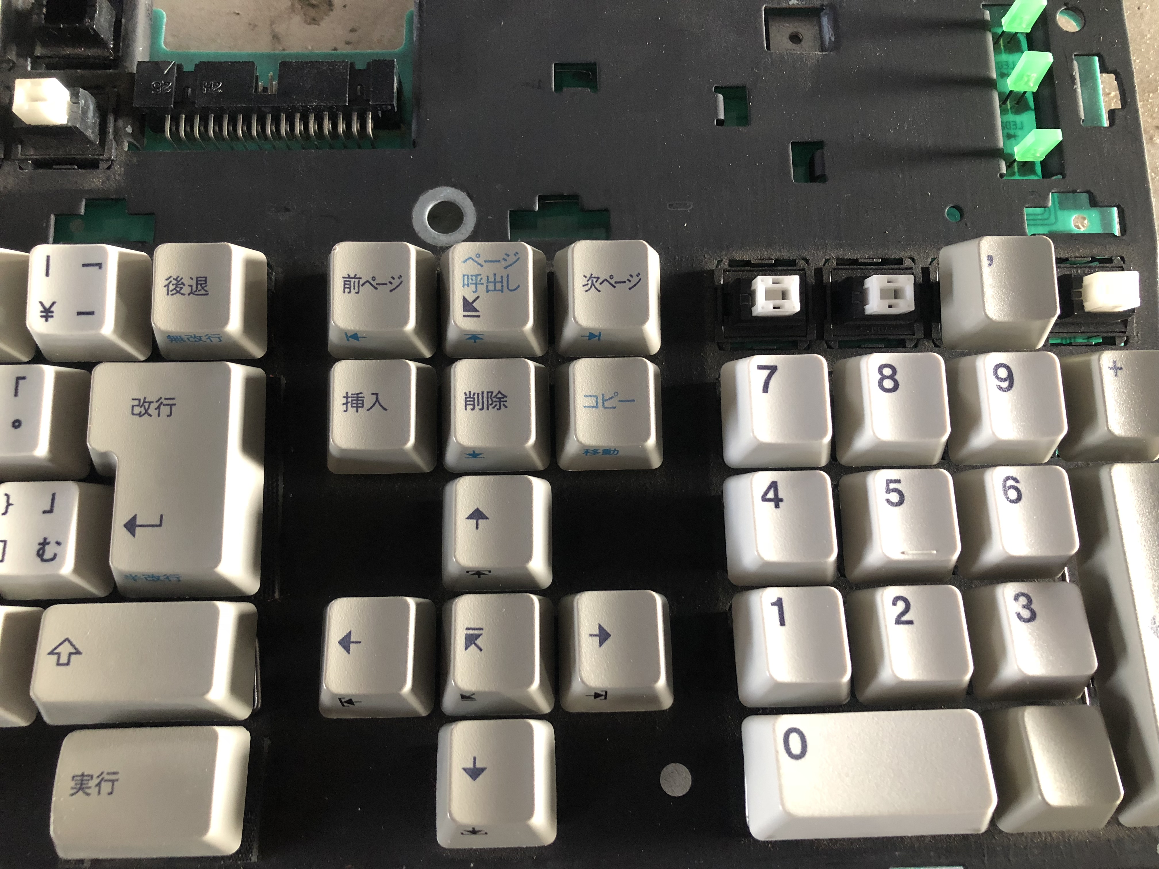

Luck of the draw, so far all the multistation are plate mounts and 2-piece caps. For p70/75/7186, there are 2 types of pcb mounts:
- Square switch: thick caps, 06/89 and earlier, with 6 pins, 4 metals + 2 plastic
- Battleship switch: thin caps for alphas and Ctrl/Alt, thick caps for long keys and F/J/num5, 4 metal pins only.

Cutout hole should be 16x16mm each
