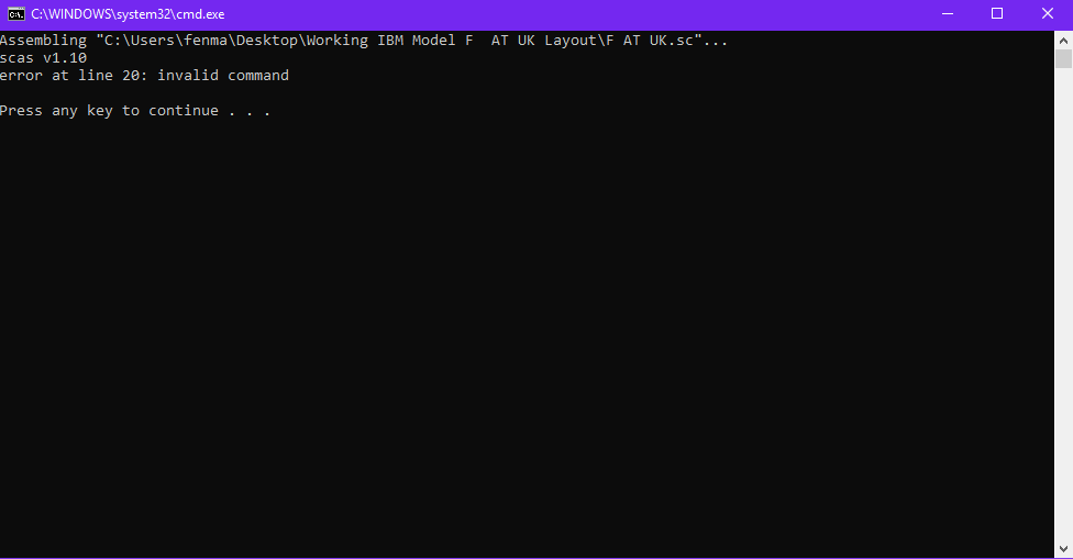

The error I kept getting I have attached an image please let me know your thoughts on that error Thanks in advance for your help.
- IBM Model F Error code.PNG (8.95 KiB) Viewed 3940 times

So I've tested it with my Model F XT now and it works fine.
I don't think it matters if it's an AT or XT in this case.
In your post you left out the first line "macroblock". But that can't be the reason, because then the error message would complain about line 1 or 2 and not 20.
But is there really not other code apart from mine in your config file? If there is, please post the complete file content.
For the F-keys you mentioned, include this between "macroblock" and "endblock":

Everything's ok. You probably just left out the first line from my code example.
Here's everything in one piece:

endblock-
Fkazim
- Location: United Kingdom
- Main keyboard: Modded IBM Model F AT
- Main mouse: Mionix Naos 8200
- Favorite switch: Capacitive Buckling Springs
All working but the control+esc is very finicky as in it works but you have to time hold the control down for a certain amount of time and even then you cannot click it repeatedly any idea why that might be and would the problem go away if we change it to tab+esc?
Again Thanks for the help.
- AJM
- Main keyboard: Geonworks W1-AT
- Favorite switch: Lichicx Lucy
- DT Pro Member: 0231
Ah, ok, sorry, the Alt/Ctrl key seems to create some chatter. So it's often good to include some "DELAY" after the PUSHING/CLEARING of METAs.
I've also changed it, so that the characters come repeatedly, if you hold the key:

endblock-
Fkazim
All working now although when I first uploaded the configuration you gave me the computer was acting really weird and the tab key acted like it was continually pressed but after restart of my PC all seems good
Thanks for all the help.
