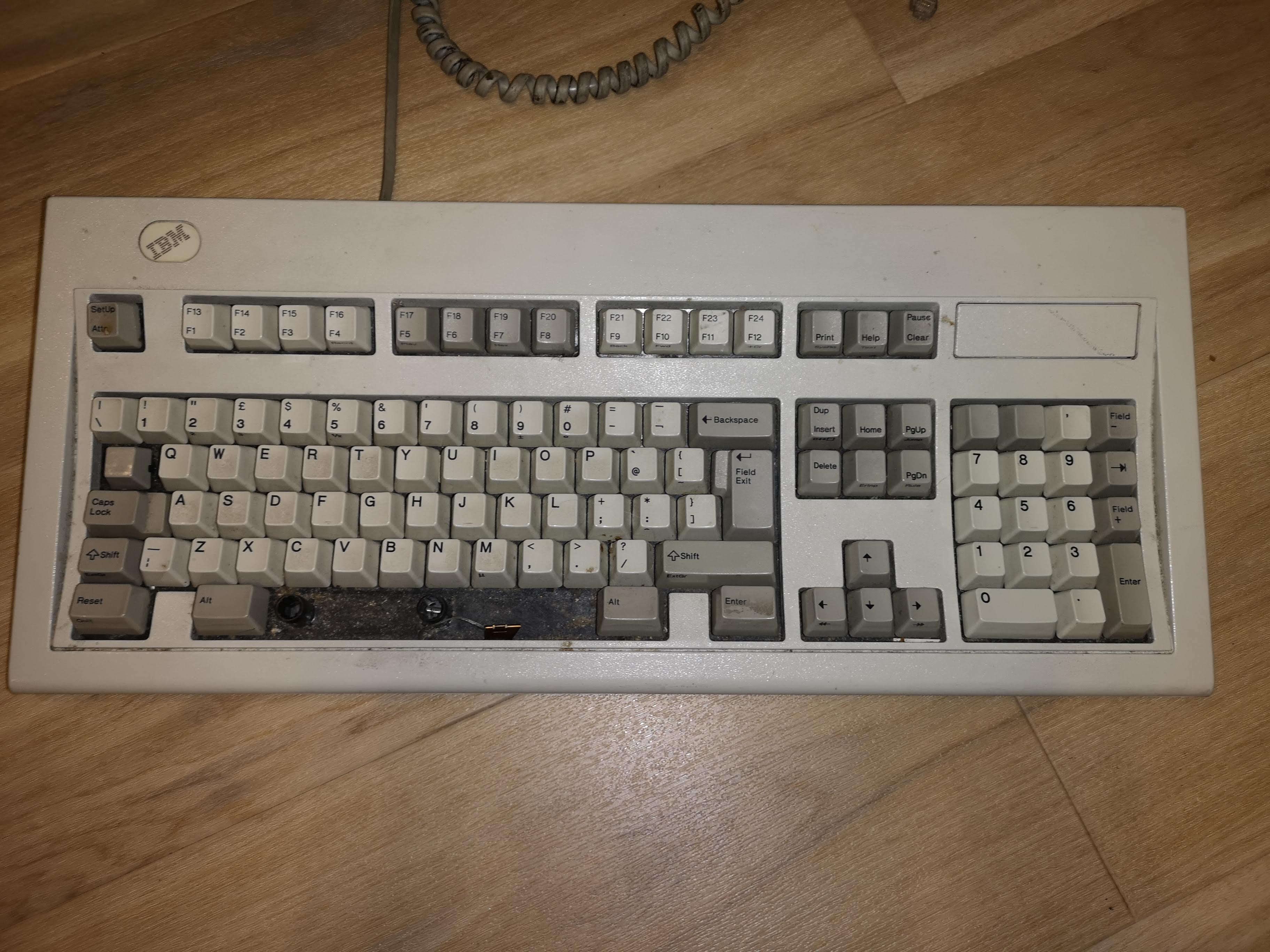

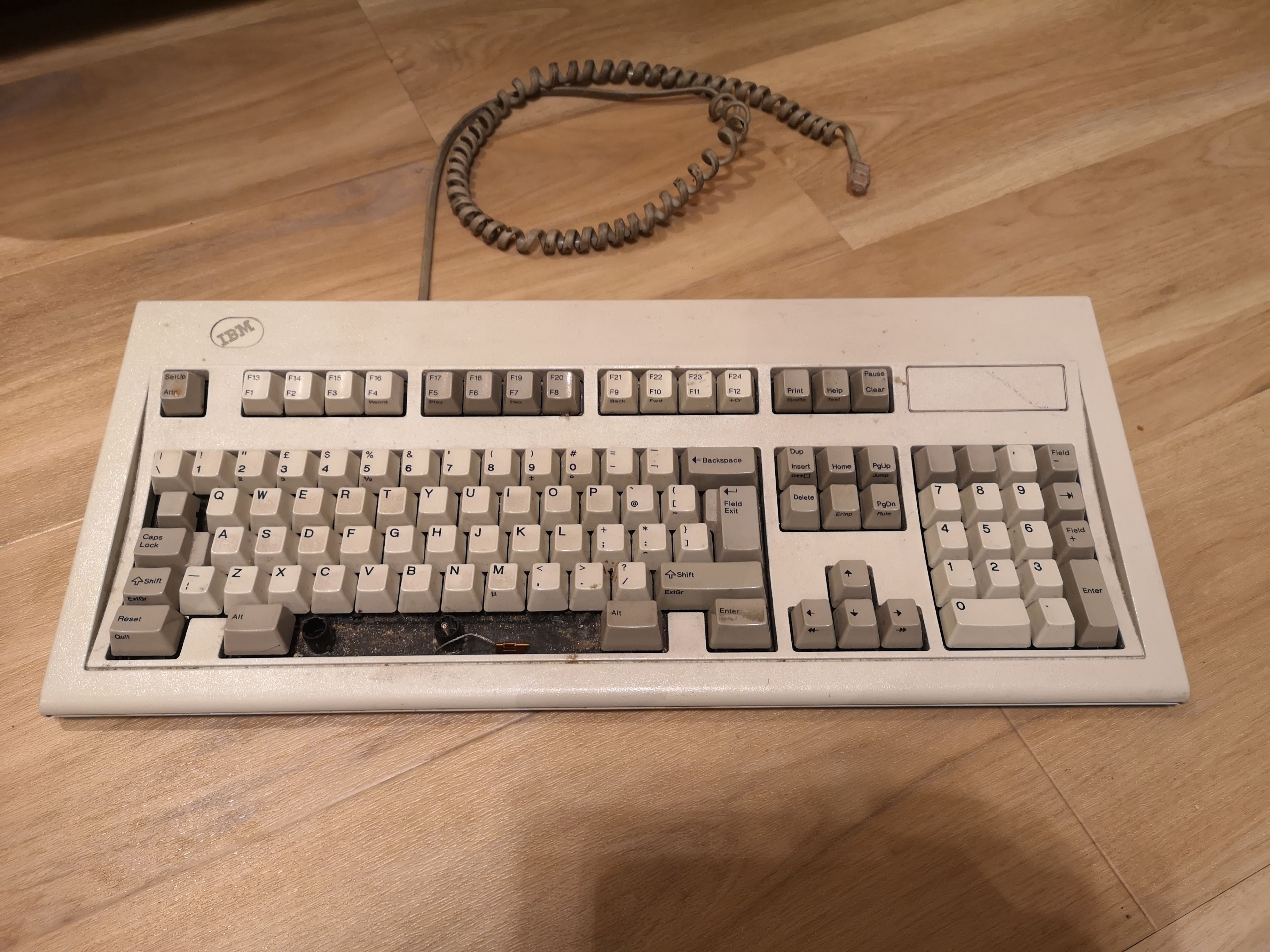

Hi here I present to you probably the worst IBM Model M Keyboard I have ever seen it even has one broken plastic tabs which I have never seen before and I have had about 4 IBM Model M keyboards.
Question I have is if it is worth saving this IBM Model M keyboard given its condition. Please let me know what you guys think I have posted some pictures of the keyboard in question
Thanks in advance for all help on this matter.

I... uhhh... what is the plastic tab that is broken? Do you mean the missing Tab keycap? (if so, it's easy to replace)Fkazim wrote: 01 Mar 2019, 22:03 Hi here I present to you probably the worst IBM Model M Keyboard I have ever seen it even has one broken plastic tabs which I have never seen before and I have had about 4 IBM Model M keyboards.
Non-US terminal keyboards aren't common, and that makes this unit interesting in and of itself. How's it look on the inside? Is the metal plate in good shape? Are the rivets loose? How does the controller look?
I'd need a better picture to fully judge, but seems the area where the space bar sits is in good shape, if dirty. A new space bar can be procured.
Without more pictures to tell me otherwise... I think this unit is worthy of saving — I'd make the effort.

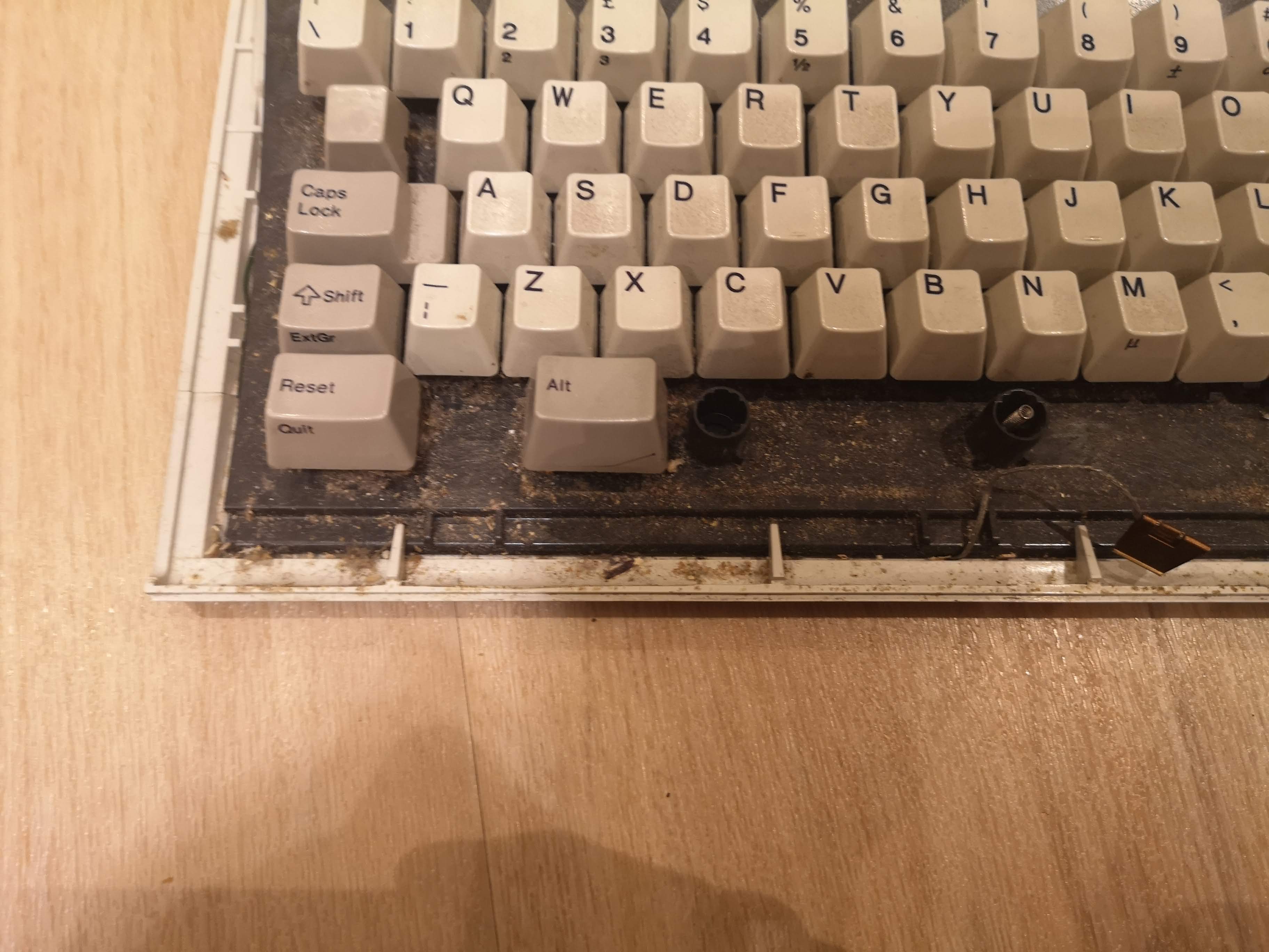

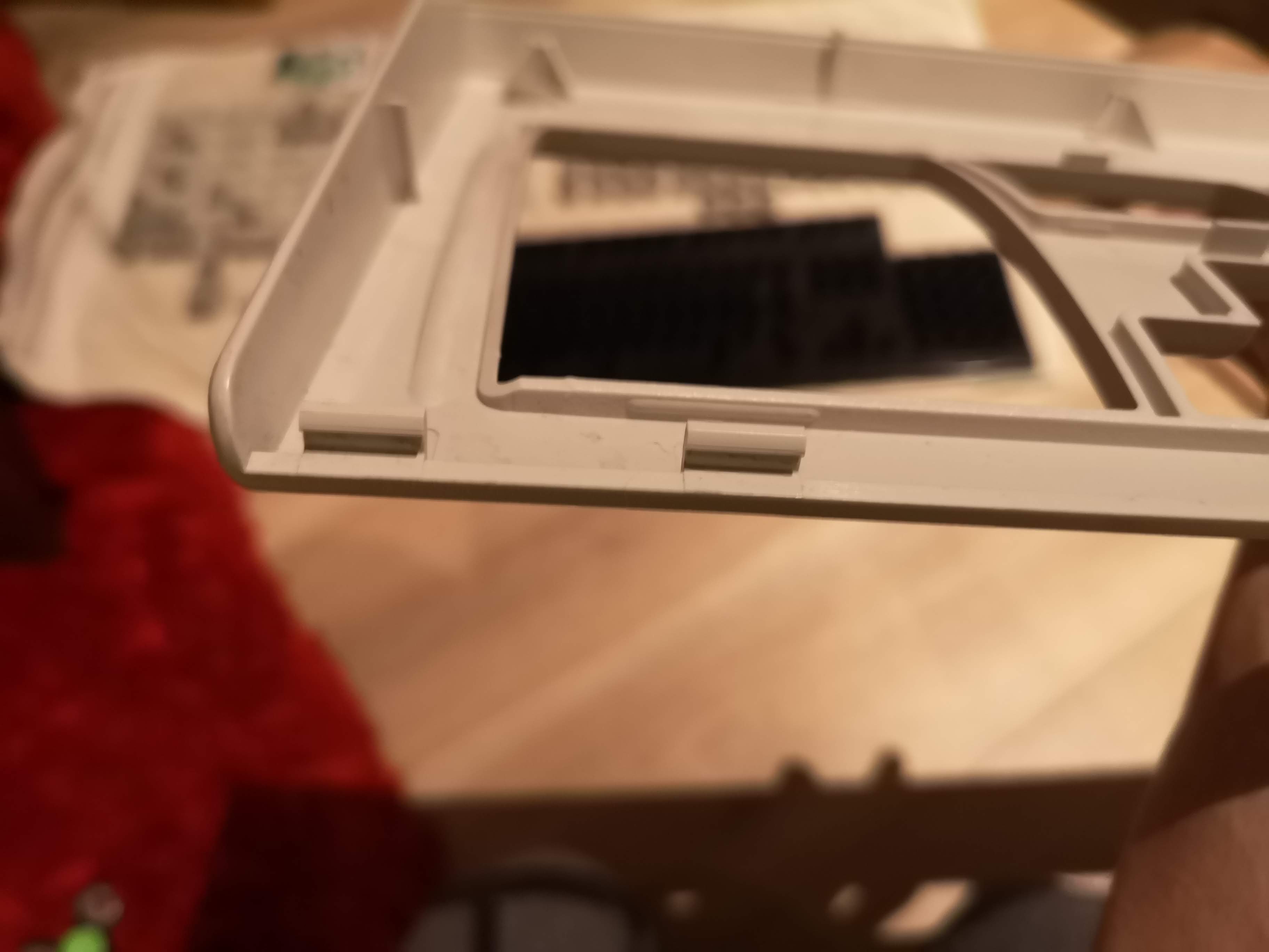

Also the tabs I'm talking about are the things in the picture below let me know your thoughts Thanks.

The easiest way to convert this to USB (not PS/2) is to get a Soarer's Converter cable, like the ones orihalcon sells (I use these all the time).Fkazim wrote: 01 Mar 2019, 22:45 The Keyboard itself is in good condition but really dirty and is full of paper clips, crumbs hair etc which is all fine as it can be cleaned but how easy would the keyboard be to convert to work on PS/2?
What picture?Fkazim wrote: 01 Mar 2019, 22:45Also the tabs I'm talking about are the things in the picture below let me know your thoughts Thanks.

That is the tabs I am talking about the one nearest to the corner is broken and as this is the case the corner where there is no tab is very loose and separates slightly when the keyboard is picked up.

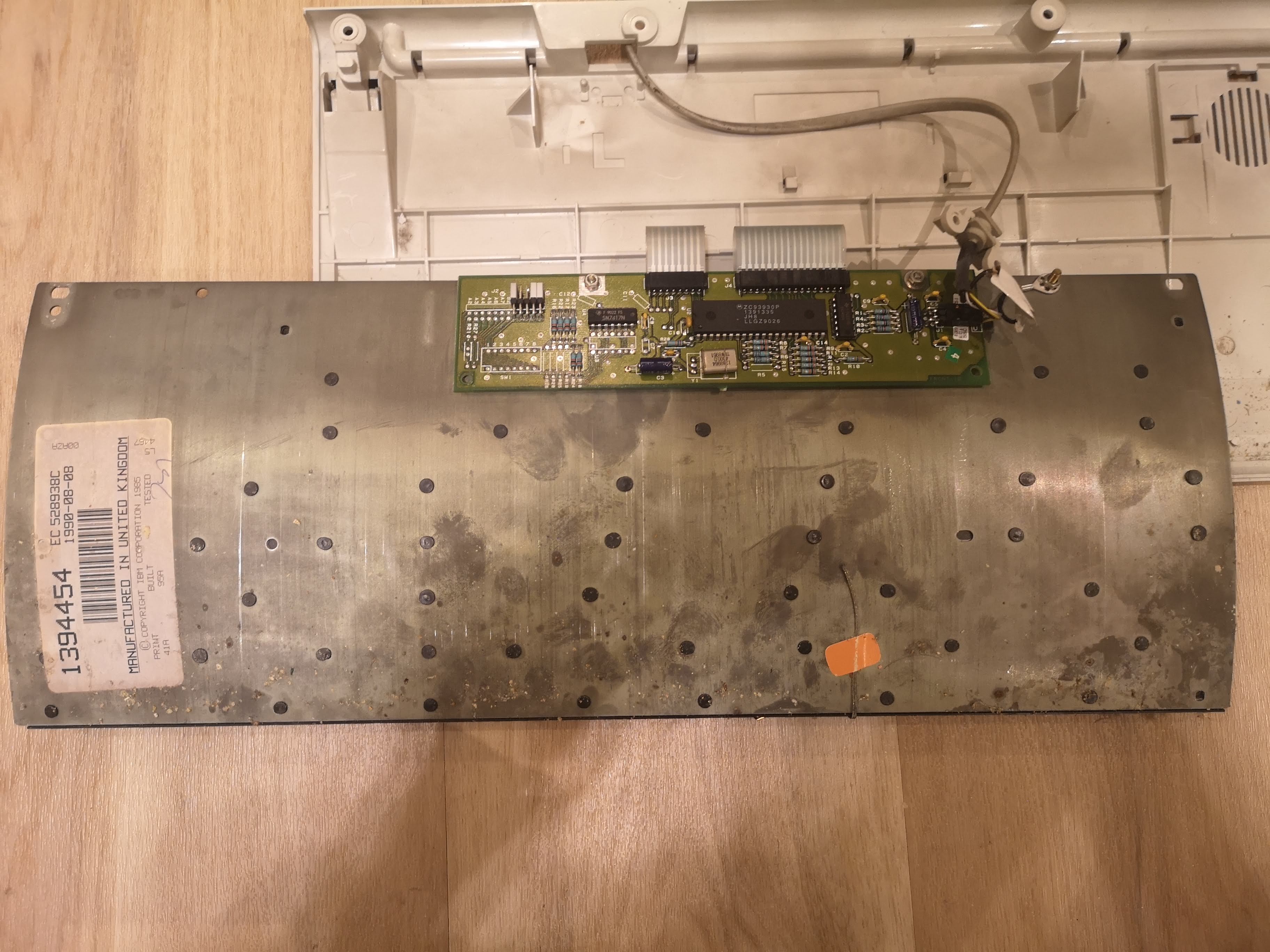

Here are the pictures you were asking about please let me know everything you know from the pictures really appreciate it

Looks in fairly decent condition. Clean it, repair the few things that do need repairing, get replacements for tab and space, and enjoy this quirky keyboard for the decades to come!
