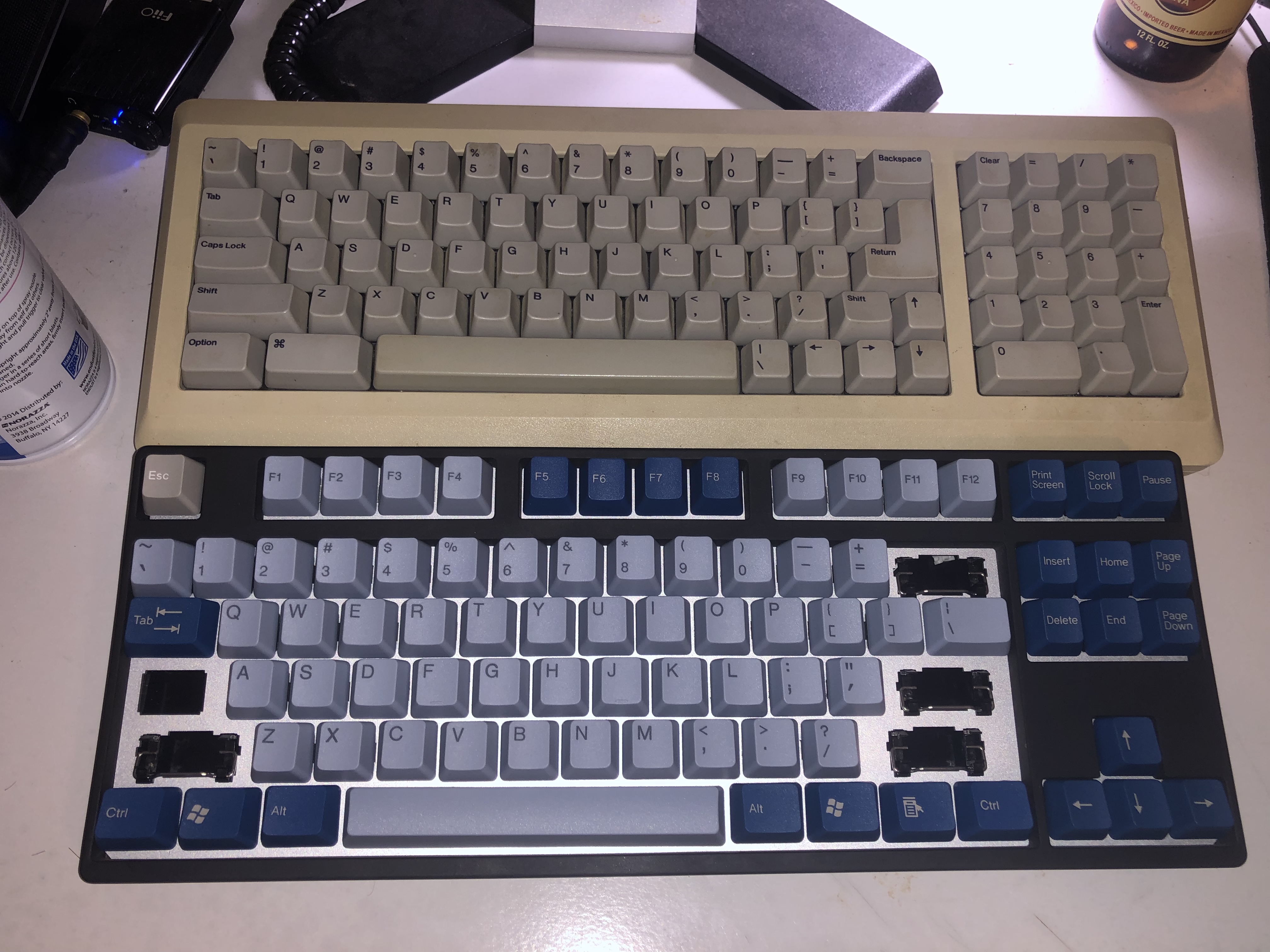

Alright here’s is a picture with all the keycaps off and uncleaned. I am getting a solder sucker and the mail tomorrow and will begin working on it. Also, I’m not sure what I’ll end up doing with the rest of the //c but if I decide to let it go I will be in touch. Tonight I will take apart as many switches as I can and begin cleaning everything before I desolder.
Hopefully the picture attaches properly.

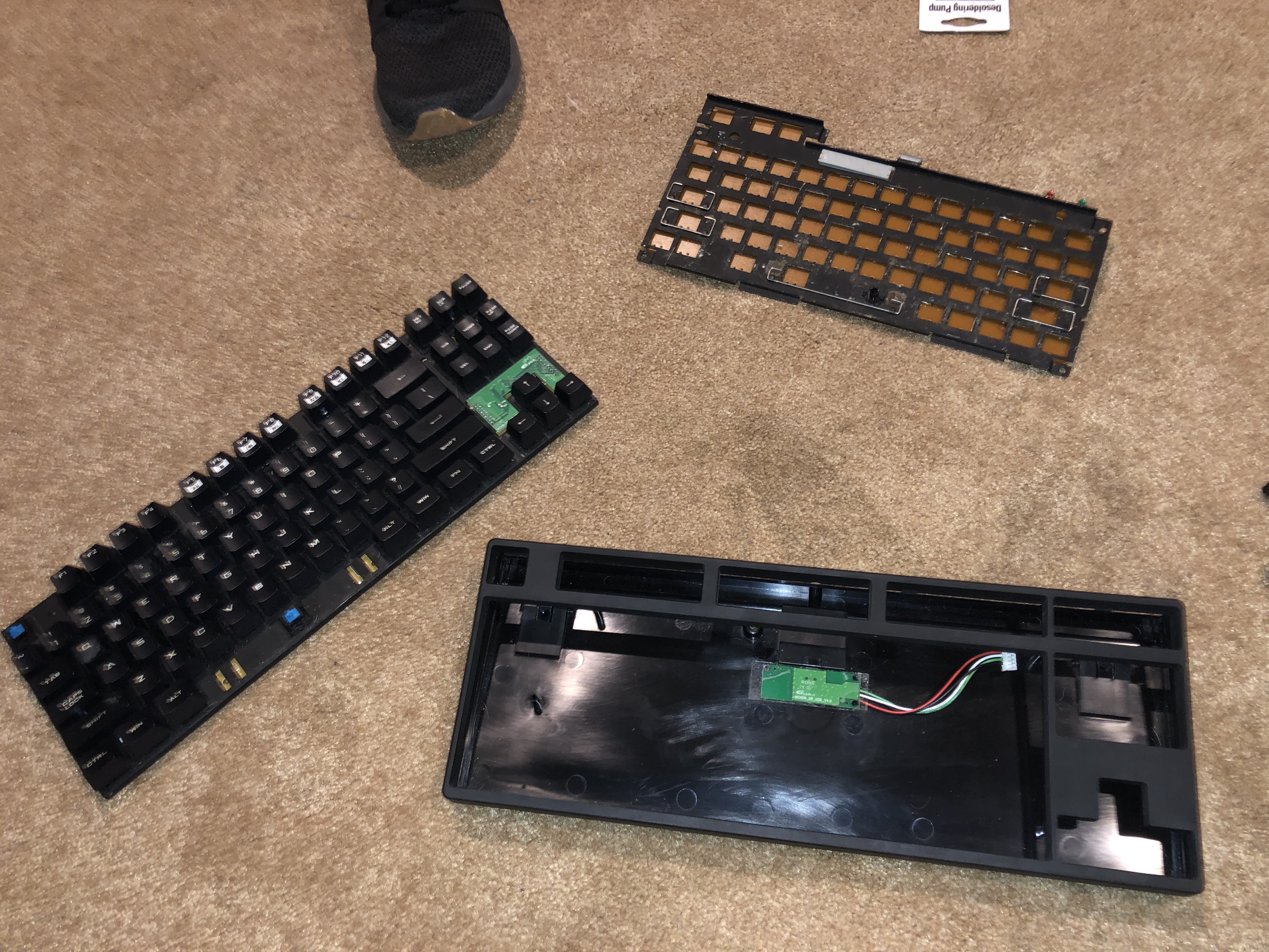

After some very tedious work, I was able to get all of the switches removed and cleaned. I chose not to lubricate the switches and just used compressed air to get any dust out and they feel plenty smooth. I don’t think they were used a whole lot to begin with. Here are some pictures of the switches, and the cooler master case that they will be going into eventually. I plan on painting it a semi-gloss gunmetal grey color. Most of the components with the exception of the PCB will be arriving on Tuesday. Hopefully the PCB doesn’t take too long, I’m very anxious to complete the build.
