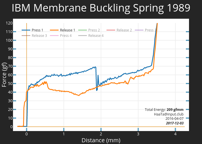

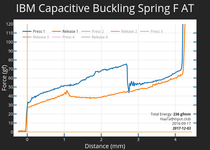

Back to tactility, here are the force-displacement curves produced by HaaTa for IBM membrane buckling spring and IBM F-AT switches:
According to these plots, the total energy (area under each blue curve) and the actuation force are somewhat higher for the F-AT than for the Model M. In addition, the actuation event occurs "later" (further along the displacement axis) for the F-AT than for the Model M. However, the overall shapes of the curves are quite similar between the two switch types. In particular, the "buckling event" is reflected by a very sharp drop in force of similar magnitude for both switch types. However, something not illustrated by such curves is the "scratchiness" of a switch. My impression is that the Model M switches feel scratchier than Model F switches. I tend to interpret the relative absence of scratchiness in the Model F switches as enhanced "crispness".

That said, the graph above, and FWIW both appear to take the same amount of stacked nickels before spring collapse cannot be avoided.
Surprising to me...
Surprising to me...

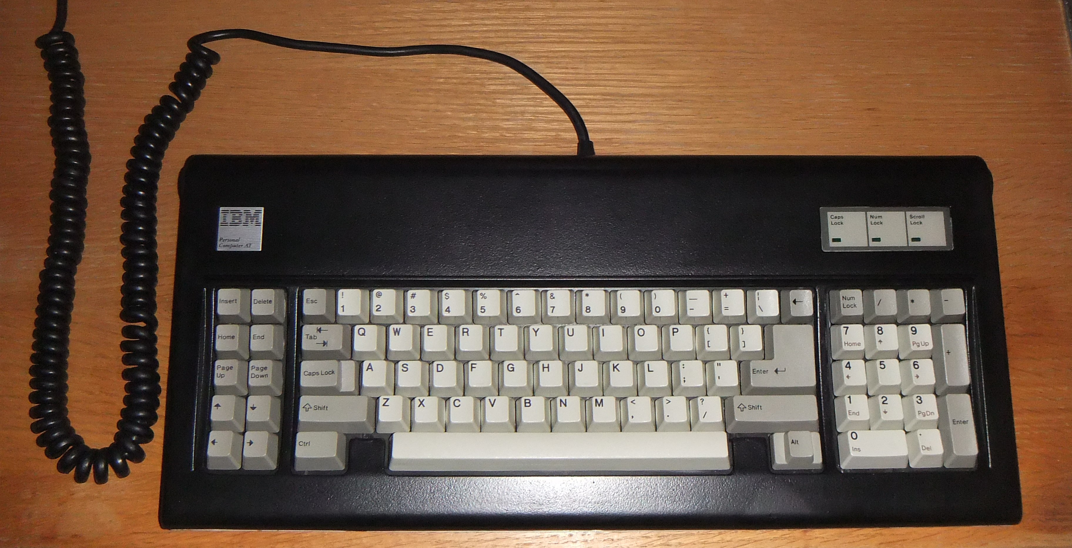

Looks good. I personally find the Big Ass enter keys to bind a lot in the upper area. Yet my F-AT still has it. I don't think the big space bar aside from the annoying method to re-seat it is that bad. I quite like it. The shorter Model M and F122 space bars are much more rattle prone.

Thank you. Actually, I hadn't noticed the upper edge of the enter binding until just the other day when I inadvertently pressed there. Sure enough though.SneakyRobb wrote:

-- A little more on this on this holiday weekend here --
The keys are mostly from an early '87 1390131. (The earlier, inkier, keys being a better match to the remaining F AT ones.)
Replaced the function keys with the navigation section after seeing the 5251 in Chryos's wonderful videos and other early boards. It's admittedly just a supplement to the main navigation, but useful. (Function keys now assigned to the numbers with the left upper corner Insert actually being an Fn key.)
Ideally, would prefer the Ctrl key in the original position, but had to move it to the Model M position as it was causing me issues with other boards. This created a false symmetry with where I have the Alt key, which I broke by restoring the original Alt key.
Whereas I was able to enclose my early bolt modded M in an M13 case, I had to paint the F AT to match my system. (However, IBM had painted it so I guess that's ok.)
Generally, I attempted to extend the symmetries consistent with IBM's early designs.
(Connected through a Soarer's Converter. Certainly wonderful that it takes these early boards and makes them fully programmable with NKRO...)

I think the graphs Hypersphere posted sum it up perfectly. You can clearly see that the tactile drop on both is about the same, but the F's force curve is much more uniform and smooth. That lack of inconsistency gives a tauter, smoother, and overall more refined feel that brings out the tactility more.
