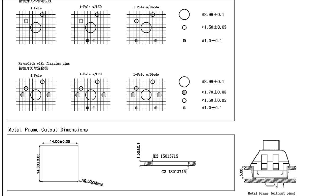

Switches are NovelKeys x Kailh BOX Thick Clicks Navy. Looking at the data sheet it seems they need square holes but I honestly have no idea how they are supposed to "mount" to the plate with the square hole. It appears they press fit between the small tabs on the body ?
I am familiar with KiCad as I've used that before for a totally different project for a simple Hakko solder tip holder. As stated, no traces required for that but was just an exercise to learn KiCad. Relearning 5.0 release now.
The PCB aspect doesn't phase me as much as figuring out the matrix right now. The way the keys angle in a ANSI 104 kind of throw me off as to how they should be connected to the matrix. Looking at matt3o's BrownFox wiring kind of gives me an idea but it's still unclear how to choose the right paths for the columns.

Don't use BOX switches! The cruciform shapes are too thick and have been shown to break keycaps' stems! There are several threads about this.
Yes, the switches are supposed to clip into the plate with the small tabs on the north and south sides of the switch. These are (supposed to be) are on plastic springs that are part of the switch housing.
The use of the clips require the plate to be 1.5 mm thick. If it is too thick, they won't work and it will only be a press-fit (the tabs will be pressed in all the time).
Not quite. The unit is 3/4 of an inch, where an inch is 25.4 mm. That makes one key unit 19.05 mm.
It does not seem like much but when you have more switches and keys that are multiple units, it adds up.

What I'm wondering now is where to find information on spacing for proper placement of the footprints on the PCB to make sure the keys line up properly and don't touch each other.
I'd like the pcb footprint placements to match the hole placements of the plate that swillkb spits out.
