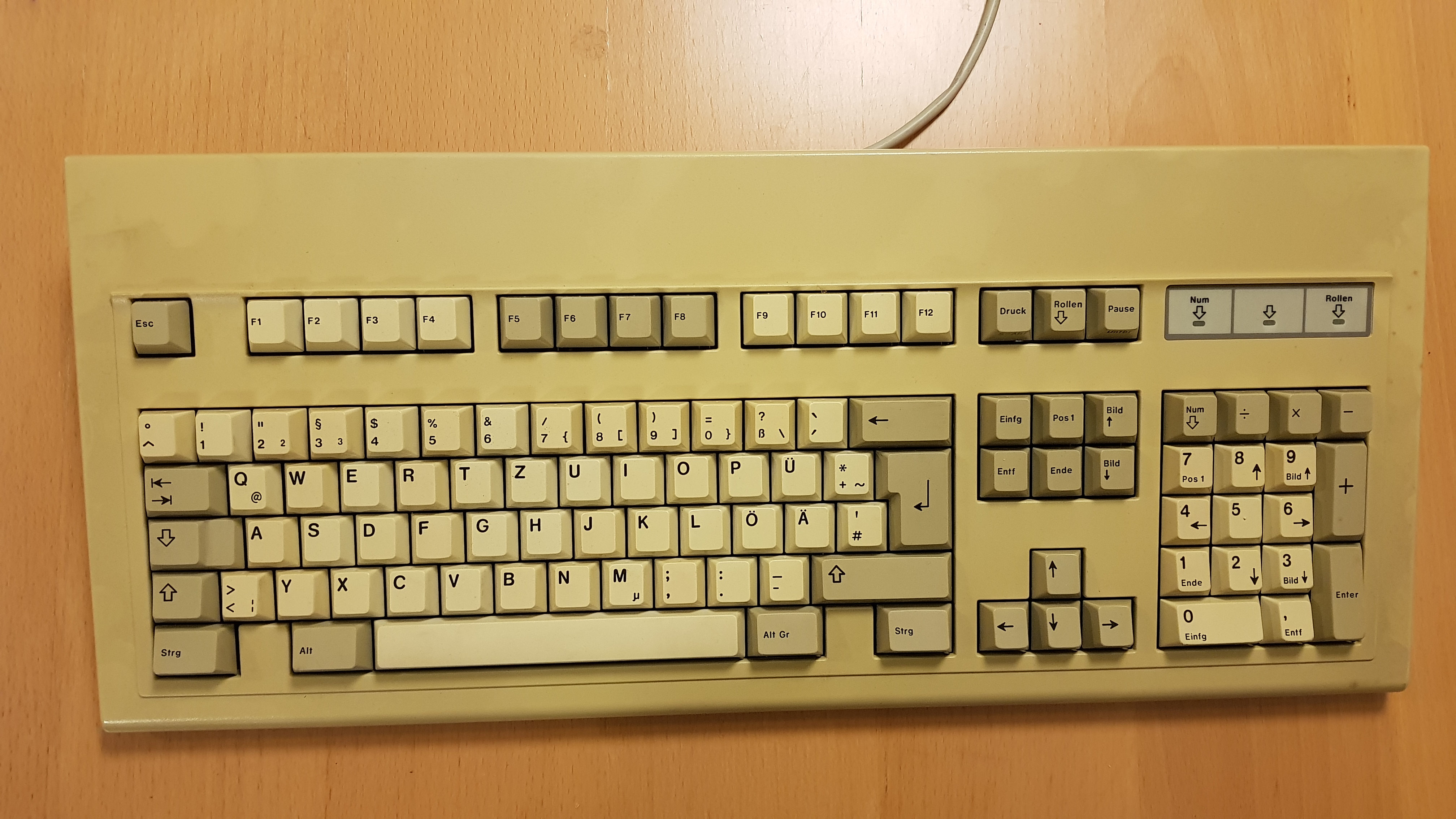

since I collected Cherry keyboards in the late 90s, I stored some in a box in my cellar. A few weeks ago I found a Cherry G80-1000 HAD, manufactured B02 (in 1989) - made in West Germany. It has 3 modes PC/XT, AT02, and MF and should work via DIN to PS/2 connector today.
It was not in bad shape, but the ABS was very yellowed since the time I picked up the keyboard (somewhat around 1998).
G80-1000 HAD (1989) - yellowed ABS
G80-1000 HAD, type platze

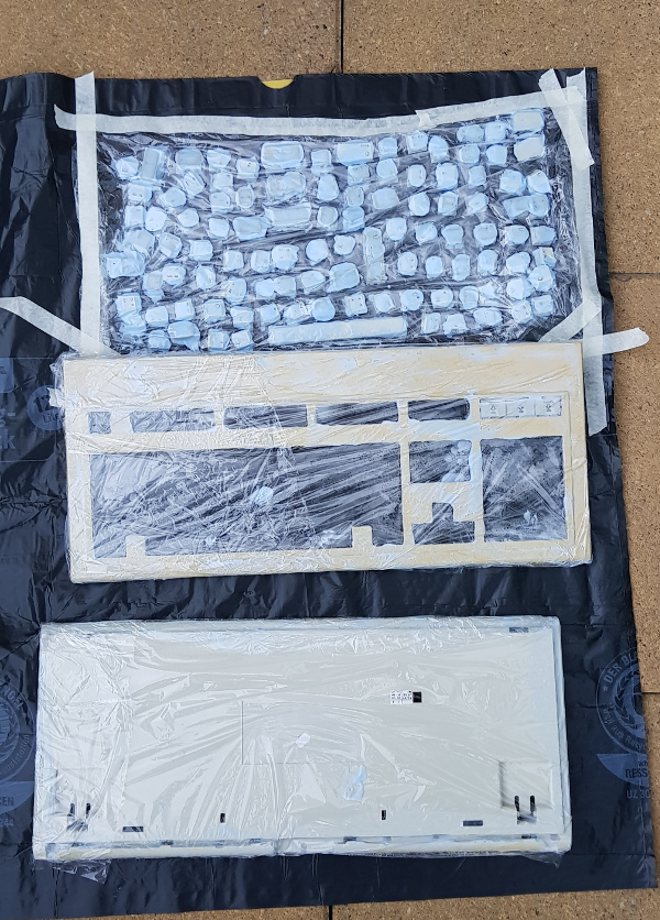

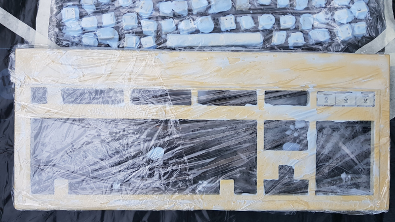

So: what to buy in Germany? I looked for a German and easy option and went to a local shop for hairdressing supplies and bought "Cosmo, Profi-Hair" (Oxy creme 12%) and blonding powder I mixed the creme and the powder about 1:1/3 and followed the regular Retr0bright procedure: apply to ABS, wrap in plastic wrap to prevent drying out (and keep the mess a little bit less messy) and exposed to the sun almost the whole day - in early February :-).
Bleaching the ABS
Bleaching the ABS
The weather that day in February 2018 was sunny, but cold, around 5 degrees Celsius (41°F).

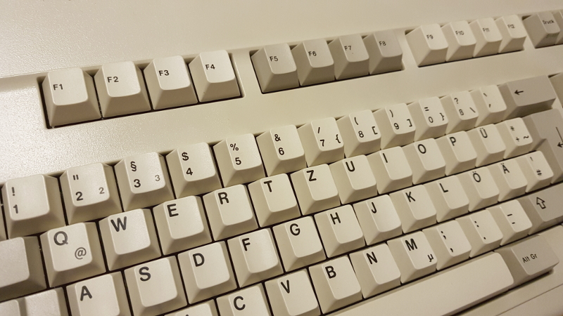

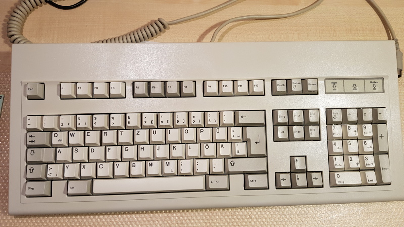

Almost new G80-1000 HAD
Detail
Detail
I was very much surprised and happy.
After cleaning off the bleaching residue I tested the keyboard. All keys work, also the LEDs.
