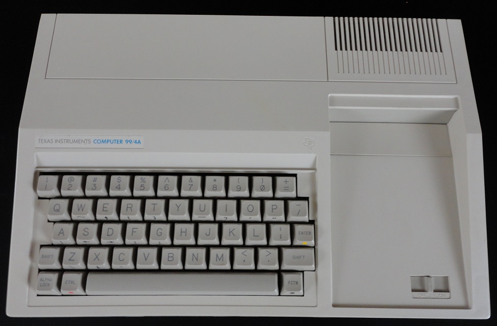

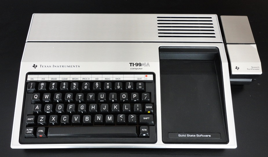

That's interesting. The key layout, legends and the ribbon looks like a TI-99/4A, but different color from what I've seen.
EDIT: Ahhh, maybe this one:

Ahhh, I forgot that thing. Smeels like Futaba, but I think they aren't

That's the General Instrument keyboard. All the relevant photos are all gone from the DT topic (yet again, same old story, same old community failure) and the pictures on the nightfall crew site were on some article that seems to have been lost or erased -- however, looking at their picture you can see the switches clearly from below.
The switches are [wiki]General Instrument Series S950[/wiki], type S95010 E9.
