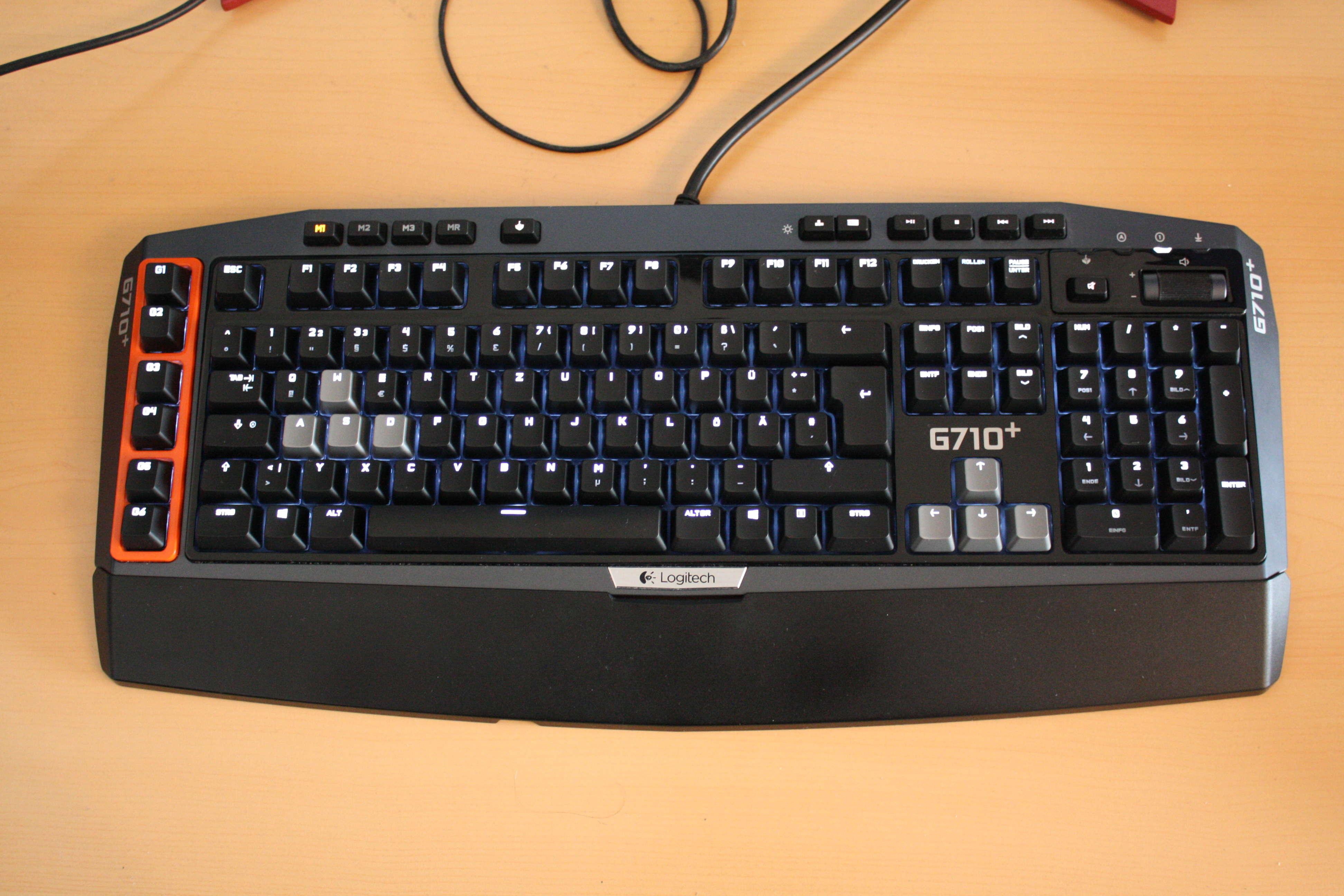

This is my keyboard prior to the modification:

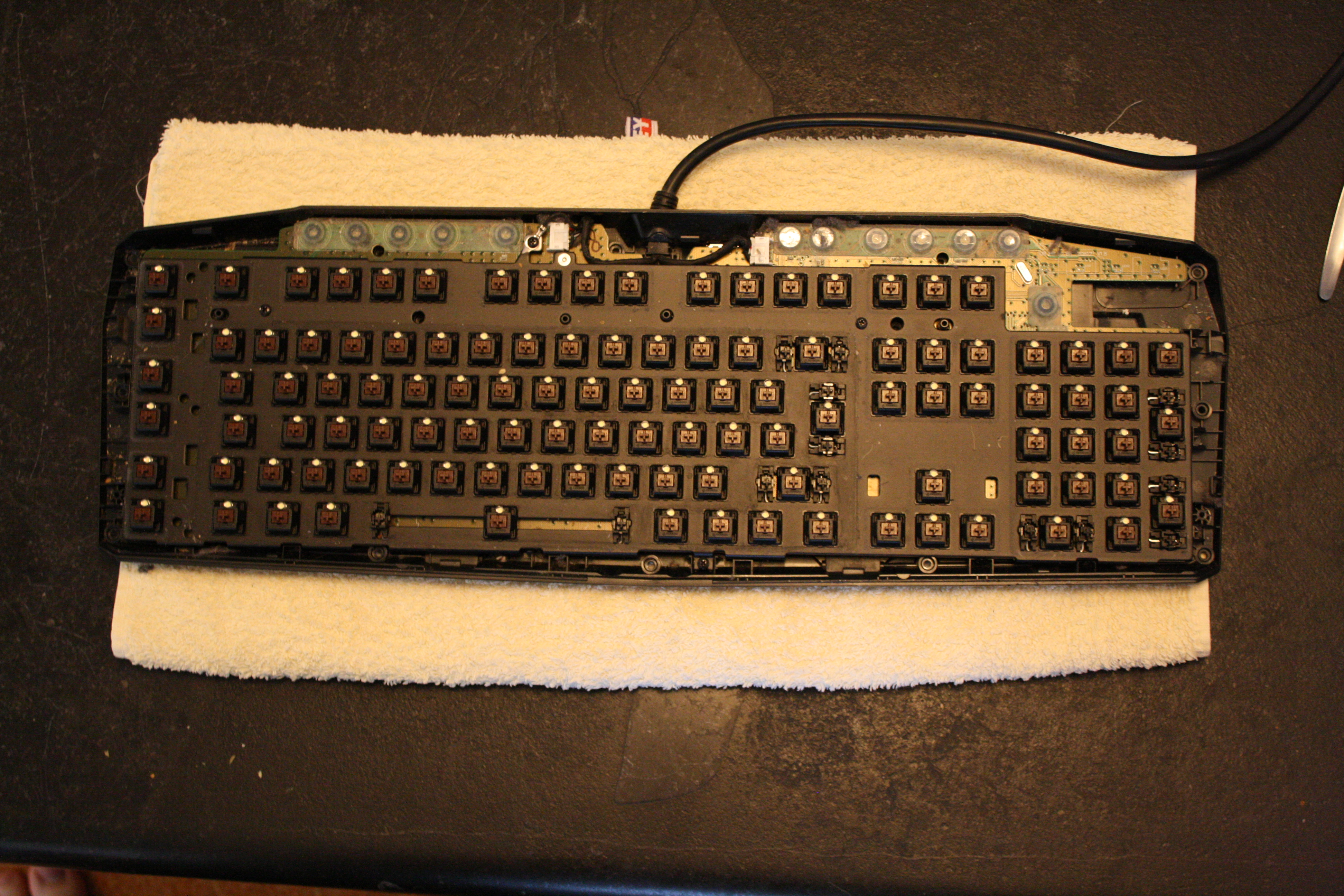

After removing all the keycaps, 14 screws had to be loosened to remove the top casing. In addition to the screws, it's also fastened by about 10 clips that are spread around the outer edge of the case. Those can break off quite easily. Additionally, the volume wheel cable needs to be removed. This is quite easy however.
In the next step, I removed the rubber dome pads for the media keys, the four additional screws holding the PCB in place. Then, the PCB was loose and after removing the USB cables, I could take it out.

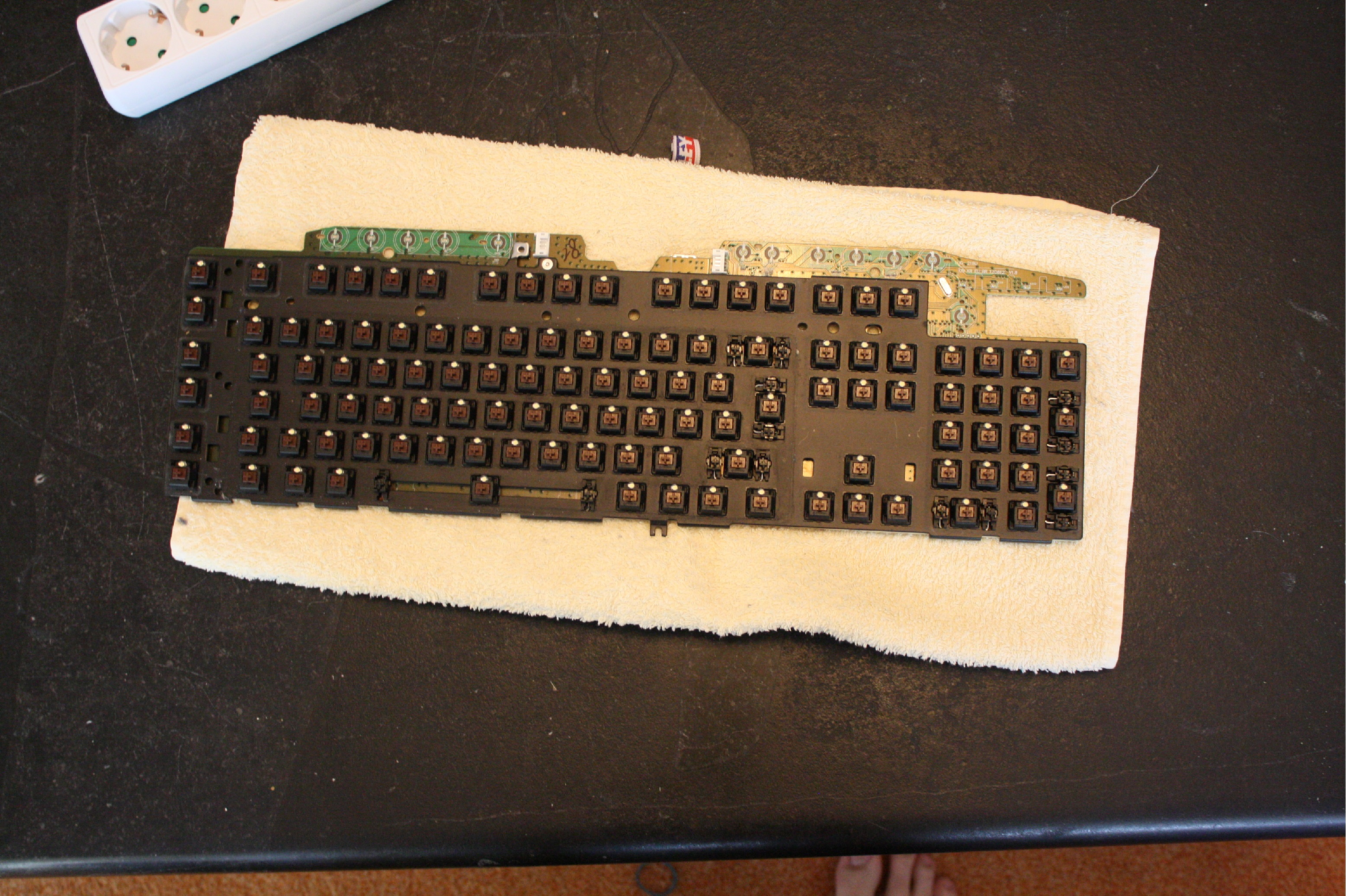

Then it was time to desolder the LEDs and the keys themselves. I used a manual desoldering pump to do that, which took about 2 hours in total. The switches could then be removed with a set of pliers by pressing in the two small clips on their front side and just pulling them out.

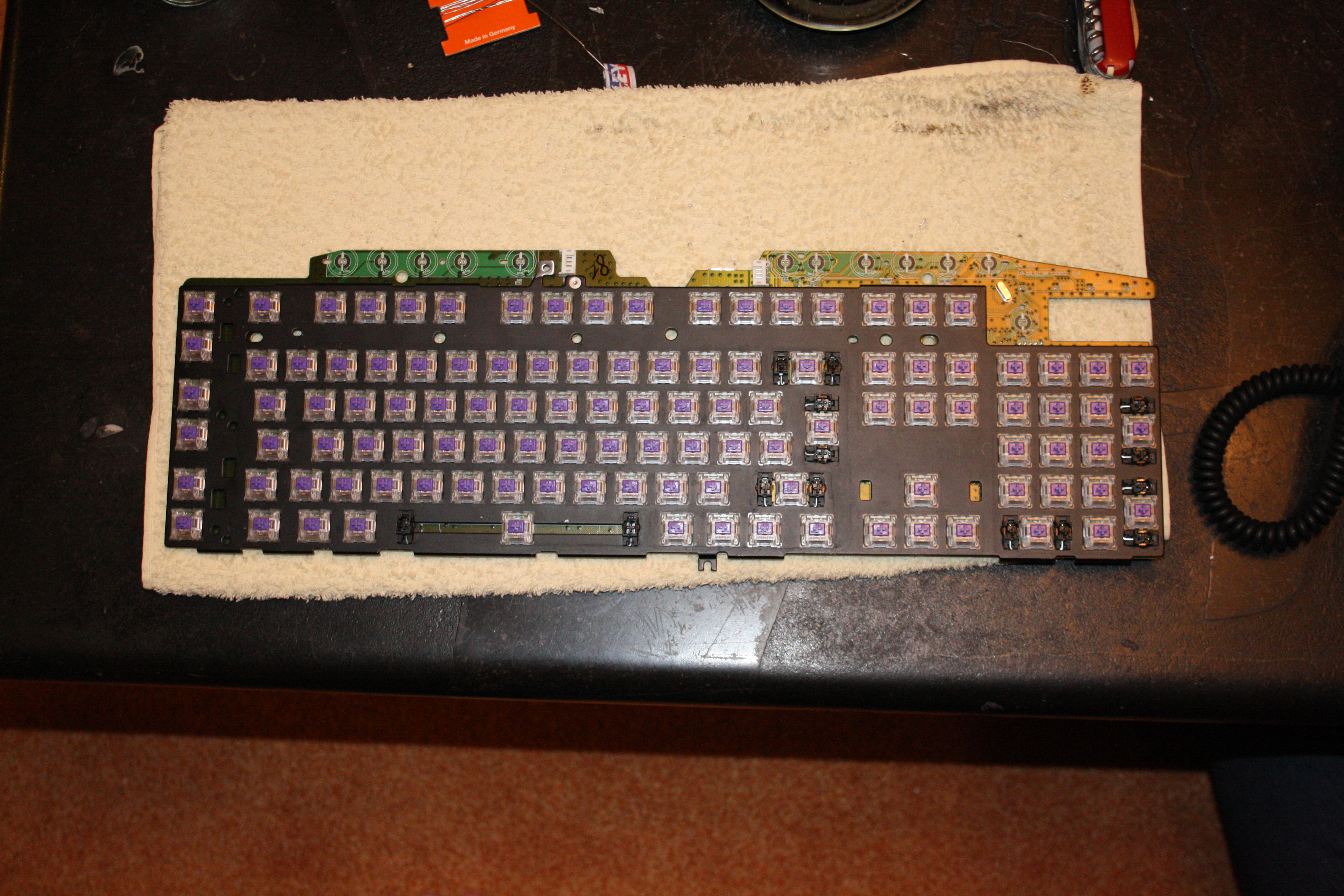

Then it was time for the Zealios. They simply snapped into place. After soldering them in the keyboard looked like this:
Soldering the LEDs was easy as well, as I had taken photos of their orientation prior to the project. I reused the original LEDs, as I didn't want the appearance of the keyboard to change at all.

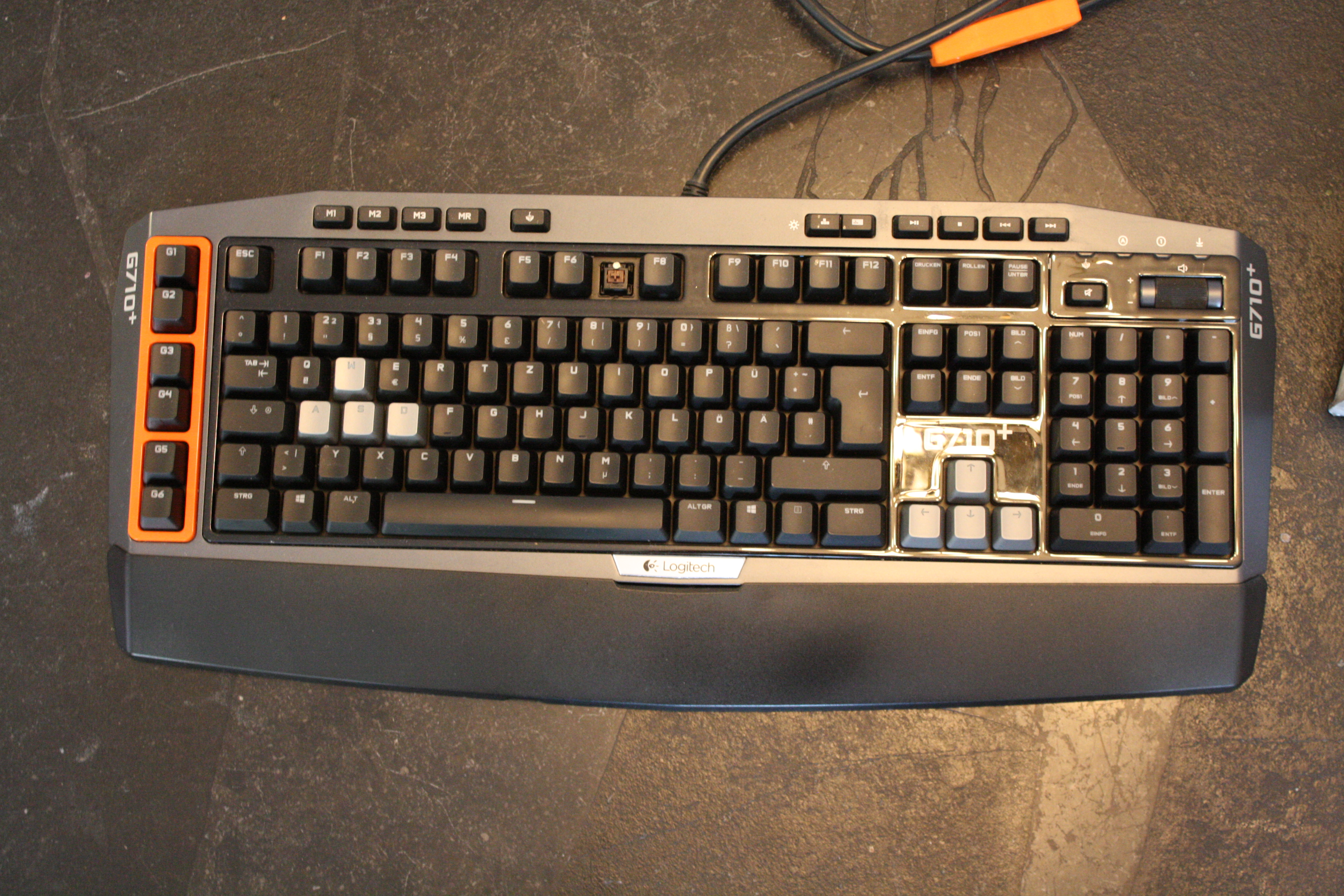

After reassembly, I ended up with this truely unique Logitech G710+:

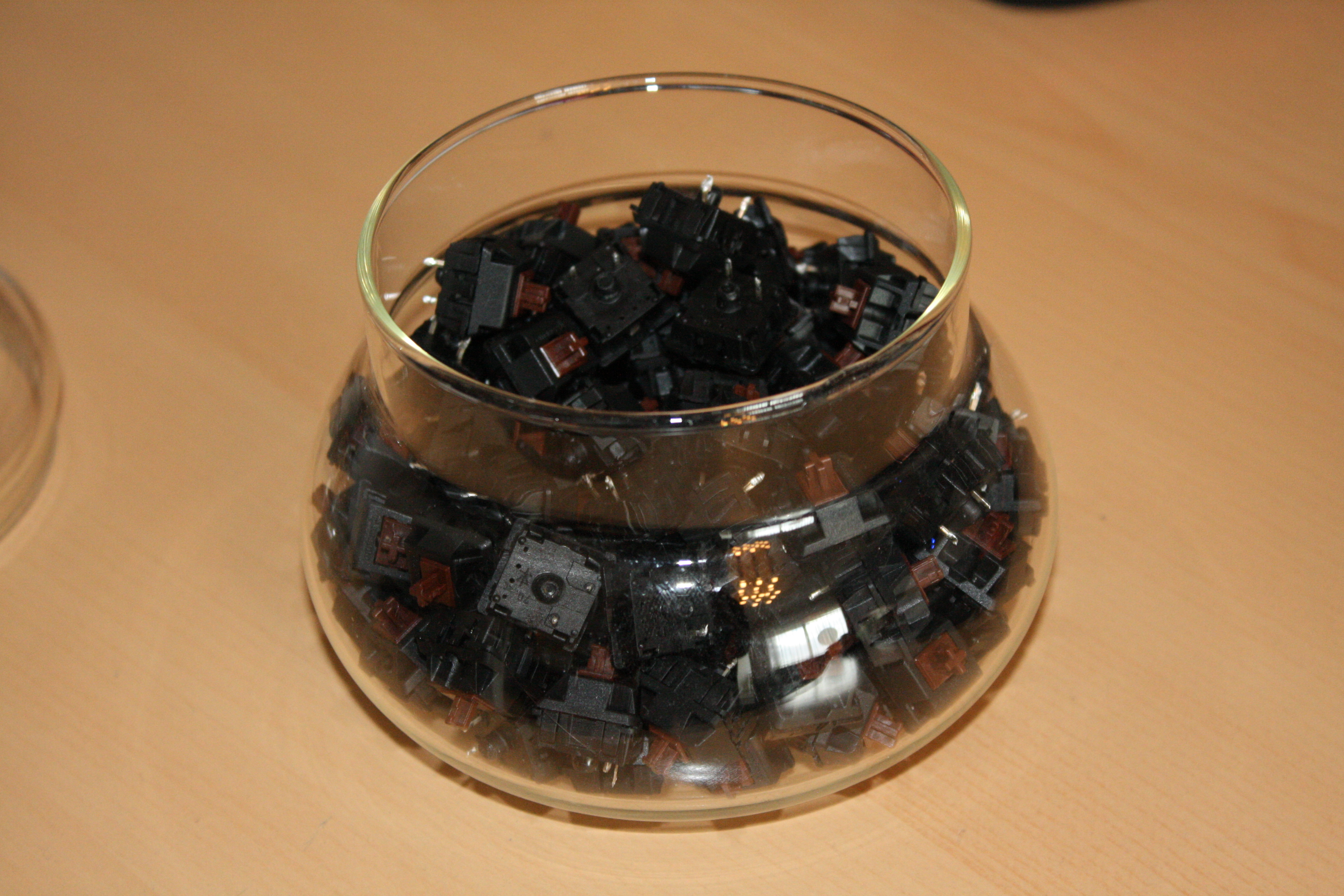

Oh, and of course a jar of dirt. No wait, those are MX Browns:
