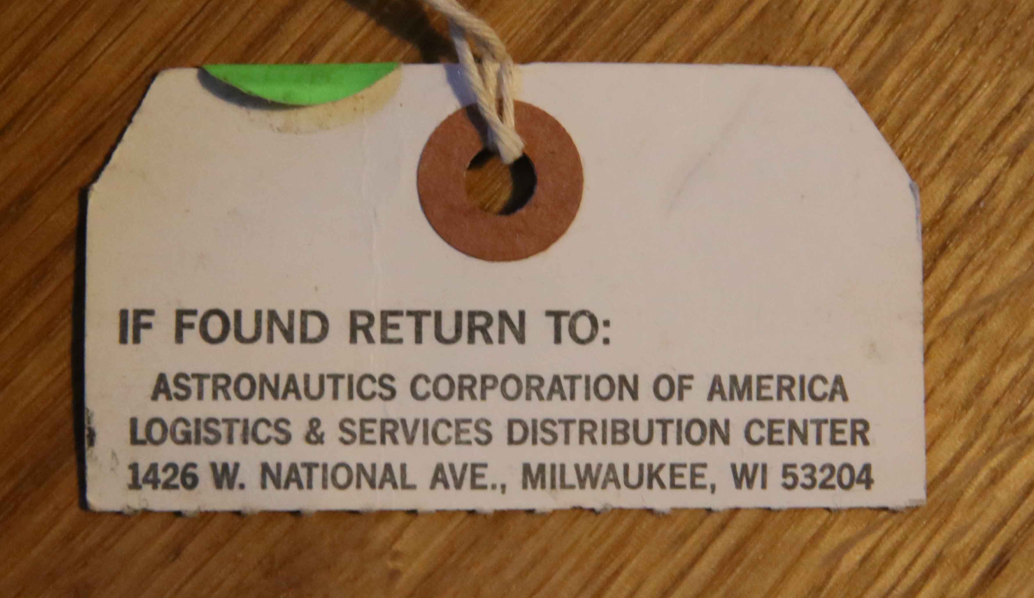

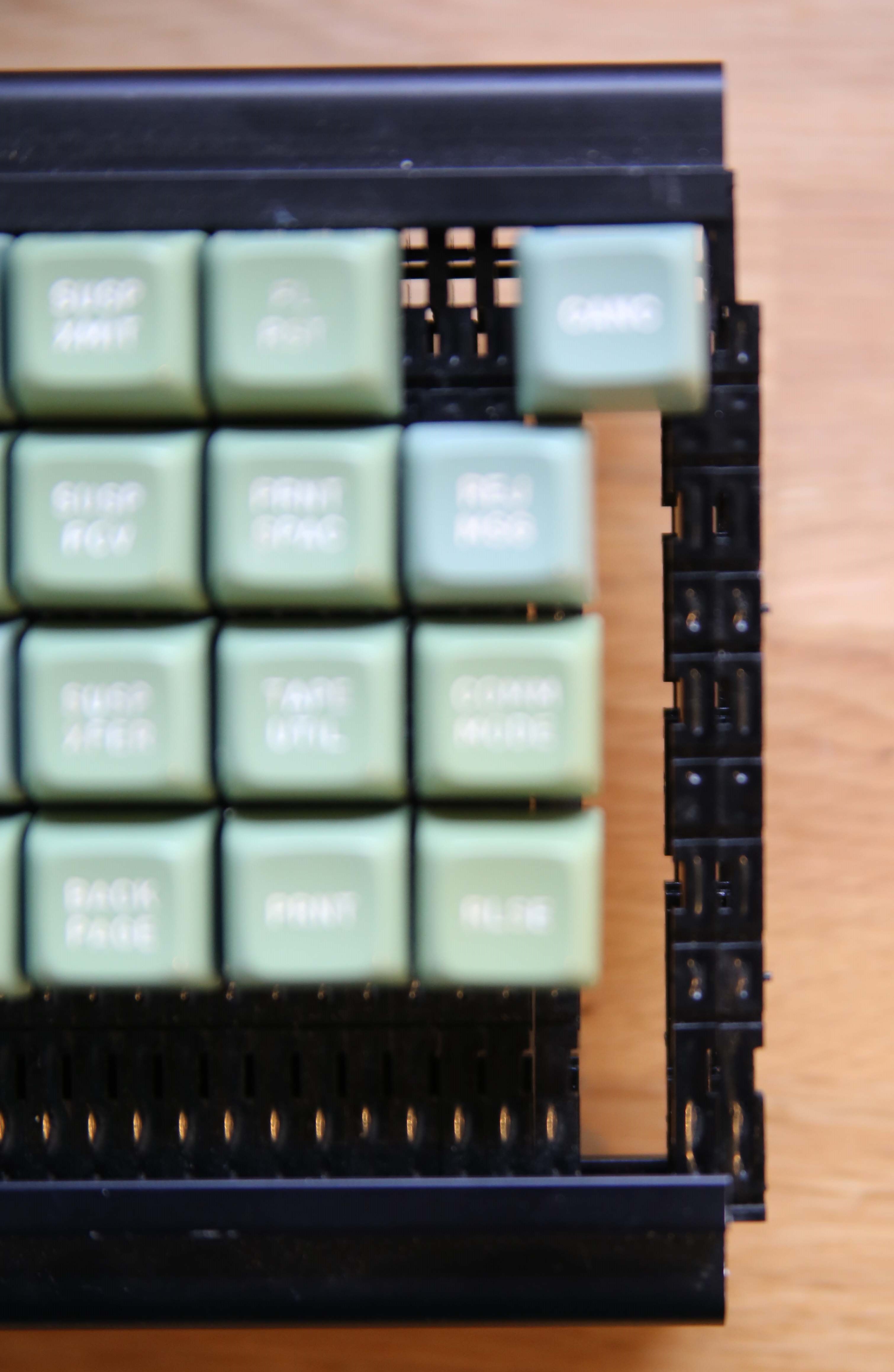

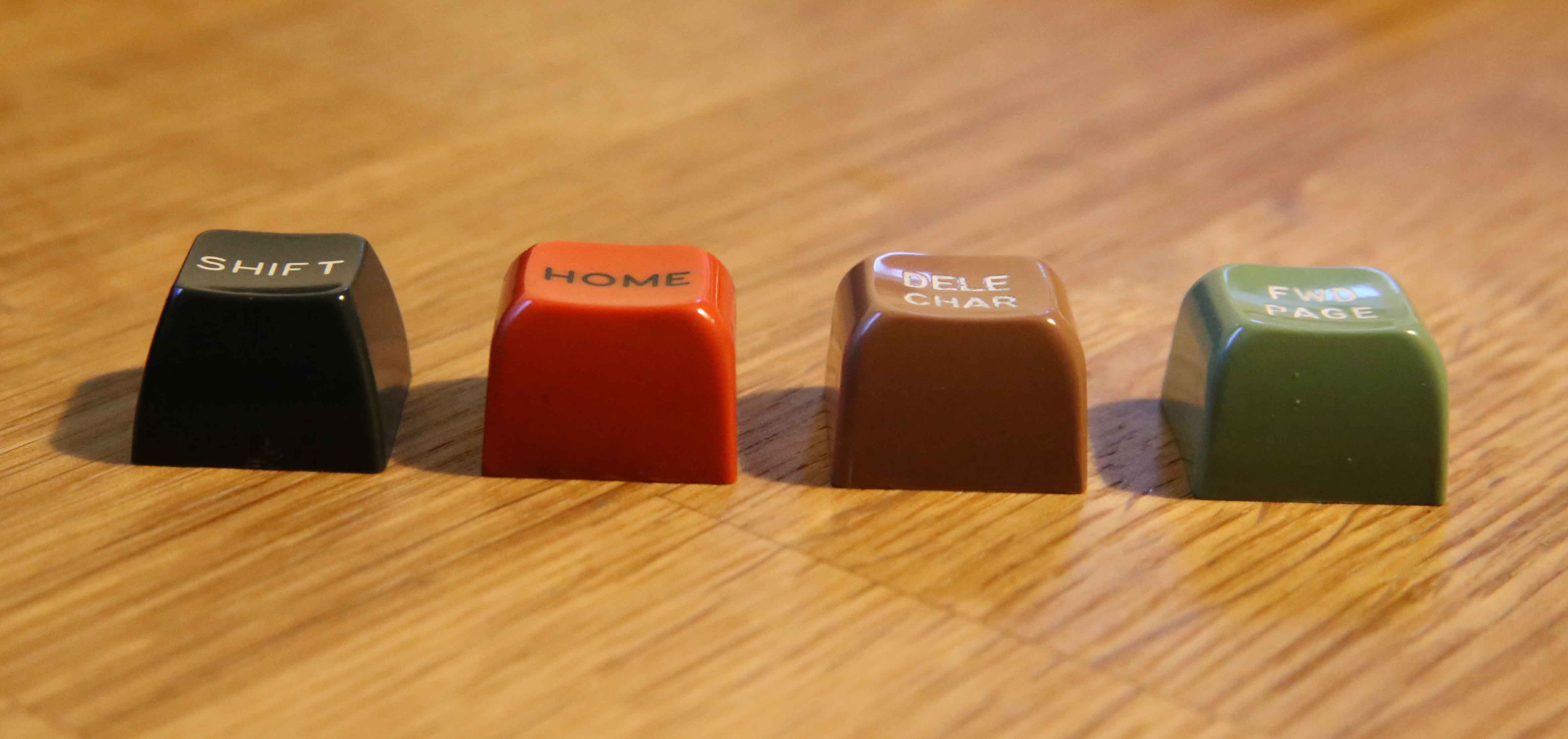

I found a few days ago this keycaps on the flee market. There is a small tag indicating to return it to the Astronautical Corporation of America (see pics). There caps have two different "switch-docking-part" (I'm new here
Astronautical Corporation of America / Help Identify
- Hypnotoad
- Location: 69126, BW, Deutschland
- Main keyboard: Pok3r
- Favorite switch: MX-Blue

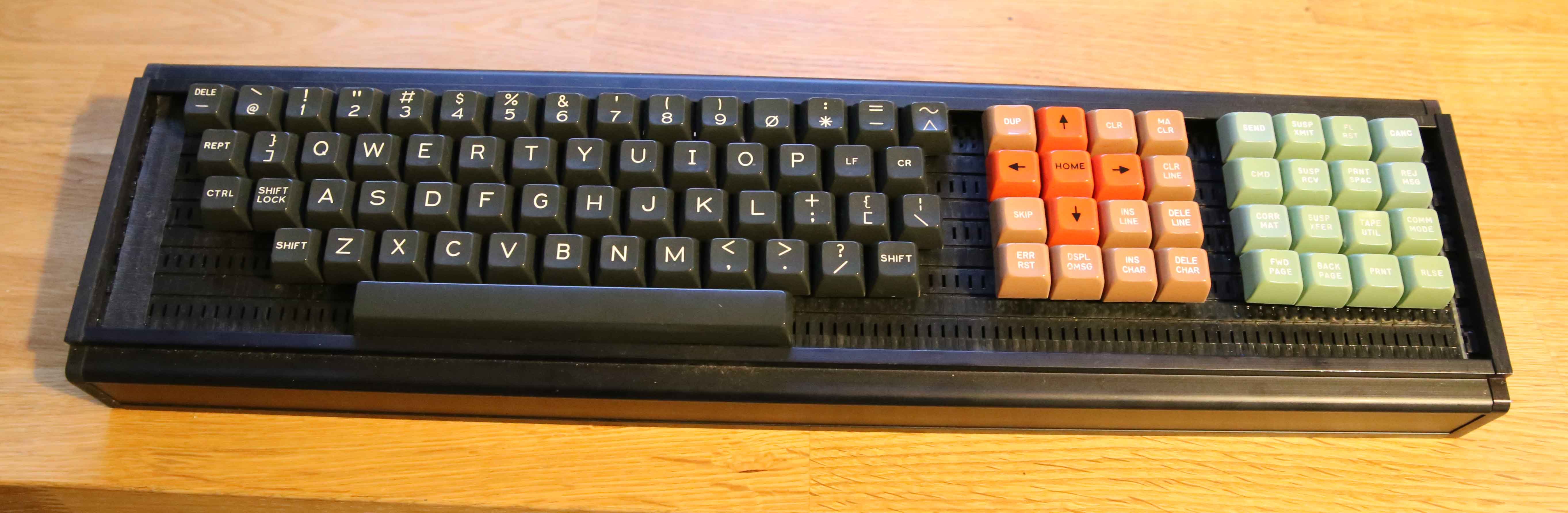

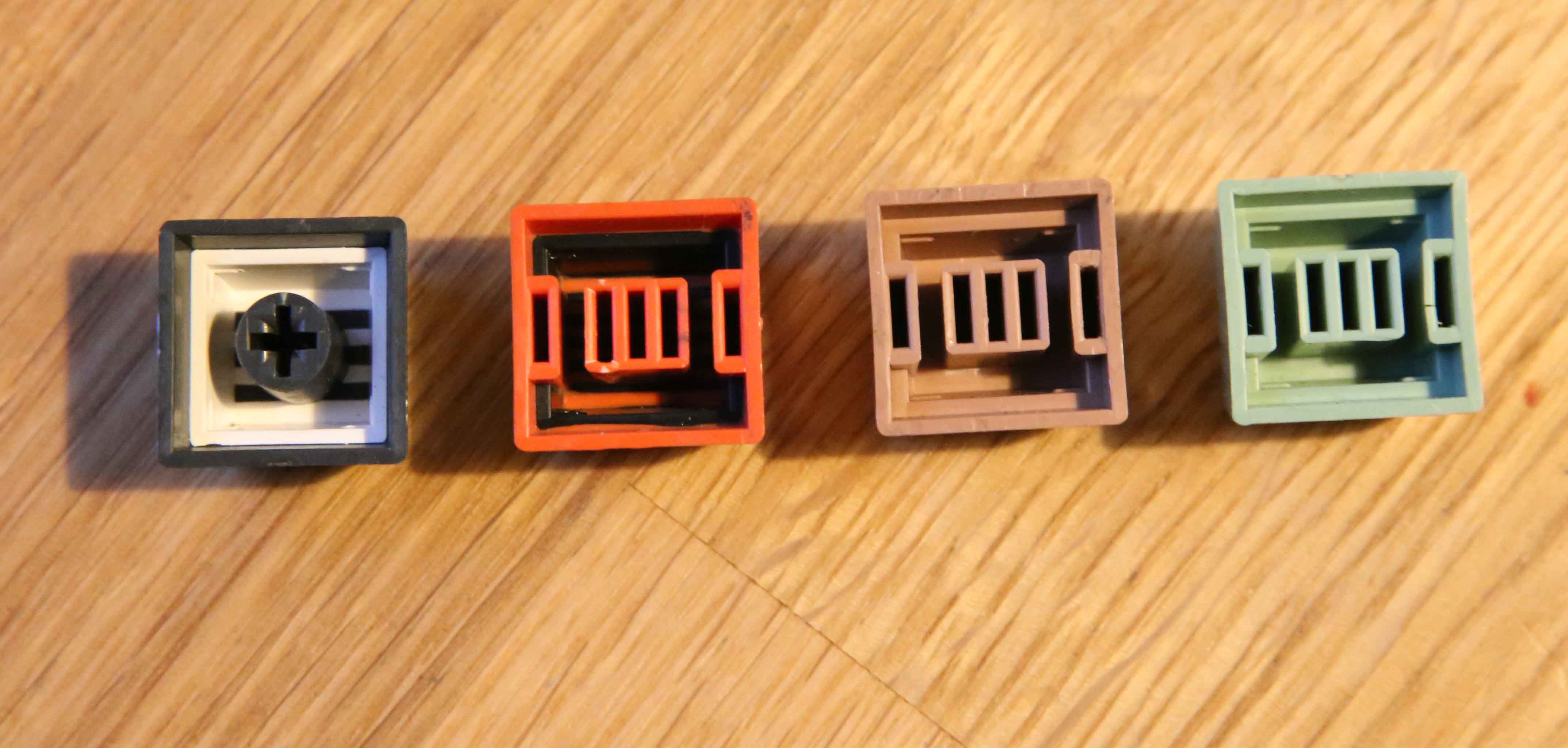

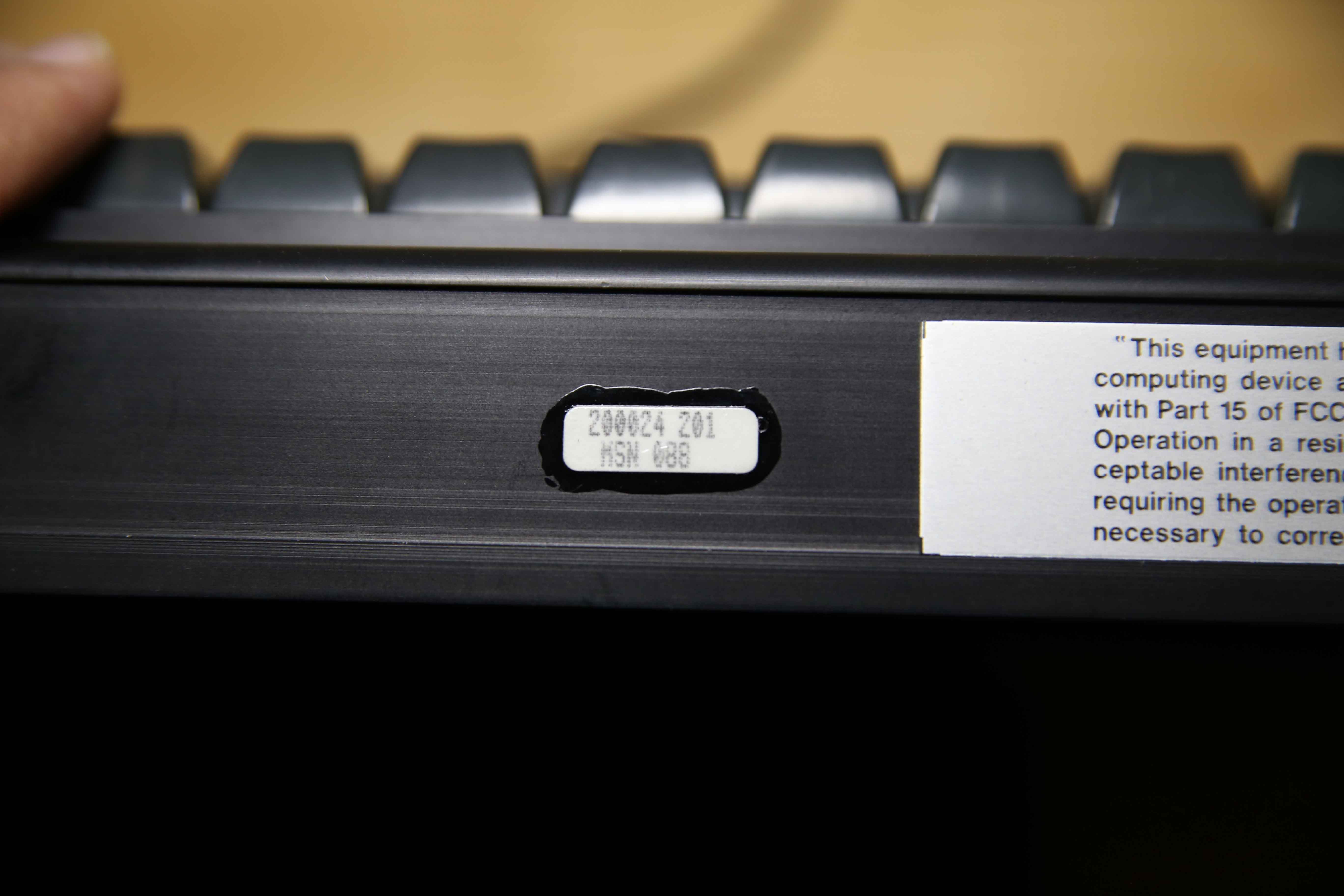

Hey Guys,
) and I would like to know if you have an idea what kind of "docking" these key have, and if its possible to use there with actual switches. I think they would look very nice on an actual board.
- caps2.jpg (223.49 KiB) Viewed 6473 times
- caps3.jpg (260.41 KiB) Viewed 6473 times
- board.jpg (341.98 KiB) Viewed 6473 times
- tag.jpg (214.6 KiB) Viewed 6473 times
- Daniel Beardsmore
- Main mouse: MS IMO 1.1
What make of keyboard is that? It looks like one of those light beam types (very similar to [wiki]Collimation Optical Encoder[/wiki]), but those should not work with standard keycaps. The reason for the three side-by-side slots is to allow the keycaps to be offset horizontally from the bar that they attach to. How does yours handle that arrangement?
The keycap mounts could be anything; you'll need to measure them. Some possibilities are given under [wiki]Cross mount clearinghouse[/wiki].
The keycaps themselves appear to be Comptec.

Welcome to DT Hypnotoad! That is quite an interesting keyboard you have there! When you write "switch-docking-part" I'm pretty sure you mean:
wiki/Switch_mount
More pictures would help. Can we see the swtich ?
wiki/Switch_mount

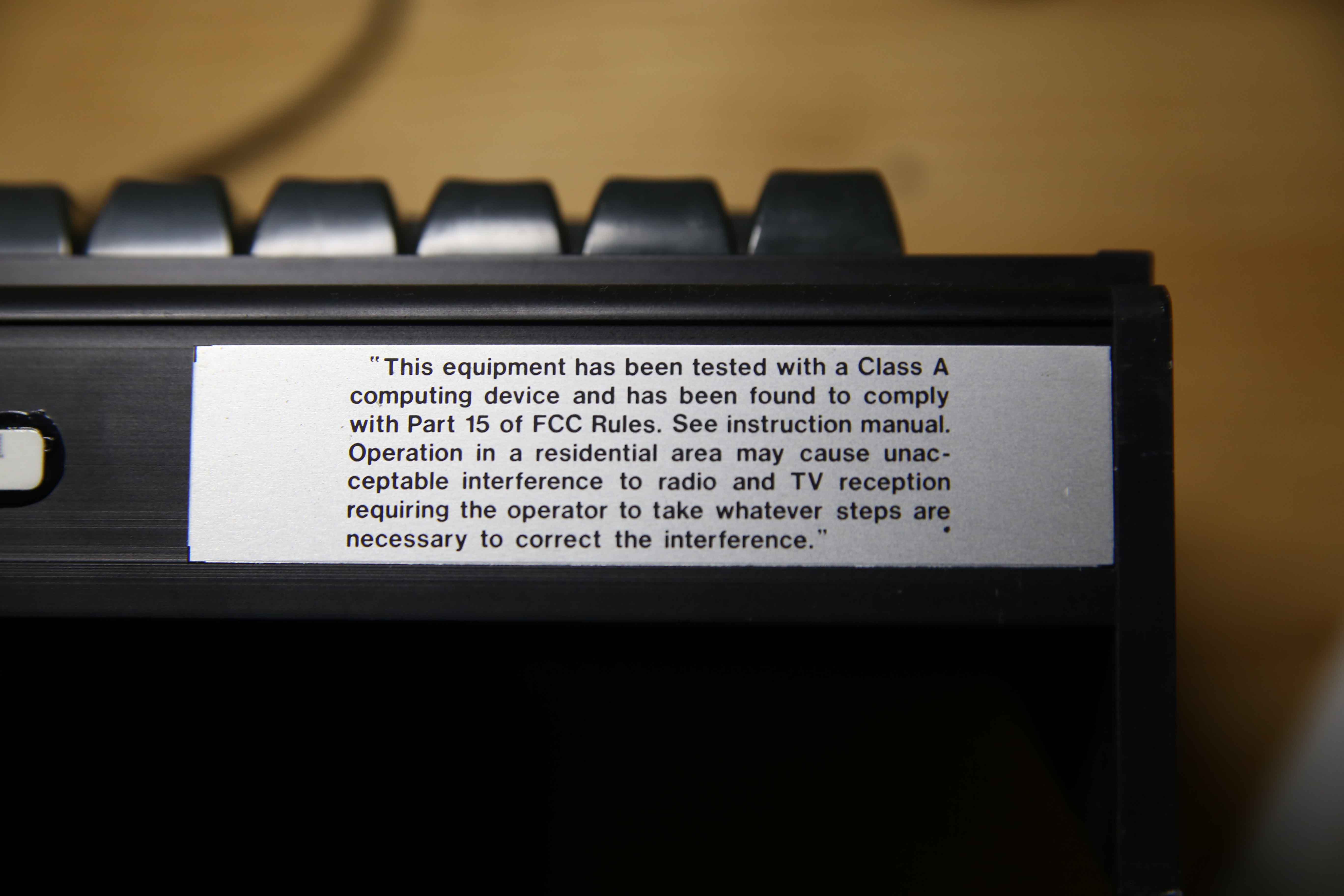

Here are some pics with the information located on the back side of the board. I will open the board this week and load other pics for clarification. Thx for the answers!

want to own one yourself?
https://www.ebay.de/itm/Alte-NASA-Tasta ... 2866897261
http://www.google.com.pg/patents/US3818485
Seem's to be the same based on the patent number.
Disclosed is optical switching keyboard apparatus employing identically constructed aligned matrix panels forming the apparatus housing as well as defining collimated light beams focused upon a photodetector matrix disposed in an area on a circuit board which extends transverse to and through slotted apertures in the aligned panels. Coded electrical signals are provided by the translation of coded shutters into selected light interrupting relationship with the beams, the coded shutters effective to block selected apertures of the matrix panels, which apertures are tapered in the direction of the beam travel.

There is only one certified NASA keyboard here
Edit: I do find this fascinating in all honesty. It has the same patent as the Collimation Optical Encoder keyboard so that's it.
Nobody mentioned the switches in the alpha part. The shift cap looks identical to a SP SA cap so there should be some Mx compatible switches in the alpha area. This would be quite a weird decision to mix two completely different switch systems in a board.

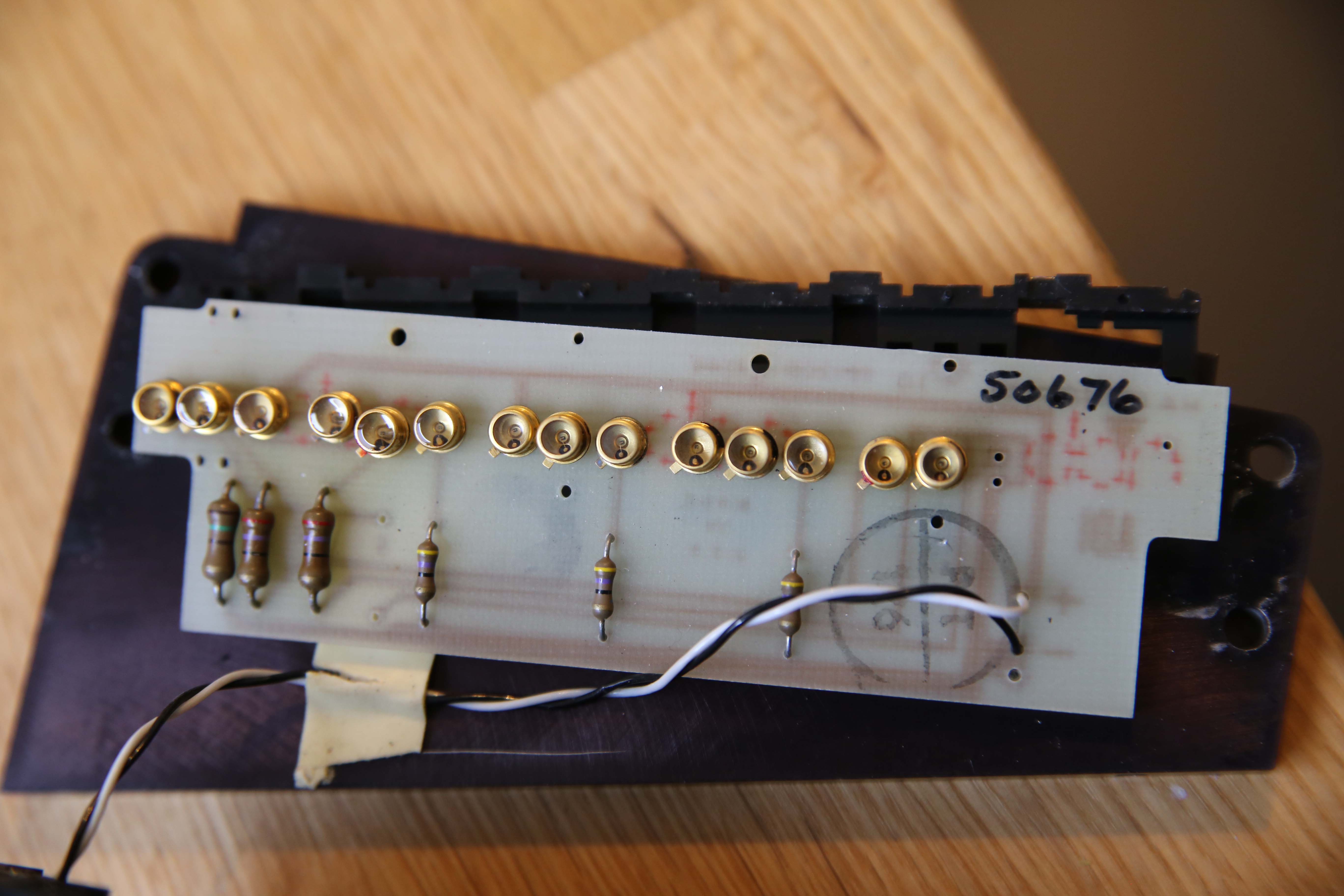

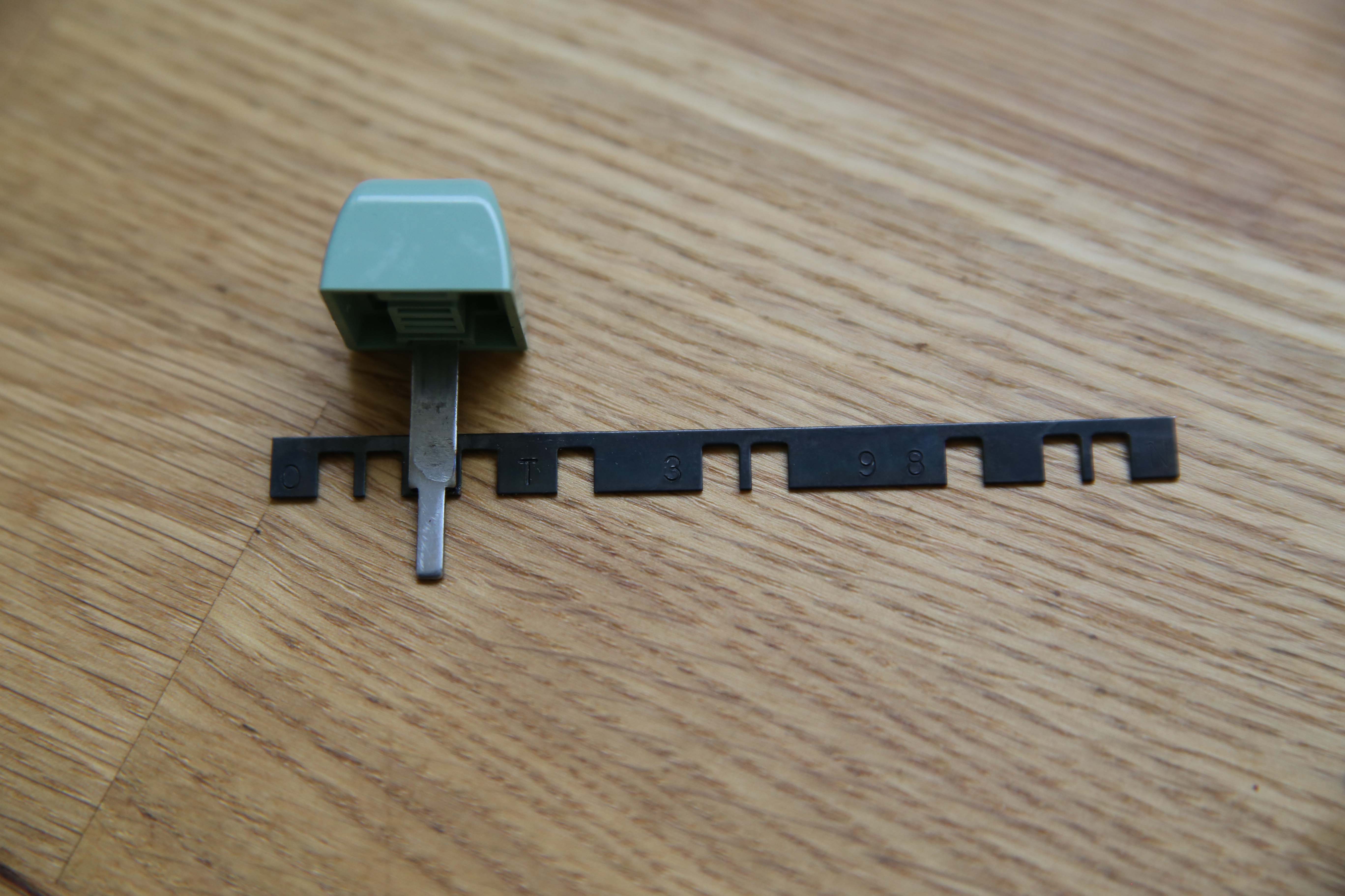

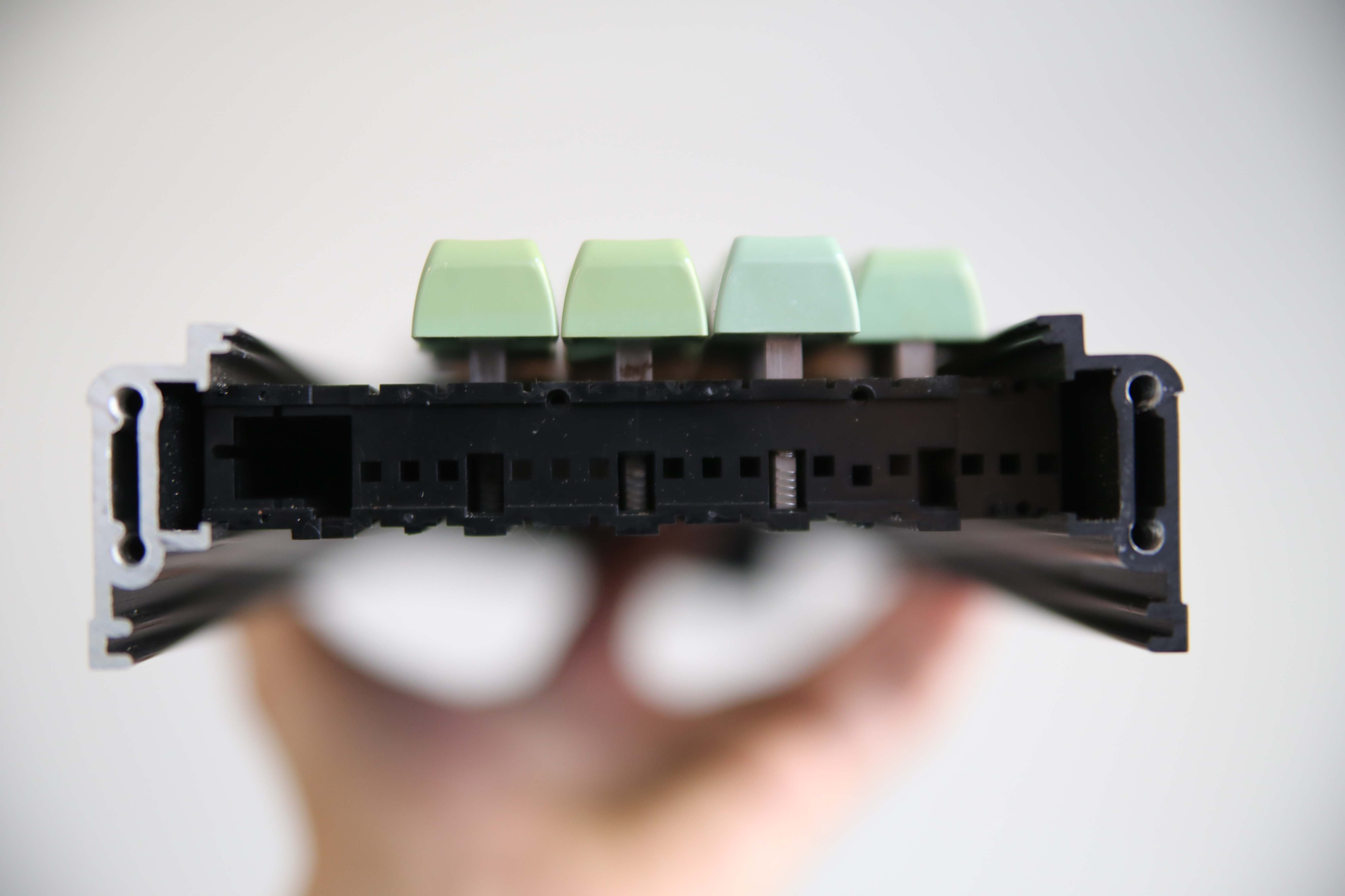

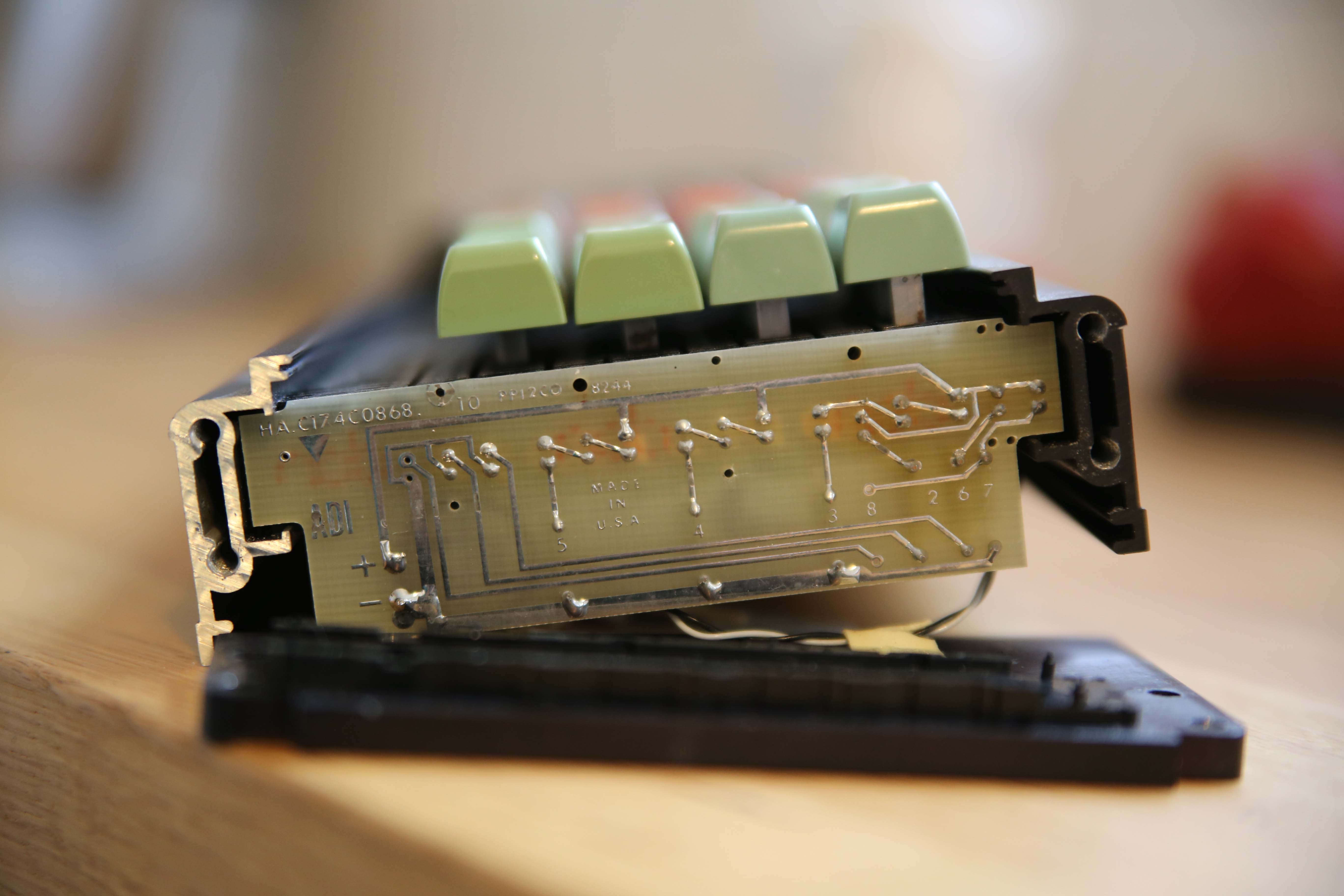

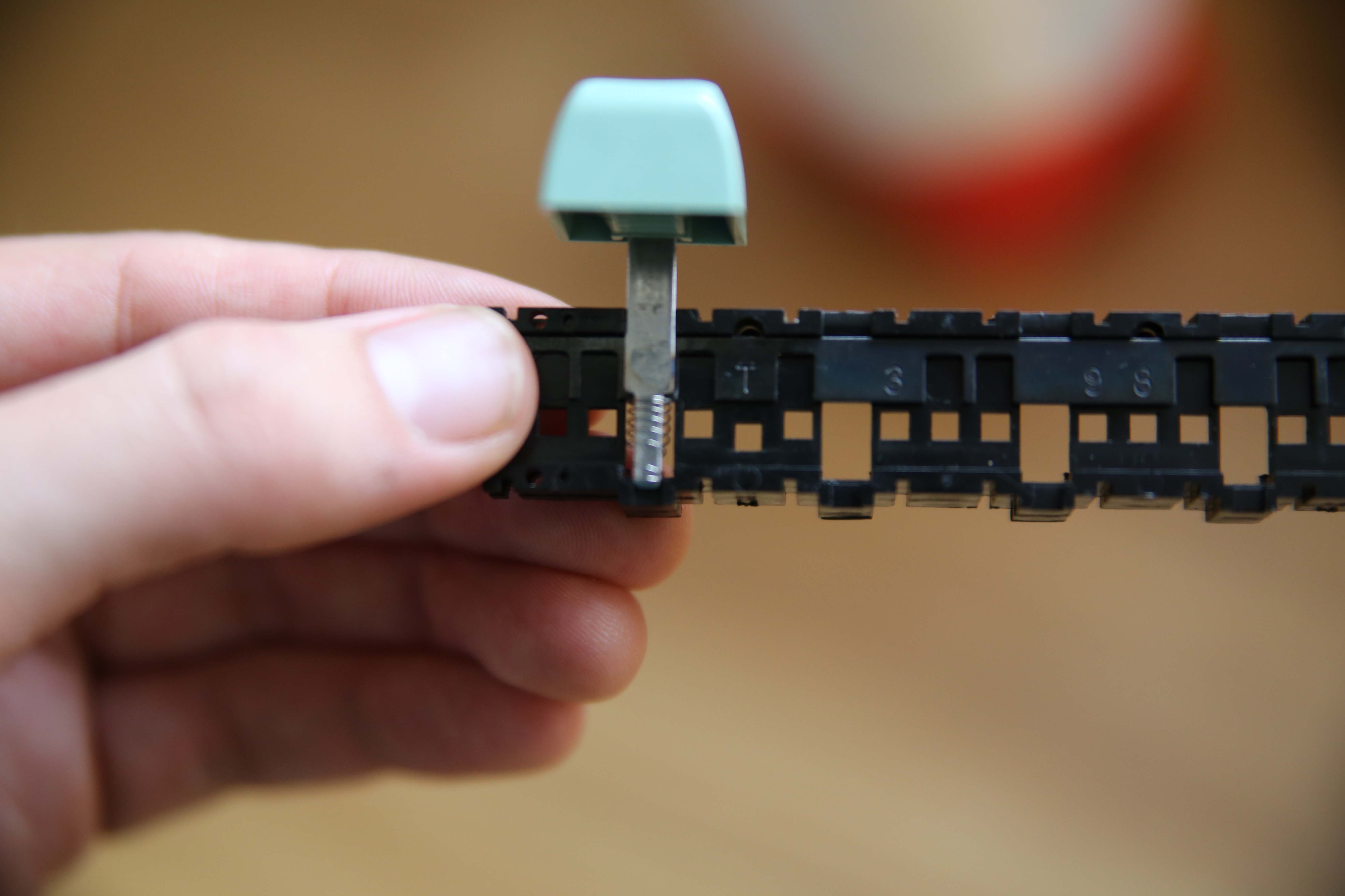

So, finally found some time to open the board to see the innards. I made some pictures so you can see whats left and how it works. To reassemble this one was a real pain in the ass... the spring just kept jumping away. I guess you need some special tool to make the springs fit without going crazy.
- gutted6.jpg (922.65 KiB) Viewed 5983 times
- gutted5.jpg (454.25 KiB) Viewed 5983 times
- gutted4.jpg (812.15 KiB) Viewed 5983 times
- gutted3.jpg (488.13 KiB) Viewed 5983 times
- gutted2.jpg (638.28 KiB) Viewed 5983 times
- gutted1.jpg (582.81 KiB) Viewed 5983 times
- snuci
- Vintage computer guy
- Location: Ontario, Canada
- DT Pro Member: 0131
That is pretty cool. So from the side view, the four bigger channels are where the keys go (can;t really call them key switches) and the two or three smaller channels is where the light travels to be captured by the sensor board on the end. Correct? Looks like the keys lower metal plates along the whole width of the board with only one spring? What's it like to type on?
This looks very much like the same way my Viatron keyboard works by blocking light channels but with a different mechanism shown here: workshop-f7/restoring-a-viatron-system- ... 17312.html
- snuci
I added a pic that I took with the keyboard "lit up" on my thread above to illustrate how that works. Lights on one side, light channels being blocked when a key is pressed, light sensors on opposite end encoding the pattern of light channels sensed to transform it to a key code.
