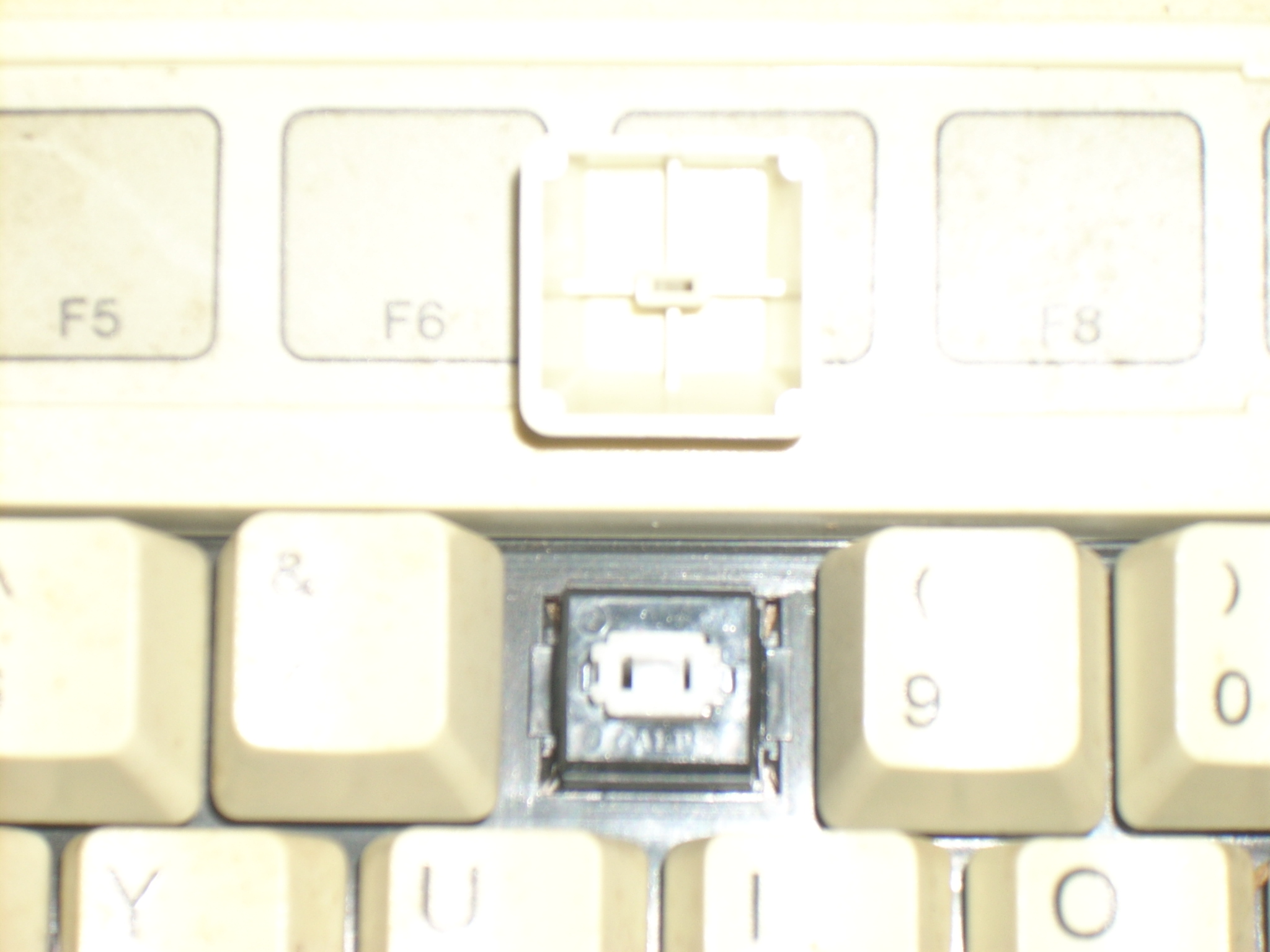

I've looked at the photos, and you've not shown the switch or the model number.Byarlant wrote: Found this at a recycling center a few days ago cleaned it up it works great seems to be some sort of membrane kb with cherry stems which is very odd it also seems to use a weird type of membrane that has something else in it for the actuation it also has really nice DST keys with Cyrillic characters on it its pretty neat. tried searching the model numbers google gave me nothing :/

Thanks! That was a quick IDDaniel Beardsmore wrote: That keyboard is almost the same as that of the [wiki]Sager NP-925[/wiki] — including the style of PCB, albeit Fontex instead of Parex. The switches appear to be [wiki]Alps SKFR/SKFS series[/wiki], finally indicating why the yellow ones exist (for function keys).
I don't have any keycaps to go with these switches so I can't say how hard they are to remove — someone with an Apple Adjustable Keyboard will know the answer to that.
I don't know of any series now with switches that are short front-to-back — that was an Alps peculiarity and all those series are gone. However, NOS SKFR and SKFS switches are still available, but I don't know off-hand if the yellow ones are still sold, as the chap I bought them from no longer sells parts. The problem with those is that you'd never get new keycaps for them.
It looks very similar to the Sager, only mine has just the 10-pin cable, not the ps/2 connector on the side
The switches are very nice, much nicer than anything on a modern laptop and if there are no other keycaps for them there is also less need to remove the current caps, except for cleaning.

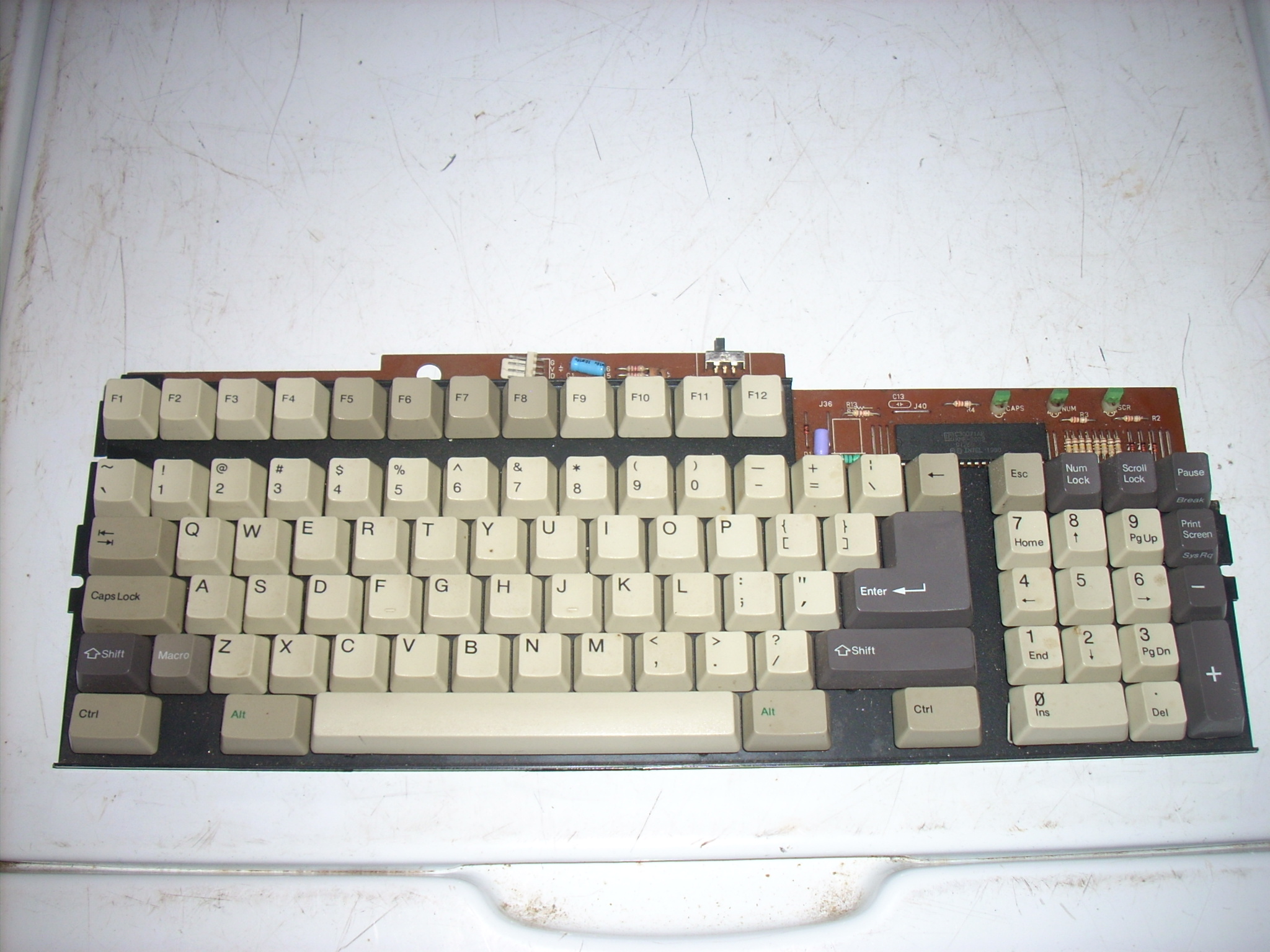

ok finally fixed it properly here it is not sure why I had so many problems.Daniel Beardsmore wrote:I've looked at the photos, and you've not shown the switch or the model number.Byarlant wrote: Found this at a recycling center a few days ago cleaned it up it works great seems to be some sort of membrane kb with cherry stems which is very odd it also seems to use a weird type of membrane that has something else in it for the actuation it also has really nice DST keys with Cyrillic characters on it its pretty neat. tried searching the model numbers google gave me nothing :/
- 1503186079606276860648.jpg (213.32 KiB) Viewed 7683 times
- Daniel Beardsmore
- Main mouse: MS IMO 1.1
Please put an actual image or link!

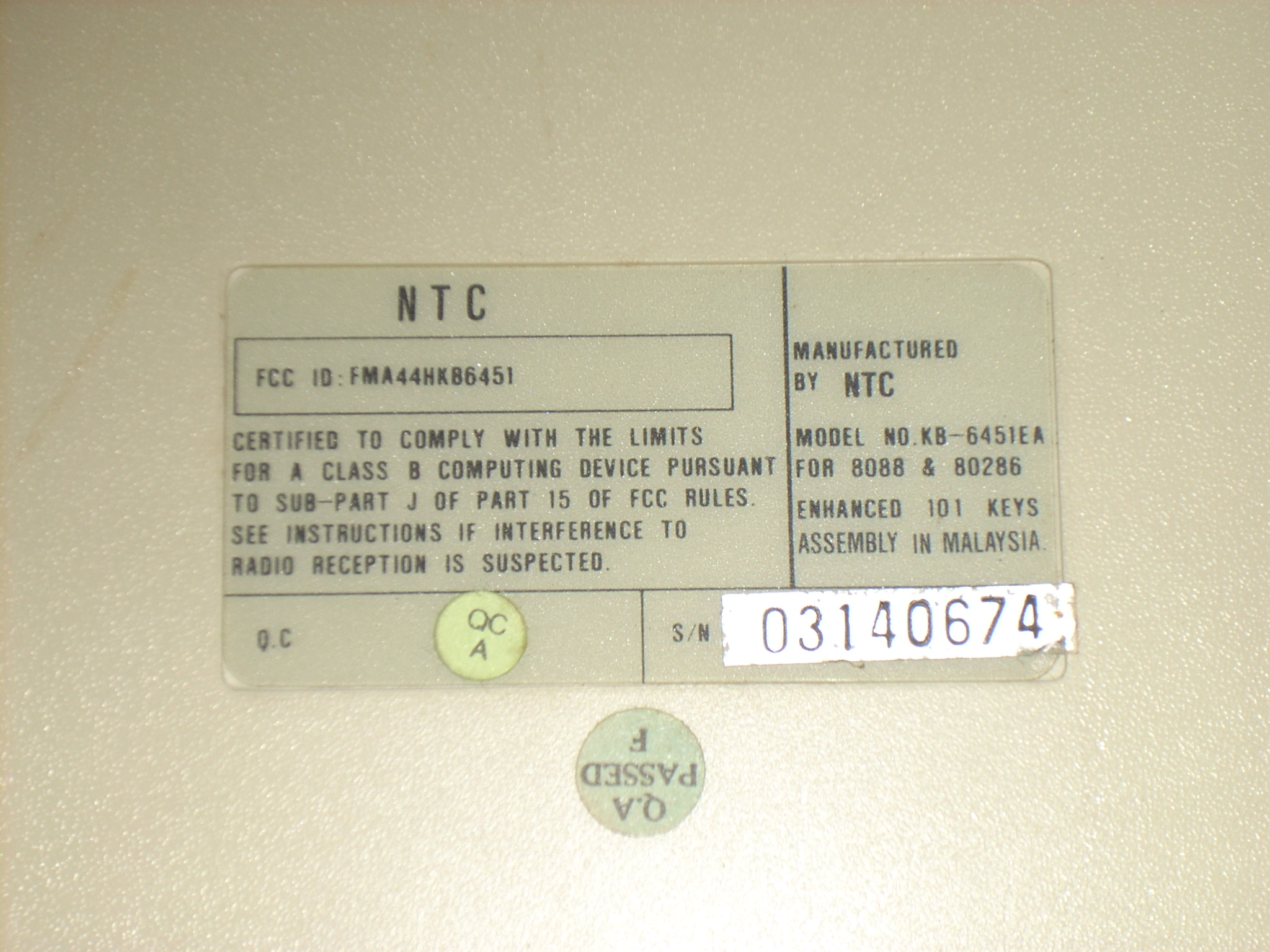

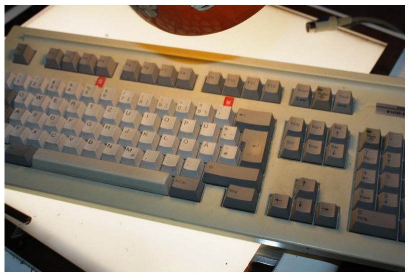

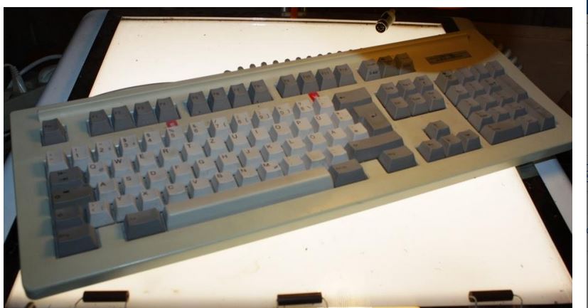

New here, trying to catch up. Late reply to a question a few pages back. I have two of those here. Mine are NTC model KB-6451EA, white Alps SKCM (marked ALPS on top), printed caps, XT/AT switch on the back, 5 pin DIN, plastic plate, very light weight. Nice feel (to me...), interesting layout. CTRL key next to A (Wordstar-friendly). Keys at the top corners very deep; those were usually broken off.
- White ALPS legend, printed caps.
- DSCN9704.JPG (605.04 KiB) Viewed 7679 times
- NTC branded.
- DSCN9703.JPG (814.86 KiB) Viewed 7679 times
- Nan Tan Computer Co spelled out on this one.
- DSCN9702.JPG (811.85 KiB) Viewed 7679 times
- Saved two good ones out of dozens that were broken, usually the top row keys, which were very deep.
- DSCN9694.JPG (787.16 KiB) Viewed 7679 times

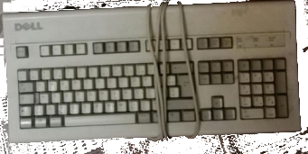

Looks like Dell AT102W. The image was a little edited by me...

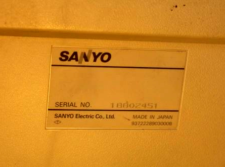

On that Sanyo, the placement and shape of the LED windows are a giveaway for Peerless IMHO. Also, has anyone seen any Leaf Spring boards with Alt and Ctrl in the same row as space? That board just doesn't seem vintage enough for Leaf Spring to me. Wanted to scoop this up, too, before I had a closer look at the pictures...
- seebart
- Offtopicthority Instigator
- Main keyboard: Rotation
- DT Pro Member: 0061
Sounds convincing. Peerlees could have been such a worthy follow up for Fujitsu...but they somehow managed to produce a pretty horrible switch after such brilliance. To this day I want to try NIB Peerless just to find out if they feel lousy even when unused. I bet they do.Keybug wrote: On that Sanyo, the placement and shape of the LED windows are a giveaway for Peerless IMHO. Also, has anyone seen any Leaf Spring boards with Alt and Ctrl in the same row as space? That board just doesn't seem vintage enough for Leaf Spring to me. Wanted to scoop this up, too, before I had a closer look at the pictures...

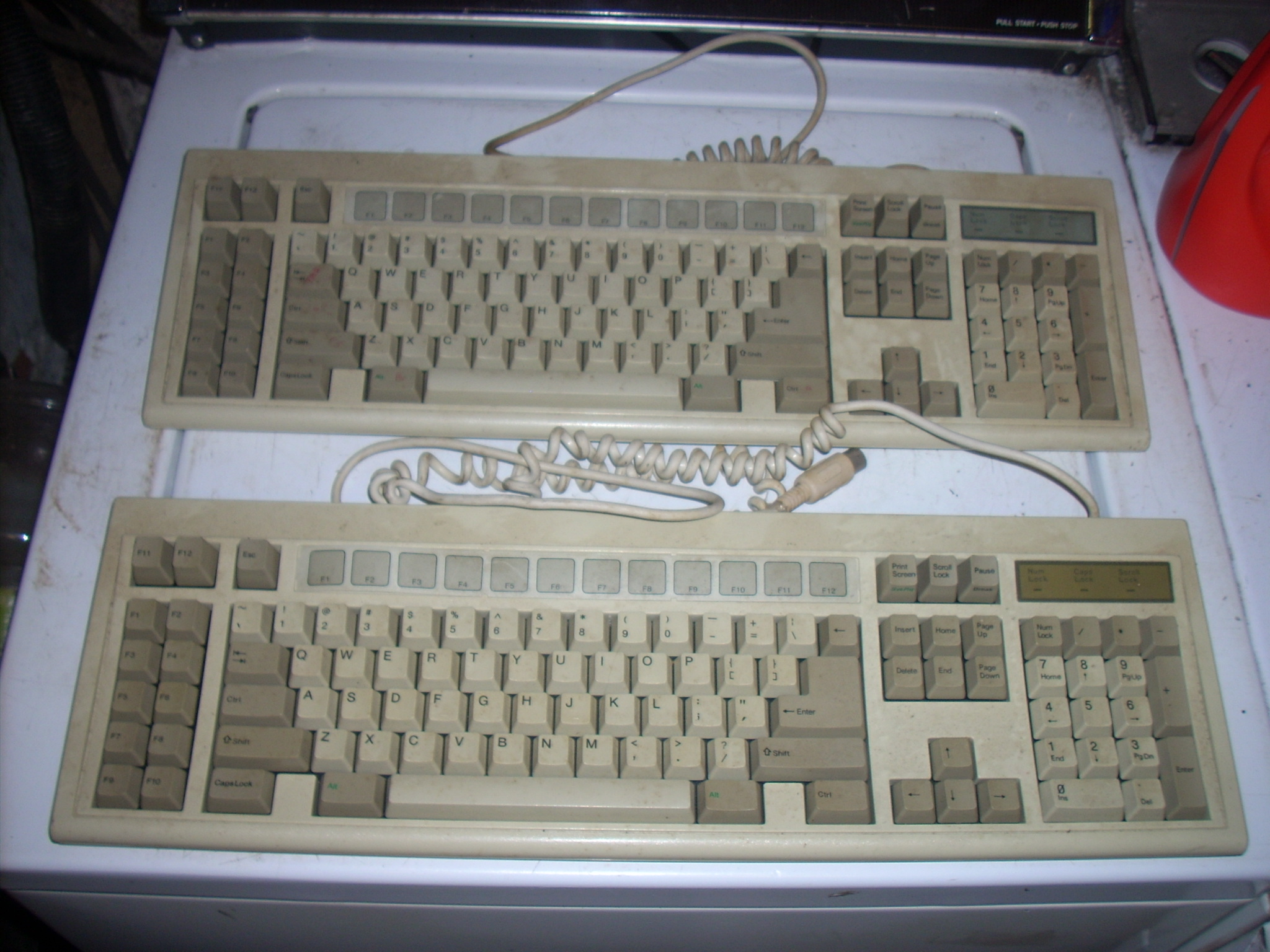

Still digging through Mr. Whoopee's Closet, down to the 386 vintage stuff now, found this one. No case, no ID other than "KB-089" on the back of the board. White Alps clones. About half have lost their click. 4 pin connector. Two position slide switch, unlabeled, presumably AT/XT? Brown Enter key, etc., Macro key next to left Shift. Stamped caps. Some sort of luggable?
- DSCN9722.JPG (804.75 KiB) Viewed 7341 times

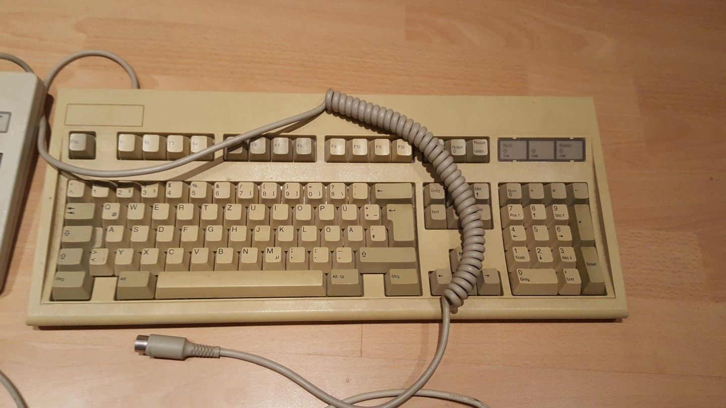

Can anyone tell off the bat what keyboard this is? Stepped capslock, indentation for logo at top left and the four little nibs around the LED screen should be pretty distinctive, but I can't recall having seen anything like it. Horrid banana colour, though...
