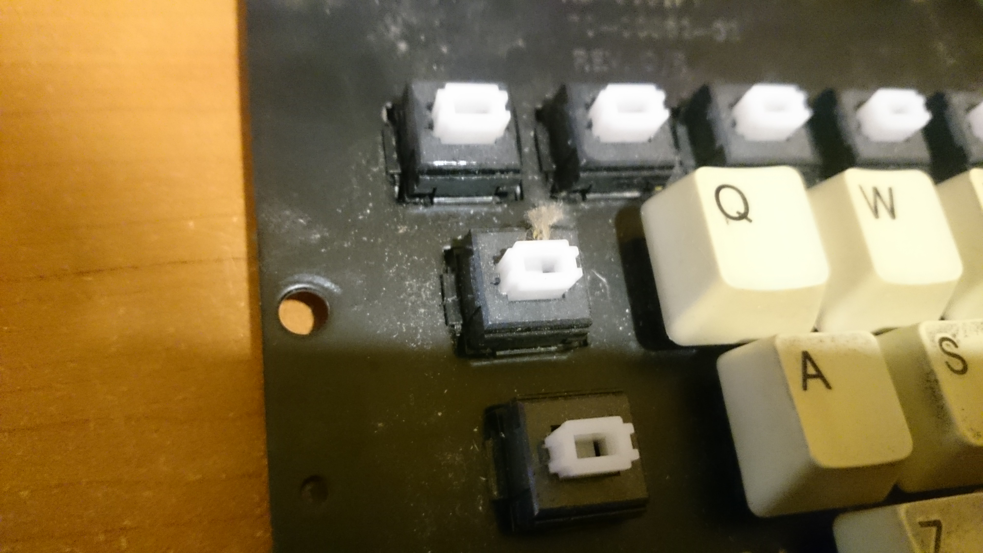

Remember that NTC I was talking about? Well... Didn't have luck... And the switches are filthy. Yuck...

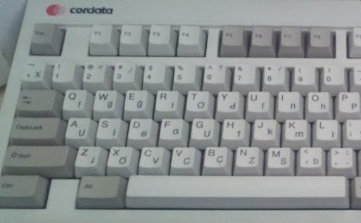

You mean, is the Cordata brand rare?

I've never seen that badge ever.
I'm sure the switches can come back. Take them apart and dust them, that will usually do it and if the top housings are still bad then you can wash/soak them in rubbing alcohol or soapy water. The irreparable damage comes when someone uses the switches when there like that. Coming from my old Taobao SKCL Green switches even after hours of work the top housings were still causing problems, the slider rail had physical damage/roughness. I think they got that way from use, the extra friction caused by all the contaminants permanently roughened the inside of the top housing. If they were never used the dust would be harmless, just sitting there.

There's at least one image of a Cordata keyboard out there, but I don't know if the internals are NTC KB-6251EA.

Well... It looks like...Hypersphere wrote: There's at least one image of a Cordata keyboard out there, but I don't know if the internals are NTC KB-6251EA.

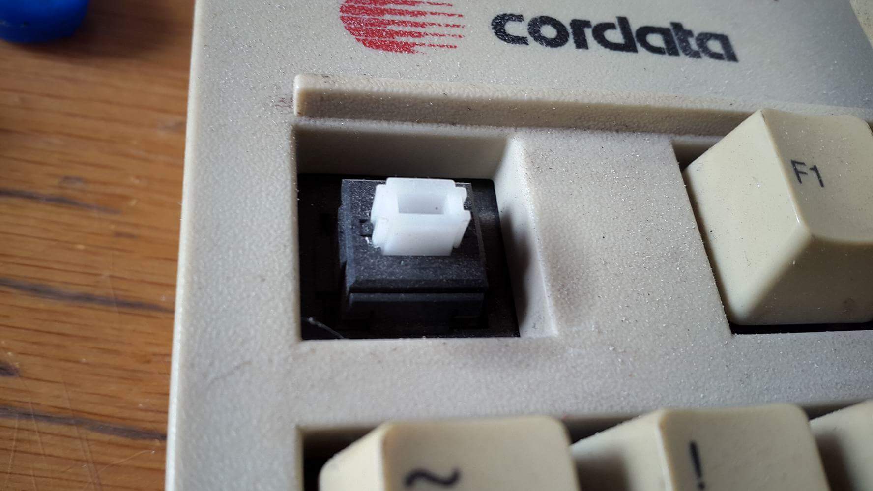

I think I have a program for my birthday.
The datamini is a kb-5161pt.

So it's done. I'm not that impressed with the resoults, it binds a bit, but the sound is not that bad. I'm gonna try lubing it sometime in the future.

You should never have to lube Alps. They're inherently very smooth switches, as long as they're clean and not heavily used.

Uhhhhhhhhhhh so who got these? SKCL Brown or possibly SKCL Striped Amber.

They are clean, I've cleaned them with a soft toothbrush, under water (switch housing and slider). But they still bind, and are scratchy. So I have no other choice, but to lube.

But White wasn't. And possible made of Polyoximethilen, rather than something that's not that slippery. So, they wouldn't need lube. But they get stuck without it.
