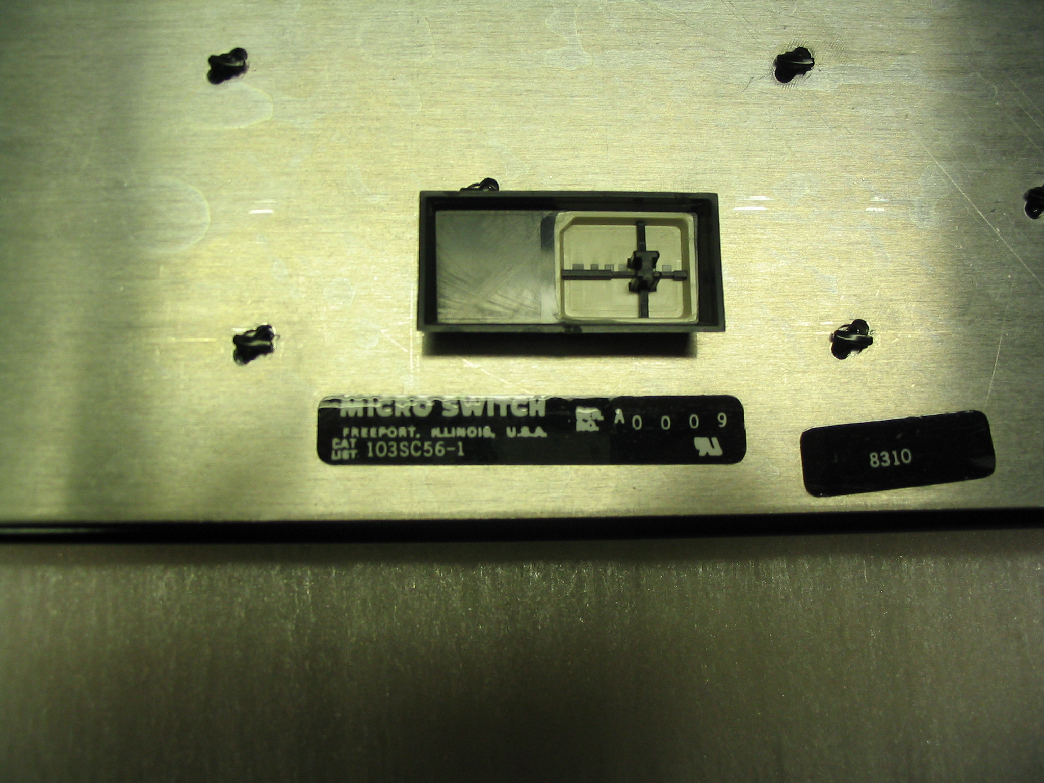

That Micro Switch KB is a 103SC56-1, build date 8310, S/N A00009. Definitely SC as all the custom parts are labeled SCxxx. There is *zero* feedback of any type from the switches, you just have to have faith... The shape/size of the keycaps and feel of the springs is very pleasant...seems weird to say, but you guys get it. I recall going to a lot of trouble, and expense (for me at least, at the time) to get it. Actually, I just recalled my GF at the time worked for Honeywell, and she couldn't even help me. Totally forgot about that. Memories...

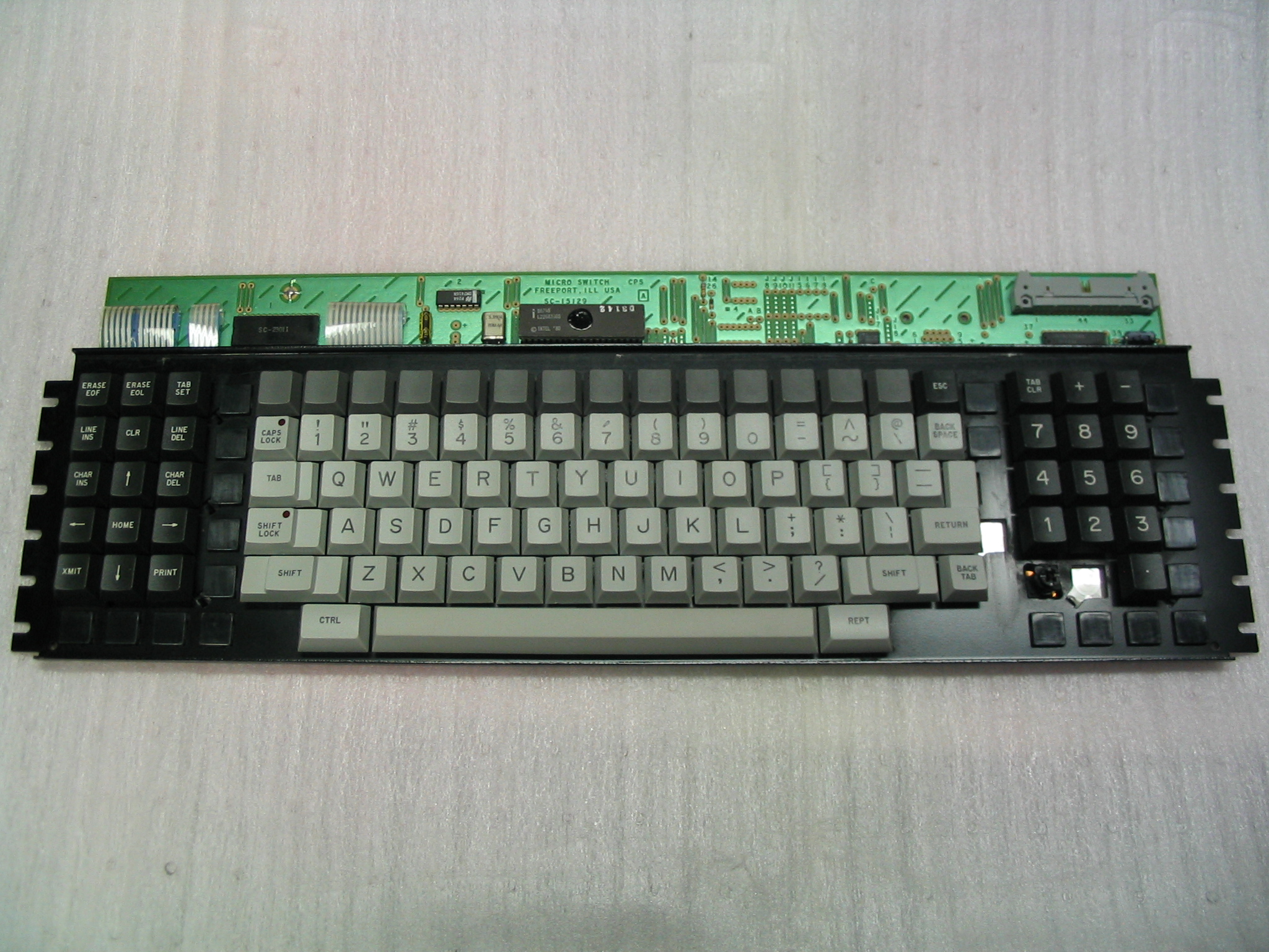

Man, am I ever way OT now... I found the "engineering drawings" for the 103SC56-1, 6 pages includes schematics. I guess I can't take a switch module out after all, but I can see the "plate" in each switch that the actuator moves is copper-colored (i.e. looks like phosphor bronze, not saying it is for sure), and there's no click or tactile feel at all. Regular switch modules are SC-10090, modules with an LED are SC-11002 (there is another version of this module, SC-10109, not used here). Membrane assembly is SC-25203, detector chip is SC-23011 (switch scanning matrix connects to this). There is no rubber anywhere! They claim NKRO, but then mention any more than 6 keys in the same row or column (of the scanning matrix) pressed at once may cause errors. Keycaps have very nicely molded-in legends (very neat from the underside, compared to e.g. the Northgate). Also has serial output, which I never used (additionally, a D-sub connector is optional). Assembly has positions/electronics for up to 126 keys.
The docs I have are obviously photocopies, and parts are already difficult to read, so I don't know how well a scan would turn out...also, they say they're the property of Micro Switch/Honeywell and can't be reproduced without permission...don't know if they'd really be of any use to the community if somebody wanted to host them for whatever reason... Pics should be fine. Later I'll see if I can find the actual catalog where the switch modules are defined, I must have it somewhere as I was very particular about getting all the deets back then when pretty much everything home computer-wise was still largely DIY.

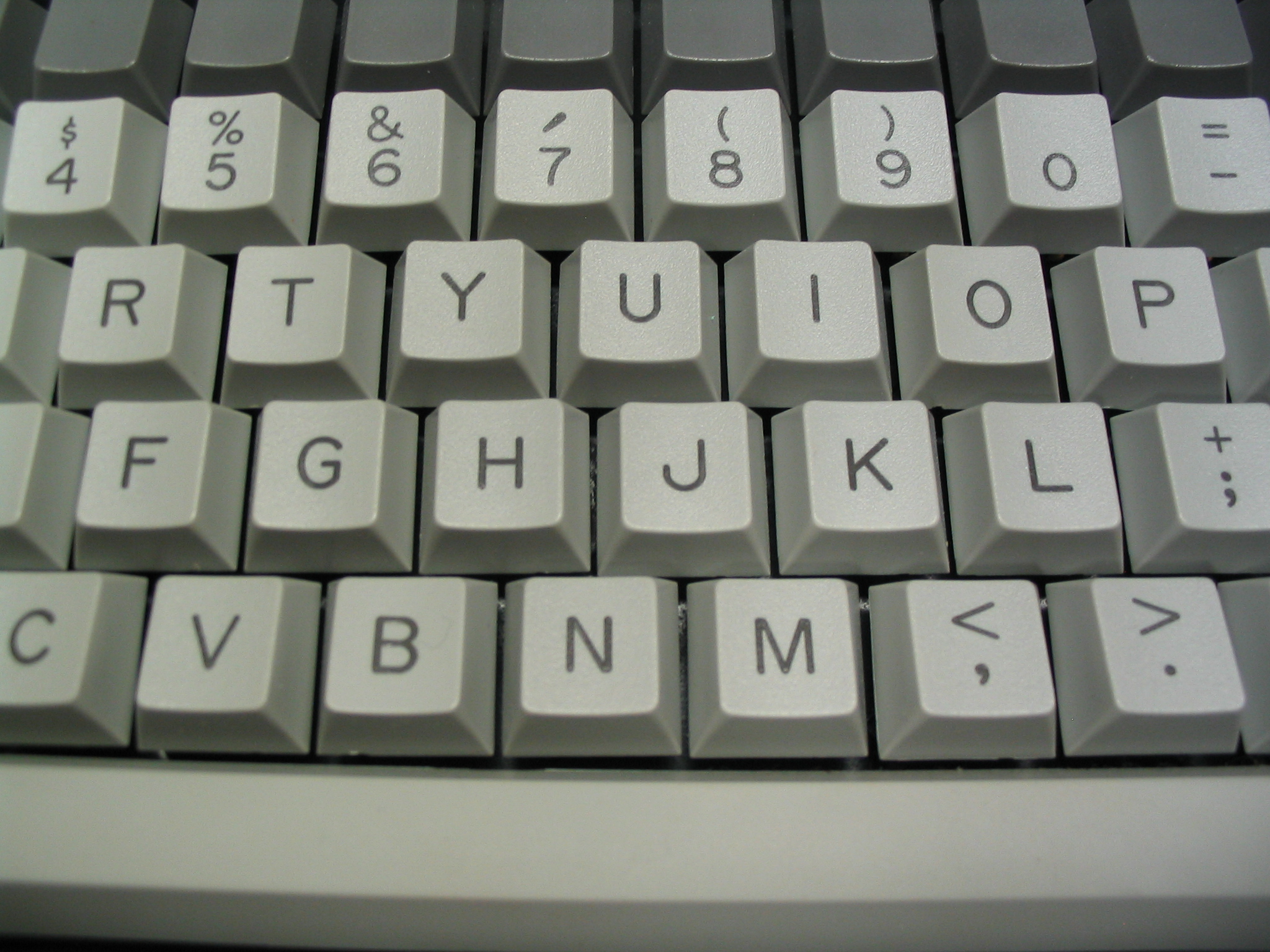

- I like the clear large keycap characters. The keys themselves are made of some kind of somewhat pliable and textured plastic, much less "brittle" than the e.g. Northgate's keycaps, but not rubber, IDK what it is, feels almost PVC-ish, but PVC would be too soft, wouldn't it?
- IMG_5917.JPG (1.12 MiB) Viewed 5299 times
- Here's that removed charcoal "0" key showing the neat molding of the cream/ivory/off-white text.
- IMG_5909.JPG (1.26 MiB) Viewed 5299 times
- The keys are all shades of gray, no exact black, in real life. Here is a general pic, if you click on it/magnify you can better see the coppery-colored actuator and the empty switch position that would normally be covered by the double-width "0" key.
- IMG_5914.JPG (1.33 MiB) Viewed 5299 times
- Daniel Beardsmore
- Main mouse: MS IMO 1.1
Double-shot moulded keycaps are only known to have used two materials historically: ABS and Tenite. Comptec/Signature Plastics always used ABS. Cherry used both ABS and Tenite. I'm assuming that Tai-Hao (who made the Northgate keycaps) always used ABS, although they now offer PBT double-shot keycaps (with the first shot, the legend, being POM I think). Micro Switch keycaps are held in high regard, but nothing is known about them.
It's hard to make the switch out in the photo, but indeed it seems to be something we've never seen before. Just to be clear, is this linear or tactile?
