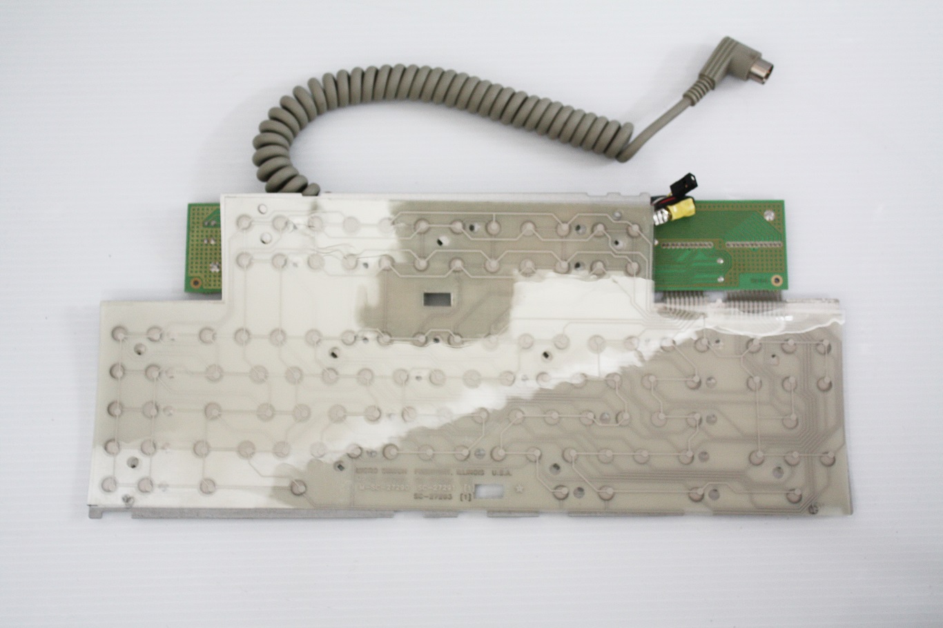

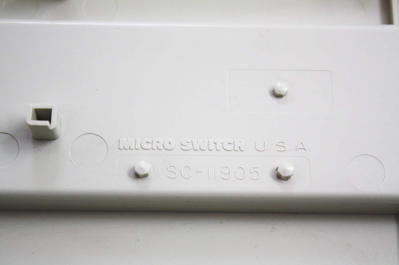

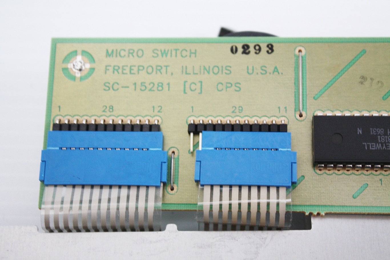

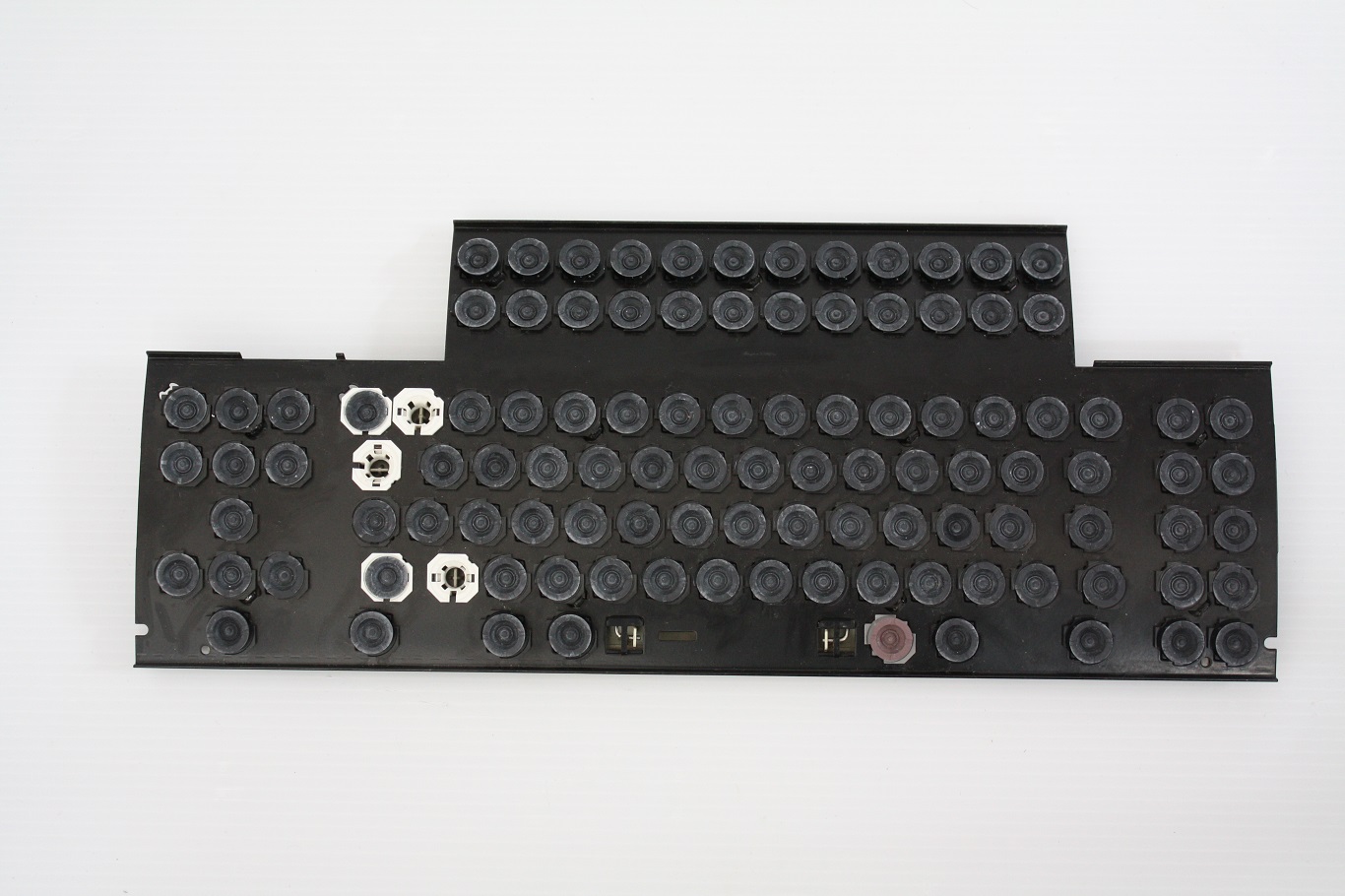

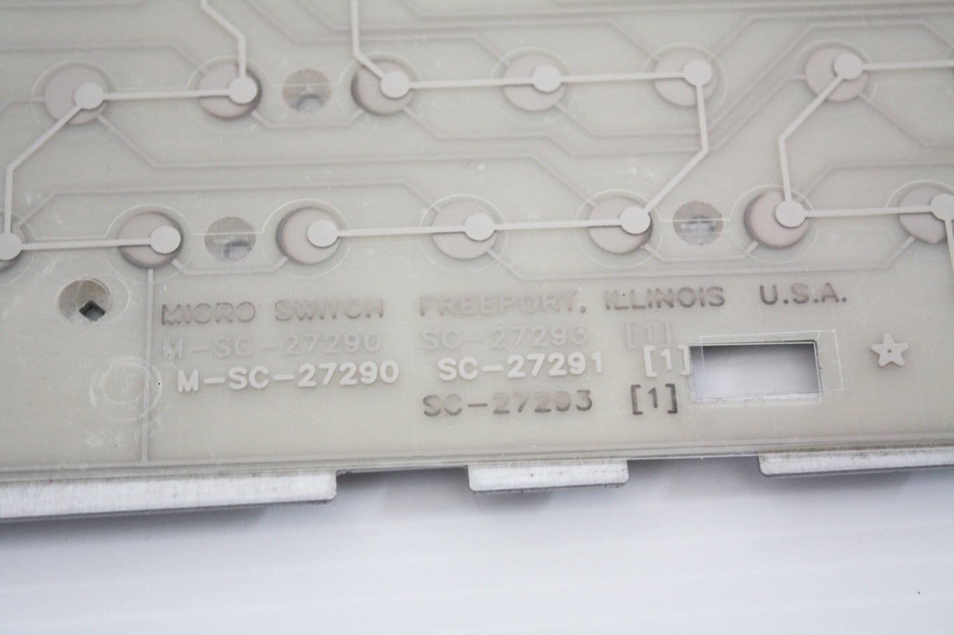

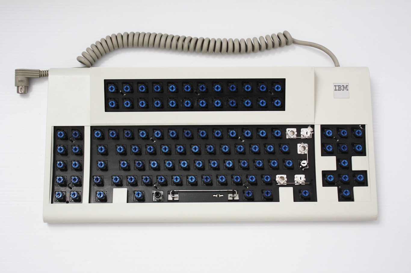

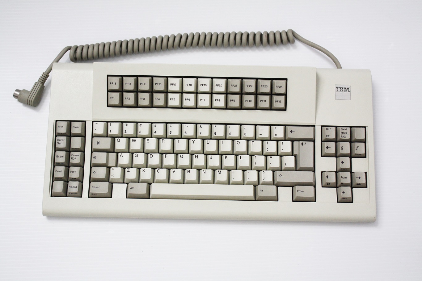

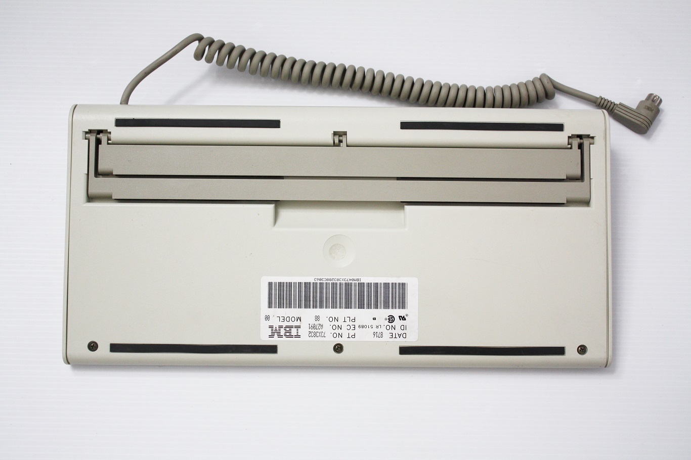

I got this recently simply because of the look. I think these are called "Unsavers". I love the look of this keyboard and I wanted to check what the low-profile Micro Switch ST key switches were like since I had a good experience in the past. They are rubber dome but they are also Micro Switch so I was curious.
The switches are not too bad on this keyboard but the space bar is a little mushy which ruins the experience. Oddly enough, they should be similar to my Gridcase 1520 keyboard but they do not seem alike at all. It may be that this keyboard has been heavily used or... perhaps not at all so the domes are a little stiffer. I do not get a tactile feel when typing on these.
Anyway, regardless of the experience, here's some pics on the construction. It's good to document this for others who may wonder about it. I still love the look.
IBM Micro Switch Unsaver - keyboard front

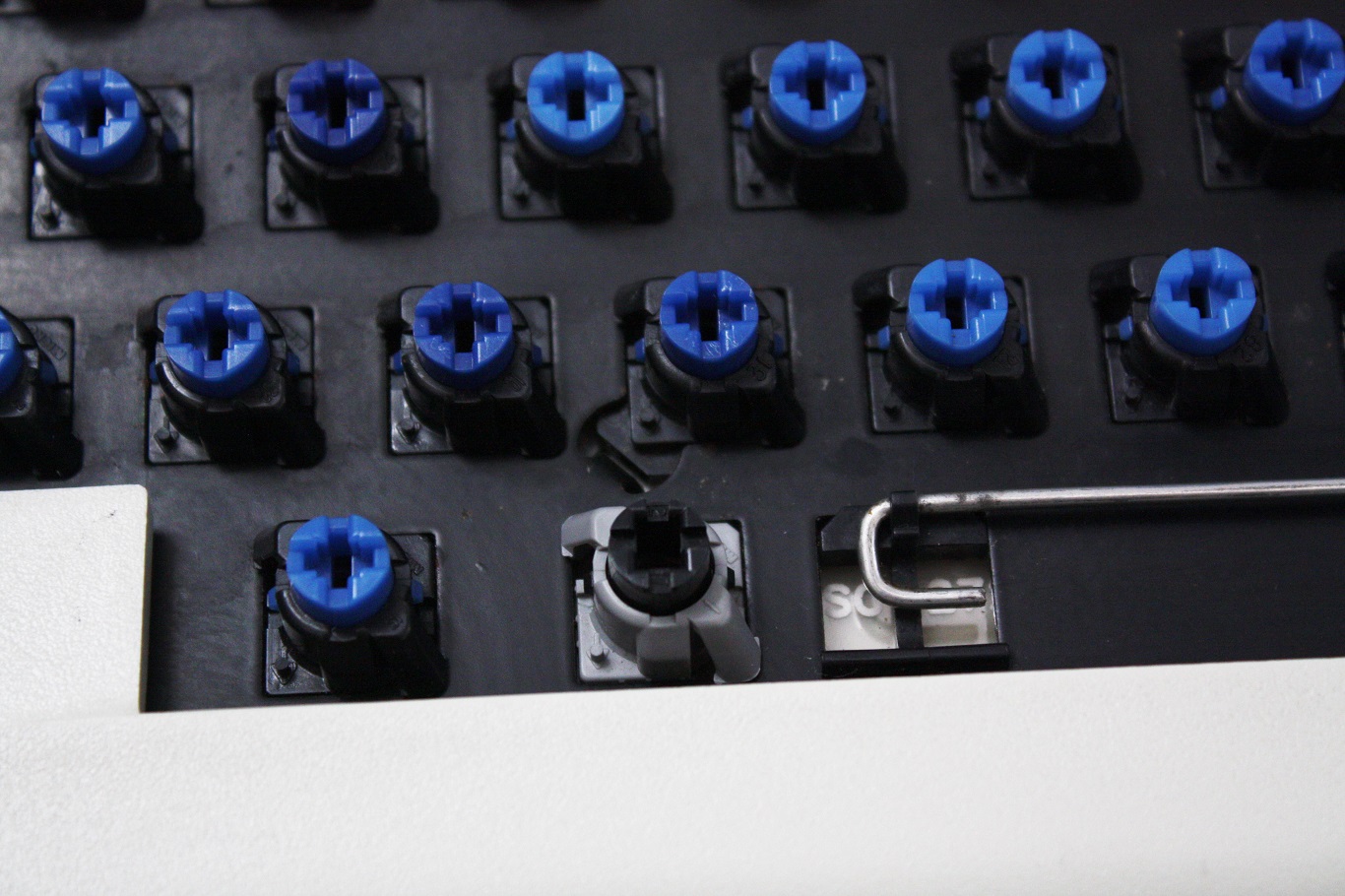

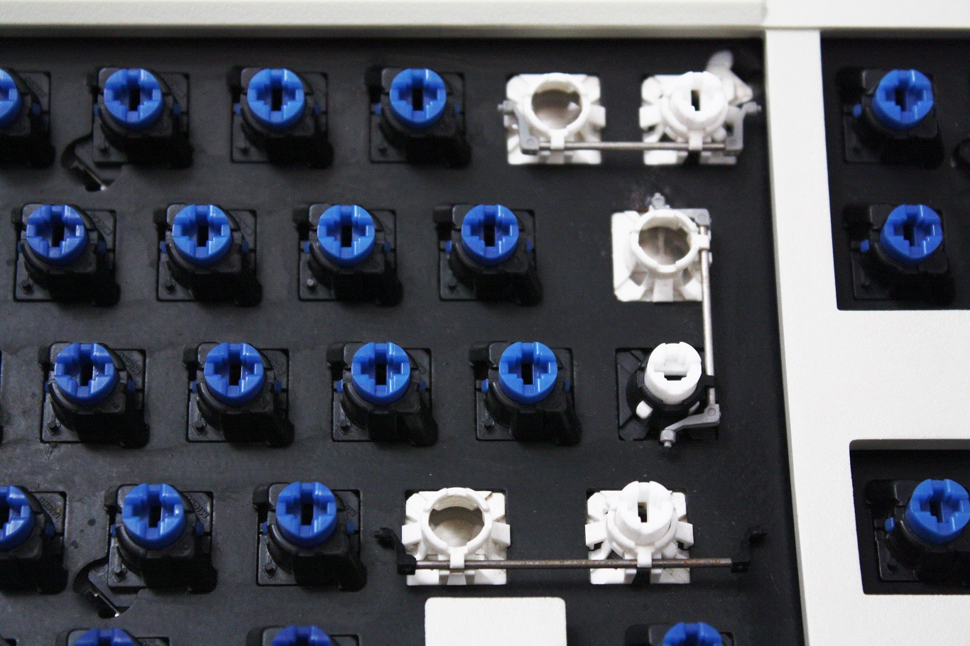

IBM Micro Switch Unsaver - key switches removed
IBM Micro Switch Unsaver - key switches removed.JPG (276.85 KiB) Viewed 3237 times

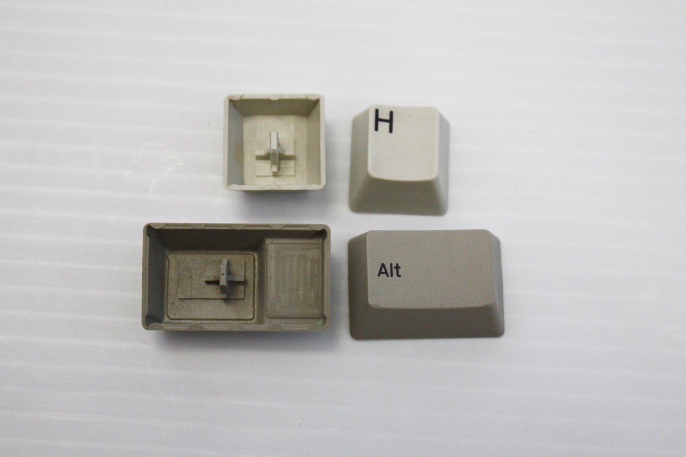

IBM Micro Switch Unsaver - Enter key switch and stabalizer
IBM Micro Switch Unsaver - Enter key switch and stabalizer.JPG (408.58 KiB) Viewed 3237 times
IBM Micro Switch Unsaver - spacebar key switch
IBM Micro Switch Unsaver - spacebar key switch.JPG (350.93 KiB) Viewed 3237 times

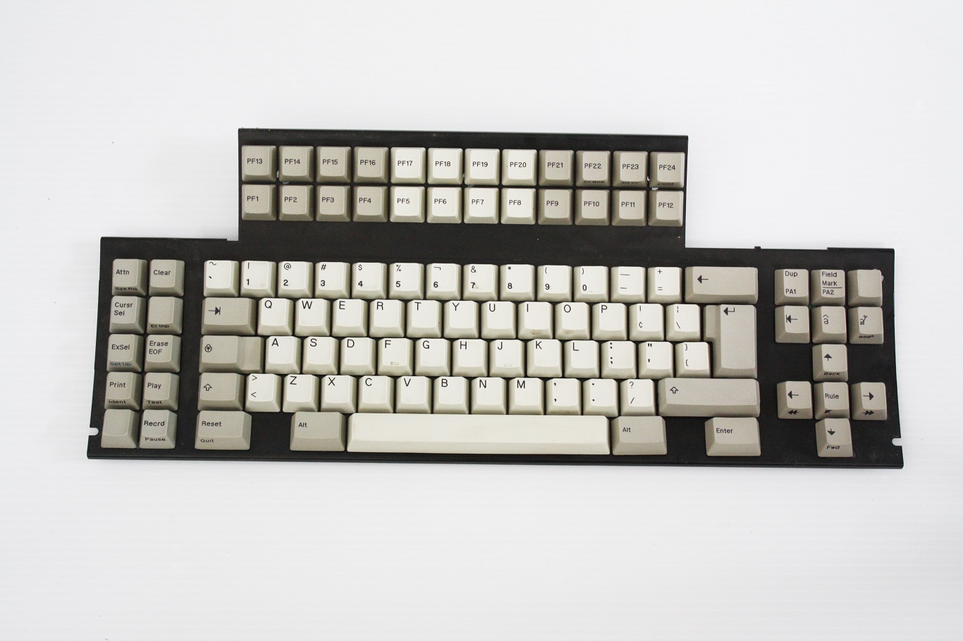

IBM Micro Switch Unsaver - keyboard mechanism top
IBM Micro Switch Unsaver - keyboard mechanism top.JPG (242.33 KiB) Viewed 3237 times
IBM Micro Switch Unsaver - keyboard mechanism bottom
IBM Micro Switch Unsaver - keyboard mechanism bottom.JPG (244.5 KiB) Viewed 3237 times

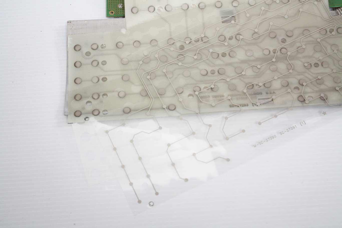

IBM Micro Switch Unsaver - Membrane
IBM Micro Switch Unsaver - Membrane.JPG (235.67 KiB) Viewed 3237 times
IBM Micro Switch Unsaver - membrane layers
IBM Micro Switch Unsaver - membrane layers.JPG (289.57 KiB) Viewed 3237 times
IBM Micro Switch Unsaver - membrane identification
IBM Micro Switch Unsaver - membrane identification.JPG (303.84 KiB) Viewed 3237 times

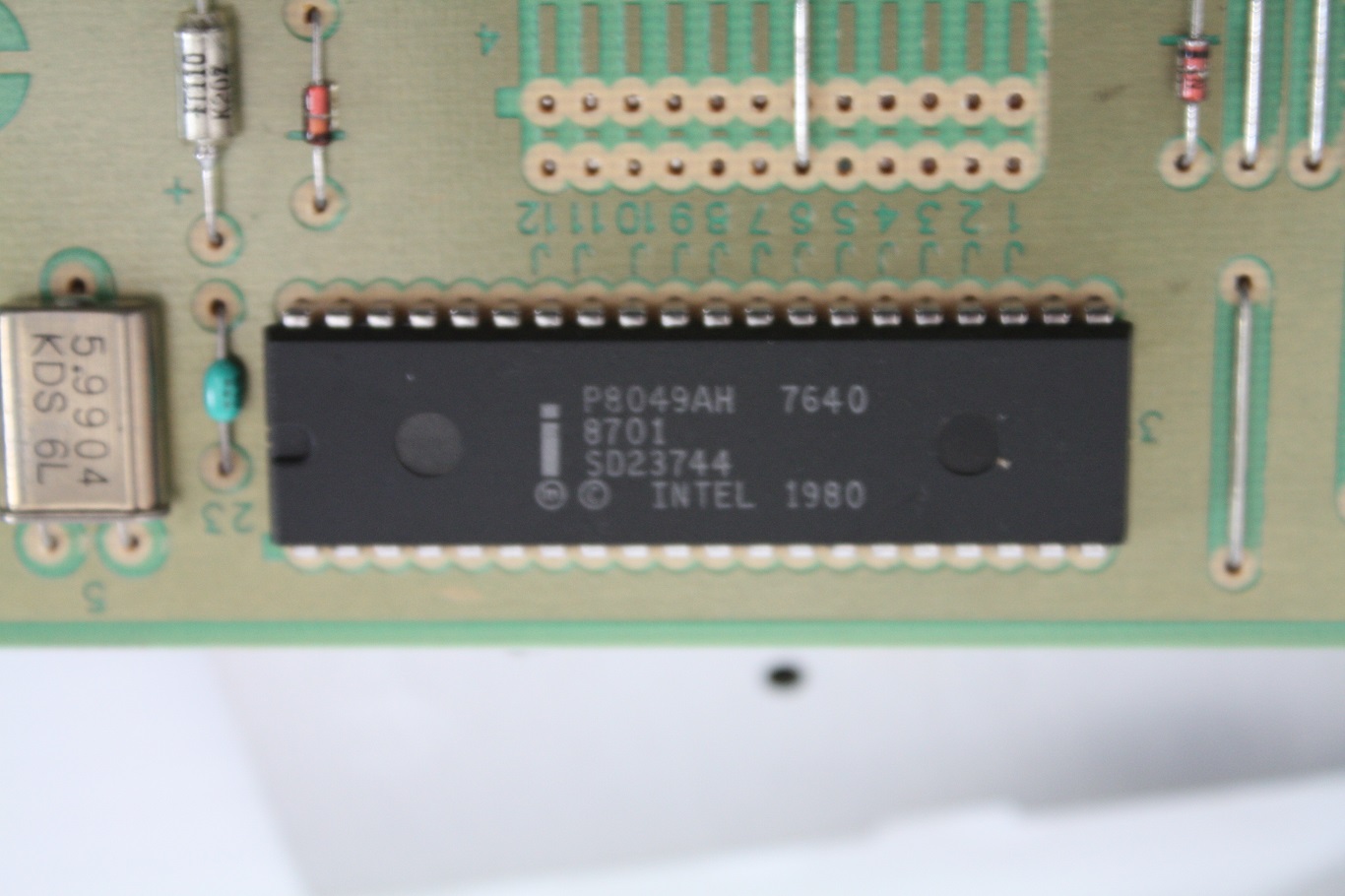

IBM Micro Switch Unsaver - Controller IC
IBM Micro Switch Unsaver - Controller IC.JPG (238.05 KiB) Viewed 3237 times

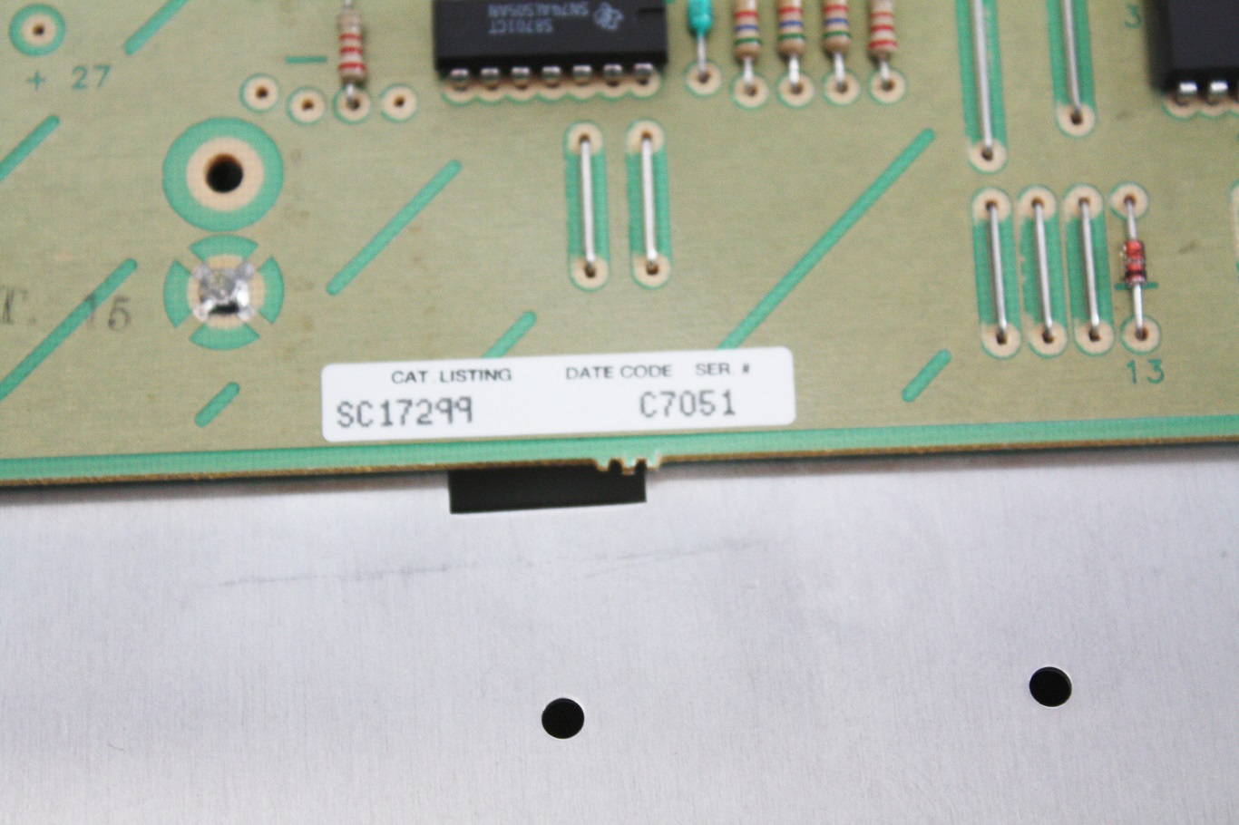

IBM Micro Switch Unsaver - PCB sticker
IBM Micro Switch Unsaver - PCB sticker.JPG (327.6 KiB) Viewed 3237 times
IBM Micro Switch Unsaver - PCB idenitification
IBM Micro Switch Unsaver - PCB idenitification.JPG (316.04 KiB) Viewed 3237 times
IBM Micro Switch Unsaver - case identification
IBM Micro Switch Unsaver - case identification.JPG (278.25 KiB) Viewed 3237 times
IBM Micro Switch Unsaver - key caps
IBM Micro Switch Unsaver - key caps.JPG (239.41 KiB) Viewed 3237 times

Ah nice we've had this one here before. Interesting to see that it's manufactured my Micro Switch. Of course quite a few users here were very quick to label this as a crappy dome keyboard. Personally I'd love to own one. That's got to be the best flip stand of all time.

Great. I always hope to see this blue variant internal.
What's is the different of the dome with black and blue?
