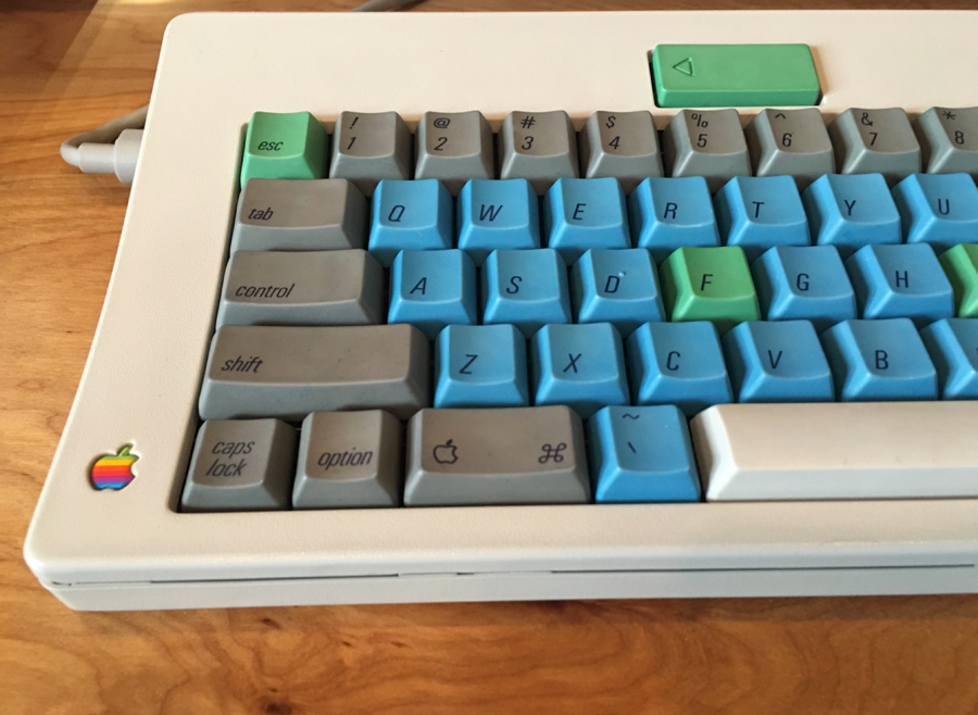

Though the size is still a little larger than my preferred 60% layout, my favorite “stock” keyboard outside the HHKB is the Apple M0116 that shipped with the Macintosh SE 30. The power button at the top still works in the current OS, and it’s got the Control key in the right place and wonderful tactile orange switches.
But I can’t stand the ocean of Apple “platinum” beige, so I came at the keycaps like Jackson Pollock on a paint-thinner induced color binge. The inspiration is the kingfisher plumage.
- dye_caps_00.png (223.61 KiB) Viewed 15029 times
It was my third attempt at dying caps—the first two weren’t great. This round I switched from iDye-Poly to Dylon Multi-purpose dye. Dylon is very hard to find in the US so I ordered it from Canadian web site Fabricville.com. I also switched from an induction stove-top to a gas stove, and I used a quasi-double boiler setup by putting the dye into mason jars inside of a canning pot.
- dye_caps_01.png (762.25 KiB) Viewed 15029 times
The colors on this board are: Kingfisher Blue, Elephant Gray, Emerald Green, and Tangerine Orange. The tangerine took the longest at nearly two hours. The other dyes took about one hour. I’m told this is longer than normal dying times. I added the salt the instructions call for—maybe I didn’t keep it hot enough; maybe it’s my elevation (4,600 ft).
- Dye_caps_02.png (783.35 KiB) Viewed 15029 times
I’ve got the HHKB arrow keys highlighted in orange (using Karabiner to get this functionality, but will convert to a Teensy later), and because Apple had the homing dots on D and K previously, I accented F and J to help me find the home row.
- dye_caps_03.png (832.93 KiB) Viewed 15029 times
- dye_caps_04.png (869.71 KiB) Viewed 15029 times
I really enjoy the color, but the work of restoring a board (deep cleaning, retrobriting, cap dying) was much more effort than I estimated at the outset—which was compounded by my stupidity of trying to refurbish 11 boards at the same time. Damn Alps virus is crippling when it gets ahold of you.
