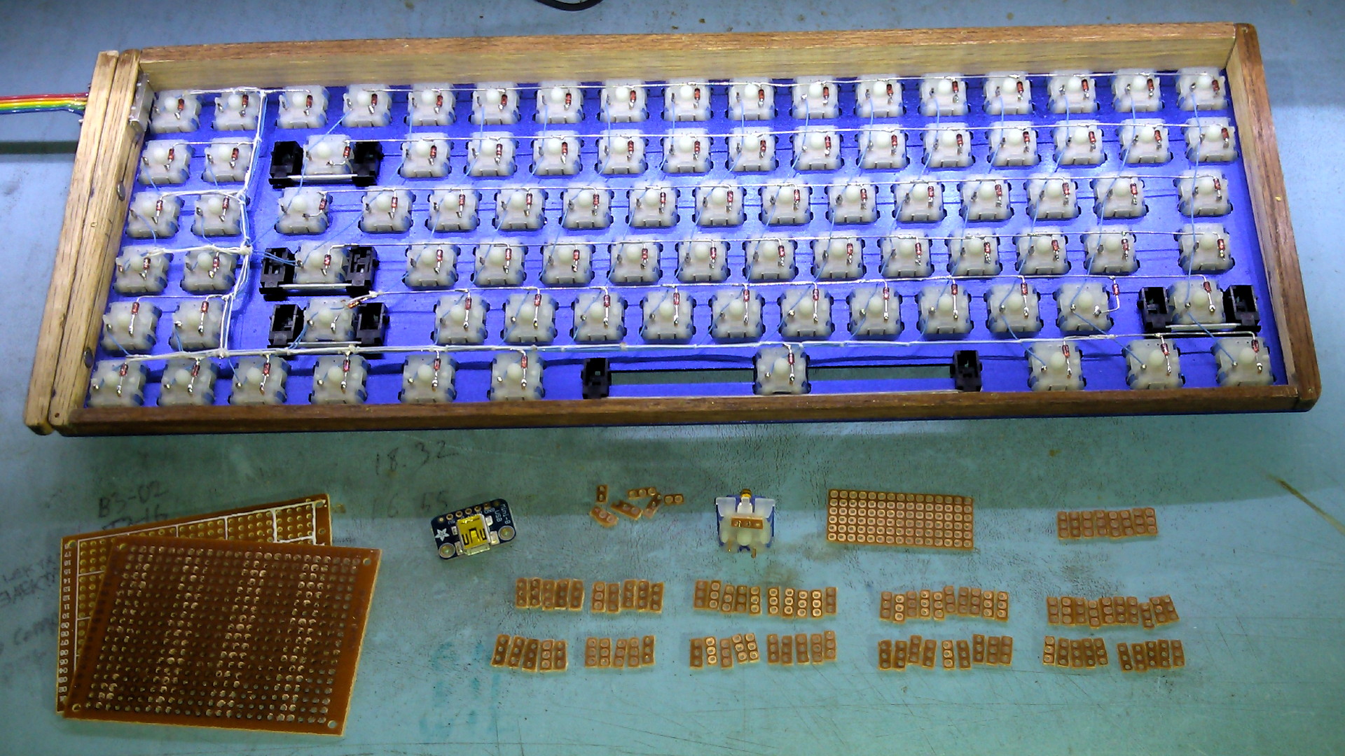

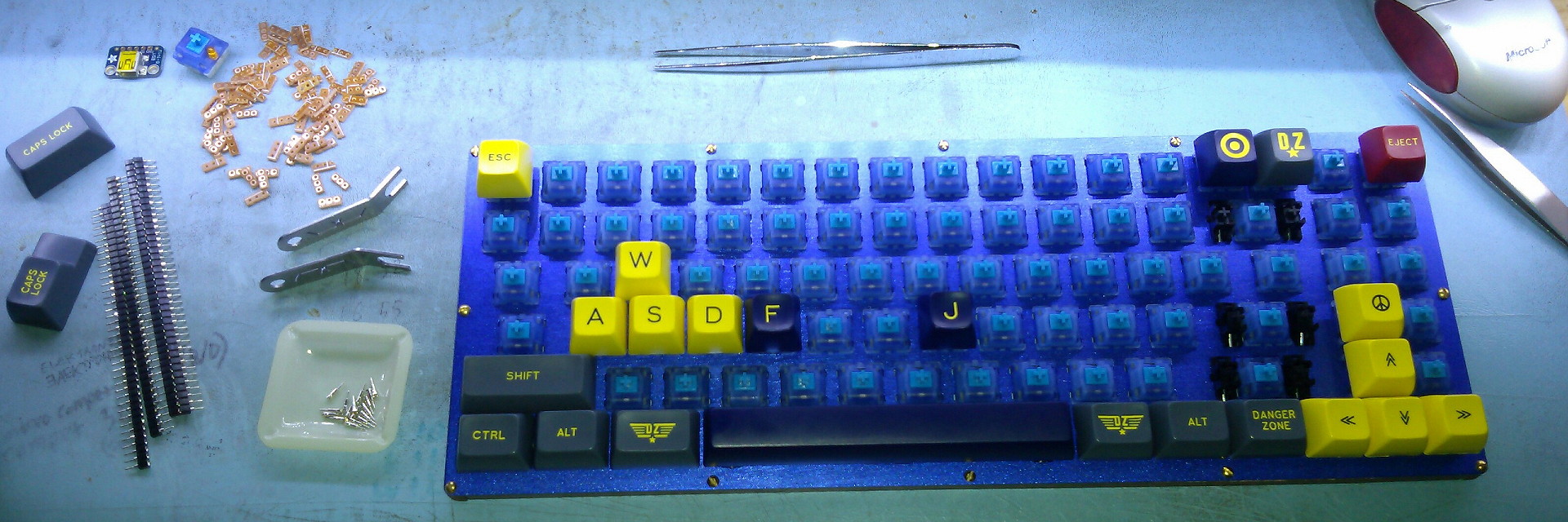

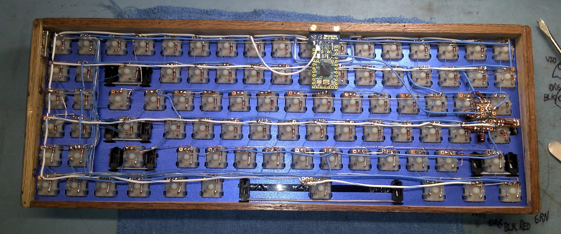

So, here's my progress so far.
Also, as a disclaimer, I posted this info, in nearly the same format, on the TMK tutorial/help thread. I'm hoping to get a response to my coding questions. I feel this info should also be here, so this thread will maintain a complete record of the build and coding.

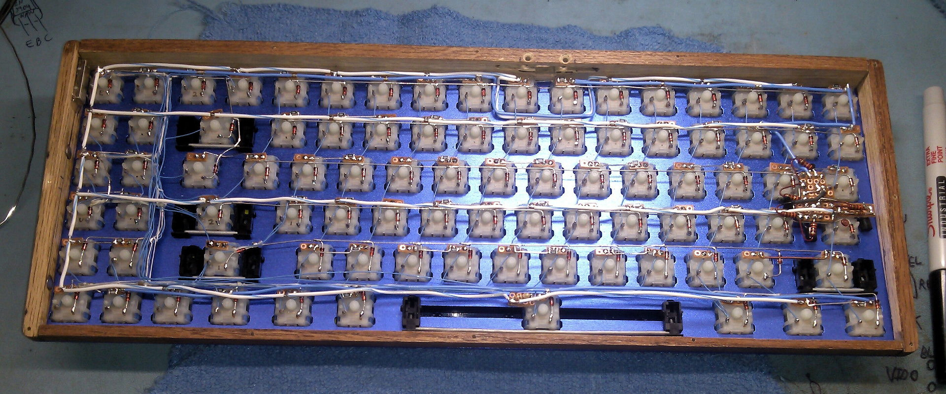

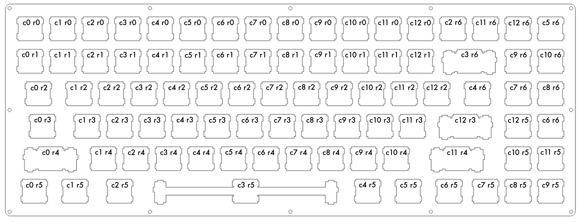

First, I've made up a nice layout worksheet that has all the electrical rows and columns identified not he physical layout. It's top down view, so it'll be useful for defining my key layout too.
- Keyboard_DZ_75+1_Matrix.png (69.07 KiB) Viewed 7022 times

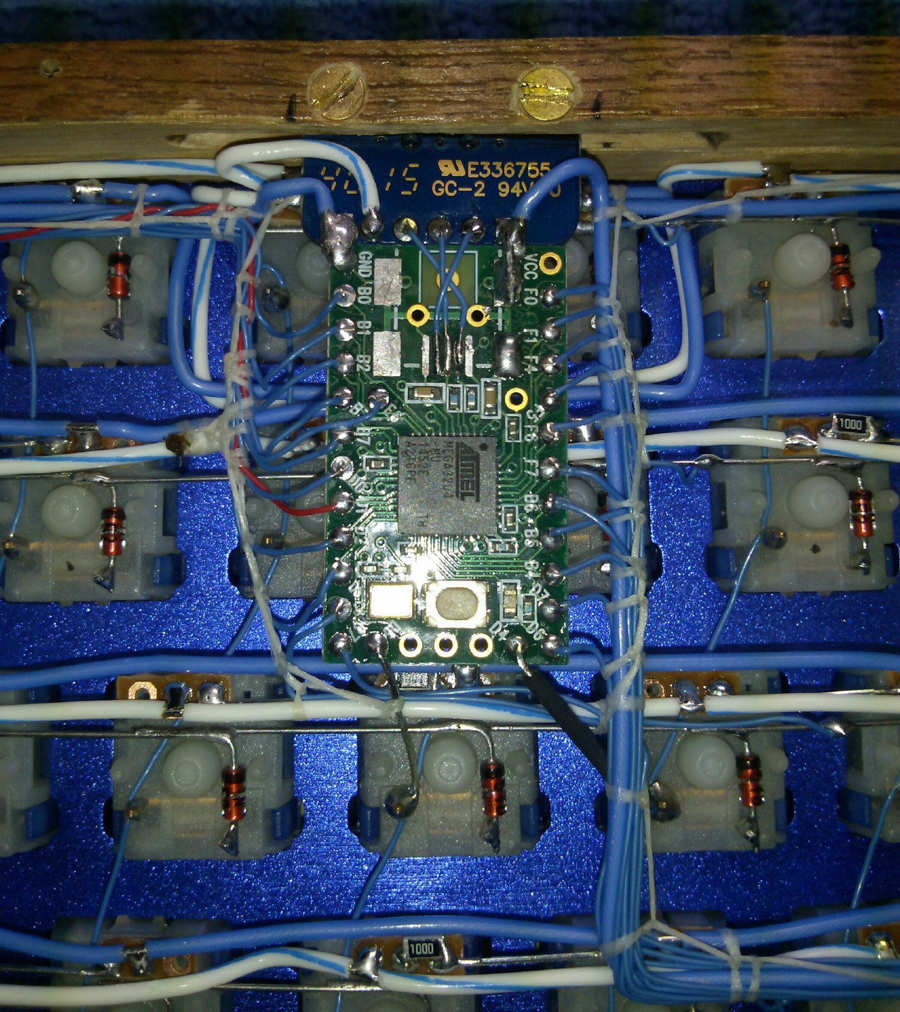

So, I did start with the TMK firmware. If it can do everything I need it to do, then I'll stick with it, but there's always the option of re-flashing it with something else in the future if I can't integrate the hot swappable port expander functionality into the code. The code for my Column and Row pin definitions are below:
/* Column pin configuration
* col: 0 1 2 3 4 5 6 7 8 9 10 11 12
* pin: F0 F1 F4 F5 F6 D4 D5 D2 B7 B3 B2 B1 B0
/* Row pin configuration
* row: 0 1 2 3 4 5 6
* pin: F7 B6 B5 B4 C7 C6 D3

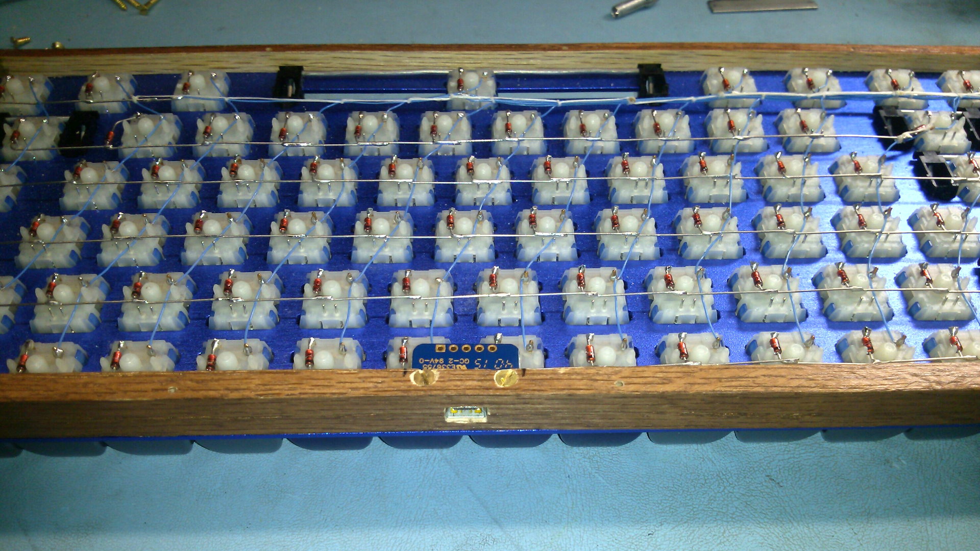

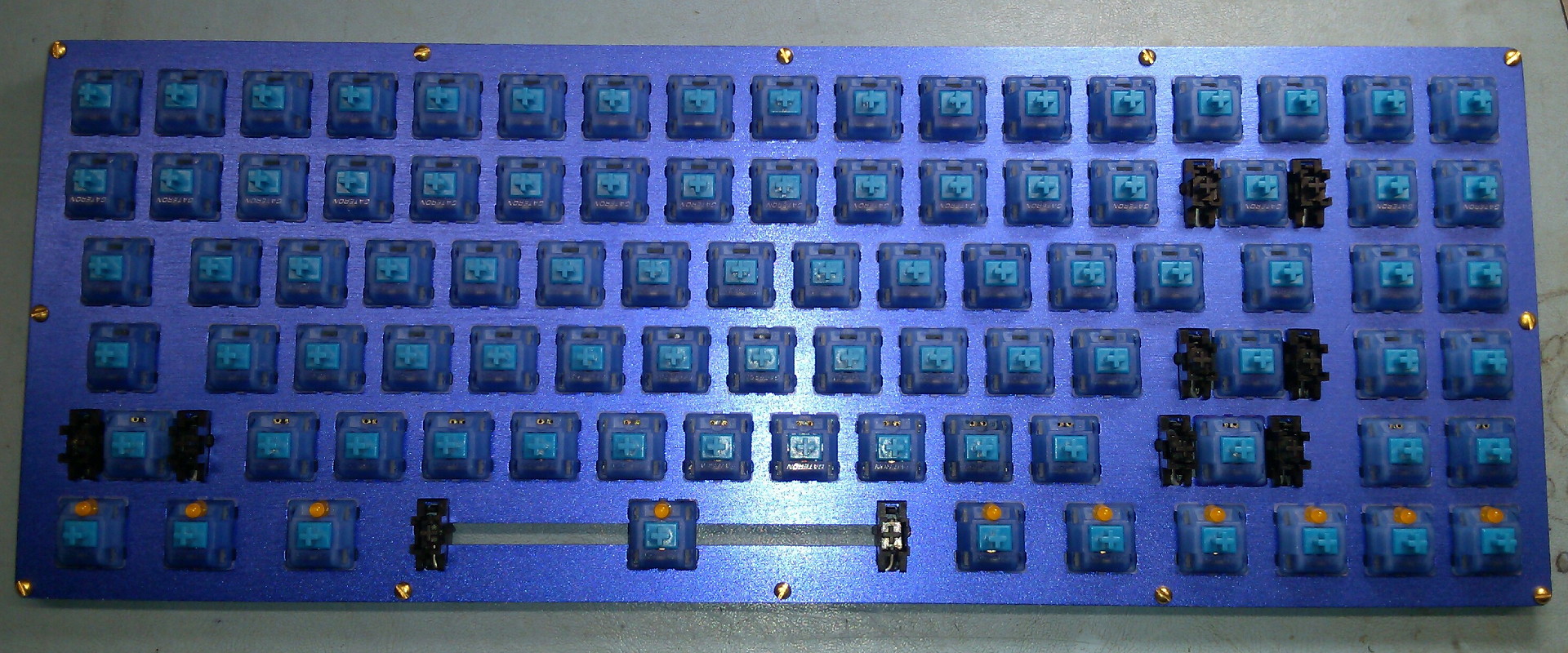

I have a VERY dense matrix of 13x7. It was necessary to keep enough I/O pins open for the Caps Lock LED, Backlight LED PWM, a pair of I2C pins, and the numpad sense pin. The sense pin detects if the number pad is attached, and whether or not it should poll the numpad's port expander over I2C. I figure, software is changeable, so I can re-do code later, once I actually have the number pad built, and have half a clue what the heck I'm actually doing.
Anyway, since I had to keep the matrix small, That super dense layout has almost no gaps, and row 6 is actually a tight cluster of keys in the top right corner. An alteration part way in resulted in the very top right key having a completely nonsensical matrix position, because the change was literally a bodge. Only three intersections in the entire matrix go unused (c0-r6, c1-r6, and c12-r4). This means my matrix does not directly conform to the physical key layout in some areas (all of Row 6 is in the top right corner, and the bottom row is "electrically" compressed to the left, and then includes the keys physically in the bottom right corner well).

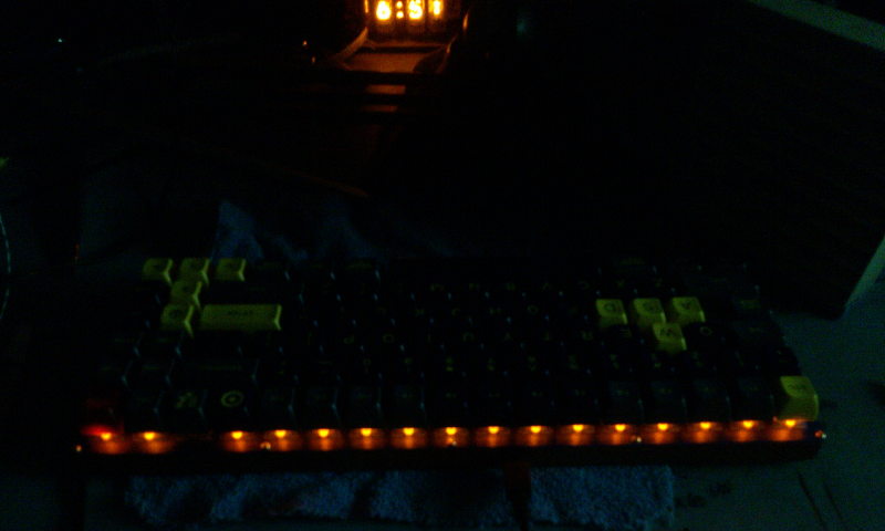

I think, for the transistor driven under-lighting LEDs in each switch housing, I just want to have a default max brightness setting at power up, and the option to change the brightness with the keyboard. I already have the max brightness current limited to stay under the USB max current, but I think at power up it'd be wise to keep total draw under 100 mA, and then let the keyboard negotiate 500 mA if you increase brightness... Again, I imagine it's possible, but I don't
know if TMK can do it, or how easy it'd be to mod that functionality in.
