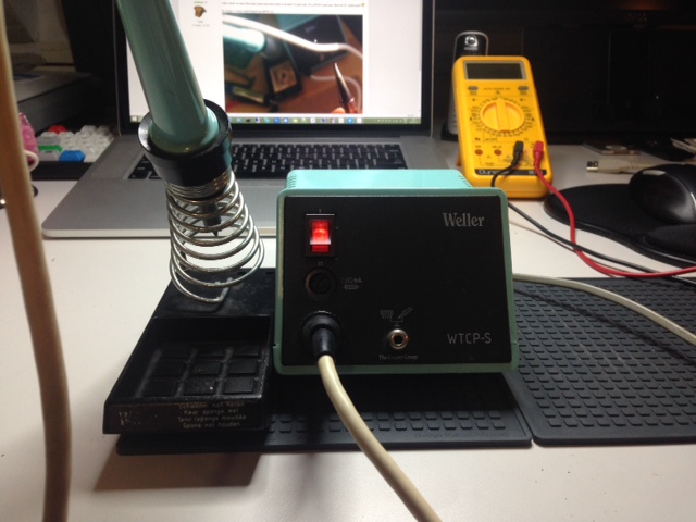

@ne0phyte, May I ask what kind of tip you are using on your Weller solderingiron? I have a exact same Weller WTCP 40E
but I think the tip I am using is not right for SMD soldering.

I don't think we have the exact same one since mine is at least 15 years old. It's a WTCP-S and says "Serie 02.93" underneath
I'm using a 1.2mm round sloped tip (4PTF7-1):

Tip is looking better than mine, I have a round tip 7 (no specific model number) only 7 for 700 F.
Look at the pic, it is about the same model, at the bottom it says Serie: 0387 and it was at my work desk when I started working 25 years a go so it may have been there for a while already
Any way, thanks for the info, when I have some more soldering stuff to order I will add this soldering iron tip.

Oh you are right. That does look like it's the exact same model I havemalcomkern wrote: Tip is looking better than mine, I have a round tip 7 (no specific model number) only 7 for 700 F.
Look at the pic, it is about the same model, at the bottom it says Serie: 0387 and it was at my work desk when I started working 25 years a go so it may have been there for a while already![]()
I'm new to soldering SMD so maybe the tip I'm using isn't ideal, but I ordered it specifically to solder those components and found it great to use for that so far. The flat side is nice for the Atmega32u4 TTQFN44 package and the pointy edge works like a charm for the 1206 capacitors and resistors.

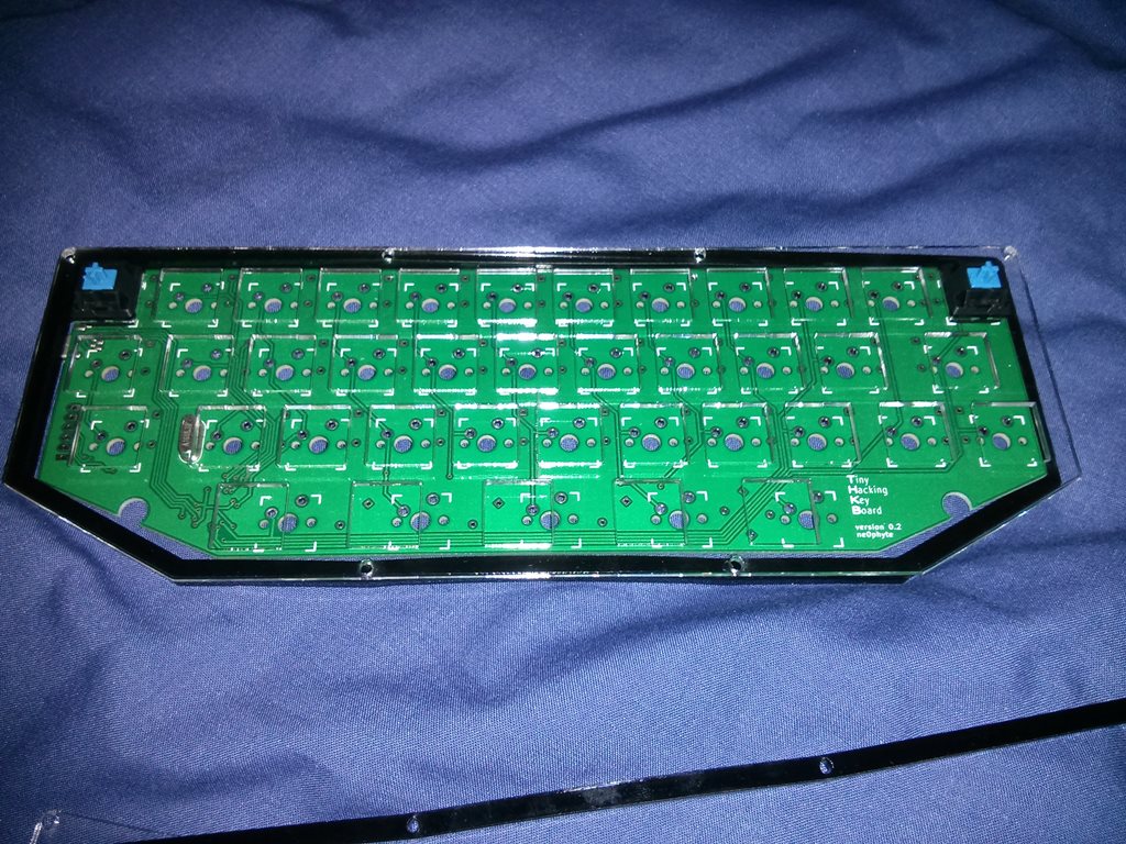

Has anyone tried making this with an acrylic switch plate? I know in general, metal is recommended as it will flex less, but I feel that this is such a small board that isn't really an issue.
I had all the CAD files ready for the CNC man at my local FabLab, but he's so busy this is getting pushed back and back, so I was considering getting some 1.5mm acrylic and doing it out of that - I know I can get that done 'while I wait' essentially.

I decided to go for it, and I literally just got back from the FabLab with my acrylic cut sections. I think it looks great!
- IMG_20151211_155359.jpg (232.46 KiB) Viewed 7560 times

Literally just the cost of materials. £8.40 for the black (it was an A3-sized sheet I will be using for other projects as well) and £3.15 for the clear (A4-sized sheet - used most of it just for this). Though I think the FabLab will start charging for machine time in the new year.
Also, the black bits are a tiny bit off (I only had guesswork to go off when making the CAD files), so I will need to drill the tiniest bit out for the PCB to fit.
In the picture, I've just clipped 2 switches in to test - as you can see, in the bottom right corner, the black bit doesn't quite fit around the PCB - either my case or the PCB itself isn't quite symmetrical. Only other thing is the USB port doesn't line up either, but that's an easy fix. Chop a bit off that layer and stick it back on somewhere else.
