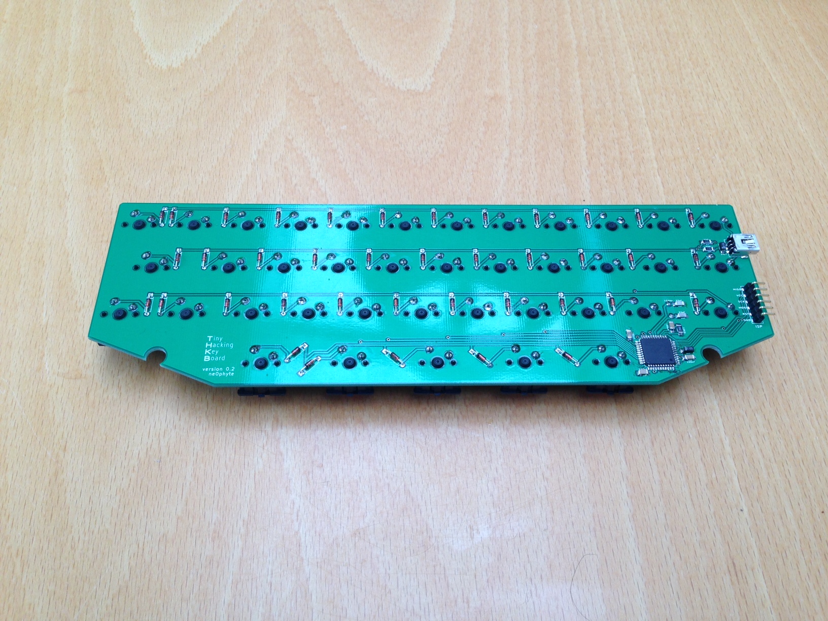

Just out of interest, is it obvious which way round the diodes go? I'm a bit of an electronics noob, and I don't want to have to desolder and resolder all of them if I get it wrong!

If this picture shows the PCBs diode side up (which I think it does) then those rectangles look like a good sign for "insert diode here", and each of them has a stripe at one end. Just like you'll find on your diodes.

ne0phyte did a good job with this. There is a mark for where you need the diodes to go and they have the line on them facing the direction you need them to go.

You guys are too fast for me. Yes, there is a black line on the diode that you just line up with the line on the PCB.
EDIT: That reminds me, I have to change the size of the diode footprint. The pad distance can be a lot smaller for those tiny diodes.

I don't think I have seen this on another pcb I have used. It is a nice idea to remove a little doubt.

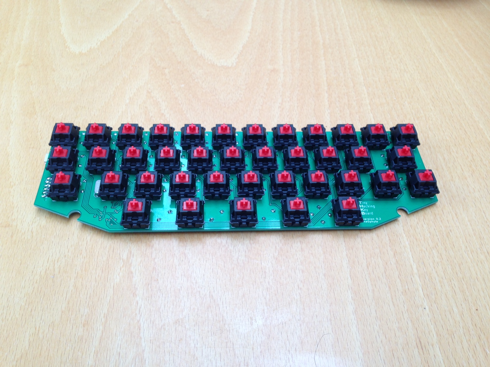

Did all the soldering. Not a pro with the SMD stuff but slowly learning. I think all parts are fine now.
If I plug the USB cable in on my windows machine I see a ATm32U4DFU in my Other devices present so there is some communication
Now I wait for the ordered USB programmer, should come on Wednesday or Thursday
- Soldering done
- IMG_1802.JPG (712.51 KiB) Viewed 9492 times
- THKB with some MX Reds
- IMG_1801.JPG (643.97 KiB) Viewed 9492 times

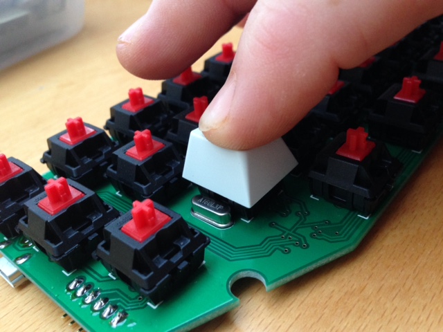

Yes it is. Key fits easy, never goes down all the way to the crystal. See photo.
- IMG_1803.jpg (101.81 KiB) Viewed 9459 times
