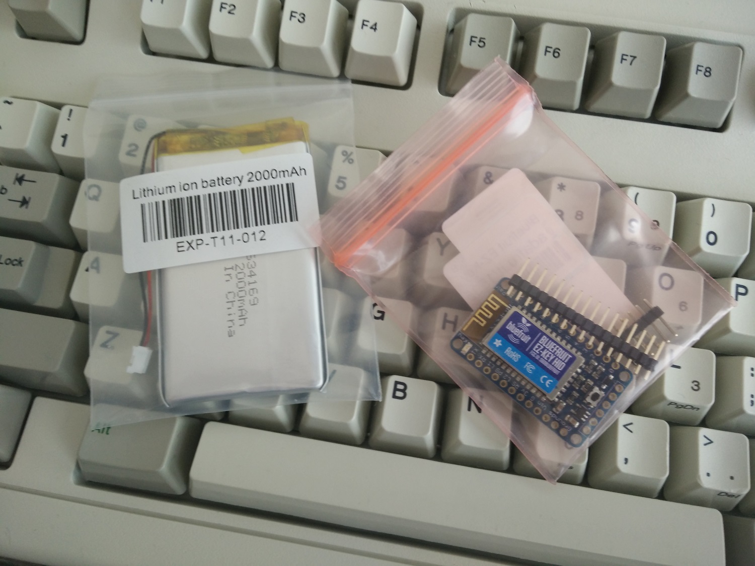

Got all the parts except the actual controller.

Now that I read the quote again, I hope I can somehow manage to put my 2000mAh battery inside the SSK.
Need more battery life!
- Muirium
- µ
- DT Pro Member: µ
Probably not a problem. An extender cable ought to do the trick. There's plenty of room in the SSK, if a bit further away from Phosphor's controller.
