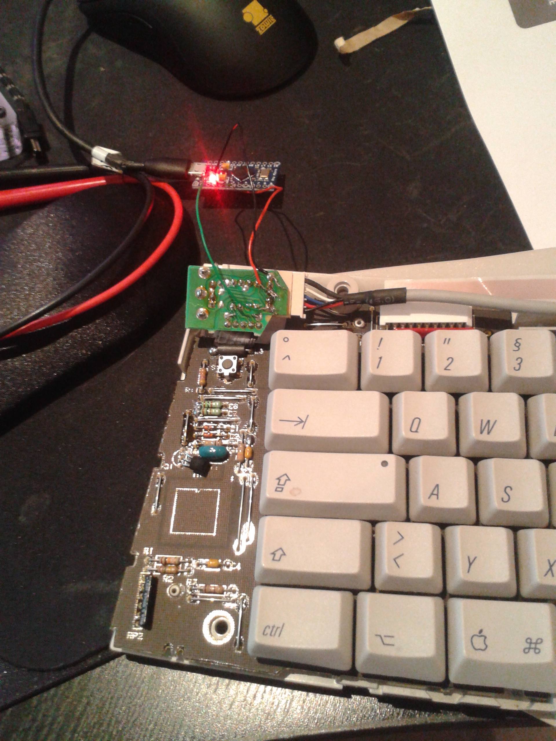

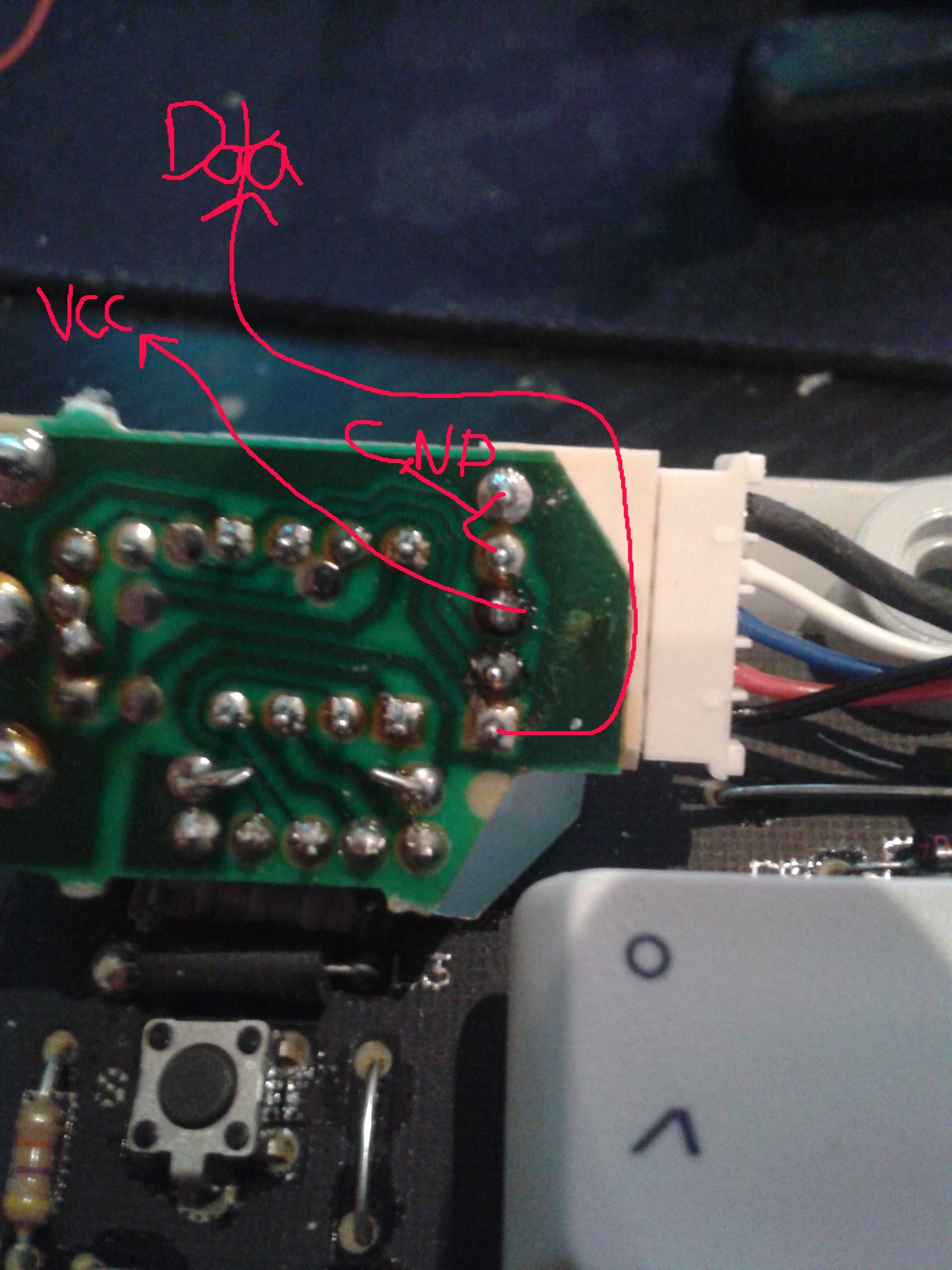

keiwop:
So my current CLOCK is in the right pin? Something went right after all
I much rather would change the soldering setup. I had so much trouble with the flashing and don not want to do it again (at least not yet) if possible.
Would it work if I solder the DATA to RX and solder the jumper togehter mentioned by Findecanor?
Thanks for the huge help keiwop!
I am also wondering, where did you guys come up with all this information? I usually try to learn while I do projects like this but this time I think I have learned nothing. This is some dark magic shit to me right now. Any recommendations on good articles to read in this subject?
Redmaus: I will look into this, thanks!
keiwop:

I'm in the process of getting one of these set up to use as an ADB converter, I'll post a bit more when I've got the damn thing flashed
http://www.ladyada.net/learn/avr/avrdude.html

TMK, right? I'd love a drag and drop ADB converter .hex file for Teensies. The default one in TMK mismaps a few things, enough to drive me mad, and then the very moment I edit the source the whole thing collapses.
I've no idea why. Which is the dangerous part. Every edit I make makes sense to me, but not the compiler. Uh oh!

Et viola! One functional AAK using hasu's ADB converter running on a pro-micro
. Very happy with this, going to get it all pretty over the weekend and try it out as a work board. I've also included my super pro wiring diagram incase someone else is planning on doing this
. Also, sorry about the attachment size...
- 20150528_220115.jpg (458.83 KiB) Viewed 12329 times
- super_wiring_diagram.jpg (212.12 KiB) Viewed 12329 times
