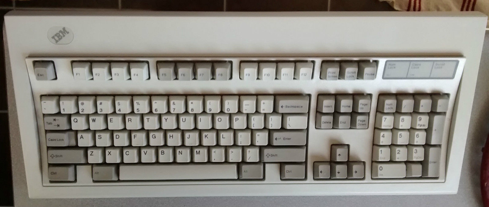

Ordered myself an old school model M and wanted to make sure I had the right adapter for when it arrives.
Plan on using it at work with a desktop that has a PS2 keyboard plug. I know the model M has pretty high power draw and was wondering whether modern PS2 plugs can handle it.
The other question is that if I went the USB path would this one do (http://www.ebay.ca/itm/NEW-Ziotek-PS2-K ... 541005c100)
Id prefer something cheaper but if I have to get it I will.
Eventually ill probably refurbish it and put in USB converter but want to get running as quick as possible.

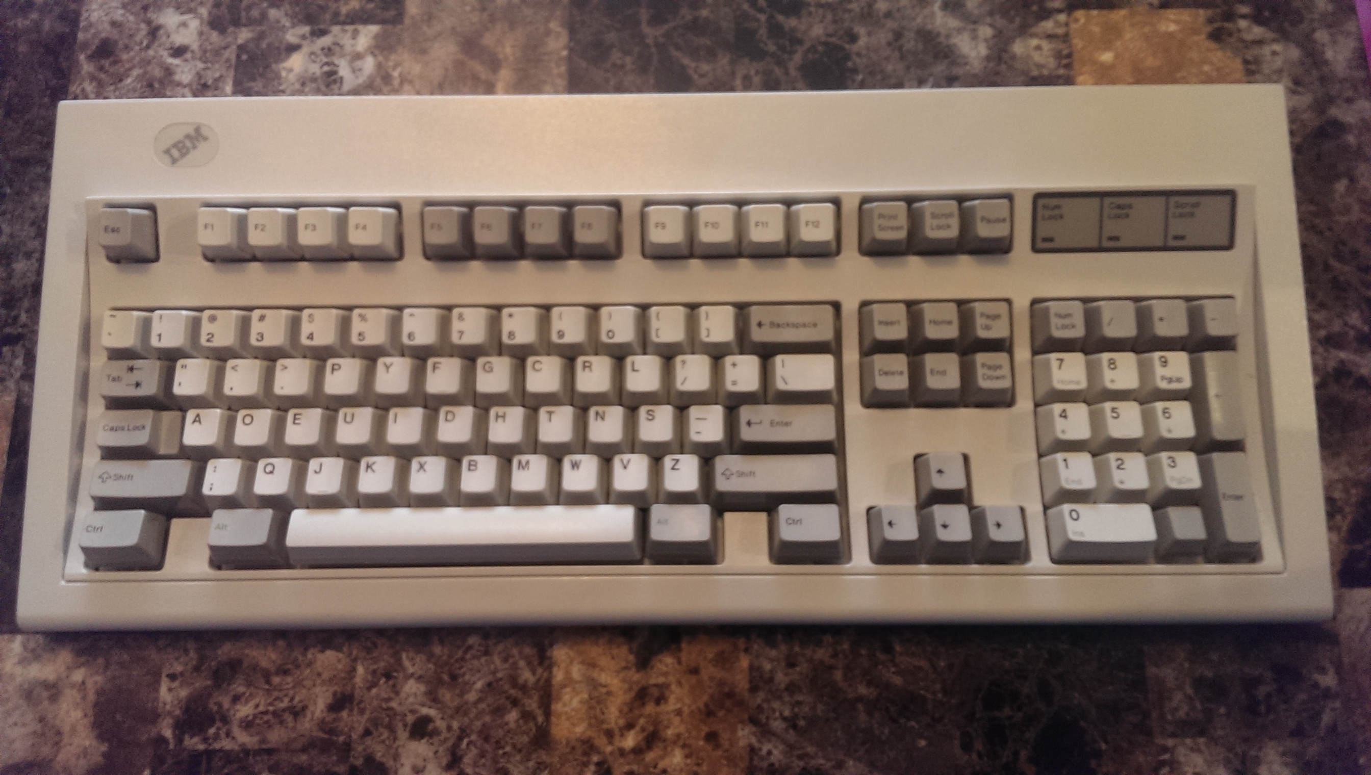

Well finished cleaning up my Model M and of course the dental floss mod to soften it a tad. I know there is debate between using Ultra and Super floss.
I find that Ultra Floss gets rid of the ping without affecting the tactile feel while the Super Floss dulls the sound more but really dulls the tactile feel.
The only problem I had is that the .Del key on the keypad is missing
Does anyone know a good source for the key?
I tried clicky keyboards and found their price reasonable ($1) but they wanted $25US to ship it to Canada which is a little rediculous since I get stuff shipped from the US all the time and find it is never more than $4-$5 for something that size. I contacted them just in case it is an error but am doubtful.

http://www.clickykeyboards.com/ has original model M caps ( best option)
http://www.pckeyboard.com/ for reproductions ( nice but not a patch on originals)
Looks like you already checked clickykeyboards, try unicomp. if not , once i get my silver label M i am going to part out the other , if i don't need the cap for the silver label i can send it to you for the cost of a bubble mailer over the pond . However it may be a while , you would be better trying to find someone with a board to part out in the us.

My preference is to go with originals if possible.
I am in no hurry as the keyboard works great without the missing key. If you end up sparing parting it I will grab it off you.
All of my keyboards so far have been custom jobs and this was the first IBM model M. It is noisy as hell but there is something satisfying about the feel and sound that it makes. Damn as addictive as crack.
I am tempted to try a more ambitious model M project but will wait and see after my thinkpad project is complete.
