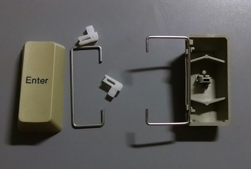

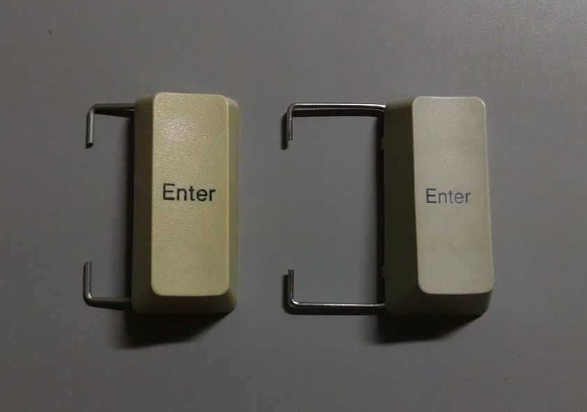

stratokaster
13 Mar 2015, 00:34
The keycap on the left is from my Silitek-made Dell AT101W, FCC ID GYUM92SK.
The keycap on the right is from an old Alps AT101-102 rubber dome keyboard, FCC ID GYIMIDAS101-102.
As you can see, stabilizer wires are different sizes. Dell's stabilizer system is detachable, while Alps uses hard-molded stabilizer mounts.

jacobolus
13 Mar 2015, 06:19
stratokaster wrote: The keycap on the left is from my Silitek-made Dell AT101W, FCC ID GYUM92SK.
The version on the left is the same as most Alps-mount keyboards, whether made by Alps, Silitek, or whoever else. The one on the right is some unique one-off.
What threw me off is the AT101 / AT102 name, since Alps made several very nice mechanical switch keyboards under that name, both Alps branded, and otherwise (e.g. Dell, SGI, etc.).
