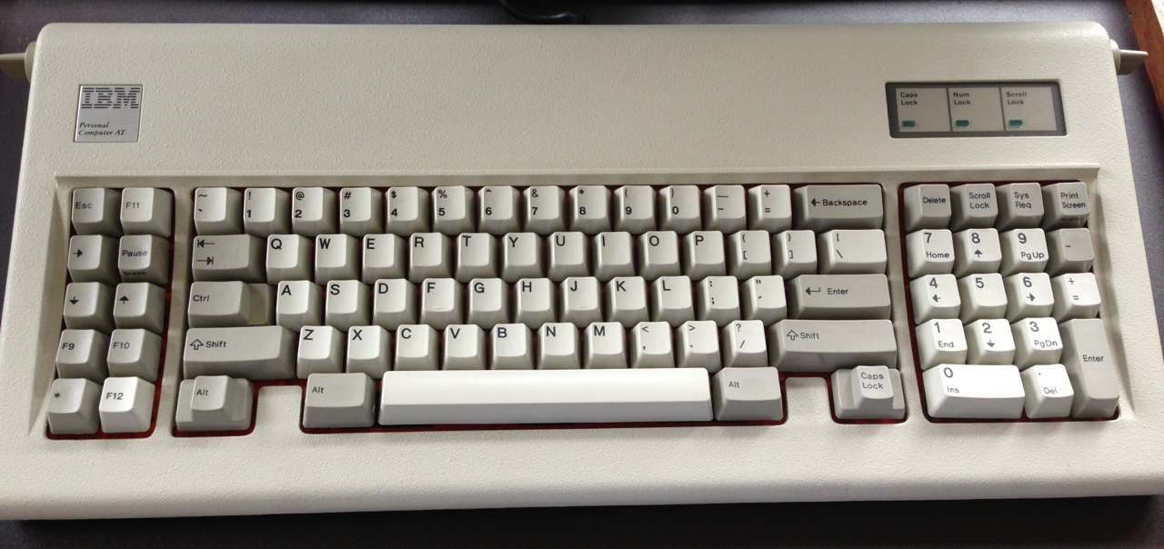

Anyway, good news: I'm typing on the AT right now. Floss worked! Thank goodness, because I was just getting hopeful fail after hopeful fail before I tried this. Somehow the flipper was perching itself almost in the right spot but not quite, which meant a properly clicky spacebar but never a positive detected keystroke. That's all fixed now. Instead, I've just realised I'm getting the caps dirty from the sticky residue from that damn AT cable still on my hands. Argh!
The next step will definitely be a Teensy / Pro Micro conversion.
Also: I can't seem to get the main case bolts to bite properly in the two mounting holes around that damn cable. Odd. Pretty sure they were bitey before. And the case doesn't seem flexed.
Let the puzzlement continue!

It wasn't to screw the controller to the main assembly by any chance?Muirium wrote: I seem to have more screws than places to install them. There's 6 identical stainless steel looking bolts (2.5 mm hex allen key head) and 2 smaller bronze colour screws, that are philips head and more the sort of thing you install hard drives with. But the case only takes 4 bolts, and the main assembly mounts via another 2 holes. (I have the LED and controller PCBs mounted in place with their own bolts / screws, and the earthing pillar is complete as well.)
Glad to hear that.Muirium wrote: Anyway, good news: I'm typing on the AT right now. Floss worked! Thank goodness, because I was just getting hopeful fail after hopeful fail before I tried this. Somehow the flipper was perching itself almost in the right spot but not quite, which meant a properly clicky spacebar but never a positive detected keystroke. That's all fixed now.
- Muirium
- µ
- DT Pro Member: µ
Ah… now I know why I was having no luck with a Pro Micro or a Teensy inside the board. The diagrams at KbdBabel are mirror images when you're looking at the cable's jack. I had +5V and Ground reversed! Eeek.
Fortunately, no Teensies were harmed in this experiment. Both converters I tried simply refused to function, with the Pro Micro dimming its little LED in protest.
Since the board was working all the while with its stock cable and my trusty Soarer box, I checked voltages while it was running and worked out what I should have noticed in the small print! What can I say? First time Soarer! Inside a keyboard, that is. I'm used to doing everything the other way around, behind sockets.
Now that I've fixed the error, I finally have the AT working independently. The Pro Micro's doing the job just fine. I still have a bunch of spare screws though! They aren't for the controller (both its screws are in, as are the screws in the LED board, and the earthing pole) and I found that the case screws just don't get any bite on the two holes around the cable outlet. This board's held together by the two at the sides, instead, plus a screw of my own I found that has a good fit in the centre. I'm using the pillars back there for strain relief on my micro USB cable, so I reckoned it was wise to make sure something's holding it there.
I'll be back inside again sometime to install a socket in the case. And some more floss may be used while I follow Fohat's suggestion and put in the Numpad Enter that my fingers still expect at the right hand edge!
Thanks for the tips everyone. If any of you know where these screws are meant to go, I'm all ears.
