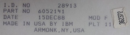

Question:
Can someone tell me if this IBM 3178 will have a solenoid inside ?
Cheers

It is indeed possible to use a xwhatsit controller + solenoid on a model M keyboard.
http://deskthority.net/keyboards-f2/sol ... 11683.html
also all IBM 3178 keyboards (ones with a blue toggle switch) should have a solenoid. Assuming it wasn't stolen.
