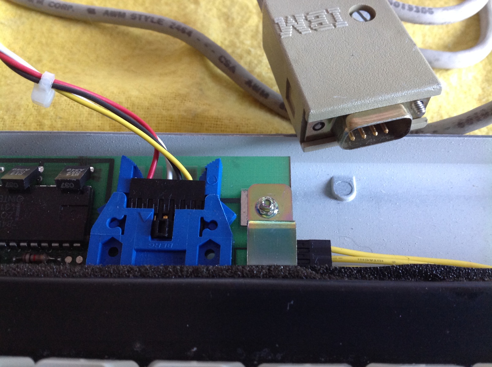

Okay, just taken the case off my Kishsaver, and what do I see? Different cable colours!hasu wrote:This converter with special serial no. 002 is on the way to AU. Enjoy, 002
Mine is a late dated one (1986) with some differences to the other three Kishsavers I've seen (I proxied for Tinnie, and I took photos when I had them, which I need to wiki…) so I expected there could be interesting times ahead.
I've tested the pins on the cable, and 2 goes to white; 3 goes to red; 4 goes to black, and 5 goes to yellow. Reckon I'm safe following your pinout above? I wonder if they monkeyed around with the controller as well as the cable!

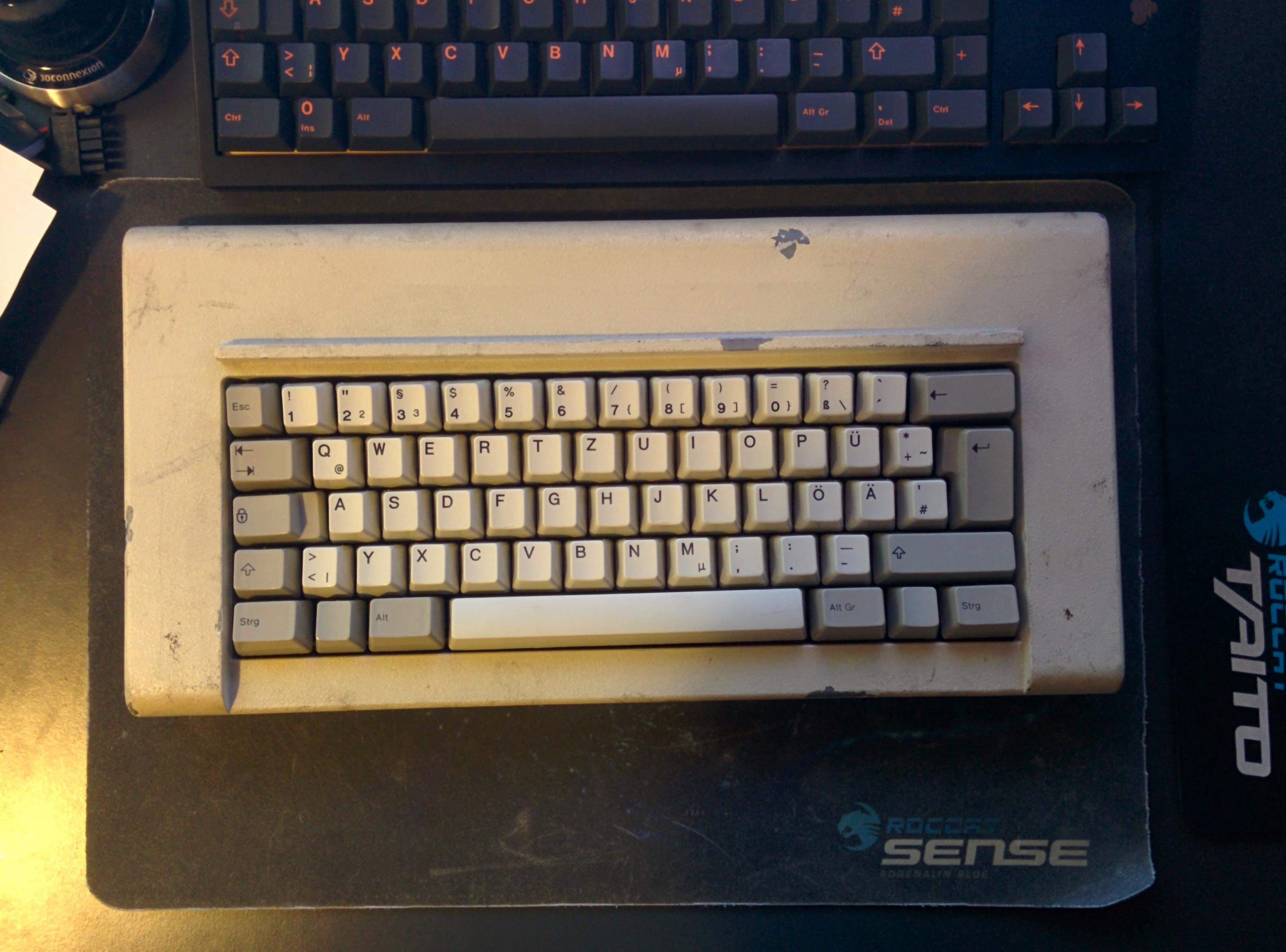

Hasu has his modded to have an ANSI Layout, they all initially come like in your picture.
Here's how mine looked before bringing it to the paint shop, where it is currently getting a nice fresh paint!
But of course I took out the inside prior to that, so I can still play around with it case-less at the moment.
I wanted to go with a split right Shift at first, but unfortunately only 1x and 1.75x is possible (not 1.75x and 1x like I wanted), so I left that standard.

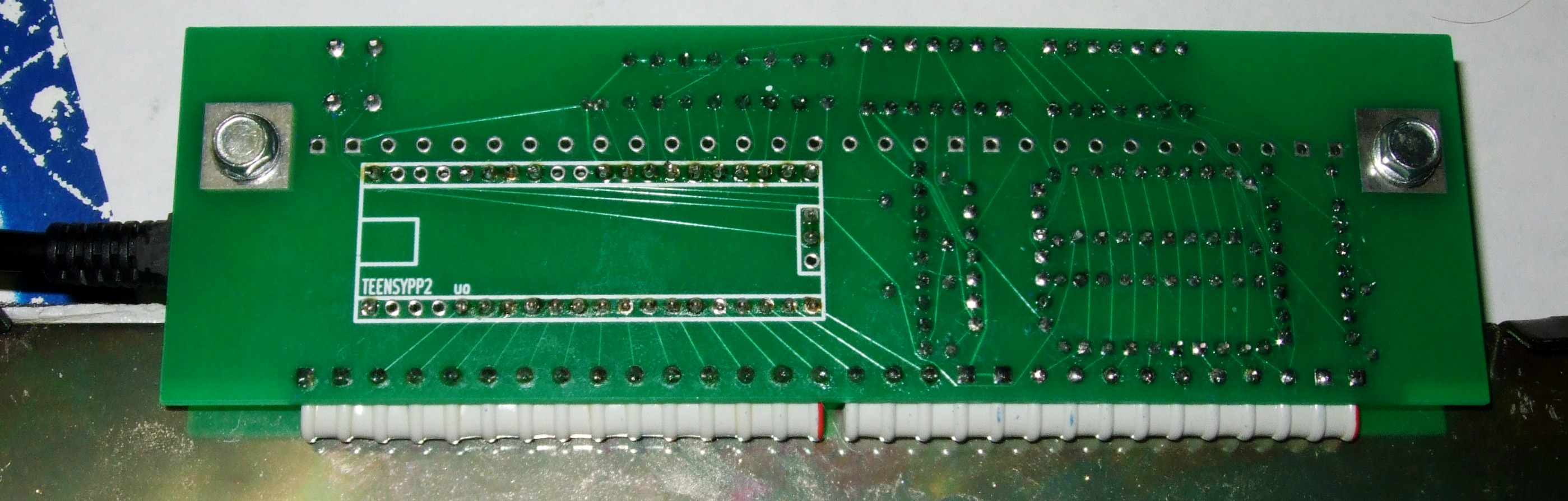

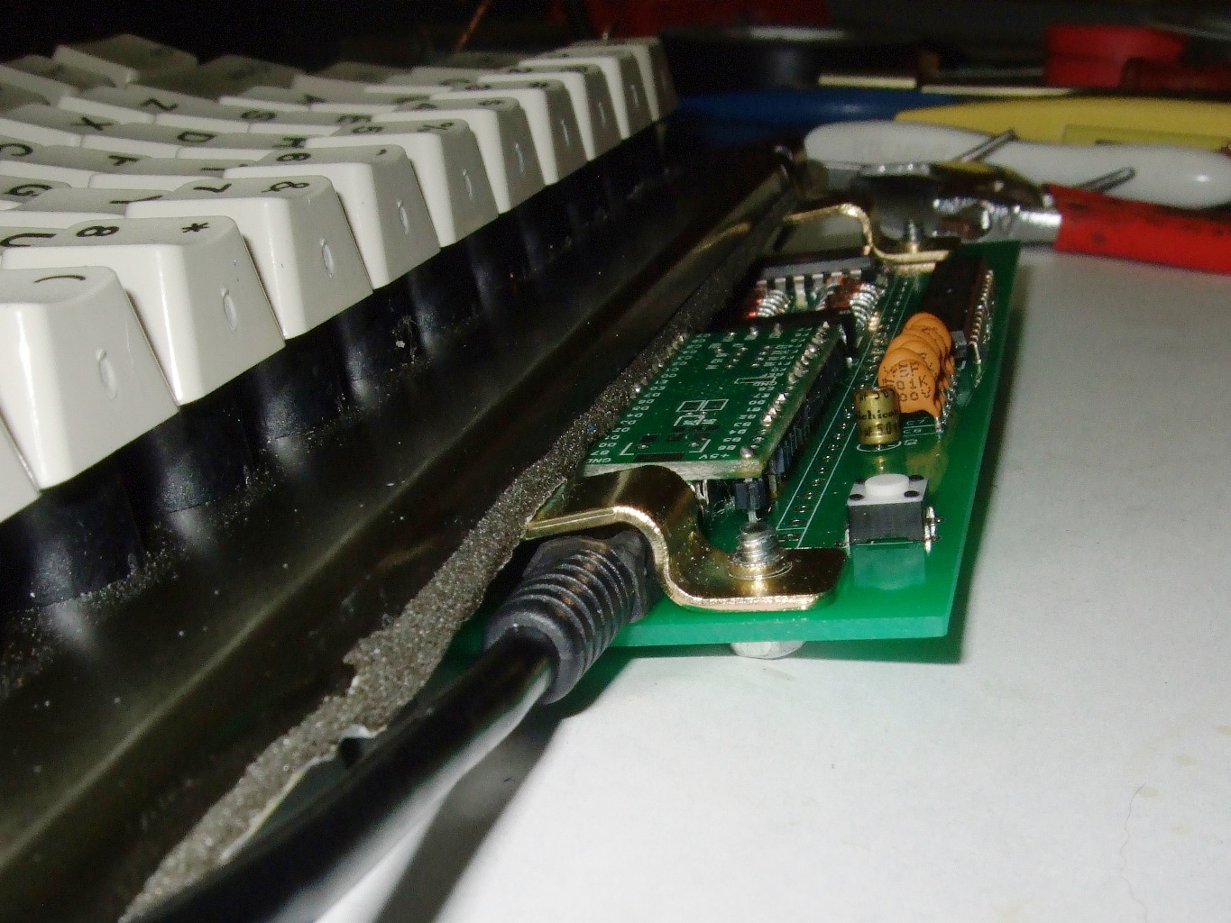

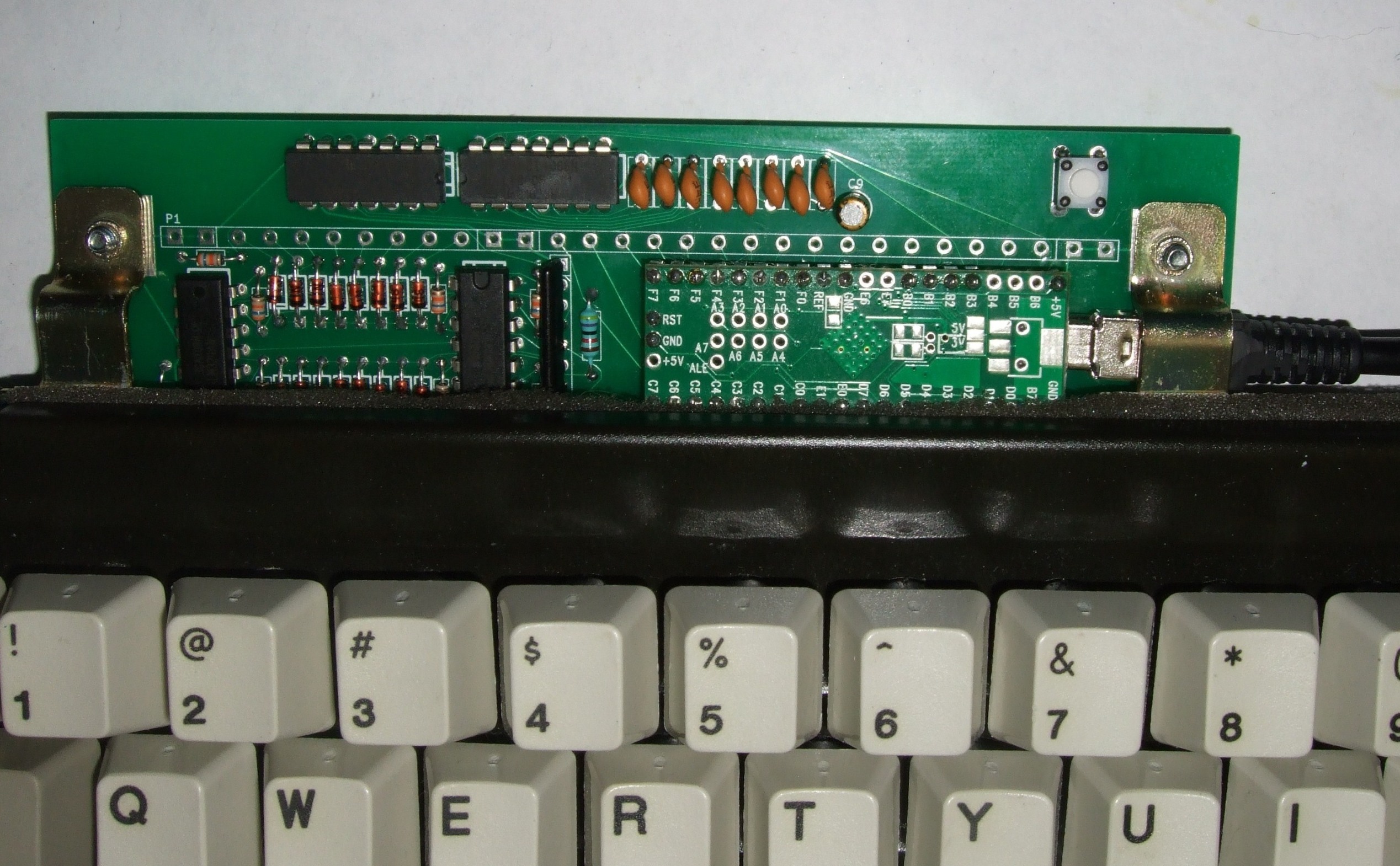

I built mine and and am here to report.
The toughest part was getting the ribbon cable off of the old controller. After spending about a half hour on that and getting nowhere, i gave up and just cut it as close to the controller as i could. It worked out just fine. More on that in a minute.
Take what I advise here with a grain of salt. I am not an expert with a soldering iron - in fact, i suck.
My assembly order was from shortest component to tallest. I started with the diodes, then standard resistors, the chips, switch, resistor array, then capacitors. The diodes, chips, resistor array, and that one odd capacitor have to go in one specific direction; don't put these in backwards or it will not work. This is where i stopped to take the picture in my last post.
Parak used diode leg trimmings to mount his Teensy; I chose to use standard header pins. I only had 32 instead of the 43 that there are holes for, but this turned out OK - the controller only uses 31 pins. I soldered the pins onto the Teensy first and then checked the fit on the PCB. It looked really tight, so i mounted the controller in the keyboard to get a better idea. The Teensy comes very close to the barrel plate, but does not touch. But the opening for the USB cable was too small for my cable to fit inside. It turns out that this is a known issue - some mini USB connectors have larger heads than others. The smallest ones will fit with no problem; average size and larger need to have the the casing trimmed off. I kept the controller mounted and with USB cable connected while I soldered the Teensy onto the controller PCB so that i was sure that they would fit properly.
The final step was to connect the ribbon cable. I cut the old controller off, so i now had to strip some insulation from the cable. I used a razor knife to cut a line about 5mm back, flip the cable to the other side and cut on top of the first cut; use tweezers to grab a spot of insulation between the wires and pull. I tinned the wires to prevent the strands from splitting as i fed all 30 through the holes on the controller PCB (the second toughest part of building this).
And pictures.
And pictures.

I didn't have problems with the size of the holes, but rather just getting all the wires lined up to the holes. The wires are all the same length, so all 30 need to enter the holes at about the same time. When attempting to do this, usually one or two wires would be leaning slightly one way or another.

Same here. Larger holes would have just made it a bit easier, so they are now standard on the production type. I'm slow when it comes to detailed work, so someone faster could have done my install in under 2 hours, but not me! 2 minutes after that, all 30 pins were soldered in place. It was just a matter of geometry, like you say.wcass wrote:I didn't have problems with the size of the holes, but rather just getting all the wires lined up to the holes. The wires are all the same length, so all 30 need to enter the holes at about the same time. When attempting to do this, usually one or two wires would be leaning slightly one way or another.

Oh nice work! How does it go? I'm quite fascinated in how this controller operates in practice. That was a bit of cunning sneaking the USB plug underneath the attachment bracket
Such a different design. Really cool to see the different approaches taken to the same problem.
