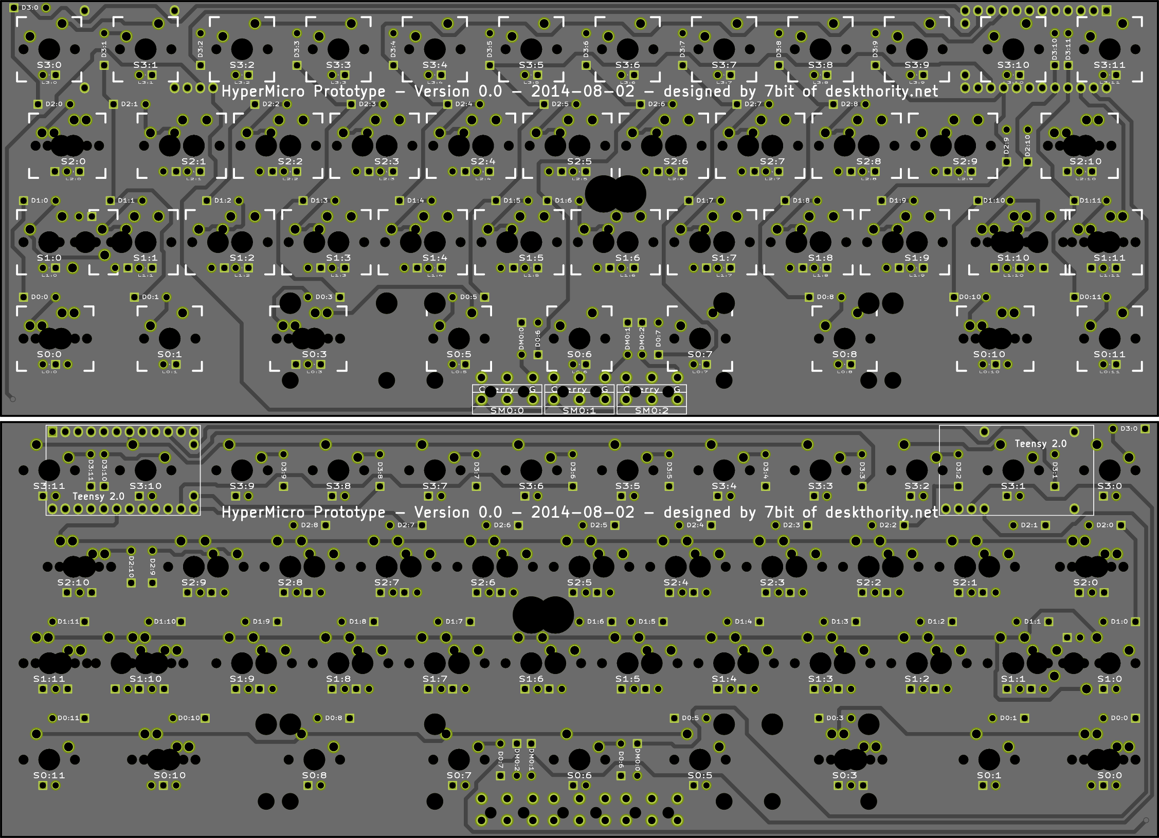

My own stuff until I get to the .brd and .sch files (including everything but the traces) and kicad from there.
Graphic is kicad's PS output (File/Plot, check "PostScript" and "Real drill" options) and manually put together. But this last step can be done with ImageMagick and a bit of scripting.

ANSI and ISO are the same, because there is no space for a Return key anyway.
Also:
This supports traditional and summetric stggering and 3 sizes of space bars (1, 4 and 7 units). Except for the 6.25 units space bar and an extra key, you can have about the same layout as the JD40.
I will post possible layouts later.
Another advantage over the JD40 is the fact that you can use PCB-mount switches and stabilisers to cheap out on a mount plate and save weight!
However, mount plates for plate mounted Cherry stabilisers will be available, too.
ps: might be even possible to add support for 6.25 units Cherry space bars ...

- support for 6.25 units space bars to kill GH's JD40 keyboard
- support for 3 mouse-buttons at the bottom to please the wild duck

Scroll-wheel should go at the positions of the center-bottom-switch (the one that would be used for a 4 or 7 units space bar).
I think I should add a 2nd controller for all those extras ...

Is there any reason not to mount stabilisers upside-down?
I mean such that the wire is between ZXCVBNM<>? and the space bar.
If there is nothing in the way, an upside-down stabiliser would make sure that mousebuttons can be mounted even if a conventional space bar is used.

Well it's much cheaper than a Teensy 2.0 and has enough pins for small boards. It seems like a natural fit to me.
I think I see an error - on the bottom PCB, you have "Teensy 2.0" on both the left and right sides, but on the upper one the Teensy pins are unmarked. Should the "Teensy 2.0" text be on the upper diagram?

With the current price rise of the eBay ProMicro modules, I don't see any reason not to use a Teensy. You're already saving money on the lower switch count.
Personally, I'd ditch the LEDs for this version and look at rotating the overlapping switches 180deg to see if it makes the holes easier to produce.
Love the concept. Keep up the great work..

Peter's right about the current prices, but in general Pro Micro is a good fit for this sort of project. Much cheaper than Teensy when they're priced right, a bit slimmer, and Micro USB. Here's a blue one for size vs. a Teensy and an NRF wireless controller.
The more you bake in support for, the better!

Both controllers are on the bottom. Viewed from top, the right one is for the keyboard, the left is for the mouse buttons.scottc wrote: Well it's much cheaper than a Teensy 2.0 and has enough pins for small boards. It seems like a natural fit to me.
Indeed, the Pro Micro controller could be used for the mouse-botton PCB.
I use 17 pins, but the Pro Micro seems only to have 16 usable pins.
- scottc
I didn't realise that the Pro Micro had so few usable pins. It looks like it has more on the first glance, but most of them are useless. It also seems to have 3 GND pins, which makes no sense to me... disappointing
- Igthorn
There are 18 usable pins. TX/RX are PD3/PD2. The only ones that are not usable are VCC/RAW/RST/GNDs.

Thanks, but I'm not sure I want to change anything. I'm working an the LEDs now and want to make sure that at least the switches at the edges can be connected through the PCB.
