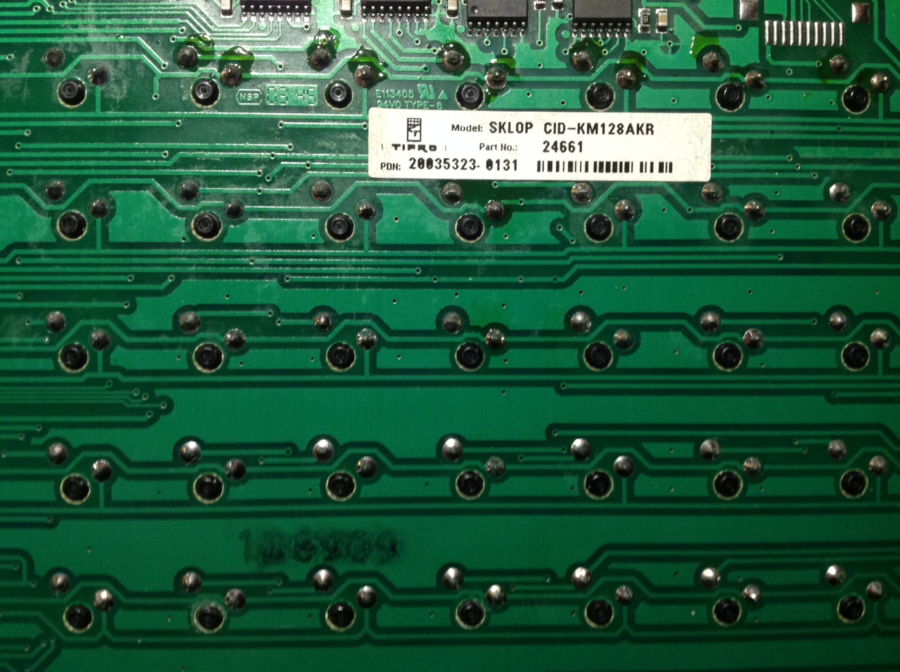

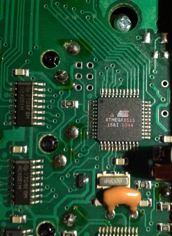

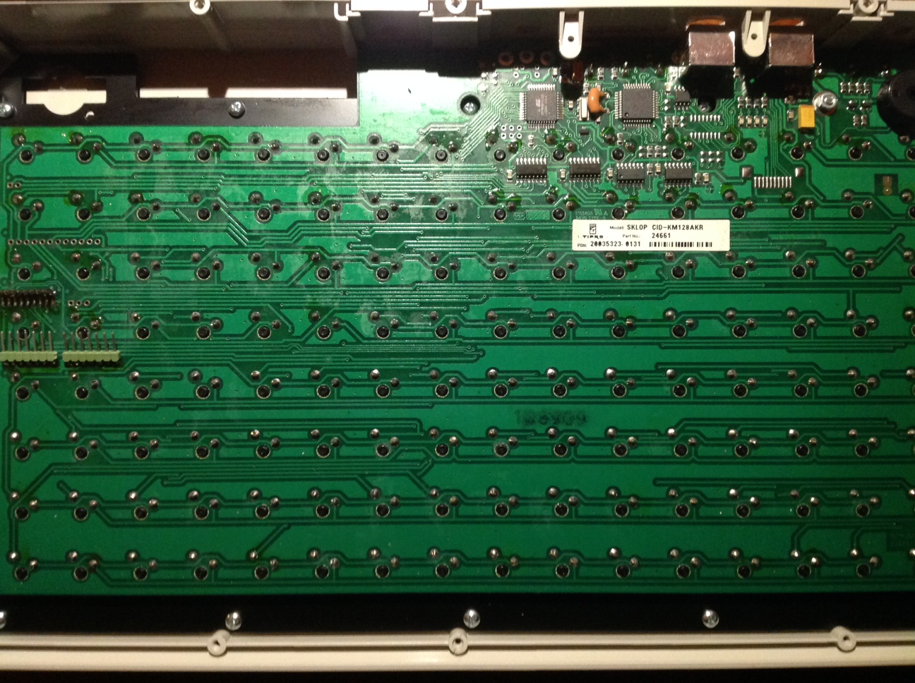

Is there a maximum matrix size for this controller, besides the available pins themselves? I'm thinking about an NKRO USB mod to an 8x16 PS/2 Tipro…
I like the Tipro's layer locks and lights, but its (reprogramming) software is a pain and I don't have PS/2 ports on most my computers anyway, so it's getting little use. A hand wired matrix and a Teensy++ 2 might just do the trick.

Great! Expect no less!Soarer wrote:It should handle 256 keys, with no limit on the shape of the matrix (besides available pins).
I don't think it does, in fact. The current rollover is pretty weak, but the software's so opaque to me I need to open it up to be sure. Lemme get my screwdriver… No diodes here. (Unless they're hidden on the top side under the plate?) That explains it. This matrix is just as naturally limited as my Model Ms, but (with a lot of de/soldering) it doesn't have to stay that way.Not sure why hand-wired... unless it doesn't have diodes...?
The only thing I'll lose (besides the crummy software and rollover) is layer locks. Well, it's not like I was using those at this rate. But if and when, they'd make a fine addition to the controller and converter suite. Unlike my own builds, this keyboard has all the layer indicator lights already in place.
I guess it's the same deal with the Teensy++ 2 and how many pins you can actually use: beware the one with the LED on it?
Hmm… I think recognise this guy: You have rivals in Slovenia!

Ha! But a lesser chip, with no USB
So, no diodes. Will take a bit of track cutting - you might get away with not having to desolder it, since most of the switches have the track to the more central pin visible on the back. Although, the pattern isn't as regular for those few switches near the chips, hmm.
Teensy++ 2.0 has so many pins that the onboard LED isn't likely to get in the way! But yeah, avoid it.
