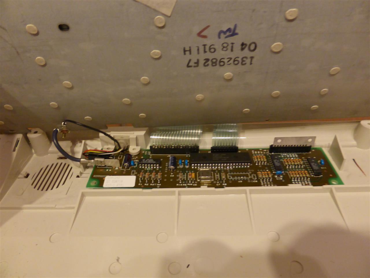

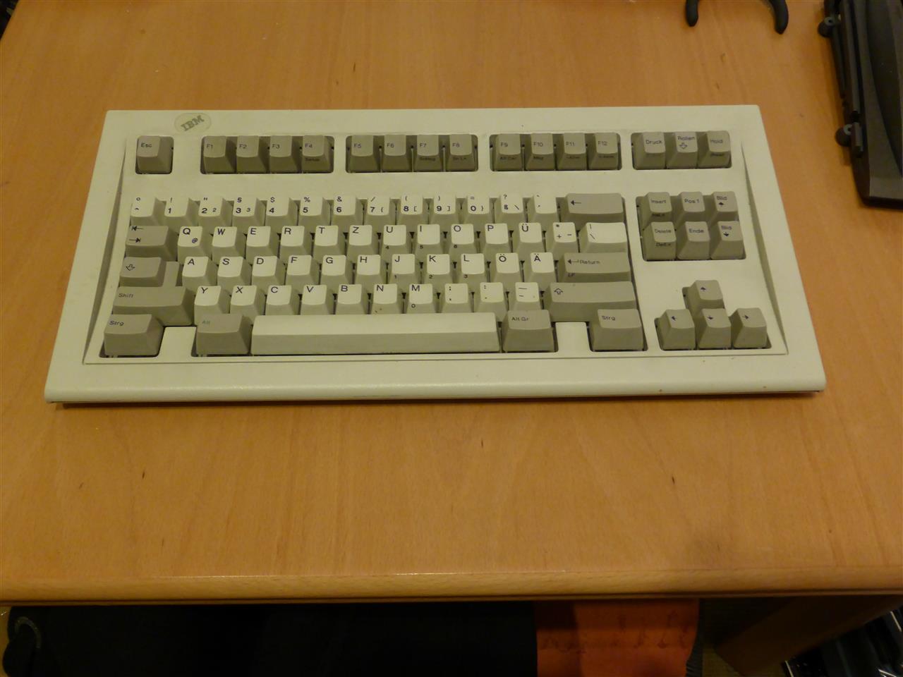

Thanks to a pointer from Muirium in the "why not us" thread, I was able to get a terminal SSK from a seller on ebay UK. It originally had an RJ45 connector and a fixed cable. I was lucky, the keyboard seems to not have seen a lot of use -- the springs feel great, and there are no broken rivets, bent springs or other problems. Sorry for the somewhat poorly illuminated pics.
I originally planned to use a Soarer converter to connect it to my PC. However, when I took a closer look and opened it I found that the key layout is identical to a PC SSK, and the two membrane cables that connect to the converter look the same and have the same positions as in a normal PC Model M.
Fortunately, I still had this old wreck lying around, with a broken case and missing key caps:
So I worked up the courage to just try and use the controller from the wrecked full size Model M in my "new" SSK. Which also has the advantage of a detachable cable.
And what can I say -- it works like a charm! The matrices seem to be just the same between the Terminal SSK and the classic fullsize PC Model M. All keys and also the membrane contacts that are not used in the ANSI layout work flawlessly.
Since I'm used to the German layout, the next step would be to convert it to ISO. I have shied away from that so far, because I would have to bolt mod the SSK to do that, and given the nice condition of the rivets, I am not really inclined to rip it apart at the moment.
What I did do was exchange the keycaps for ones with German layout. I was lucky to have gotten a German set of IBM caps from matt3o a few months ago, and together with the stems from the wrecked Model M I now, for the time being, have an SSK with a mixed "German ANSI" layout.
I'm using it every day at home at the moment, and I love it. Buckling springs FTW!
I wouldn't have found and got this keyboard without the community. So thanks again to Muirium for tipping me off, to Matteo for the keycaps, and to the admins and club members for bringing us all together here!

You're welcome, Halvar. Good to see the controllers and matrices are just as universal as the caps. IBM could be pretty smart sometimes.
The mixed layout you've got now is the best of both worlds: the way the German layout should be, I'd say! Give it a while and see if we can turn you to the dark side! Better keyboards on the ANSI side of the divide.

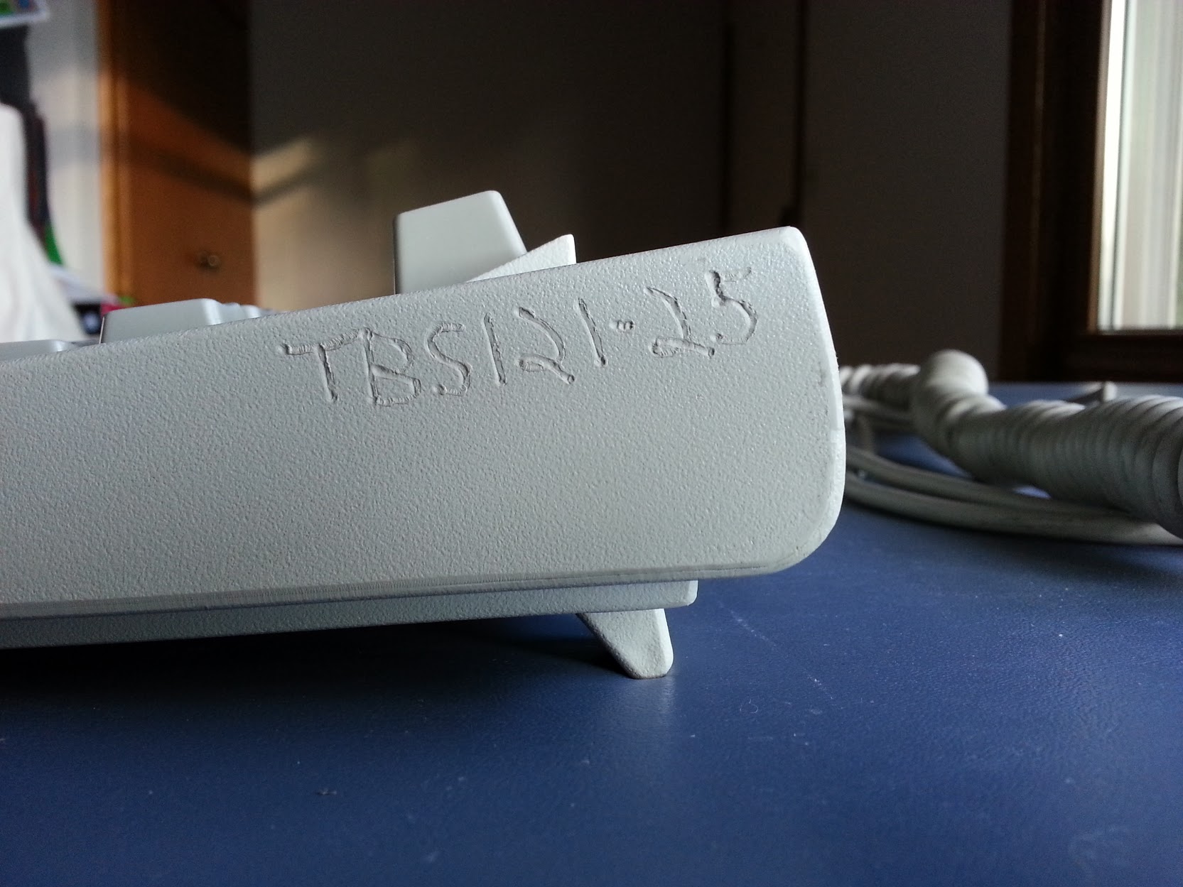

but engraved

Evil, but not nearly as bad as scrawling on the top.
Just imagine the computer lab where there were 25 or more of these! It would be like visiting Webwit's place.

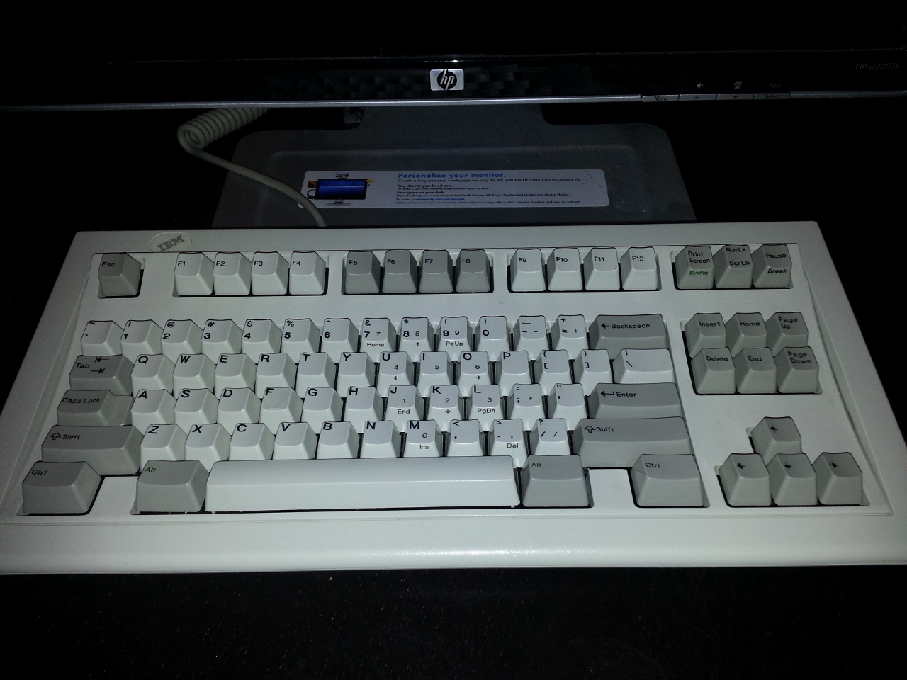

recent arrival:
Looking at the other picts in this thread I wonder if there's a difference between those with black logo's and those with blue logo's ?
ciao,
J.
ciao,
J.

Blue labels are the later Model Ms. Of all sizes. I think grey label was the one before that (where the logo is grey on beige plastic) and silver labels are the oldest of the three (where the logo is on a shiny silver square). Today's SSK (from the same batch as yours) is my first blue label IBM. I've several grey labels now, and one silver label PC/XT Model F.
Don't think there were SSKs back in the silver label days, but this is exactly the place to guess out loud and have someone show a picture as proof of the opposite!
